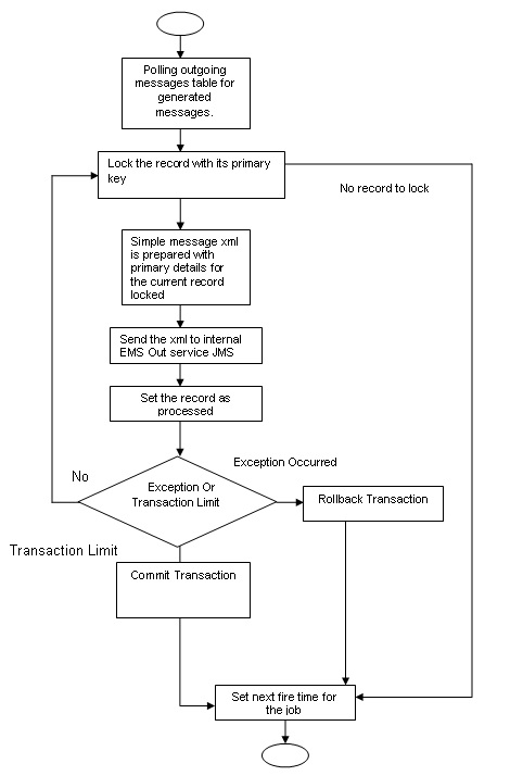

The Outgoing EMS Process as part of jobs scheduler is as follows:
  • Once the job is triggered, it polls outgoing messages table for generated and unsent messages.
  • Each message is then sent to an internal JMS queue.
  • The job is then rescheduled to fire next time.

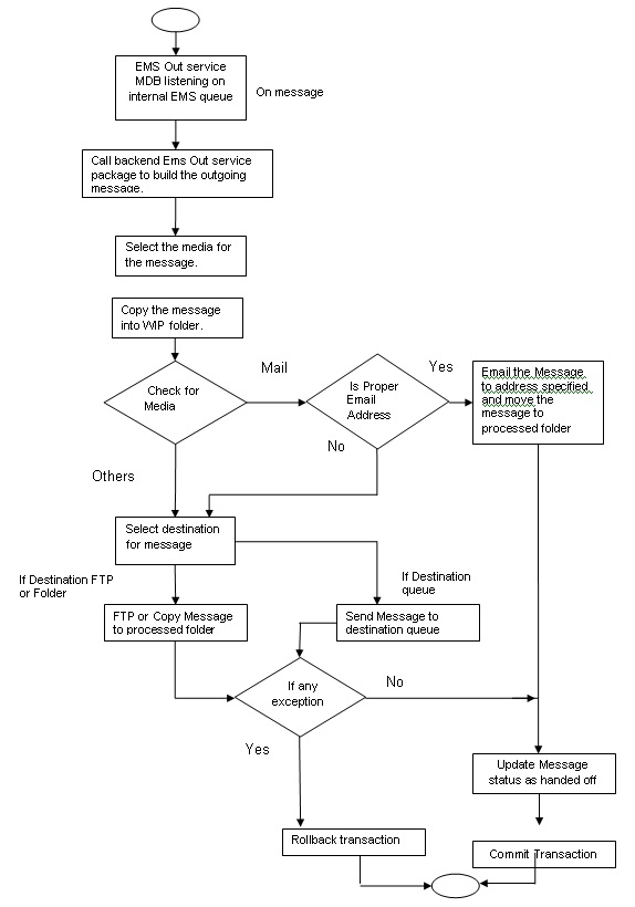

The Outgoing EMS Process in MDB is as follows:
  • An MDB listens on the internal EMS outgoing queue and it builds the final message sent to intended destinations.
  • In case of any exception while processing, message is sent to a deferred queue.
The following diagram illustrates outgoing EMS process in scheduler.
Flowchart
The following diagram illustrates outgoing EMS process in MDB.
Flowchart
