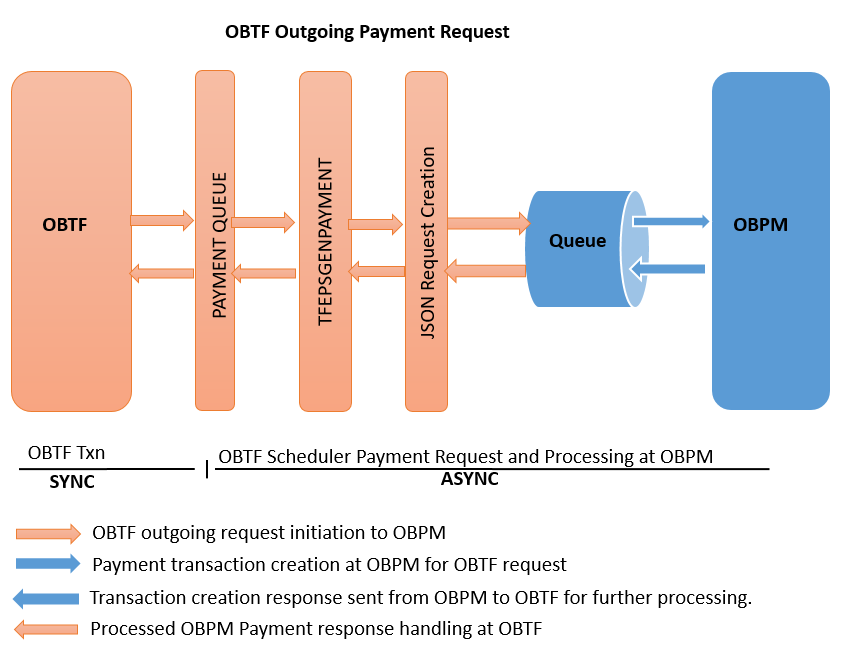

- ASYNC Processing,
- In OBTF a transaction is created with payment message initiation to OBPM system.
- TFEPSGENPAYMENT scheduler fetches records from Queue and handovers to OBPM.
- In OBPM a transaction is created and response is sent to OBTF
- OBTF updates the queue references accordingly.

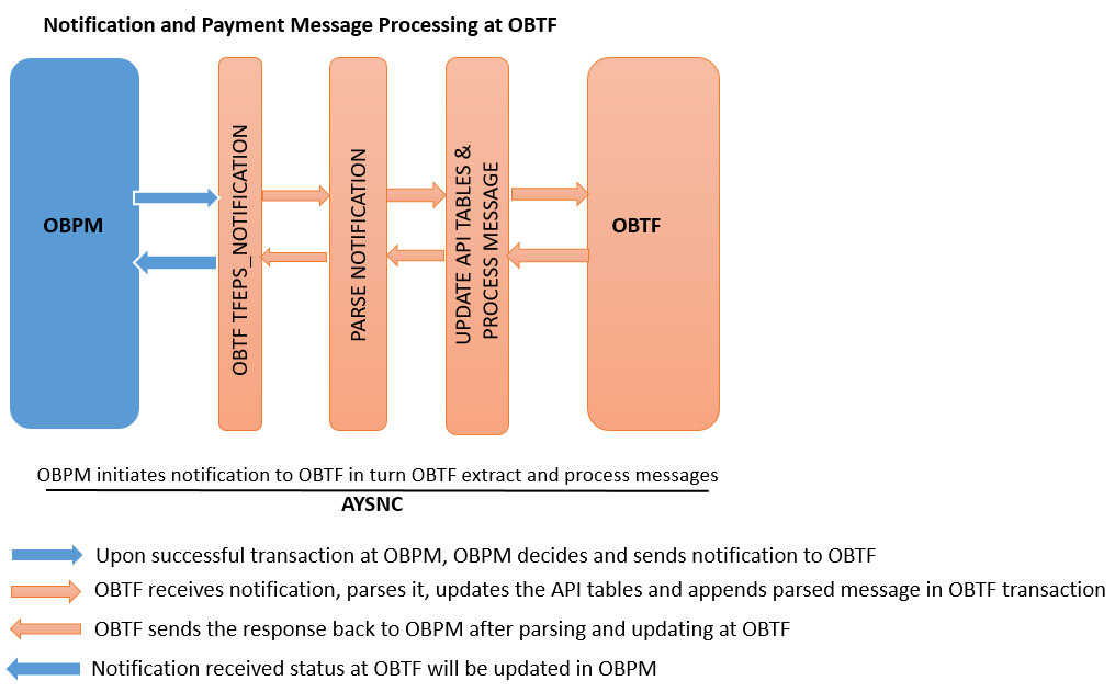

- Upon successful transaction creation at OBPM, OBPM decides in sending notification to OBTF.
- Once OBTF receives notification, OBTF parses notification, extracts payment message and updates the message CLOB of the OBTF transaction.
- Upon notification updated at OBTF, OBPM receives the OBTF processed
status and updates the external system (OBTF) processed status at OBPM.
Description of the illustration notification-and-payment-message-processing-obtf.png
