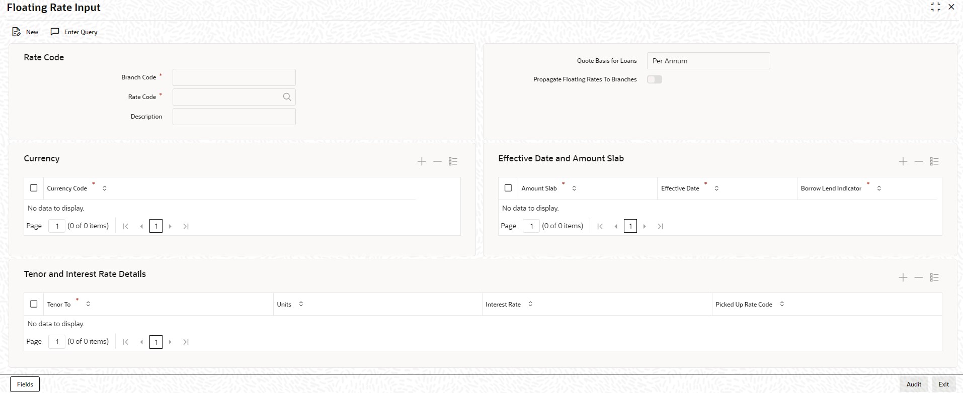

  1. On Homescreen, type CFDFLTRI in the text box, and click Next.
    The Floating Rate Input screen displays.
  2. On the Floating Rate Input screen, specify the fields.
    The fields, which are marked with an asterisk, are mandatory.
