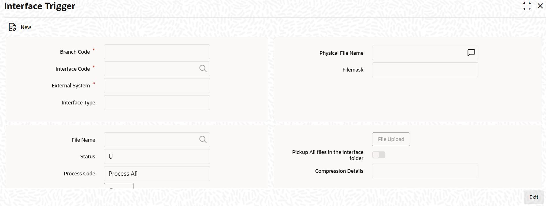

  1. On Homescreen, type GIDIFPRS in the text box, and click Next.
    The Interface Trigger screen displays.
  2. On the Interface Trigger screen, specify the fields.
    The fields, which are marked with an asterisk, are mandatory.
    Table 1-77 Interface Trigger - Field Description
    Field Description
    Branch Code Specify the branch code from where the GI file process has to be initiated.
    Interface Code Click Search and specify the Interface Code that has to be processed from the list of values.
    External System The system displays the External System based on the selected Interface Code.
    Interface Type The system displays the Interface Type based on the selected Interface Code.
    File Name Click Search and specify the file name if the selected Interface Code is Incoming.
    Status The system displays the status.
    Process Code Select the process code from the drop-down list, if the selected Interface Code is Incoming.
    • Process All - This will trigger File Processing and Data Processing one after another.
    • Retry - This is a retry operation, the previous process that failed is triggered.
    • Retry Error - This will rerun the Data Processing for error records.
    • File Processing - Populating the upload tables using the file data
    • Data Processing - Populating the base tables from the upload tables.
    Process Click on Process to process the entered details.
    Physical File Name A Physical File Name is applicable if a file that is uploaded through the Interface Trigger screen is processed. When the file upload is successful, the system displays the name of the file.
    File Mask The system displays the incoming file mask specified during interface definition.
    Pickup All files in the Interface Folder Check this box to pick up all files in the interface folder for the interface trigger.
    Specific File to be Picked Up Specify the specific file details to be picked up.
    File Upload Click File Upload to upload specified files.
