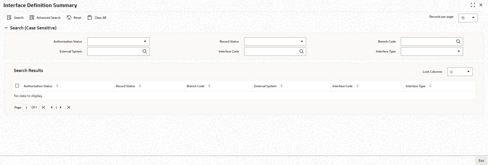

  1. On Homescreen screen, type GISIFTDF in the text box, and click Next.
    The Interface Definition Summary screen displays.
    Figure 1-71 Interface Definition Summary
  2. On the Interface Definition Summary screen, specify the fields.

  3. Click Search after specifying the search parameters.
    The system identifies all records satisfying the specified criteria and displays the following details for each one of them:
    • Authorization Status
    • Record Status
    • Branch Code
    • External System
    • Interface Code
    • Interface Type
  4. Click Exit to end the transaction.
