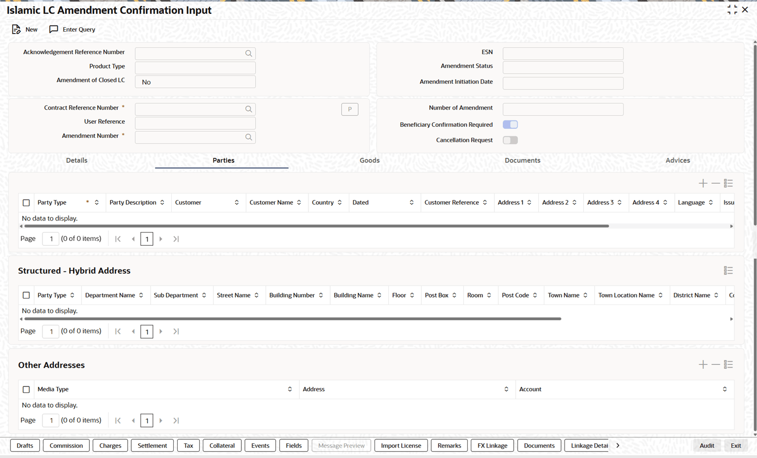

  4. On the Islamic LC Amendment Confirmation Input screen, click Parties.
    Islamic LC Amendment Confirmation Input - Parties screen is displayed.
    Figure 7-2 Islamic LC Amendment Confirmation Input - Parties
    Description of Figure 7-2 follows
    Description of "Figure 7-2 Islamic LC Amendment Confirmation Input - Parties"
  5. On the Parties tab, specify the details as required.
    For more information on fields, refer to the field description table below:
    Table 7-2 Parties - Field Description
    Field Description
    Party Type The system defaults the party type. The user can edit the party type using the adjoining option list that displays all the party types available for the Islamic LC.
    Customer The system defaults the customer number. However, you can modify it. Specify the ‘Customer’ for which you need to maintain. Alternatively, you can select ‘Customer No’ from the adjoining option list also.
    BIC Code appears next to the ‘Customer No’ only if the BIC Code is mapped with that customer number. If the BIC Code is not mapped with that customer number then the BIC Code will not appear next to the ‘Customer No’ in the adjoining list.
    Customer Name The system defaults the customer name. However, you can modify it.
    Country The system defaults the country of the customer. However, you can modify it.
    Party Description The system defaults the party description. However, you can modify it.
    Dated The system defaults the date on which the party joined. However, you can modify it.
    Customer Reference The system defaults the customer reference number. However, you can modify it.
    Address 1 to 4 The system defaults the address of the party.
    Language The system defaults the language in which advices are sent to the customer.
    Issuer Bank The system defaults the name of the issuer bank.
    Template ID Specify the template ID related to MT799 message types from the option list.
    Parent Account Specify the Parent Account number.
    Structured Payment Address Specify the following payments releated details.
    Party Type Specify the Party Type of a customer.
    Department Name Specify the Department Name of a customer.
    This field is optional.
    Sub Department Specify the Sub Department of a customer.
    Street Name Specify the Street Name of a customer.
    Building Number Specify the Building Number of a customer.
    Building Name Specify the Building Name of a customer.
    Floor Specify the Floor of a customer.
    Post Box Specify the Post Box of a customer.
    Room Specify the Room number of a customer.
    Post Code Specify the Post Code of a customer.
    Town Name Specify the Town Name of a customer.
    This field is mandatory.
    Town Location Name Specify the Town Location Name of a customer.
    District Name Specify the District Name of a customer.
    Country Sub Division Specify the Country Sub Division of a customer.
    Country Specify the Country Code of a customer from the list of values.
    Address Line1 Specify the Address of a customer.
    Address Line2 Specify the Address of a customer.
    Other Addresses Specify Other Addresses
    Media Type The system defaults the media type. You can select a different medium from the adjoining option list.
    Address The system defaults the other address of the party. However, you can edit this field.
    Account The system defaults the account number. However, you can edit this field.

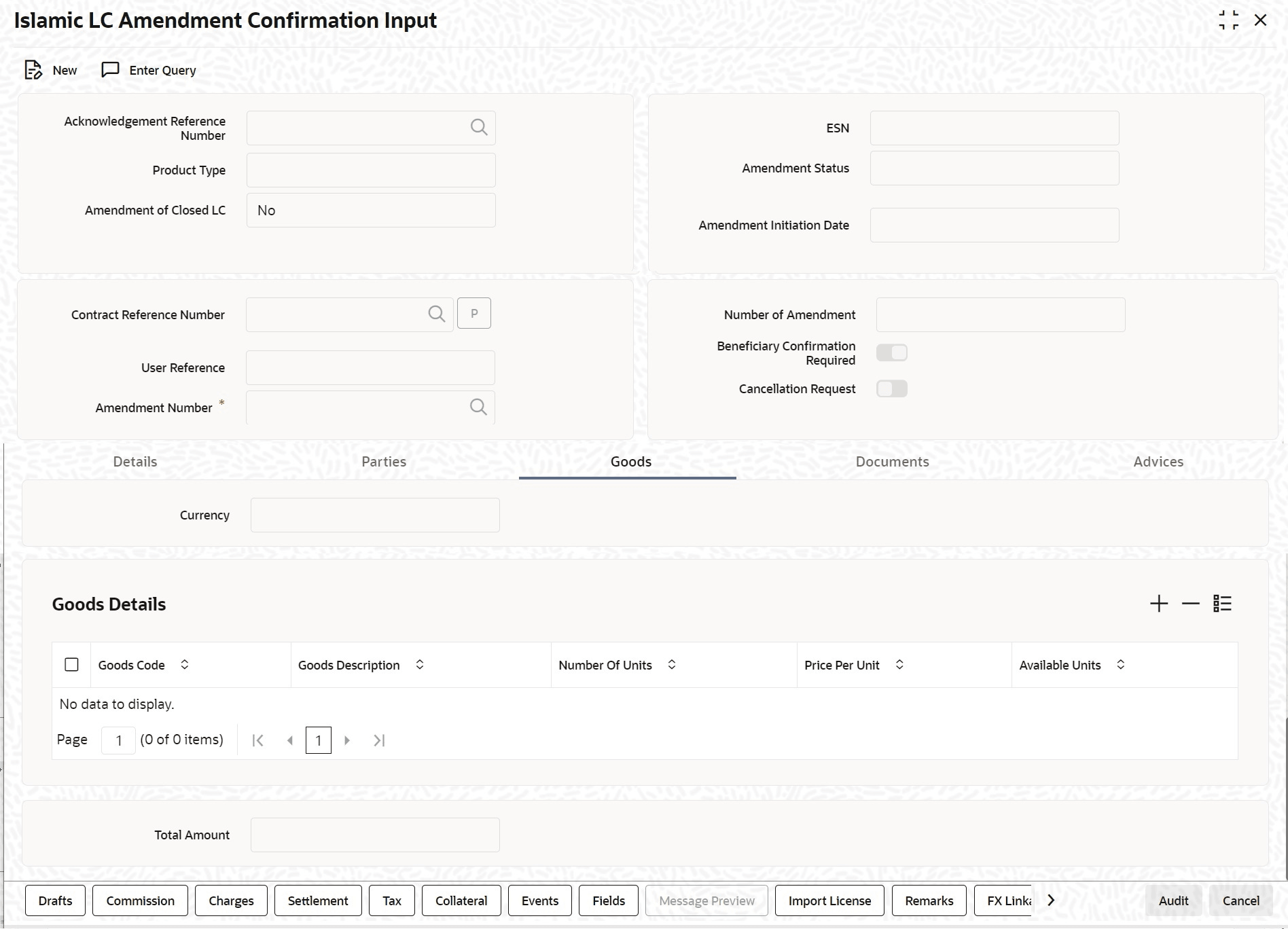

  6. On the Islamic LC Amendment Confirmation Input screen, click the Goods tab.
    The Goods Details is displayed. The Goods tab maintains multiple goods details.
  7. Click on add icon to add the goods details.
    A new row is added. You can specify the goods details. For more information on the fields, refer the Field Description table given below:
    Table 7-3 Goods- Field Description
    Field Description
    Currency The system displays the currency by default once you select the contract reference number.
    Goods Details Specify the Goods Details:
    Goods Code Select the Goods Code from the list provided.
    Goods Description The system displays the description of the Goods.
    Number of Units The system displays the number of units.
    Price Per Unit The system displays the price per unit.
    Available Units The system displays the available units of the goods.

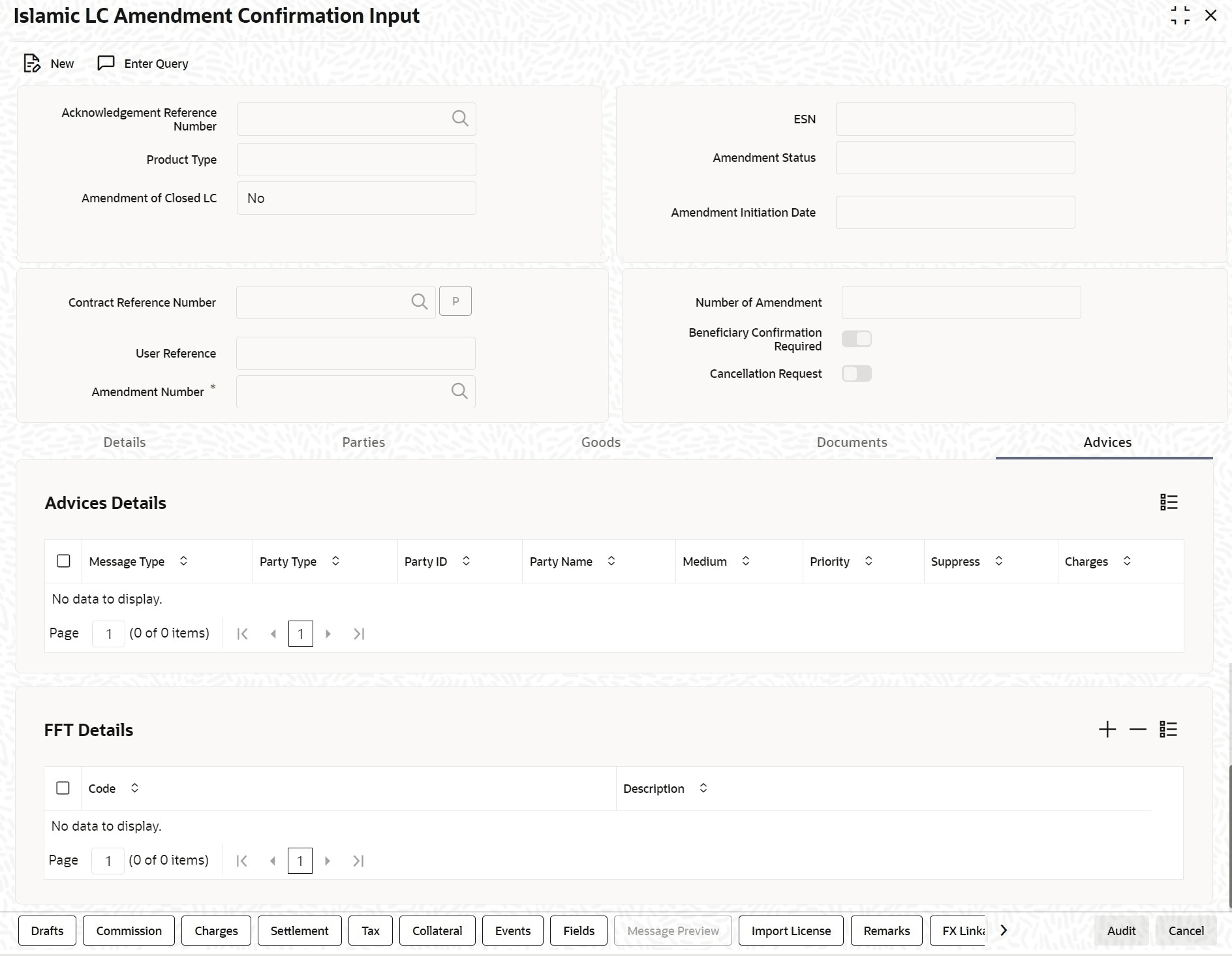

  8. On the Islamic LC Amendment Confirmation Input screen, click Advices.
    Islamic LC Amendment Confirmation Input screen with Advices tab details is displayed.
    Figure 7-4 Islamic LC Amendment Confirmation Input screen - Advices
    Description of Figure 7-4 follows
    Description of "Figure 7-4 Islamic LC Amendment Confirmation Input screen - Advices"
  9. On the Advices screen, specify the details as per requirement
    Table 7-4 Advices - Field Description
    Field Description
    Message type Check the box to view the advice details.
    Party type The system displays the party type for which the advice is generated.
    Party Id The system displays the party id for which the advice is generated.
    Party Name The system displays the name of the party for which the advice is generated.
    Medium The system displays the medium through which the advice is sent. The user can select a different medium from the list. If the medium is modified, the user must provide the new address in the ‘Other Addresses’ section, in the ‘Parties’ tab.
    Priority The system displays the priority of sending the advice. However, you can change the priority.
    Suppress The system displays if the advice is suppressed or not. However, you can edit this field.
    Charges The system displays the charges involved. However, you can edit the charges.
    FFT Details The user can select a message from the ‘Advices Details’ section and associate a code and a description to it.
    Code The user can select the appropriate code from the adjoining option list.
    Description The system displays the description of the selected code. However, you can modify this description.
    Advices for a party are sent to the default media maintained in the Customer Addresses table. However, you can send the advices through a different medium by doing the following:
    • Maintaining media details in ‘Other Address’ in Parties screen
    • Indicating the medium in the Advices screen
    • Suppressing the Advices which is ‘N’ by default.

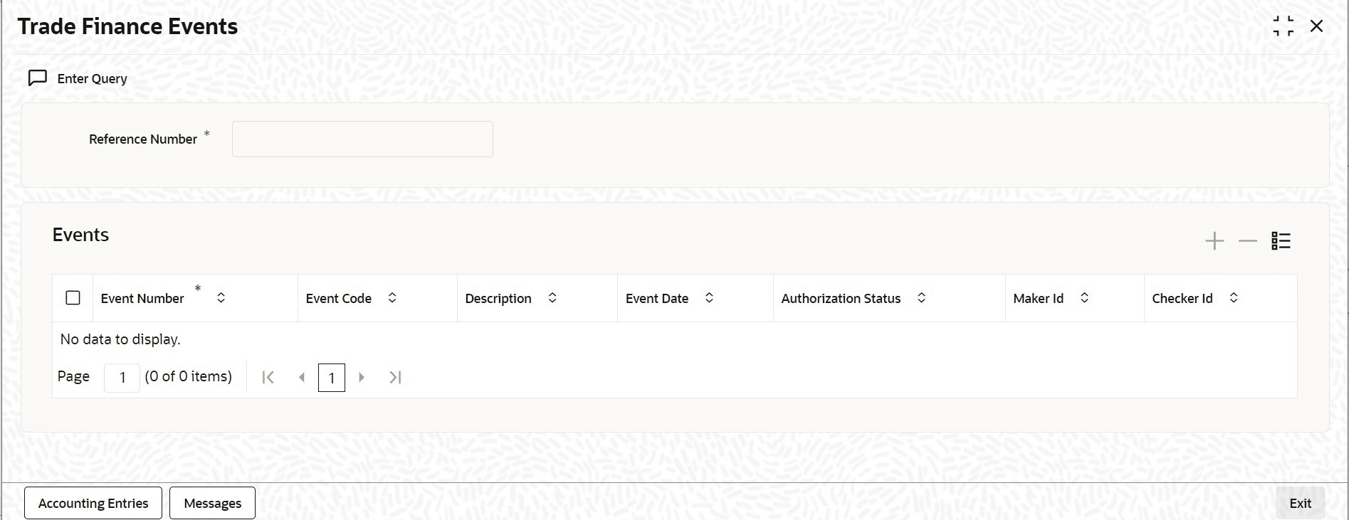

  12. On the Islamic Letters of Credit Amendment Confirmation Input screen, click Events.
    The details of events that have already taken place on the contract are displayed, along with the date on which the event took place.
    Main screen with Events details is displayed.

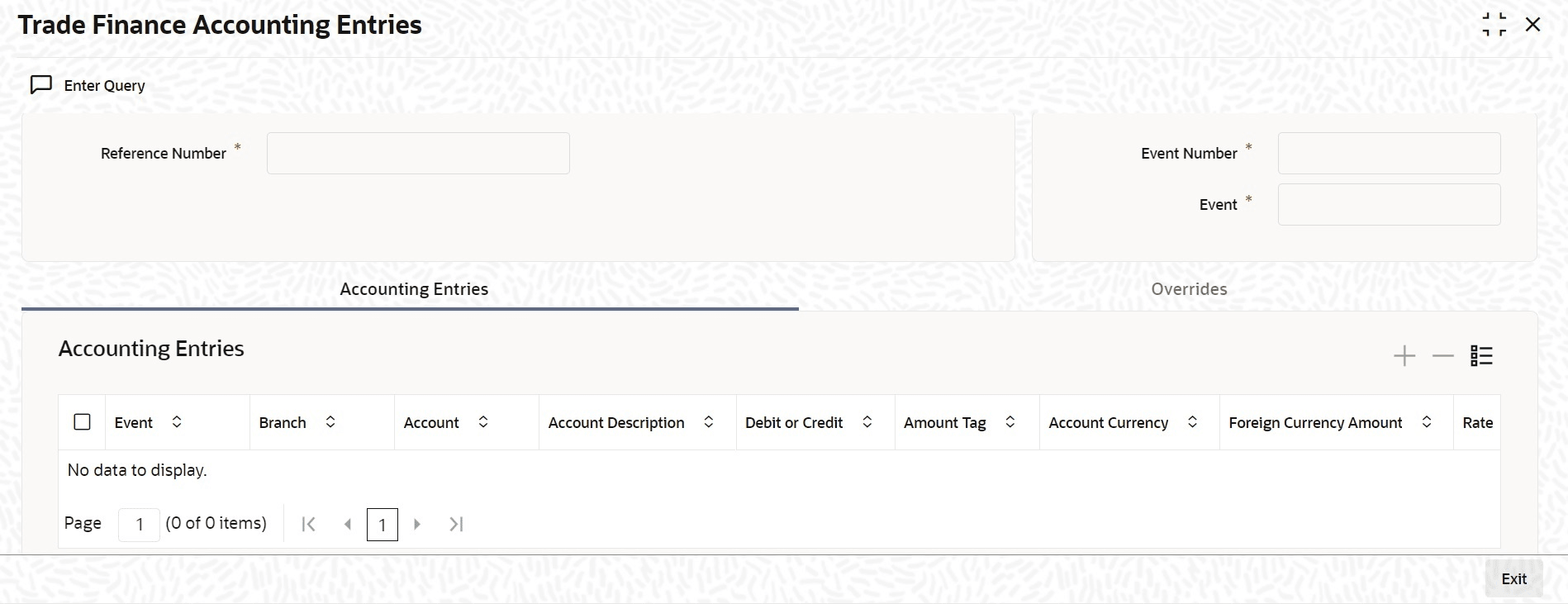

  13. On the Events Screen, click Account Entries.
    Accounting Entries for the Event that is highlighted is displayed.
    Accounting Entries screen is displayed.
  14. View the Details as per Requirement.
    The following information is provided for each event:
    • Branch
    • Account
    • Transaction Code
    • Booking Date
    • Value Date
    • Dr/Cr indicator
    • Currency
    • CCY (Currency)
    • Amount in contract CCY
    • Amount in local currency
    • All the overrides that were given for an event will also be displayed.

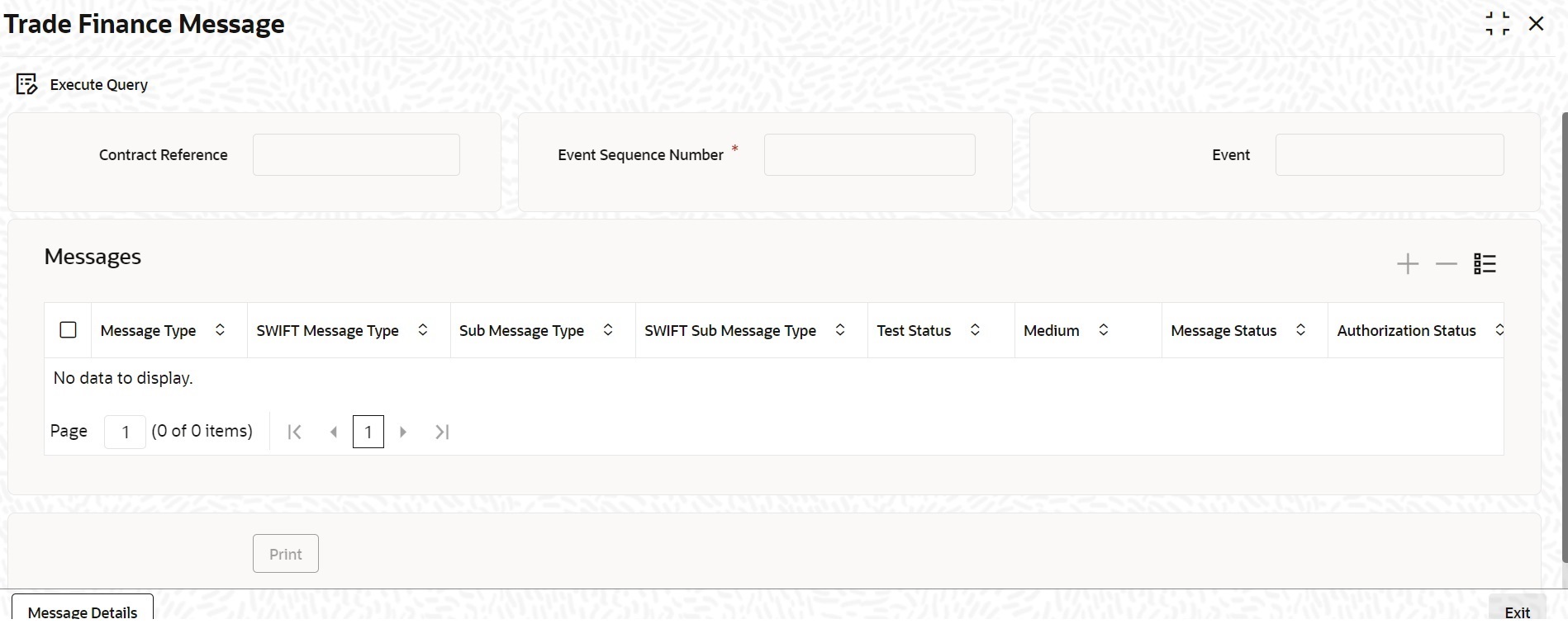

  15. On the Main Screen, click Message.
    List of advices applicable to a particular event in the lifecycle of Islamic LC is displayed.
    Message screen with messages applicable to the event is displayed.
  16. View the Details as per Requirement.
    • The message type
    • The Name and ID of the recipient of the message
    • The status of the message
  17. Click Ok to save the details OR Exit to close the screen.

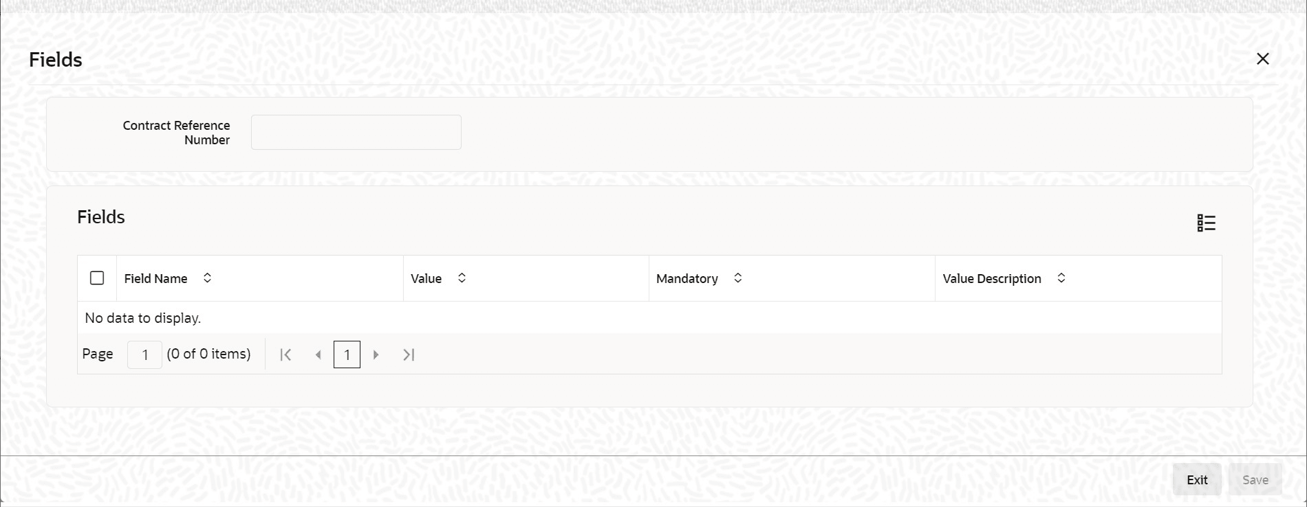

  18. On Islamic Letters of Credit Amendment Confirmation Input screen, click Fields.
    Fields screen is displayed.

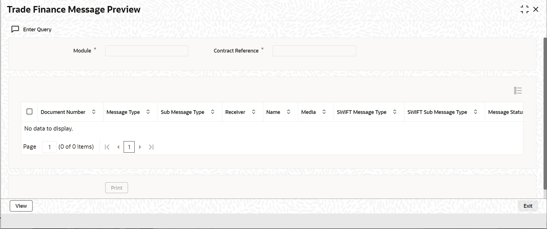

  23. On Islamic Letters of Credit Amendment Confirmation Input screen, click Message Preview.
    Message Preview screen is displayed.
  24. On the Message Preview screen, specify the details as required.
    For the contract, you can view the following details of the messages:
    • The document number generated for the message/advice
    • Type of message generated for the event
    • Customer ID of the receiver of the message/advice
    • Name of the receiver of the message/advice
    • Media of transmitting the message/advice (Mail/SWIFT)
    • SWIFT message type of the message
    • Status of the message/advice
    You cannot preview the message if the contract has been authorized. The ‘Message Preview’ is disabled in that case.
