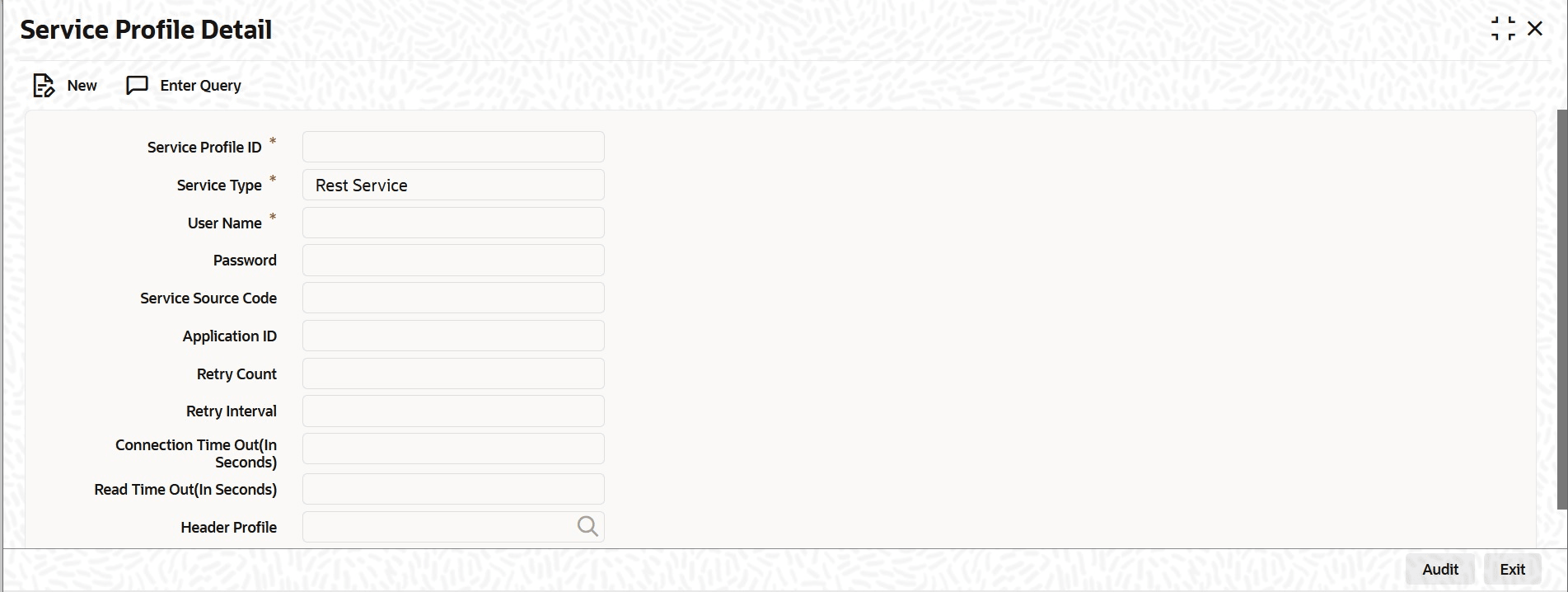

Service Profile ID (PMDSPROF):
Create a Service Profile ID with Service Type as 'Webservice' in Service Profile ID (PMDSPROF) maintenance.
Figure 1-10 Service Profile Detail

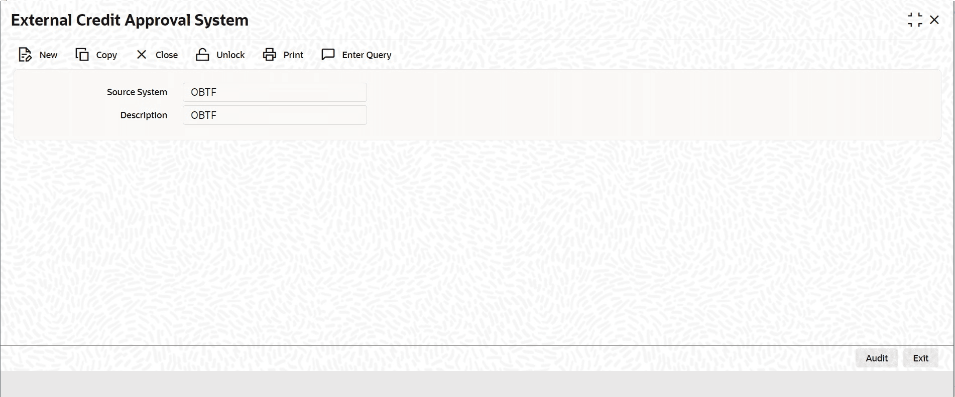

ECA System Maintenance (STDECAMT)
Create External Credit Approval Check system as 'OBTF' in STDECAMT screen.
Figure 1-11 External Credit Approval System

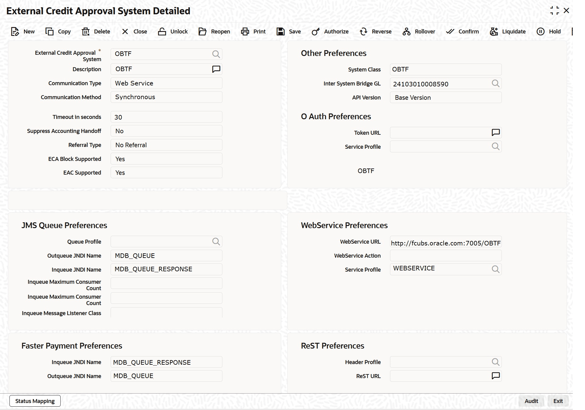

External Credit Approval System (PMDECAMT)
Maintain External Approval System details for the ECA system 'OBTF' in the PMDECAMT.
  • ECA System Class should be ‘OBTF
  • Inter System Bridge GL should be with appropriate value. It should be in same as interbridge GL maintained at OBTF product processor in function id “IFDTFEPM – Trade Finance External System Maintenance”.
  • Communication Type should be ‘Webservice’
  • Communication Method should be ‘Synchronous’
  • Webservice URL should contain the URL of OBTF system where EAC check will be done. (E.g. http://<URL>/OBTFEPSService/OBTFEPSService?WSDL)
  • Service Profile should be the ‘Webservice’ type Service profile created.
    Figure 1-12 External Credit Approval System Detailed

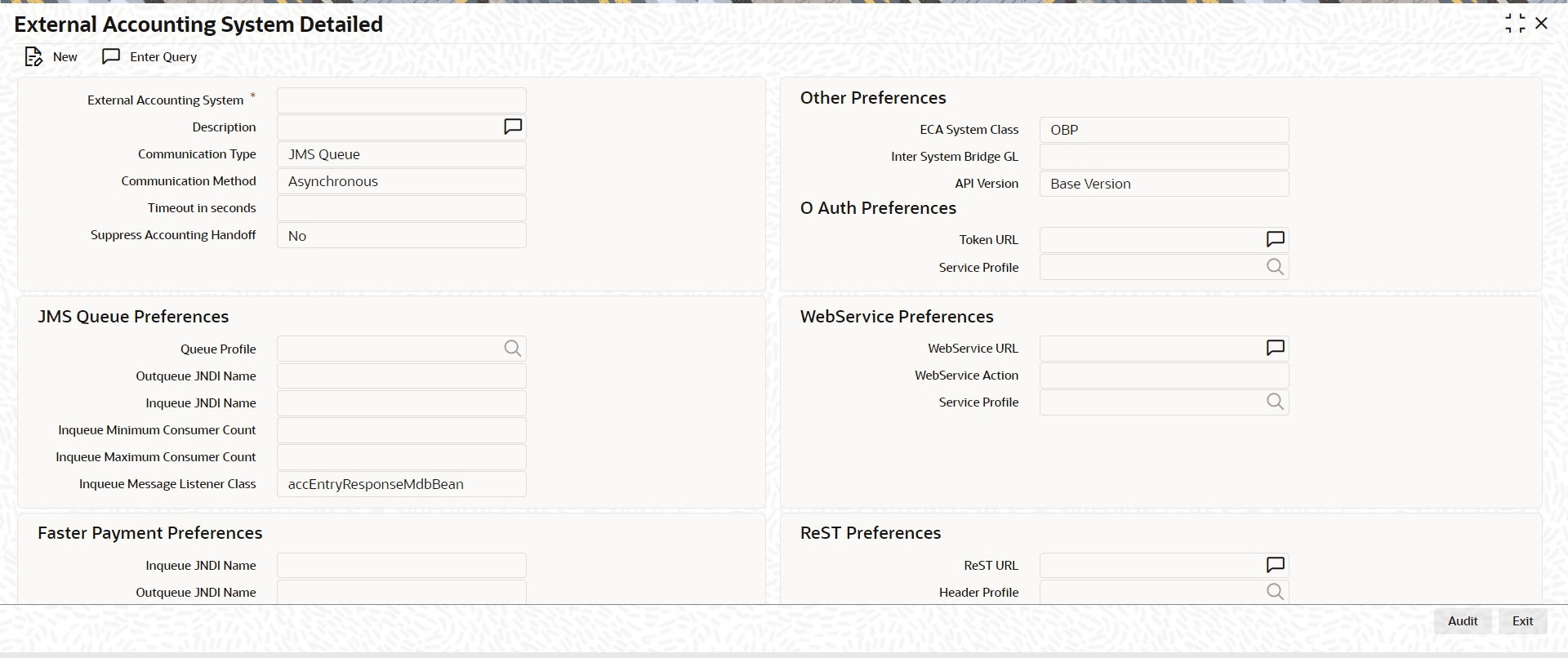

External Accounting System Detailed (PMDACCMT)
Maintain the accounting system as 'OBTF' in PMDACCMT
  • Webservice URL should contain the URL of OBTF system where accounting will be done.
  • Service Profile should be the Webservice profile created.
  • Account System Mapping to be done based on the requirement.

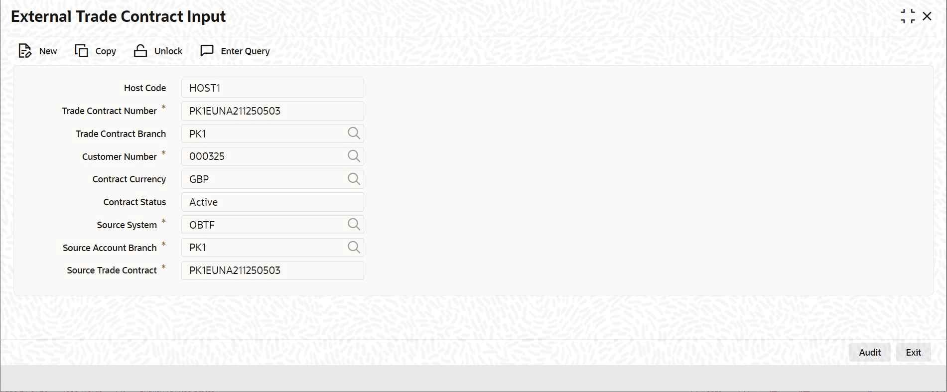

External Trade Contract (STDCRTRD)
Replicate Trade contacts for which the payment message will be received in the External Trade Contract (STDCRTRD) maintenance.

On export bill creation Bill related details will be exposed to common core system screen External Trade Contract Input (STDCRTRD) using common core service FCUBSCoreentitiesService and operation CreateExternalTrade. OBPM system uses the common core External Trade Contract Input data for an Incoming MT202 to Bills.

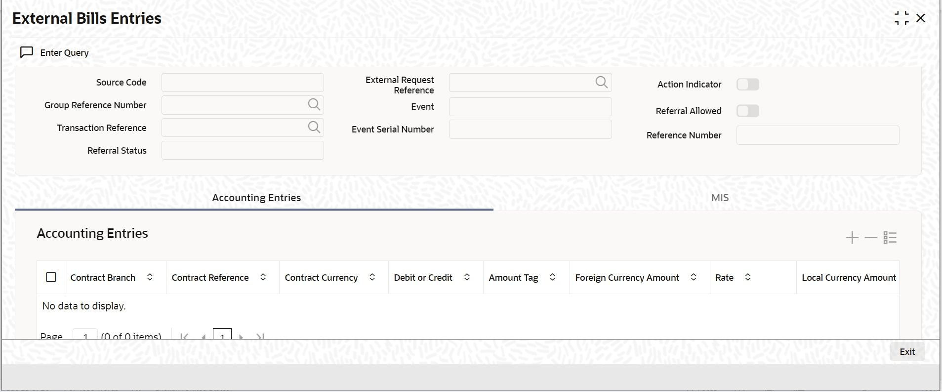

You can view the details of external bill entries through ‘External Bill Entries’ screen. You can invoke this screen by typing ‘IFDEXBIL’ in the top right corner of the Application toolbar and clicking the adjoining arrow button.

Existing accounting entries on liquidation events continues where as it debits bridges GL and credits customer account.
Click Accounting Entries to view the accounting entries for the external bill event.
The details of the accounting entries that were passed for the event are viewed here. The accounting entries that are passed depend on the type of bill processed.
The following information is provided for account entries:
  • Contract Branch
  • Contract Reference
  • Contract Currency
  • Debit or Credit
  • Amount Tag
  • Foreign Currency Amount
  • Rate
  • Local Currency Amount
  • Date
  • Value Date
  • Event
  • All MIS details that were allowed will also be displayed.

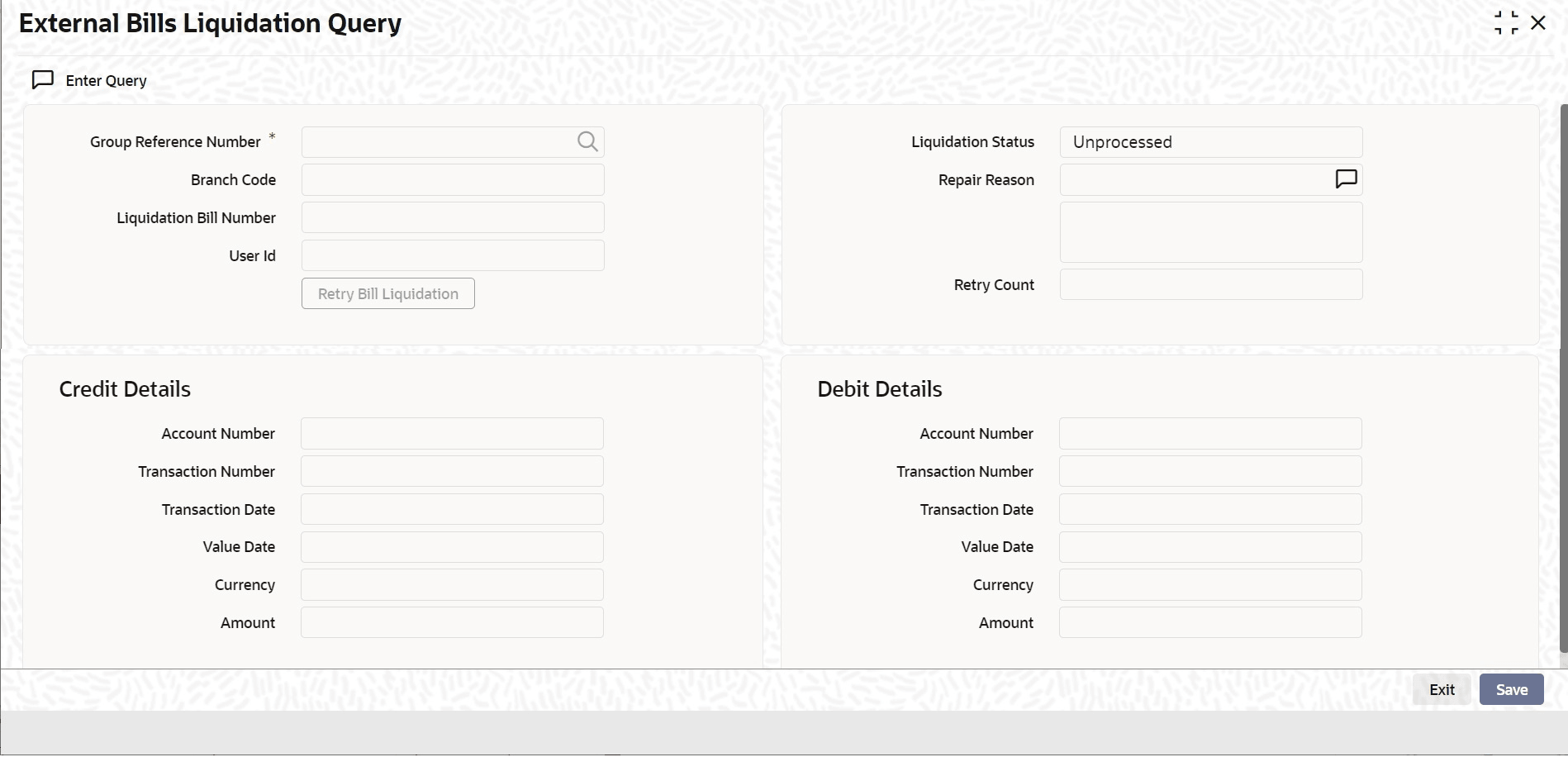

External Bill Liquidation Query and Retry
External Bill Query screen allows the user to resolve the technical failures in case of EA request.
Whenever an EA request is received from Payments through GW Webservice, Liquidation gets triggered by OBTF.
If Liquidation triggered by OBTF did not processed successfully, then retry liquidation provided in IFDEXLIQ to be enabled for repaired process records.
On click of retry liquidation external liquidation to be triggered automatically till the retry count provided in "Bills Branch Parameter maintenance” screen.
If external liquidation from external system is failed corresponding Bill should not be allowed for further operations except Query and Copy.
You can view the details of bill liquidation request through ‘External Bill Liquidation Query’ screen. You can invoke this screen by typing ‘IFDEXLIQ’ in the top right corner of the Application toolbar and clicking the adjoining arrow button.Description of ifdexliq.png follows
Liquidation Status
The system displays the liquidation status. The list displays the following options:
Liquidation Status Description
Un Processed Bill liquidation is pending for processing
Processed Bill liquidation processed successfully
Processing Failed Bill liquidation processing failed due to unexpected failure
Improper Notification Bill liquidation received is not in proper format
Empty Notification Bill liquidation notification received
