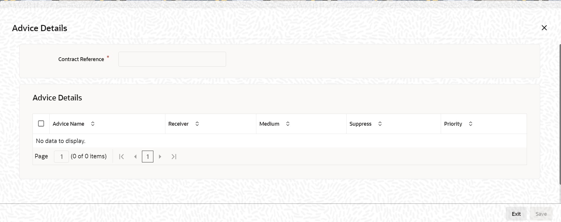

Advices Click this button to define the advices that will be generated for the availment.

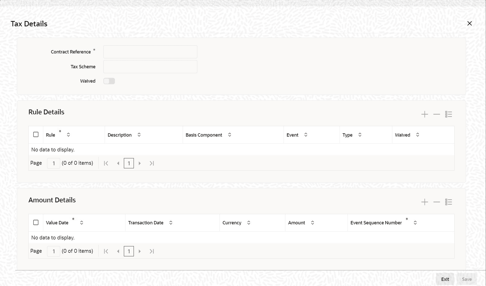

Tax This button invokes the availment tax services. The tax details applicable for the availment will be shown and you can choose to waive it, if necessary. The chapter titled Processing Tax for LCs details the procedure of maintaining tax rules and schemes. It also deals with the linking and application of the scheme on an availment.

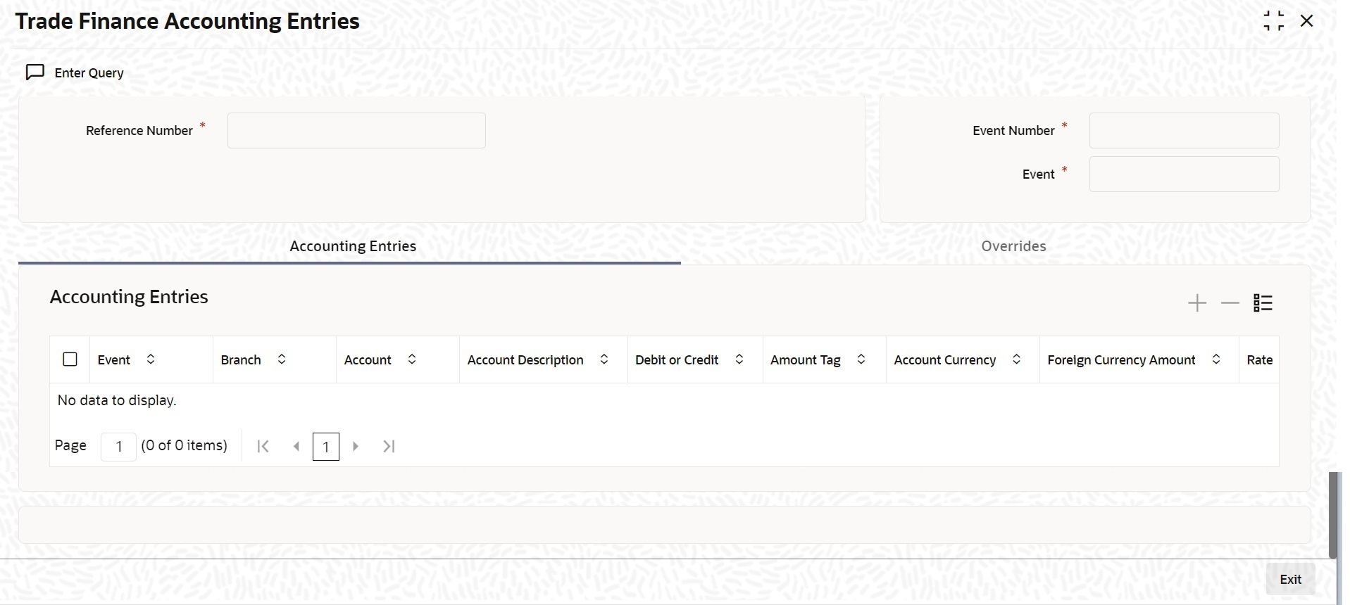

  3. On the Trade Finance Events screen, click the Accounting Entries.
    You can view the details of the accounting entries that were passed only for the event displayed in the availment.
    Figure 5-3 Trade Finance Accounting Entries
    The following information is provided for each event:
    • Branch
    • Account
    • Account Description
    • Transaction Code
    • Debit or Credit
    • Amount Tag
    • Rate
    • Account Currency
    • Foreign Currency Amount
    • Local Currency Amount
    • Value Date
    • Date
    All the overrides that were allowed for an event will also be displayed.
    The system will display an override message if the date when the availment is made i.e. the value date of the availment falls after the expiry date for the LC issued. You may use your discretion to proceed or cancel the contract. You can also have this override configured as an error message in which case, the system will not allow you to proceed until you make the necessary changes.
  4. Click Exit or Cancel button to return to the Accounting Entries screen.

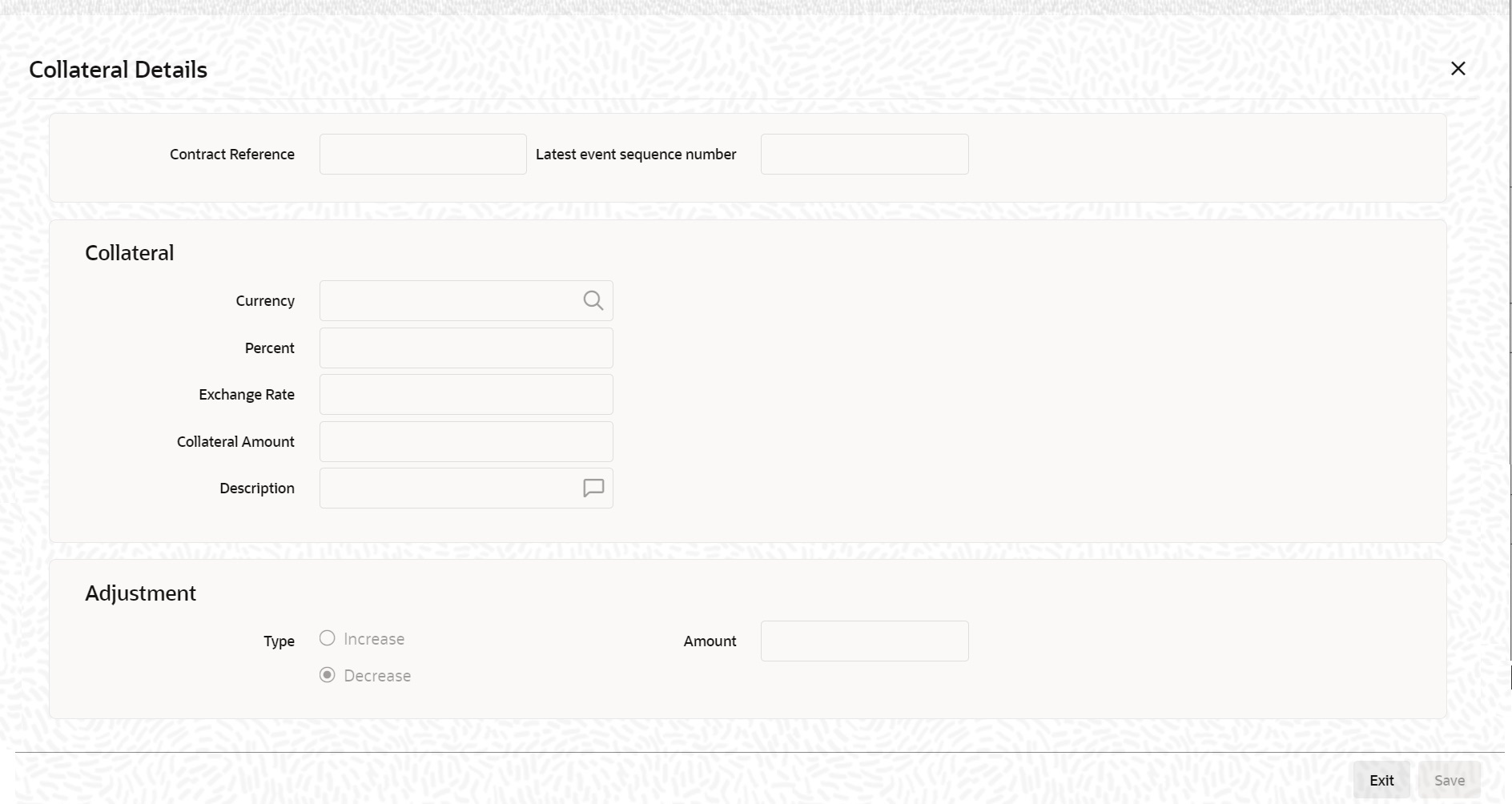

  5. On the Letters of Credit Availment Detail screen, click the Collateral button.
    You can specify the adjustments that you want to make, on the cash collected as collateral.
    If the LC that you are processing has been backed by cash collateral, you can specify the cash collateral to be released as a result of the availment.
    By default, the collateral amount proportional to the amount availed will be adjusted automatically. This default amount can be reduced or increased.
    For more information on fields, refer the Field Description table:
    Table 5-3 Collateral Details - Field Description
    Field Description
    Contract Reference The system displays the contract reference number.
    This field is optional.
    Latest Event Sequence Number The system displays the latest even sequence number.
    Collateral Details Provide the collateral details:
    Currency The currency of the collateral is displayed here.
    Percent The system displays the percentage of LC amount that should be considered for the collateral amount.
    Exchange Rate The exchange rate to be used in the conversion is displayed here. The value of the collateral is determined based on this exchange rate.
    Collateral Amount The collateral amount is displayed here.
    Description A brief description of the collateral is displayed here.
    Adjustment Details Specify the Adjustment Details.
    Type You can increase the collateral amount that is calculated by default. Choose ‘Increase’ option and enter the amount by which the cash collateral should be increased. You can decrease the collateral amount that is calculated by default. Choose the Decrease option and enter the amount by which the cash collateral should be decreased.
    If you are adjusting the collateral against an availment, you should have defined the appropriate accounting entries for the event code AVAL.
    Not invoking the Cash Collateral screen during the availment session will mean that you do not want to adjust the collateral. This would be so even if you have defined the accounting entries for availment reduction. An override to this effect will be displayed when you save the availment.
    Amount Specify the amount by which the cash collateral should be increased or decreased.
    Not invoking the ‘Collateral’ screen during the availment session will mean that you do not want to adjust the collateral. This would be so even if you have defined the accounting entries for availment reduction. An override to this effect will be displayed when you save the availment.

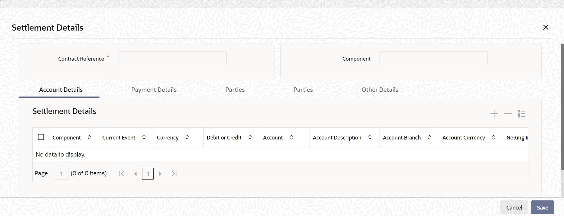

  6. On the Letters of Credit Availment Detail screen, click the Settlement button.
    The Settlement Details screen is displayed.
    Current Event:
    Current event of settlements will be checked for the amount tags pertaining to the current event and will be unchecked for the amount tags not pertaining to the current event.
    Apart from the details of the accounts involved in the availment, you may have to capture party details for messaging requirements. The default settlement instructions for the customer will be shown in the Settlement Details screen. You can modify them. The accounts involved could be the settlement account for the availment amount, charges and tax, if they are applicable.
  7. On the Settlement Details screen, click the Account Details tab.
  8. Specify the field details and click Ok.
    It allows you to enter the tab details.
    Click Account Details tab to specify the details of the accounts involved in the availment. The accounts and amount involved in the Debit and Credit legs of the accounting entry, for the availment amount will be displayed in the Account Details screen. These details cannot be changed here. If a change is necessary, the same would have to be specified in the LC Availment screen. For more details on customer specific exchange rates, refer the section titled Specifying Pricing Benefit Details in Relationship Pricing user manual.
    When settling charges for an LC or a guarantee, you can use a Receivable Account instead of a Customer Account. In such a case, you can send a charge claim advice to the customer.
    Table 5-4 Account Details - Field Description
    Field Description
    Component Select the component.
    Currency The system displays the currency by default.
    Debit or Credit The default settlement instructions for the customer will be shown in the Settlement Accounts screen. The default can be modified.
    The direction of settlement indicates whether the account being shown, will be debited or credited:
    P - Indicates Pay, meaning that the account should be credited
    R - Indicates Receive, meaning that the account should be debited
    Account The system displays the account details.
    Account Description The system displays the account description.
    Account Branch The system displays the account branch.
    Account Currency The system displays the account currency. The exchange rate to be used in the conversion is displayed here. The value of the collateral is determined based on this exchange rate.
    Netting Indicator Check this box to indicate that you would like to enable the Netting option for the various components (Amount Tags) involved in the transaction. These components could be commission, interest, tax, charges etc.
    Rate Code Select the Rate Code from the drop-down list. The available options are
    • Buy
    • Mid Rate
    • Sell
    Spread Definition
    Select the Spread Definition from the drop-down list.
    • Point
    • Percentage
    Customer Spread Specify the customer spread.
    Original Exchange Rate The base or the actual exchange rate between the contract currency and collateral currency gets displayed here.
    Exchange Rate It is the customer specific exchange rate derived by adding the original exchange rate and the customer spread (applicable for Relationship Pricing customers). If Relationship Pricing is not applicable, the Exchange rate will be the same as the Original Exchange rate.
    Negotiated Cost Rate Specify the negotiated cost rate.
    Negotiation Reference Specify the negotiated reference.
    Generate Message Settlement messages, defined for components that fall due, will be generated automatically when you the Settlement Generation function at the End of Day. To suppress the generation of the settlement message defined for a component, uncheck the Gen Message field of the Contract Settlement Message Details screen.
    IBAN Account Number Select the IBAN Account Number from the list.
    Euro In Currency SWIFT messages (MT 100/MT 202) generated towards settlement, can furnish the value of the settlement amount in the settlement account currency and in the ERI currency.
    The system defaults to the ERI currency specified for the customer and currency combination. The default ERI currency can be changed.
    Euro In Amount If you choose to furnish the ERI value of the amount, you have to enter the following in the Settlement Message Details screen:
    The ERI currency
    The ERI Amount
    If you choose to furnish the ERI value of the amount, you have to enter the following in the Settlement Message Details screen: The ERI amount will be validated against the Tolerance Limit, specified for the ERI currency.
    On 1 January 1999, eleven countries that are part of the European Union embarked on the first phase of economic integration, called the ‘Economic and Monetary Union’ (EMU). The EMU ushered in a new, single European currency: the Euro (EUR). The Euro, in Oracle Banking Trade Finance, can be handled by capturing information such as the ERI details, in this screen.

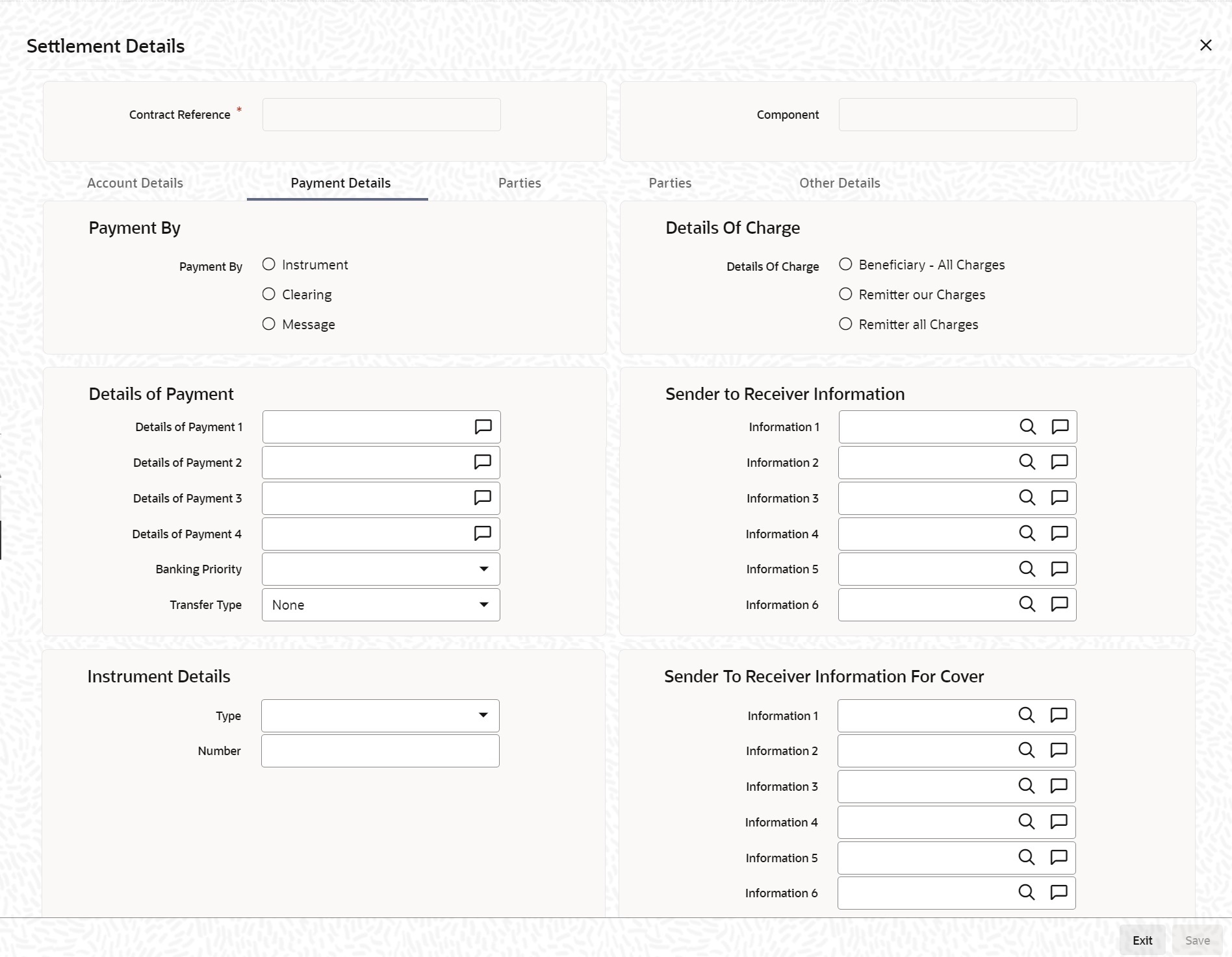

  9. On the Settlement Details screen, click Payment Details tab.
    The Payment Details screen is displayed.
    A Letter of Credit can be settled either in the form of an instrument or a Message (a SWIFT, TELEX or Mail message to be sent to the concerned party). The details regarding the instrument or message have to be specified in the Payment Details screen. The payment details that you specify in this screen are applicable only for SWIFT. The type of SWIFT message that is generated depends on the parties involved in the LC.
  10. On the Payment Details screen, specify the method of settling the LC.
    You should input either Instrument or Payment details. For more information on fields, refer the Field Description table given below:
    Table 5-5 Payment Details - Field Description
    Field Description
    Instrument Details Specify the following details.
    Instrument Type If the payment is through an instrument, indicate the type of instrument. It could be Manager’s Check, Check or a Demand Draft.
    Number Specify the number that will identify the instrument. This number will be printed on the instrument. If the settlement is through an instrument, the party details cannot be specified for the transfer.
    Typically, an LC availment entails the debiting or crediting of the customer account, for the settlement amount. If the customer is being credited (in the case of your customer being the beneficiary, of the availment,) you may want to generate an instrument.
    Details of Charges Specify who should bear charges for the message. Choose one of the following options:
    • Remitter all Charges
    • Beneficiary all Charges
    • Remitter our Charges
    Message Details For a SWIFT message, you have to specify the following.
    Cover Required Check this box to indicate that a Cover has to be sent to the Reimbursement Bank, along with the payment message to the receiver.
    Details of Payment 1 to 4 Specify bank to bank payment details (these can be in the form of instructions or additional information to any of the parties involved in the transfer).
    Sender to Receiver Information 1 to 6 Tag 72 will be used to specify the sender to receiver information. This tag is applicable to MT740 message type.
    RTGS Payment Check this box to indicate the payment mode is RTGS.
    RTGS Network Specify the RTGS Network used for the transaction.
    Transfer Type Specify the type of transfer. It can be any one of the following:
    • Bank Transfer
    • Customer Transfer
    • Bank Transfer for own A/c
    • Direct Debit Advice
    • MCK
    • Customer transfer with cover
    • None
    Banking Priority Indicate the priority for the payment. Choose any one of the following options:
    • Highly Urgent Payments
    • Urgent Payment
    • Normal Payment

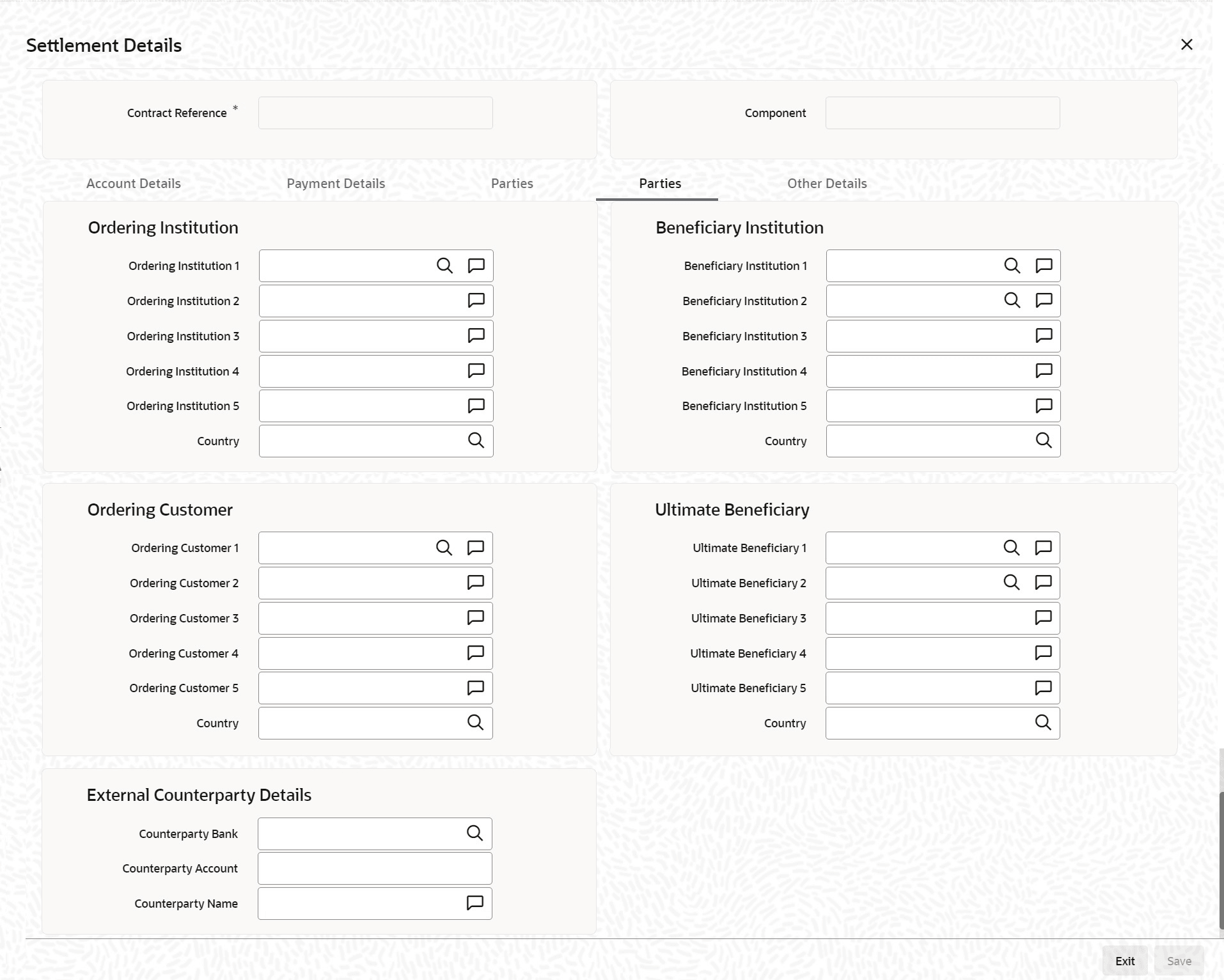

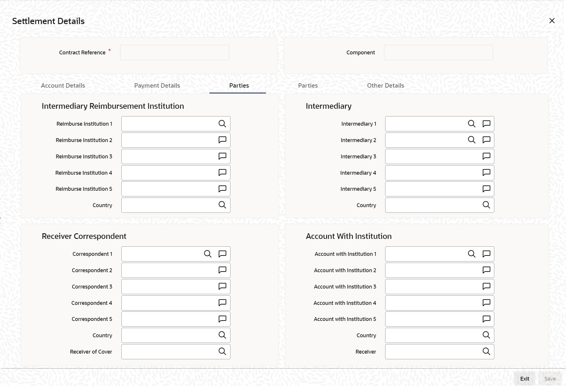

  11. On the Settlement Details screen, click the Parties tab.
    The Parties screen is displayed.
    To process an availment on an LC, the funds may have to pass through a series of banks, before it actually reaches the Ultimate Beneficiary. Through the Parties screen you can capture details of all the parties that are involved in the transfer of funds. The details you enter in these screens depend on the type of LC being processed. An Intermediary Reimbursement Institution is the financial institution between the Sender’s Correspondent and the Receiver’s Correspondence.
  12. On the Settlement Details screen, click the Parties tab.
    An Intermediary Reimbursement Institution is the financial institution between the Sender’s Correspondent and the Receiver’s Correspondence. For more information on the fields, refer the Field Description table.
    Table 5-6 Parties1 - Field Description
    Field Description
    Reimburse Institution 1 to 5 Specify the institution through which reimbursement of the funds should take place.
    Intermediary 1 to 5 The Intermediary in a LC refers to the financial institution, between the Receiver and the Account With Institution through which the funds must pass. The Intermediary may be a branch or affiliate of the Receiver or the account with Institution or an altogether different financial institution. This field corresponds to field 56a of S.W.I.F.T. Here you can enter either the:
    • ISO Bank Identifier Code of the bank
    • Name and address of the bank
    Receiver’s Correspondent 1 to 5 The Receiver’s Correspondent is the branch of the Receiver or another financial institution, at which the funds will be made available to the Receiver. This field corresponds to field 54a of SWIFT. You can enter one of the following:
    • The branch of the Receiver’s Correspondent
    • Name and address of the Receiver’s Correspondent
    Account With Institution 1 to 5 An Account With Institution refers to the financial institution at which the ordering party requests the Beneficiary to be paid. The Account With Institution may be a branch or affiliate of the Receiver, or of the Intermediary, or of the Beneficiary Institution, or an entirely different financial institution. This field corresponds to field 57a of SWIFT.
    Receiver of Cover You can enter one of the following: ISO Bank Identifier Code of the bank

  13. On the Settlement Details screen, click the Parties tab.
    The Parties details is displayed.
    Figure 5-8 Parties 2- Field Description
    For more information on the fields, refer the Field Description table given below:
    Table 5-7 Parties 2- Field Description
    Field Description
    Ordering Institution 1 to 5 The Ordering Institution is the financial Institution that is acting on behalf of itself, or a customer, to initiate the transaction. This field corresponds to 52a of SWIFT. In this field, you can enter one of the following:
    • The ISO Bank Identifier Code of the Ordering Institution
    • The branch or city of the Ordering Institution
    • The Name and address of the Bank
    Beneficiary Institution 1 to 5 In this field you can enter details of the institution in favor of which the payment is made. It is in reality the bank that services the account of the Ultimate Beneficiary. This field corresponds to field 58a of SWIFT.
    Entries into this field are permitted only for Bank Transfers (when the remitter and beneficiary of the transfer are financial institutions - MT 100 or MT 202). Here you can enter either of the following:
    • The ISO Bank Identifier Code of the Beneficiary Institution
    • The Name and Address of the Beneficiary Institution
    Ultimate Beneficiary 1 to 5 The Ultimate Beneficiary refers to the Customer to whom the availment amount is to be paid. This field refers to field 59 of SWIFT. Entries into this field are permitted only for a customer transfer (MT 100 and MT 202). The number of banks involved in the transfer would therefore depend on the following:
    • Relationships and arrangements between the sending and receiving banks
    • Customer instructions
    • Location of parties
    • The banking regulations of a country
    Beneficiary Institution For Cover 1 to 5 Select the institution in favor of which the payment is made, from the option list. If you click on the button, a notepad editor emerges. You can specify further details about the institution here. This field is optional.
    Counterparty Bank The clearing bank code here gets populated with the value specified in the contract screen. However you can change it. Select the relevant clearing bank code from the option list.
    Counterparty Account Specify the counterparty account. All the counterparty accounts pertaining to the selected Counterparty Bank will appear for selection in the adjoining option list. On selecting the Counterparty Account, the system will default the Counterparty Name as maintained for that account.
    If at the time of selecting Counterparty Account, Counterparty Bank is Null, then the Counterparty Bank will also appear by default.
    Counterparty Name Specify the name of the counterparty.
    Agreement Identification For processing direct debits on transactions you will also need to capture the Agreement ID of the counterparty in order to facilitate a cross-referencing between the contract payment and the direct debit instruction when a reversal of payment is carried out due to rejection of the outbound DD. Specify the Agreement ID in this field. Typically, you will need to specify this only for the Receive leg. This field is disabled for the Pay leg.
    Clearing Network Specify a clearing network during settlement instruction maintenance for the Pay Leg.
    Post Accounting Check this option to indicate that accounting entries maintained for the product should be posted.

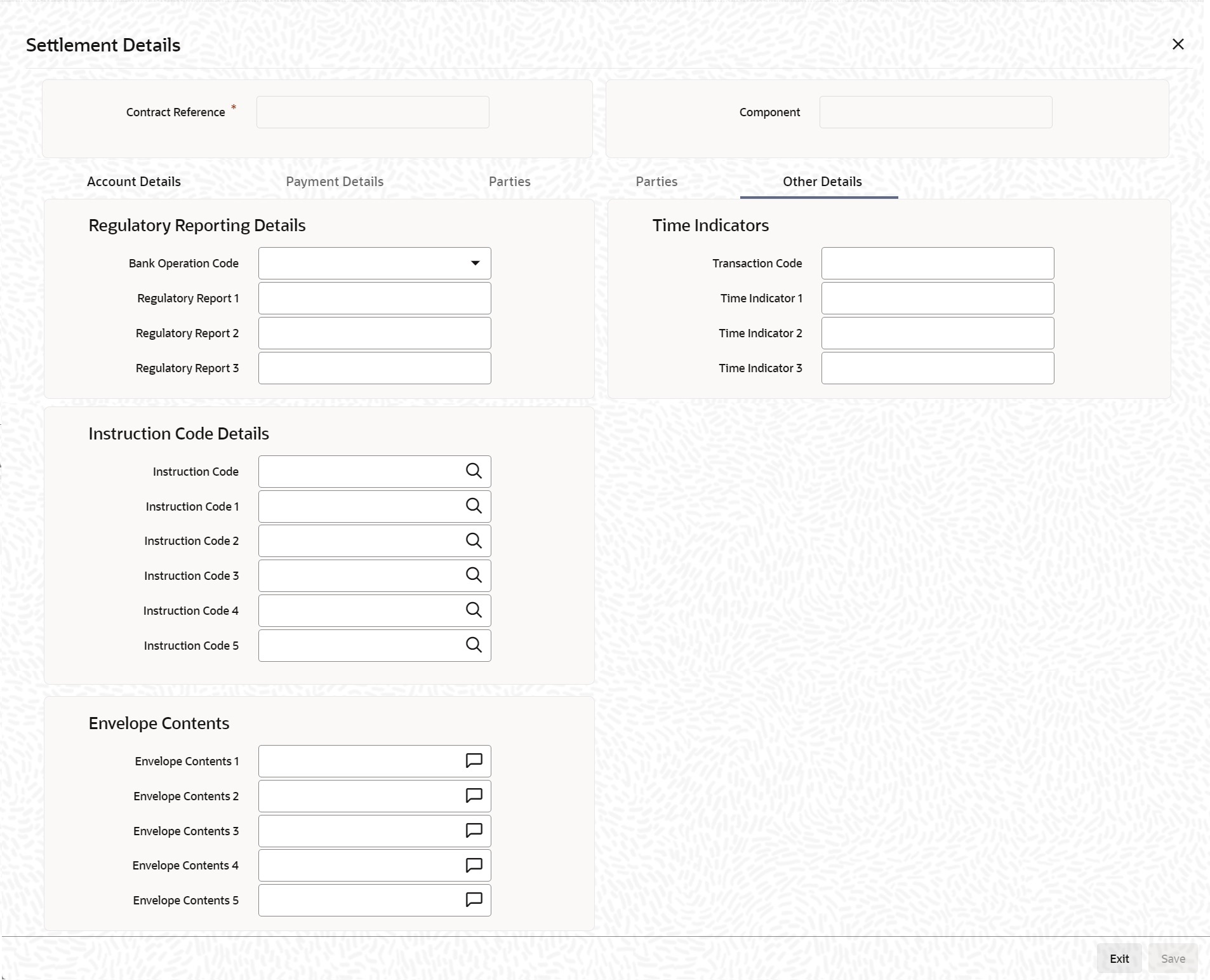

  14. On the Settlement Details screen, click Other Details
    The Other Details is displayed. For more information on the fields, refer the Field Description table given below:
    Table 5-8 Other Details- Field Description
    Field Description
    Bank Operation Code Select the bank operation code that should be inserted in field 23B of an MT103 message, from the adjoining drop-down list. The list contains the following codes:
    • SPRI
    • SSTD
    • SPAY
    • CRED
    This specification is defaulted from the settlement instructions maintained for the customer, currency, product, branch and module combination. However, you can change it.
    Transaction Code The transaction code maintained in the settlement instructions is defaulted here. However, you can change the code.
    Time Indicator 1 to 3 Time Indication, specifies one or several time indication(s) related to the processing of the payment instruction. Select the time indication code from the following values available in the option list:
    /CLSTIME/ - Time by which funding payment must be credited, with confirmation, to the CLS Bank's account at the central bank, expressed in CET.
    /RNCTIME/ - Time at which a TARGET payment has been credited at the receiving central bank, expressed in CET
    /SNDTIME/ - Time at which a TARGET payment has been debited at the sending central bank, expressed in CET
    Instruction Code 1 to 6 Select the instruction code that should be inserted in field 23E of an MT103 message involving the customer of the contract, from the drop-down list. This list contains the following codes:
    • CHQB
    • TELE
    • PHON
    • PHOI
    • REPA
    • INTC
    • TELI
    • SDVA
    • PHOB
    • TELB
    • HOLD
    • CORT
    • BONL
    Description Specify additional information that should be inserted to qualify the Instruction Code in field 23E of an MT103 message involving the customer of the contract. For instance, if the Instruction Code is REPA and the description is “Repayment” then the text ‘REPA/Repayment’ will be inserted in Field 23E. You can give a description for the following instruction codes only:
    • PHON
    • PHOB
    • PHOI
    • TELE
    • TELB
    • TELI
    • HOLD
    • REPA
    This specification is defaulted from the settlement instructions maintained for the customer, currency, product branch and module combination. However, you can change it.
    Envelope Contents 1 to 5 Specify details of envelope contents, if required.
  15. On the Letters of Credit Availment Detail screen, click the Advices button.
    The Advice Details screen is displayed.

  18. On the Letters of Credit Availment Detail screen, click the Tax button.
    The Tax Details screen is displayed.
    Refer the Tax User Manual under Modularity for further details about tax processing.

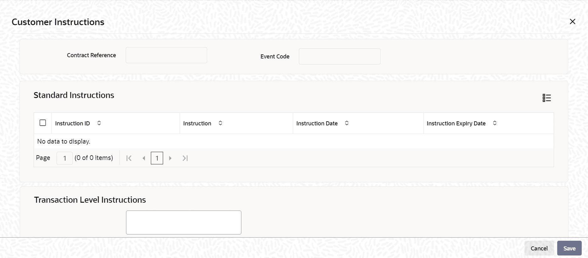

  21. On the Letters of Credit Availment Detail screen, click the Customer Instructions tab.
    The Customer Instructions screen is displayed.
    Table 5-9 Customer Instructions - Field Description
    Field Description
    Contract Reference Number System displays the contract reference number.
    System displays the Event Code of the contract.
    Standard Instructions
    Customer would want to give Standard instructions in advance to the bank that need to be referred by the bank while processing certain type of transactions.
    Instruction ID System displays the Instruction ID.
    Instruction System displays the customer standard instruction.
    Instruction Date System displays the start date of the customer instruction.
    Instruction Expiry Date System displays the expiry date of the customer instruction.
    Transaction Level Instruction Enter the transaction level instructions for the event.
