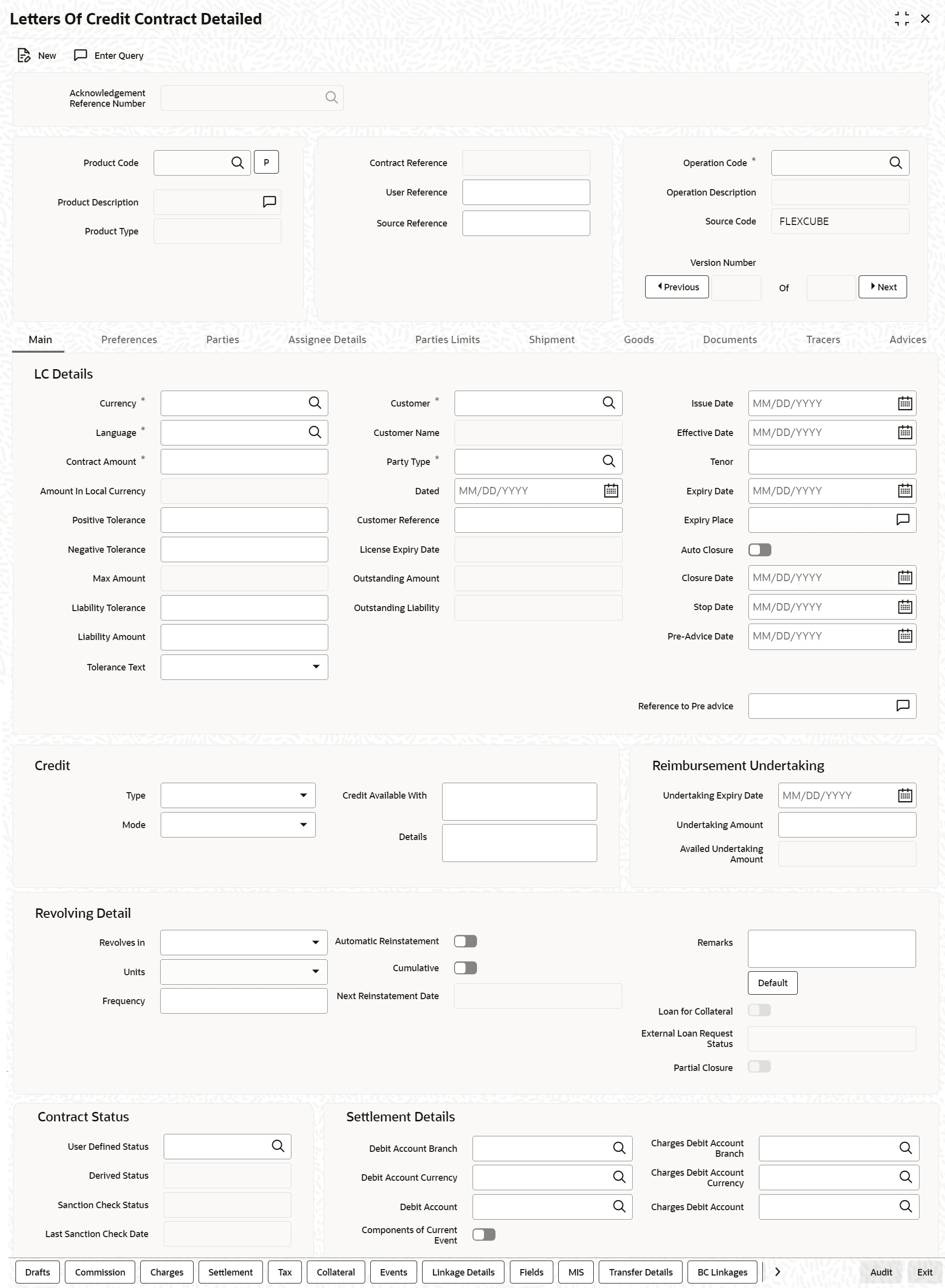

The following LC contract screen is launched when the amendment is confirmed in the LC amendment confirmation input screen.
Figure 6-26 Letters of Credit Contract Detailed
The amendment cannot be deleted using the LC contract screen, and can only be deleted using the amendment screen as part of the confirmation. This is done by deleting the confirmation using the amendment screen.
