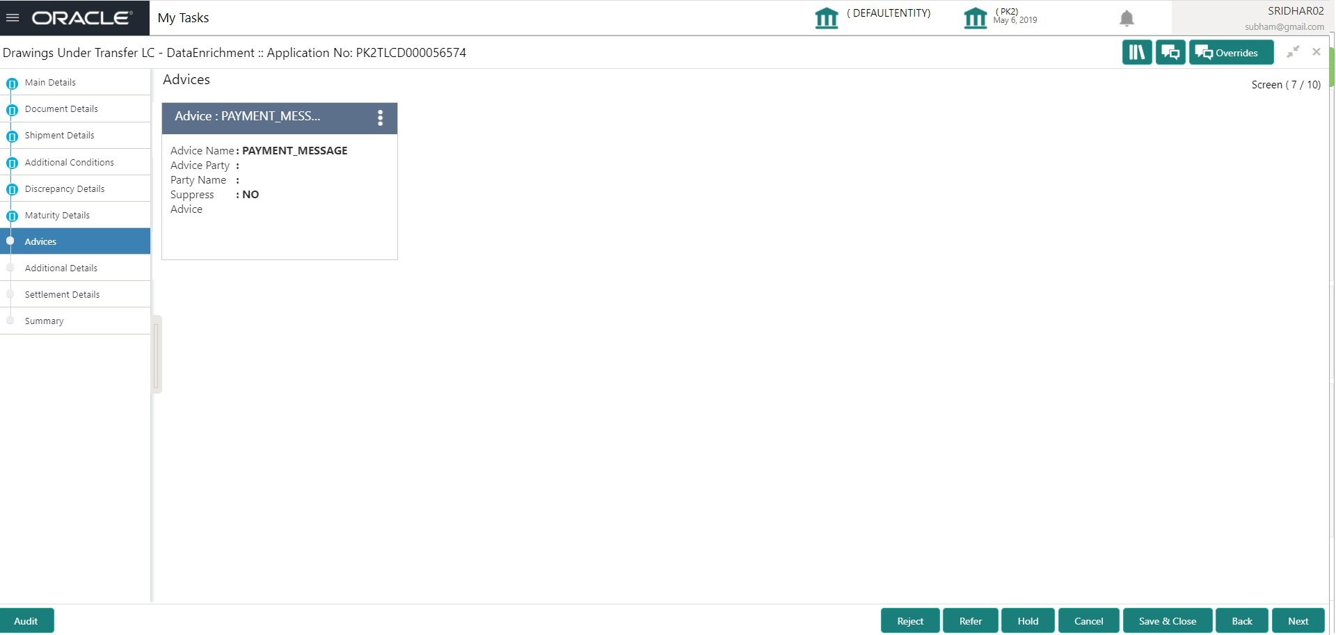

2.3.7 Advices
This topic provides the systematic instructions to capture the advices details.
- On Advices screen, click the 3 dots on any advice tile
to view the advice details.
Figure 2-24 Advices
Description of the illustration deadvices.pngTable 2-22 Advices Details
Field Description Suppress Advice Enable this option to suppress the advice. Disable this option if suppress advice is not required.
Advice Name Read only field. Advice name is defaulted from LC.
Medium The medium of advices is defaulted from the system. User can update, if required.
Advice Party Read only field. The medium of advices is defaulted from the system.
Party ID Read only field. Value be defaulted from LC.
Party Name Read only field. Value be defaulted from LC.
Free Format Text Specify the free format text details.
Click plus icon to add new FFT code. FTT Code Click Search to search and select the FFT Code. FFT Description FFT description is populated based on the FFT code selected.
Click edit icon to edit the existing FFT description. Action Click delete icon to remove any existing FFT code. Click edit icon to edit the existing FFT code.
Instruction Details Specify the Instruction Details details.
Click plus icon to add new instruction code. Instruction Code Click Search to search and select the instruction Code. Instruction Description Instruction description is populated based on the instruction code selected.
Click edit icon to edit the existing instruction description. Action Click delete icon to remove any existing instruction code. Click edit icon to edit the existing instruction code.
- Click Next.The task will move to next data segment.
