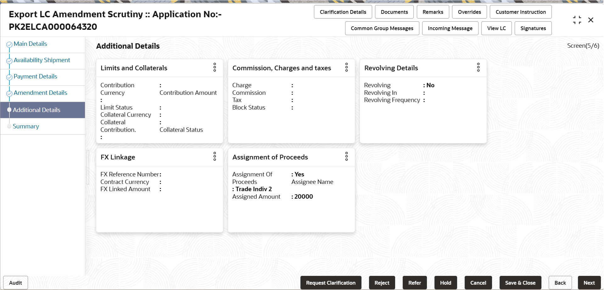

- On Additional Details screen, click
on any Additional Details tile to view the details.Figure 2-12 Additional Details
Description of the illustration scrutinyadditionaldetails.pngLimits and Collaterals
