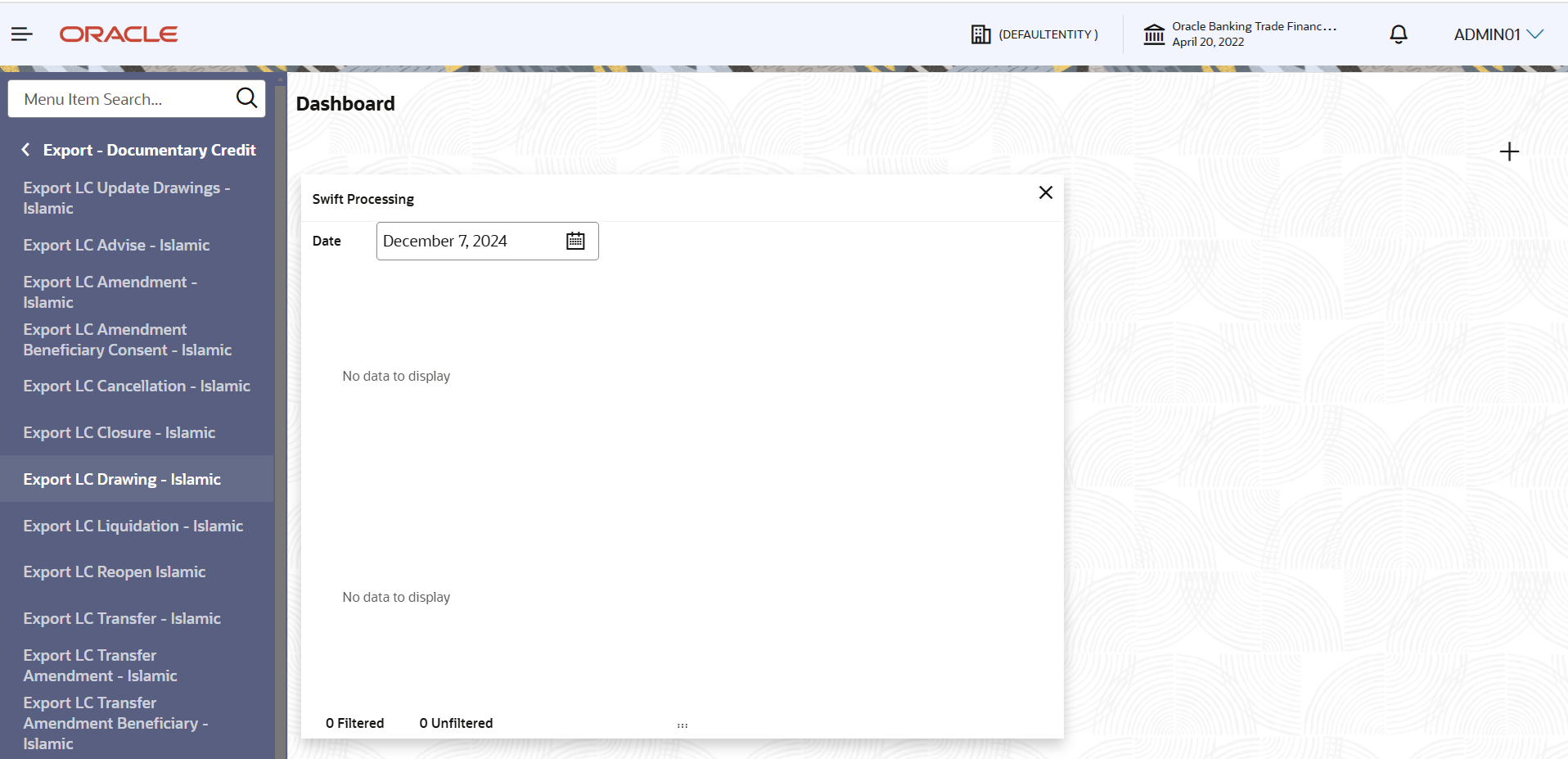

- On Home screen, click Trade Finance - Islamic. Under Trade Finance - Islamic, click Export Documentary Credit.
- Under Export Documentary Credit, click Export
LC Drawing - Islamic.The Export LC Drawing - Islamic- Registration screen appears.

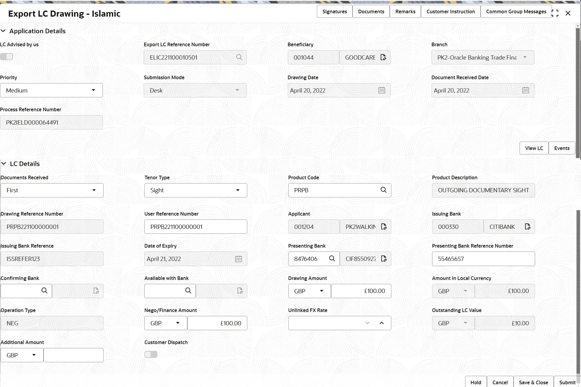

Figure 2-4 Export LC Drawing - Islamic- Registration - Application Details
- On Export LC Drawing - Islamic - Registration - Application
Details screen, specify the fields.
The fields which are marked as Required are mandatory.For more information on fields, refer to the field description table below.
Table 2-3 Export LC Drawing - Islamic - Registration - Application Details - Field Description
Field Description LC Advised by us Enable the option, if LC is advised by negotiating bank. Disable the option, if LC is not advised by the negotiating bank.
Export LC Reference Number Specify the export LC reference number. Alternatively, click Search to search and select the export LC reference number. In the lookup, you can search giving Customer ID, Currency, Amount, Issue Date and Issuing Bank Reference, User Reference Number to fetch the LC details. Based on the search result, select the applicable LC for drawing.
This field is applicable only if LC Advised by us toggle is enabled.Note:
In case of silent confirmation, user gets an alert message “The LC has been Silently Confirmed.”Beneficiary If LC Advised by us toggle is enabled, this field is read-only. Beneficiary will be auto-populated based on the selected LC from the look-up. If LC Advised by us toggle is disabled, click Search to search and select the beneficiary customer.
If beneficiary is a customer of the bank, system will check for valid KYC status. If KYC status is not valid, system will display alert message.
Branch Read only field. Branch details is auto-populated based on the selected Export LC Reference Number.
Priority System populates the priority of the customer based on priority maintenance. If priority is not maintained for the customer, system will populate 'Medium' as the default priority. User can change the priority populated any time before submit.
Submission Mode System populates the submission mode of Export LC Drawing request. By default the submission mode will have the value as ‘Desk’.
- Desk - Request received through Desk
- Courier - Request received through Courier
- Email - Request received through Email
- Fax - Request received through Fax
Drawing Date Read only field. System displays the drawing date.
By default, the application will display branch’s current date and does not enables the user to change the date to any back date.
Document Received Date Read only field. By default, the application will display branch’s current date and does not enables the user to change the date to any back date.
Process Reference Number Unique sequence number for the transaction. This is auto generated by the system based on process name and branch code.

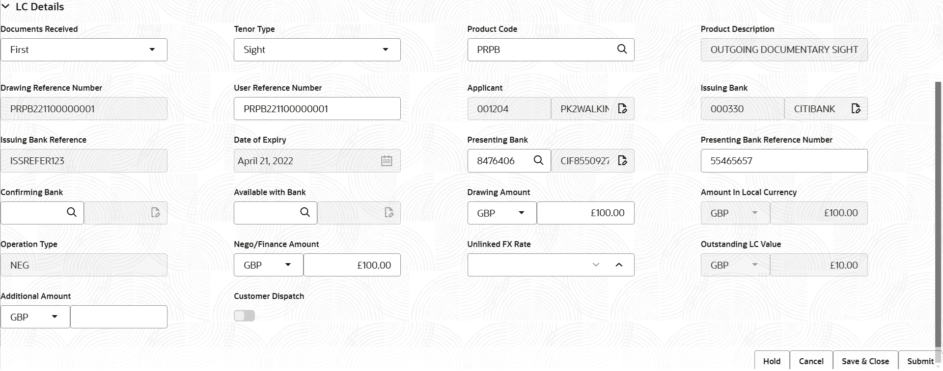

LC DetailsRegistration user can provide LC details in this section. Alternately, details can be provided by Scrutiny user.
Description of the illustration registrationlcdetails.png - On Export LC Drawing - Islamic - LC Details screen,
specify the fields.
Table 2-4 Export LC Drawing - Islamic - Registration - LC Details - Field Description
Field Description Documents Received System defaults the value for documens received. User can select the number of sets of documents received from the drop-down.
The options are:- First
- Second
- Both
Tenor Type System defaults the value for tenor type. User can select the tenor type received from the drop-down.
The options are:- Sight
- Usance
- Multi Tenor
Product Code Click Search to search and select the product code for the drawing, from look-up. Product Description Read only field. This field displays the description of the product as per the selected product code.
Drawing Reference Number Read only field. This is auto generated by the back end system.
User Reference Number System defaults the user reference number based on the product code. The user can change the user reference number.
Applicant If LC Advised by us toggle is enabled, this field is read-only. Applicant will be auto-populated based on the selected LC from the look-up. If LC Advised by us toggle is disabled, click Search to search and select the applicant.
Issuing Bank If LC Advised by us toggle is enabled, this field is read-only. Issuing bank will be auto-populated based on the selected LC from the look-up. If LC Advised by us toggle is disabled, click Search to search and select the issuing bank.
The system will display the- SWIFT code (if available)
- Name and address of the bank
Issuing Bank Reference If LC Advised by us toggle is enabled, this field is read-only. Issuing bank reference will be auto-populated based on the selected LC from the look-up. If LC Advised by us toggle is disabled, specify the issuing bank reference number.
Date of Expiry If LC Advised by us toggle is enabled, this field is read-only. Expiry Date will be auto-populated based on the selected LC from the look-up. If LC Advised by us toggle is disabled, specify the Expiry Date.
Presenting Bank Specify the presenting bank or click Search to search and select the presenting bank. Note:
In case the selected Bank is not RMA Compliant, the system displays error message “RMA arrangement not available”.Presenting Bank Reference Number Specify the presenting bank reference number. Confirming Bank Click Search to search and select the confirming bank. Available with Bank Click Search to search and select the value for available with bank from the look-up. Note:
The Available Bank details should be handed off against ‘Collecting Bank’ Party in OBTF.Note:
If the Bank selected in Confirming Bank and Available with Bank are same, system should hand off only the Confirming Bank details in Back office.Note:
If Confirming Bank/Available with Bank are the same as Issuing Bank/Presenting Bank, system should display an error.Drawing Amount Specify the amount to be drawn in this drawing. Amount In Local Currency Read only field. System fetches the local currency equivalent value for the LC amount from back office (with decimal places).
Operation Type This field is read-only. Operation type will be auto-populated based on the selected LC from the look-up.
Nego/Finance Amount This field is read-only. Negotiation/Financing amount will be auto-populated based on the selected LC from the look-up.
Unlinked FX Rate This field is read-only. Unlinked FX Rate will be auto-populated based on the selected LC from the look-up.
Outstanding LC Value If LC Advised by us toggle is enabled, this field is read-only. Outstanding LC value will be auto-populated based on the selected LC from the look-up. If LC Advised by us toggle is disabled, specify the Outstanding LC value.
Additional Amount Specify any additional amount to be processed under this LC drawing. LC Transferred Amount Read only field. Indicates the total LC transferred value.
This field appears, if the user select the Export LC Reference Number from the look-up.
LC Not Transferred Amount Read only field. Indicates the outstanding non Transferred LC Value.
Customer Dispatch The value will be populated from back office based on the maintenance. If the option is enabled, the customer has the option to dispatch the documents directly to the importer’s bank.
If the option is enabled, the bank has to dispatch the documents to the importer’s bank.
Bank user is not allowed to edit the field, if the value defaulted from the back office is “No”.
This field is enabled, if LC Advised by us option is enabled. - Click Submit.The task will move to next logical stage of Export LC Drawing - Islamic.
