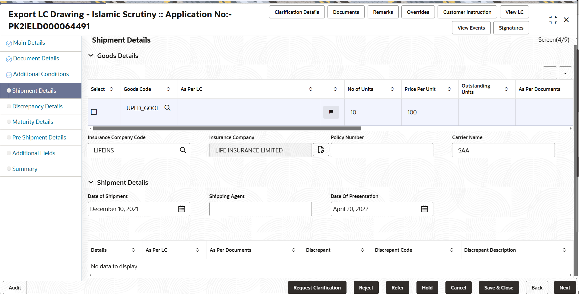

This topic provides the systematic instructions to capture the shipment details of Export LC Drawing - Islamic request.
- On Shipment Details screen, specify the fields.
Figure 2-11 Shipment Details
Description of the illustration scrutinyshipmentdetails.pngFor more information on fields, refer to the field description table below.
Table 2-14 Shipment Details – Field Description
Field Description Description of Goods and/or Services Specify the Description of Goods and/or Services details based on the description of following table. Click Plus icon to add multiple descrption of goods and services.
Select Check box to select the record. Goods Code Click Search to search and select the goods code. Once you select goods code, value will default in Goods Type and Goods Description. As Per LC If LC Advised by us toggle is enabled, this field is read-only. This field displays description of the goods as per the latest LC. If LC Advised by us toggle is disabled, specify the description of goods.
As Per Documents Provide the description of the goods as per the documents. Discrepant Enable the option as ‘Yes’ if there is difference between LC requirement and documents received. Discrepant Code Select the discrepancy code based on the discrepancy identified. This field is enabled, if Discrepant option is enabled.
Discrepant Description Description will be displayed based on the discrepancy code. The user can change the description.
Insurance Company Code Click Search to search and select the Insurance Company Code from the lookup. Insurance Company Read only field. The system displays the insurance company details as per the selected Insurance Company Code.
Policy Number Specify the policy number of the insurance. Carrier Name Specify the name of the carrier through which the goods were shipped. Shipment Details Specify the Shipment Details based on the description of following table. Date Of Shipment Select the date of shipment. Shipment date can be back dated but not future dated. This is a mandatory field, an error message will be displayed if not provided.
Shipping Agent Specify the shipping agent name from the document received. Date of Presentation Date of presentation is auto-populated based on the system date.
Details Details represent the fields in latest LC. As Per LC If LC Advised by us toggle is enabled, this field is read-only. This field displays description of fields as per the latest LC. If LC Advised by us toggle is disabled, specify the description of fields.
As Per Documents Specify the description of the goods as per the documents. Discrepant Enable the option as ‘Yes’ if there is difference between LC requirement and documents received. Discrepancy Code Select the discrepancy code based on the discrepancy identified. This field is enabled, if Discrepant option is enabled.
Discrepancy Description Description will be displayed based on the discrepancy code. - Click Next.The task will move to next data segment.
