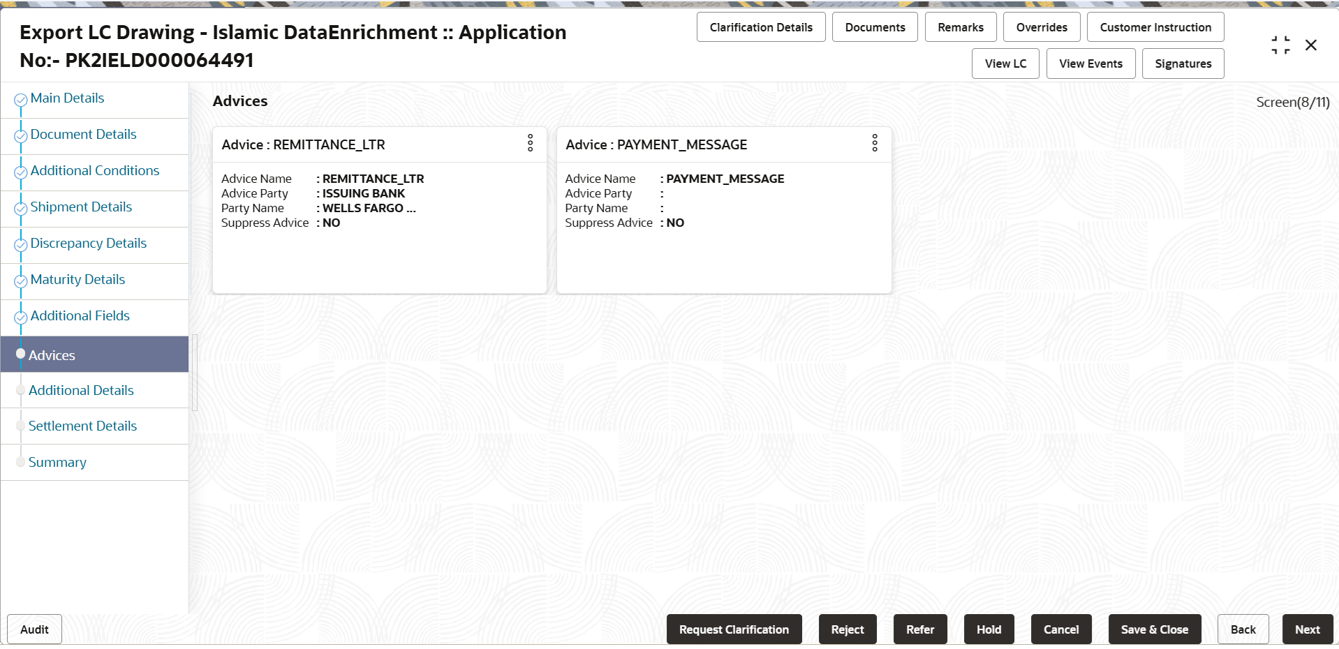

This topic provides the systematic instructions to capture the advices details of Export LC Drawing - Islamic process.
- On Advices screen, click
on any advice tile to view the advice details.Figure 2-31 Advices
Description of the illustration deadvices.pngAdvice Details
Description of the illustration deadvicedetails.pngFor more information on fields, refer to the field description table below.
Table 2-29 Advice Details
Field Description Suppress Advice Enable this option to suppress the advice. Disable this option if suppress advice is not required.
Advice Name Displays the advice name. Medium Displays the medium of advices is defaulted from the system. Advice Party Displays the advice party is defaulted from the system. Party ID Displays the party Id defaulted from system. Party Name Displays the defaulted from Guarantee. FTT Code Specify the free format text details. Click plus icon to add new FFT code.
FTT Code Click Search to search and select the FFT Code. FFT Description FFT description is populated based on the FFT code selected. User can edit the FFT description.
Click edit icon to edit the existing FFT description. Action Click delete icon to remove any existing FFT code. Click edit icon to edit the existing FFT code.
Instructions Specify the Instruction Details details. Click plus icon to add new instruction code.
Instruction Code Click Search to search and select the instruction Code. Instruction Description Instruction description is populated based on the instruction code selected. User can edit the instruction description.
Click edit icon to edit the existing instruction description. Action Click delete icon to remove any existing instruction code. Click edit icon to edit the existing instruction code.
