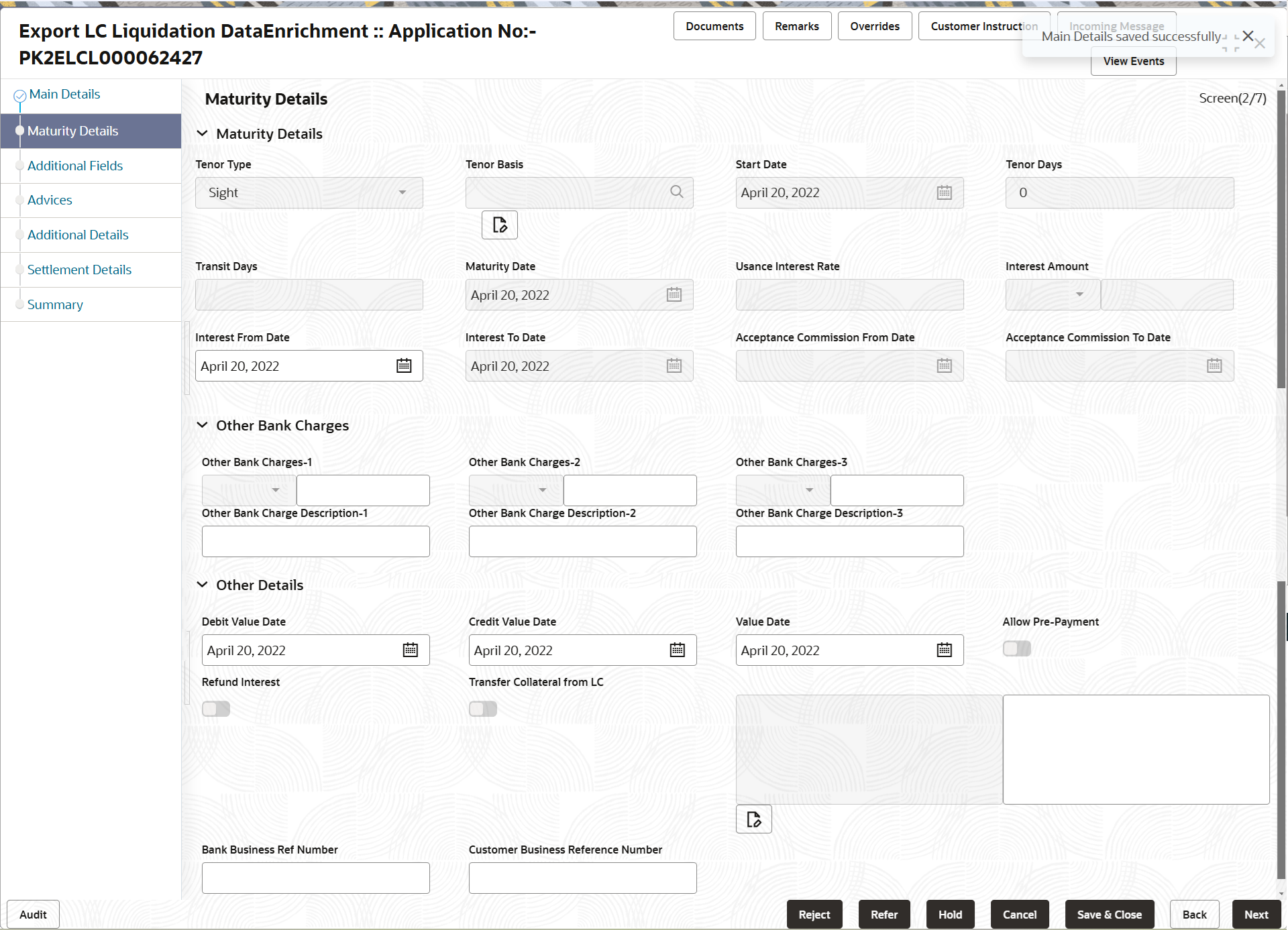

- On Maturity Details screen, specify the fields.
Figure 2-9 Maturity Details
Description of the illustration dematuritydetails.pngFor more information on fields, refer to the field description table below.
Table 2-10 Maturity Details - Field Description
Field Description Tenor Type Read only field. This field displays the tenor type as per LC.
Tenor Basis Read only field. This field displays the tenor basis as per LC.
Start Date Read only field. This field displays the tenor start date as per LC.
Tenor Days Read only field. This field displays the number of tenor days as per LC.
Transit Days Read only field. This field displays the transit days as per LC.
Maturity Date Read only field. System displays the due date for the bill based on tenor and tenor basis.
If tenor is sight, system will calculate the maturity date as five working days from document received date.
User can change this value to any date earlier than the maturity date up to system date. User cannot change the value to later than maturity date.
If tenor is Usance, system will calculate the maturity date based on the tenor basis and populate the maturity date.
Usance Interest Rate Read only field. This field displays the usance interest rate.
Interest Amount Read only field. This field displays the interest amount.
Interest From Date System defaults the interest from date. The user can change the date. The interest from date cannot be earlier than branch date and later than maturity date.
Interest To Date System defaults the interest to date. The interest from date cannot be earlier than branch date and later than maturity date.
Acceptance Commission From Date Read only field. This field displays the acceptance commission start date.
Acceptance Commission To Date Read only field. This field displays the acceptance commission end date.
Other Bank Charges Other Bank Charges - 1 This field displays the charges to be collected for the other bank as part of the collection transaction. Other Bank Charges - 2 This field displays the charges to be collected for the other bank as part of the collection transaction. Other Bank Charges - 3 This field displays the charges to be collected for the other bank as part of the collection transaction. Other Bank Description -1 This field displays the description of charges to be collected for the other bank as part of the drawings transaction. Other Bank Description - 2 This field displays thedescription of charges to be collected for the other bank as part of the drawings transaction. Other Bank Description - 3 This field displays the description of charges to be collected for the other bank as part of the drawings transaction. Other Details Debit Value Date Specify the debit value date. Credit Value Date Specify the credit value date. Value Date Read only field. Displays the value date.
Allow Pre-Payment Read only field. Indicates whether pre-payment is allowed or not.
Refund Interest Read only field. Indicates whether refund of interest is allowed or not.
Transfer Collateral from LC Read only field. Indicates whether transfer collateral from LC is allowed or not.
Sender to Receiver Information-MT756 Click the edit icon and specify the sender to receiver information in Line 1-6 and click Save & Close to save the changes. The user can edit the details by clicking the edit icon.
Narrative-MT756 Specify the narrative. - Click Next.The task will move to next data segment. For more information refer Additional Fields.
