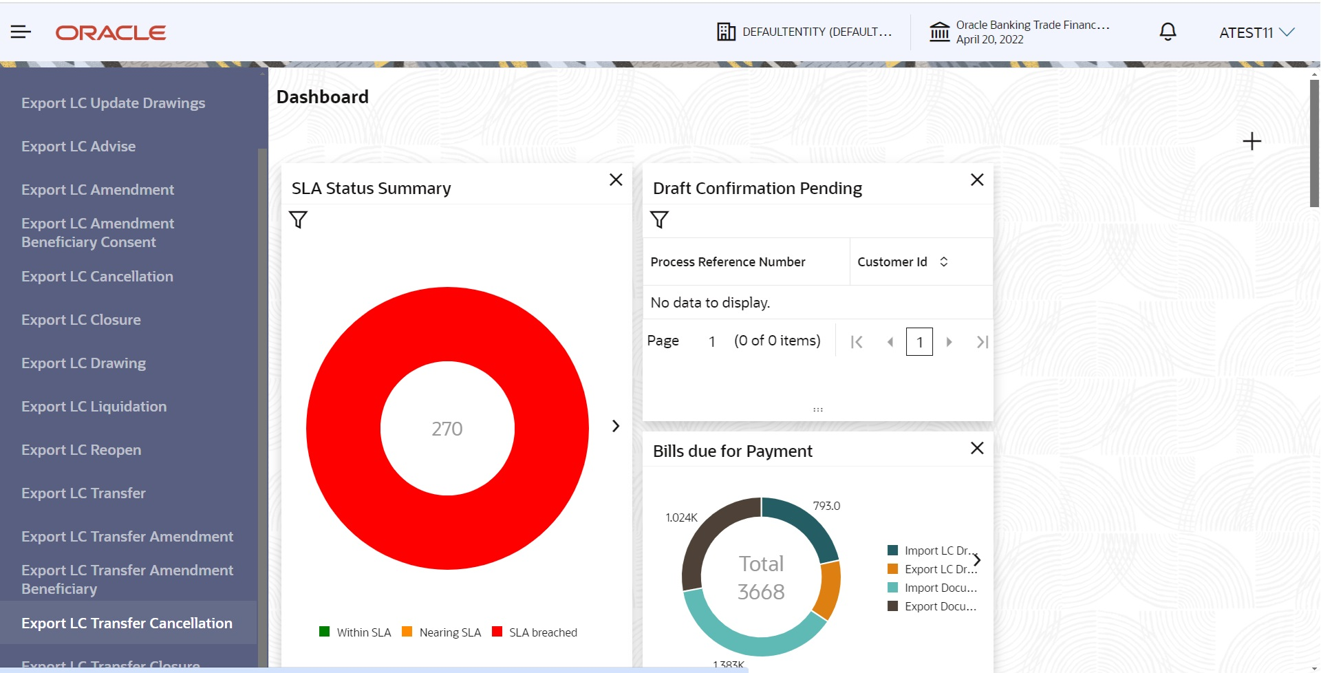

- On Home screen, click Trade Finance. Under Trade Finance, click Export Documentary Credit.
- Under Export Documentary Credit, click Export
LC Transfer Cancellation.
Figure 2-3 Export LC Transfer Cancellation

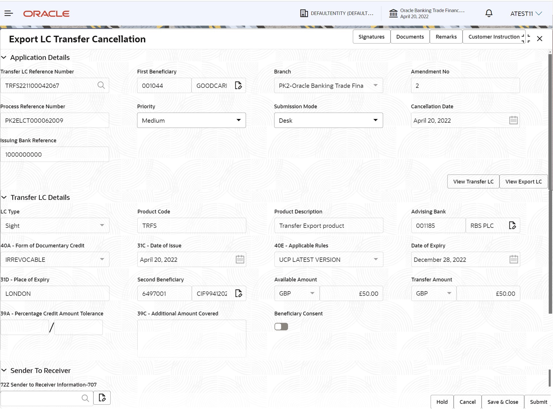

Description of the illustration exportlctransfercancellation_menu.pngThe Export LC Transfer Cancellation screen is diaplayed.The Export LC Transfer Cancellation - Registration stage has three sections Application Details, Transfer LC Details and Sender To Receiver. Let’s look at the details of Registration screens below:
Figure 2-4 Export LC Transfer Cancellation - Registration - Application Details
Description of the illustration registrationapplicationdetails.png - On Export LC Transfer Cancellation - Registration - Application
Details screen, specify the fields.
The fields which are marked as Required are mandatory.For more information on fields, refer to the field description table below.
Table 2-3 Export LC Transfer Cancellation - Registration - Application Details - Field Description
Field Description Transfer LC Reference Number Specify the transfer LC reference number. Alternatively, click Search to search and select the transfer LC reference number.
As part of lookup, user can search giving Transfer LC Reference Number, Second Beneficiary, Currency, Amount and User Reference to fetch the Export Transfer LC details.
System displays all the Transfer LC’s outstanding against the given first Beneficiary-Second Beneficiary combination.
User can select the particular Transfer LC that can be cancelled.Once the LC to be cancelled is input/selected, on tab out system will populate the details of the LC to be cancelled.
System will not display the Transfer LC Reference which is already in cancelled or closed status.First Beneficiary Read only field. First Beneficiary details is defaulted from the underlying Export LC.
Branch Read only field. Branch details is auto-populated from LC details.
Amendment No Read only field. System defaults the latest amendment number sequence for this Export LC. The amendment sequence number is simulated from the backend system. The System to default based on the logic < Last Amendment Number +1>.
Process Reference Number Read only field. Unique sequence number for the transaction.
This is auto generated by the system based on process name and branch code.
Priority System defaults the priority of the customer as Essential/Critical/Medium/High/Low based on priority maintenance. If priority is not maintained for the customer, system will populate 'Medium' as the default priority.User can change the priority populated any time before submit.
Submission Mode System populates the submission mode of Export LC Transfer Cancellation request. By default the submission mode will have the value as ‘Desk’.
- Desk - Request received through Desk
- FAX - Request received through
- Email - Request received through Email
- Courier - Request received through Courier
The user can change the submission mode.
If cancellation request initiated from customer portal, then submission mode value will be ‘online’ and read only.
Cancellation Date Read only field. By default, the application will display branch’s current date.
Issuing Bank Reference Read only field. Issuing Bank reference number details will be auto-populated from the underlying Transfer LC.

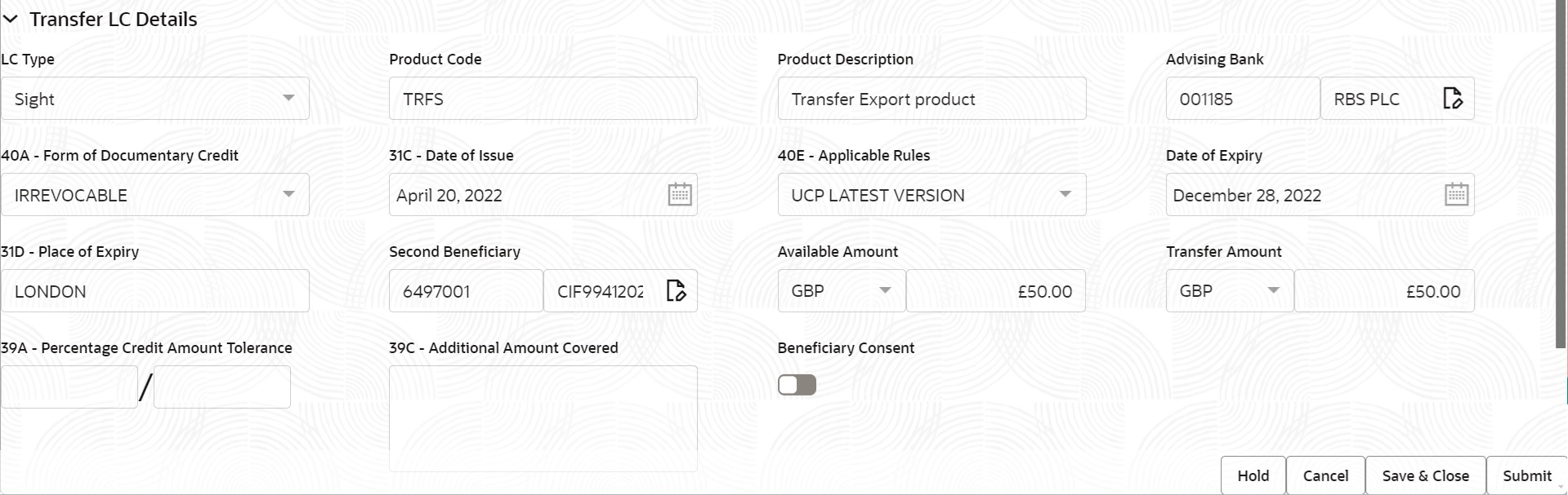

Transfer LC DetailsThe user can view the latest LC values displayed in the respective fields. All fields displayed in LC details section are read only fields except the Beneficiary Consent toggle.
Description of the illustration registrationtransferlcdetails.png - On Export LC Transfer Cancellation - Transfer LC Details
The fields which are marked as Required are mandatory.Table 2-4 Registration - Transfer LC Details - Field Description
Field Description LC Type Read only field. Displays the value used for LC Type as per the latest LC details.
Product Code Read only field. Displays the product code used during Issuance of Transfer LC.
Product Description Read only field. Displays the description of the product as per the product code as in Transfer LC Issuance.
Advising Bank Read only field. Displays the advising bank Bank through which Transfer LC is advised, as per the latest LC details.
40A - Form of Documentary Credit Read only field. Displays the type of LC as per the selection done at the time of Transfer LC Issuance.
Date of Issue Read only field. This field displays the transfer LC issuance date.
Applicable Rules Read only field. Displays the rules under which LC is issued, as per the latest LC details.
Date of Expiry Read only field. Displays the expiry date as per the latest Transfer LC details.
Place of Expiry Read only field. Displays the place of expiry as per the latest Transfer LC details.
Second Beneficiary Read only field. Applicant Bank if available as per the latest LC details is displayed.
Available Amount Read only field. Displays the outstanding value of the Transfer LC.
Transfer Amount Read only field. Currency Code as per the latest LC details is displayed.
Transfer LC Amount as per the latest LC details is displayed.
Percentage Credit Amount Tolerance Read only field. Displays the percentage credit amount tolerance details as per the latest LC.
Additional Amount Covered Read only field. Additional amount covered as per the latest LC details
Beneficiary Consent This flag is enabled, if cancellation requires beneficiary’s consent. In case user wishes to turn it OFF, an override message should be populated. “Beneficiary Consent flag Turned OFF”.

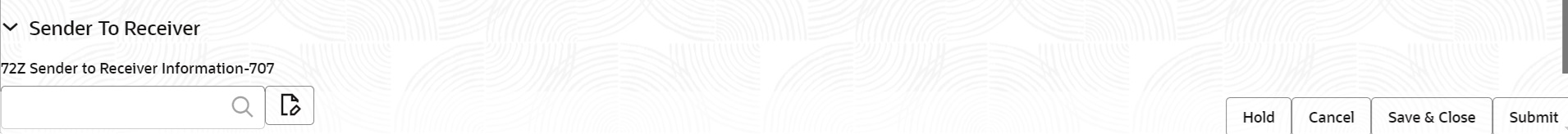

Sender To ReceiverThis screen captures the Sender To Receiver details.
Description of the illustration registartionsendertoreciever.png - On Export LC Transfer Cancellation - Sender To Receiver
The fields which are marked as Required are mandatory.For more information on fields, refer to the field description table below.Table 2-5 Registration - Sender To Receiver - Field Description
Field Description Sender to Receiver Information Click ‘Search’ icon to search and select a FFT to provide the additional information to receiver. User can enter the Sender to Receiver Information to be sent in outgoing MT707.
Click the edit icon to edit the sender to receiver information.
