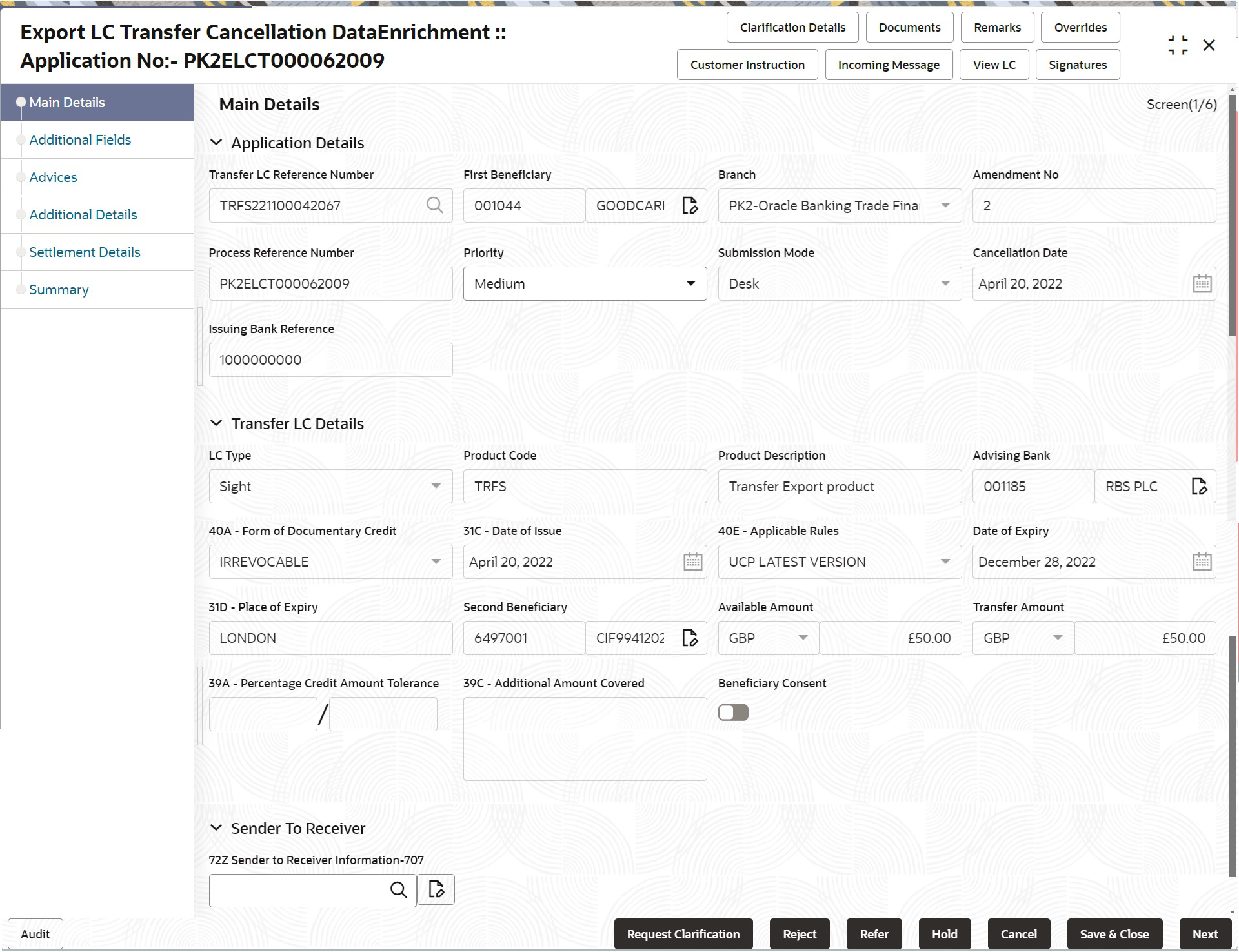

This topic provides the systematic instructions to initiate the main details of Scrutiny stage of Export LC Transfer Cancellation request.
- Application Details
- Transfer LC Details.
- Sender To Receiver
This section provides a quick snapshot of Application details. All fields displayed under Application details section, would be read only except for the Priority
- On Main Details screen, specify the fields that were not
entered at Registration stage.For more information on fields, refer to the field description table below.
Table 2-7 Export LC Transfer Cancellation - Main Details - Application Details - Field Description
Field Description Transfer LC Reference Number Read only field. System displays the Transfer LC reference number as available from previous/Registration stage.
Transfer LC Reference Number is the LC Number for the instrument to be cancelled.
First Beneficiary Read only field. System displays the name of the first beneficiary as available from previous/Registration stage.
Branch Read only field. Branch through with the LC is issued. This is usually the home branch of the customer. Displays as available from previous/Registration stage.
Amendment No Read only field. System defaults the latest amendment number sequence for this Transfer Letter of Credit. The amendment sequence number is simulated from the backend system.
Displays the value as available from previous/Registration stage
Process Reference Number Read only field. Unique sequence number for the transaction.
This is auto generated by the system based on process name and branch code.
Displays the value as available from previous/Registration stage.
Priority System populates the priority of the customer as Essential/Critical/Medium/High/Low based on priority maintenance. If priority is not maintained for the customer, system will populate 'Medium' as the default priority.
User can change the priority populated.
Submission Mode Read only field. System populates the submission mode of Export LC Transfer Cancellation request.
- Desk- Request received through Desk
- Courier- Request received through Courier
- Email - Request received through Email
- Fax - Request received through Fax
By default the submission mode will have the value as ‘Desk’
User can change the defaulted Submission Mode.
Cancellation Date Read only field. By default, the application will display branch’s current date.
Issuing Bank Reference Read only field. Reference number of the Issuing bank will be auto-populated from the underlying Transfer LC.

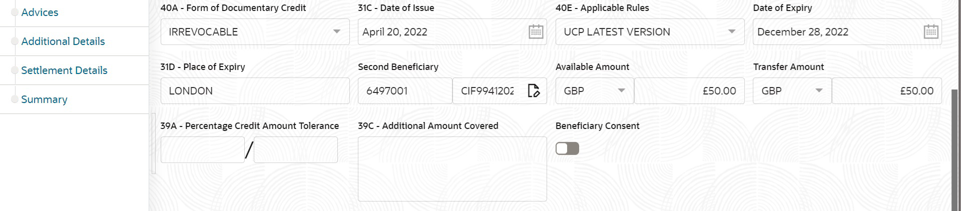

Transfer LC DetailsA DE user will be able to view the latest Transfer LC values defaulted in the respective fields. All fields displayed in Transfer LC Details section are read only fields except the Beneficiary Consent toggle
Figure 2-8 Transfer LC Details
Description of the illustration detransferlcdetails.pngFor more information on fields, refer to the field description table below.
Table 2-8 Export LC Transfer Cancellation - Transfer LC Details - Field Description
Field Description LC Type Read only field. Displays the value used for LC Type as per the latest LC details.
Product Code Read only field. Displays the product code used during Issuance of Transfer LC.
Product Description Read only field. Displays the description of the product as per the product code as in Transfer LC Issuance.
Advising Bank Read only field. Displays the advising bank as per the latest LC details.
40A - Form of Documentary Credit Read only field. Displays the form of documentary credit details value available in LC record.
Date of Issue Read only field. This field displays the LC issuance date. Application will default the branch’s current date in date of issue.
Applicable Rules Read only field. Displays the applicable rule as per the latest LC details.
Date of Expiry Read only field.. Displays the expiry date as per the latest LC details.
Place of Expiry Read only field.. Displays the place of expiry as per the latest LC details.
Second Beneficiary Read only field. Second beneficiary name, as per the latest Transfer LC details is displayed.
Available Amount Read only field. Displays the available amount in the Transfer LC. Latest value is displayed from Back Office.
Transfer Amount Read only field. Currency Code as per the latest LC details is displayed.
Transfer LC Amount as per the latest LC details is displayed.
Percentage Credit Amount Tolerance Read only field. Displays the percentage credit amount tolerance details as per the latest LC.
Additional Amount Covered Read only field. Additional amount covered as per the latest LC details.
Beneficiary Consent Enable the option, if beneficiary consent is required for cancellation. Disable the option, if beneficiary consent is not required.Note:
If user wishes to turn OFF the beneficiary consent, an override message is populated as “Beneficiary Consent flag Turned OFF”.Beneficiary Consent is enabled, if the cancellation is for full or part of the LC remaining value where further drawings are expected under the LC.
User has to turn OFF Beneficiary Consent flag if all drawings under the LC have already been booked and the cancellation is triggered for the remaining unutilized amount.

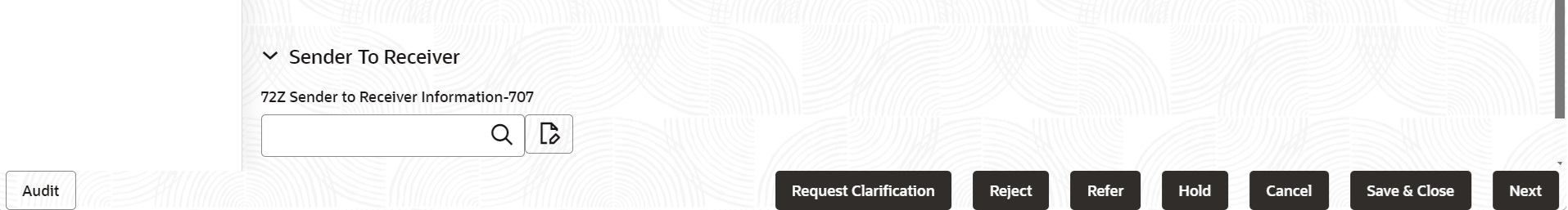

Sender To ReceiverThis screen captures the Sender To Receiver details, if not entered in 'Registration' stage.
Table 2-9 Sender To Receiver - Field Description
Field Description Sender to Receiver Information Click ‘Search’ icon to search and select a FFT to provide the additional information to receiver. User can enter the Sender to Receiver Information to be sent in outgoing MT707.
Click the edit icon to edit the sender to receiver information.
