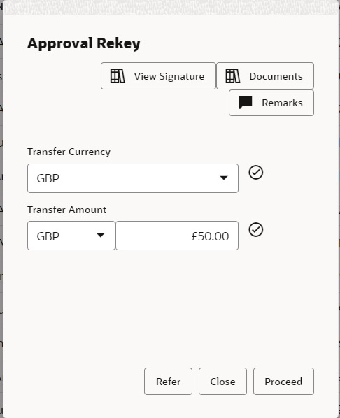

Click Edit to approve the task.The Approval Re-Key pop-up screen is displayed.
Figure 2-15 Approval Re-Key
Description of the illustration approvalrekey.pngFor non online channel, application will request approver for few critical field values as an authorization step. If the values captured match with the values available in the screen, system will allow user to open the transaction screens for further verification. If the re-key values are different from the values captured, then application will display an error message.
- Open the task and re-key some of the critical field values from the request in
the Approval Re-Key screen.Some of the fields below will dynamically be available for re-key.:
- Transfer Currency
- Transfer Amount

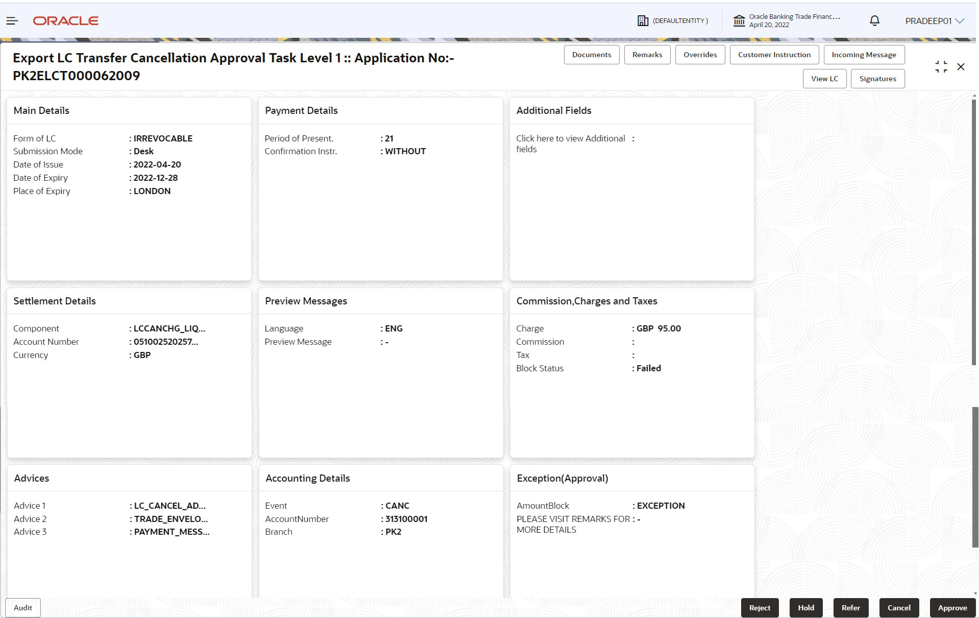

- Click Proceed to proceed for the approval.The Approval Summary screen is displayed. The user can view the Summary tiles which displays list of important fields with values.
- Click each tile to drill down from summary tiles into respective data segments
to verify the details of all fields under the data segment.
The user can simulate/recalculate charge details and during calling the handoff, if handoff is failed with error the OBTFM displays the Handoff failure error during the Approval of the task.Tiles Displayed in Summary:- Main Details - User can view the application details and LC details.
- Payment Details - User can view payment details.
- Additional Fields: User can view the additional fields during implementation.
- Settlement Details: User can view the Settlement details.
- Preview Messages - User can view the preview messages.
- Commission, Charges and Taxes: User can see the details provided for commission, charges and taxes.
- Advices: User should be able to view the advice details.
- Accounting Details: User can view the accounting
details.
When the Value Date is different from the Transaction Date for one or more accounting entries, system displays an Alert Message “Value Date is different from Transaction Date for one or more Accounting entries. - Exception (Approval): User can view the Exception (Approval) details.
