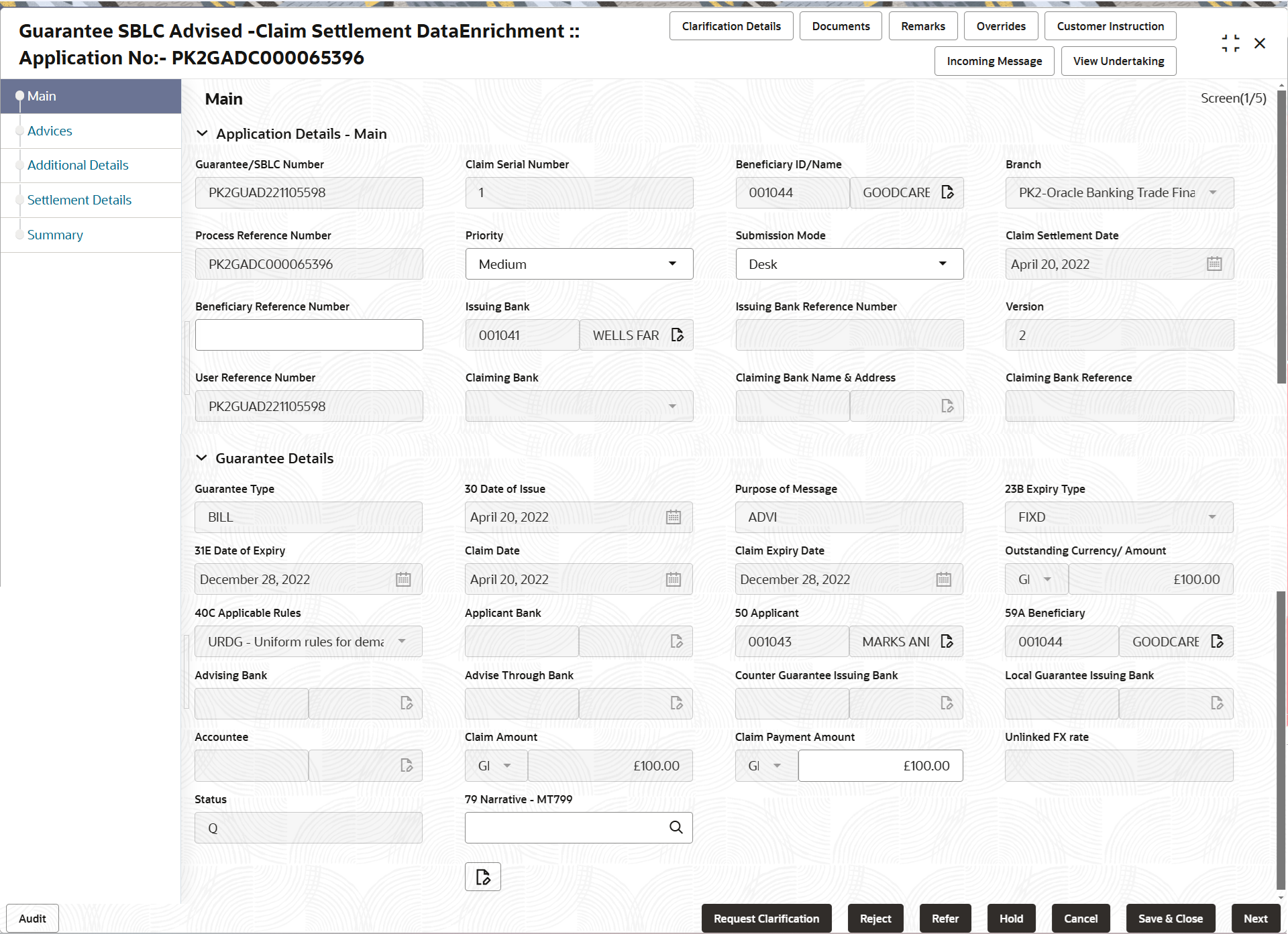

- On Data Enrichment - Main screen, specify the fields
that were not entered at Registration stage.
Figure 2-7 Data Enrichment - Main
Description of the illustration demaindetailsapplication.pngFor more information on fields, refer to the field description table below.Table 2-6 Main - Application Details - Field Description
Field Description Guarantee/SBLC Number Read only field. System defaults the value from Registration stage.
Claim Serial Number Read only field. System defaults the claim serial number from Guarantee/ SBLC advise.
Beneficiary ID/Name Read only field. System defaults the customer ID/ Name from Guarantee/ SBLC claim.
Branch Read only field. System defaults the branch name from Guarantee /SBLC advised.
Process Reference Number Read only field. Unique OBTFPM task reference number for the transaction.
This is auto generated by the system based on process name and branch code.
Priority Priority maintained will be populated as either 'Essential/ Critical /Low /Medium /High'. If priority is not maintained for a customer, ‘Medium' priority will be defaulted. User can change the priority.
Submission Mode System defaults the submission mode of Guarantee Advised Claim Settlement request. By default the submission mode will have the value as ‘Desk’.
- Desk - Request received through Desk
- Fax- Request received through Fax
- Email- Request received through Email
The user can change the submission mode.
Claim Settlement Date Read only field. By default, the application will display branch’s current date for the claim settlement date.
Beneficiary Reference Number Specify the Beneficiary Reference Number. Issuing Bank Read only field. System defaults the Issuing Bank name from Guarantee/ SBLC advise.
Issuing Bank Reference Number Read only field. System defaults the Issuing Bank Reference Number from Guarantee/ SBLC advise.
Version Read only field. System defaults the version number.
User Reference Number Read only field. System defaults the User Reference Number from Guarantee/ SBLC advise.

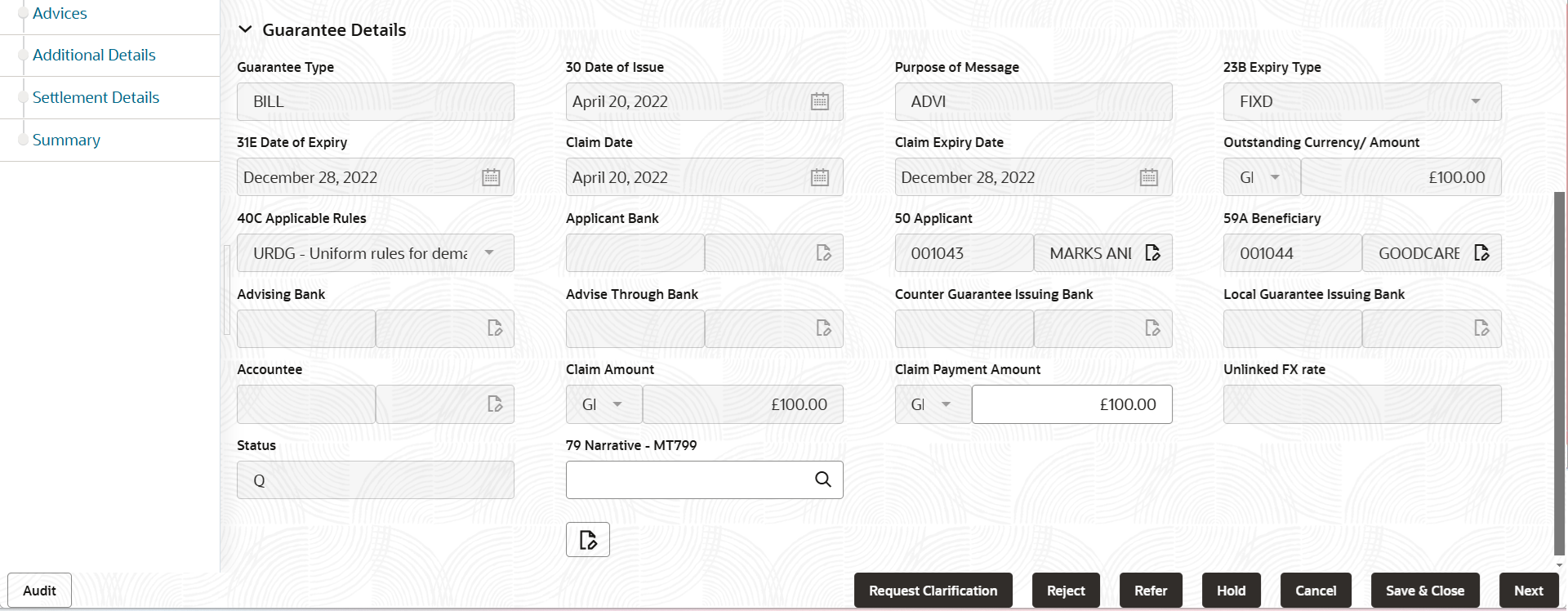

Main - Guarantee DetailsThe fields listed under this section are same as the fields listed under the Guarantee Details section in Registration stage. For more information on the fields, refer to Guarantee Details of Registration stage. During registration, if user has not captured input, then user can capture the details in this section.
Figure 2-8 Main - Guarantee Details
Description of the illustration demainguaranteedetails.pngFor more information on fields, refer to the field description table below.
Table 2-7 Main - Guarantee Details - Field Description
Field Description Guarantee Type Read only field. Guarantee type defaults from Guarantee/ Standby Advised.
Date of Issue Read only field. System defaults the date of issue from Guarantee /SBLC Advised.
Purpose of Message Read only field. System dafaults the purpose of message from Guarantee/ Standby Advised.
Expiry Type Read only field. System defaults the expiry type from Guarantee/ SBLC Advised.
Date of Expiry Read only field. Expiry date of the Guarantee Advise.
System defaults the expiry date from Guarantee/ SBLC Advised.
Claim Date Read only field. System defaults the claim date from Guarantee/ SBLC Advised.
Claim Expiry Date Read only field. System defaults the claim expiry date from Guarantee/ SBLC Advised.
Outstanding Currency/ Amount Read only field. System defaults outstanding currency and amount from Guarantee/ Standby Advised.
Applicable Rules Read only field. System defaults the value from Guarantee Advised details.
Applicant Bank Read only field. This system defaults the applicant bank details available in Guarantee.
Applicant Read only field. System defaults the applicant from Guarantee/ SBLC Advised.
Beneficiary Read only field. System defaults the beneficiary as in Guarantee/ SBLC Advised.
Advising Bank Read only field. System defaults the advising bank if available.
Advising Through Bank Read only field. System defaults the advising through bank if available in Guarantee Advise.
Counter Guarantee Issuing Bank Read only field. System defaults the counter guarantee issuing through bank, if available in Guarantee Advise.
Local Guarantee Issuing Bank Read only field. System defaults the local guarantee issuing bank, if available in Guarantee Advise.
Accountee Read only field. System defaults the accountee name, if available in Guarantee.
Claim Amount Read only field. System defaults the claim amount from the Guarantee Claim.
Claim Payment Amount System defaults the claim amount and currency from the Guarantee Claim. The user can change the claim payment amount and currency.
Unlinked FX rate Read only field. If claim currency is different from local currency system displays the unlinked FX rate.
Status This field displays the status of the Guarantee advised claim settlement. Narrative - MT799 Specify or click search icon to search and select the narrative. Audit
