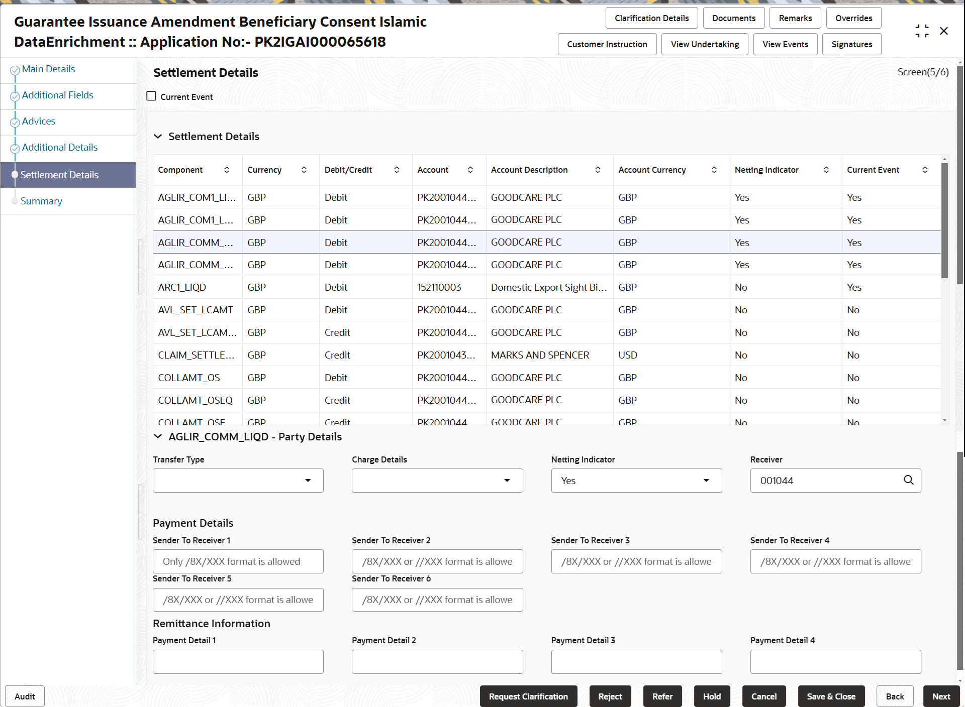

2.3.4 Settlement Details
This topic provides the systematic instructions to capture the settlement details of Guarantee SBLC Issuance - Claim Settlement request.
- On Settlement Details screen, specify the fields.
For more information on fields, refer to the field description table below.
Table 2-17 Settlement Details – Field Description
Field Description Current Event Select the check box to populate the settlement details of the current event associated with the task. On De-selecting the check box, the system list all the accounts under the settlement details irrespective of the current event. Component Read only field. System defaults the value from Guarantee /SBLC claim.

Current Event System displays the current event as Y or N. Original Exchange Rate System displays the Original Exchange Rate as simulated in settlement details section from OBTF. Exchange Rate System populates the exchange rate maintained. Deal Reference Number System defaults the exchange deal reference number. - Click any component in the grid.Party Details
Field Description Transfer Type Select the transfer type from the drop-down list. The options are:- Customer Transfer

Ordering Customer Click search icon to search and select the ordering customer from the look up. Ordering Institution Click search icon to search and select the ordering institution from the look up. Senders Correspondent Click search icon to search and select the senders correspondent from the look up. Receivers Correspondent Click search icon to search and select the receivers correspondent from the look up. Intermediary Institution Click search icon to search and select the intermediary institution from the look up. Account with Institution Click search icon to search and select the account with institution from the look up. Beneficiary Institution Click search icon to search and select the beneficiary institution from the look up. Ultimate Beneficiary Click search icon to search and select the ultimate beneficiary from the look up. Intermediary Reimbursement Institution Click search icon to search and select the intermediary reimbursement institution from the look up. Reciever Receiver is defaulted from the guarantee claim. The user can change the receiver. Payment Details

Field Description Sender to Receiver 1 Specify the sender to receiver message. Sender to Receiver 2 Specify the sender to receiver message. Sender to Receiver 3 Specify the sender to receiver message. Sender to Receiver 4 Specify the sender to receiver message. Sender to Receiver 5 Specify the sender to receiver message. Sender to Receiver 6 Specify the sender to receiver message. Remittance Information
Field Description Payment Detail 1 Specify the payment details. Payment Detail 2 Specify the payment details. Payment Detail 3 Specify the payment details. Payment Detail 4 Specify the payment details. - Click Next.The task will move to next data segment.
