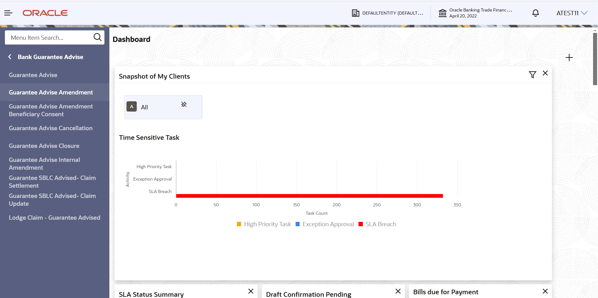

- On Home screen, click Trade Finance. Under Trade Finance, click Bank Guarantee Advise.
- Under Bank Guarantee Advise, click Guarantee
Advise Amendment.The Guarantee Advise Amendment - Registration screen displays.

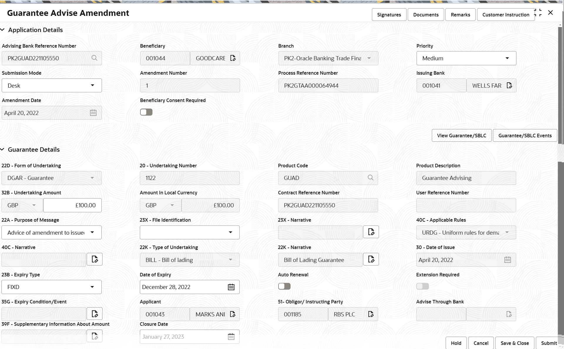

The Guarantee Advise Amendment - Registration stage has two sections Application Details and Guarantee Details. Let’s look at the details of Registration screens below:
Figure 2-4 Guarantee Advise Amendment - Registration - Application Details
Description of "Figure 2-4 Guarantee Advise Amendment - Registration - Application Details" - On Guarantee Advise Amendment - Registration - Application
Details screen, specify the fields.
The fields which are marked as 'Required' are mandatory.Table 2-3 Guarantee Advise Amendment - Registration - Application Details - Field Description

Guarantee DetailsRegistration user can provide Guarantee details in this section.
Description of the illustration registrationguaranteedetails.png - On Guarantee Advise Amendment - Registration - Guarantee
The fields which are marked as 'Required' are mandatory.For more information on fields, refer to the field description table below.
Table 2-4 Guarantee Details - Field Description
Field Description Form of Undertaking Read only field. Form of Undertaking defaults from Guarantee/ SBLC Advise.
Form of Undertaking values can be:
- DGAR - Guarantee
- STBY - Standby LC
Undertaking Number Read only field. Undertaking Number defaults from Guarantee/ SBLC Advise.
Product Code Read only field. System defaults the value from Guarantee/ SBLC Advise.
Product Description Read only field. System defaults the description of the product from Guarantee/ SBLC Advise.
Undertaking Amount System defaults the value from Guarantee/ SBLC Advise. The user can change the undertaking amount but not the currency.
Amount In Local Currency Read only field. System fetches the local currency equivalent value for the transaction amount from back office (with decimal places).
Contract Reference Number Read only field. Auto-generated by back end application.
Number will be populated based on the Product Code.
User Reference Number Read only field. System defaults the user reference number from Guarantee/ SBLC Advise.
Purpose of Message System defaults the value from Guarantee/ SBLC Advise. The user can change the value.
Select the purpose of message from the drop-down.
The values are:- Advice and confirmation of amendment to issued undertaking
- Advice of amendment to issued undertaking
In case of STP of Incoming MT 767, system displays the value available in incoming MT 767.
File Identification Select the type of delivery channel and its associated file name or reference from the available values. The options are:- COUR - Courier delivery
- EMAL - Email transfer
- FACT - SWIFTNet FileAct
- FAXT - Fax transfer
- HOST - Host-to-Host
- MAIL - Postal Delivery
- OTHR - Other delivery channel
Narrative Specify the description available in the amendment instrument. If applicable. This field is enabled, if File Identification field values are COUR or OTHR .
Applicable Rules Read only field. System defaults the rules for guarantee, from Guarantee/ SBLC Advise.
Narrative Specify the description in this field, if Applicable Rules field values is OTHR. Type of Undertaking Read only field. System defaults the value from Guarantee/ SBLC Advise.
Narrative Specify the details of any other type of local undertaking. This field is enabled if the Type of Undertaking has value as OTHR .
Date of Issue Read only field. System defaults the value from Guarantee/ SBLC Advise.
Expiry Type Indicates the validity of the guarantee. System defaults the value from Guarantee/ SBLC Advise.
The options are- COND - With Expiry
- CONU - Without Expiry
- FIXD - Specified expiry date (with/without automatic expansion)
- OPEN - No specific date of expiry
User can amend the field, if required.
Date of Expiry Indicates the validity of the guarantee. System defaults the expiry date of Guarantee from Guarantee/ SBLC Advise. User can amend the field, if required.
This field is enabled if the Expiry Type is COND or FIXD.
Expiry Condition/Event This field indicates the documentary condition/event that indicates when the local undertaking will cease to be available. System defaults the value from Guarantee/ SBLC Advise.
This field is enabled if the Expiry Type is COND or CONU.
Applicant Read only field. System defaults the value from Guarantee/ SBLC Advise.
Obligor/ Instructor Party System defaults the name of the obligor from Guarantee/ SBLC Advise. Advise Through Bank System defaults the value from Guarantee/ SBLC Advise. Supplementary Information About Amount Read only field. System defaults any additional information about amount from Guarantee/ SBLC Advise.
Closure Date System defaults the “Closure Date”value from the previous version of the contract. User can modify the system defaulted “Closure Date” and system should validate the same for the below conditions:- Closure Date must be after the Issue Date.
- Closure Date must be after the Expiry Date.
- Closure Date cannot be blank
