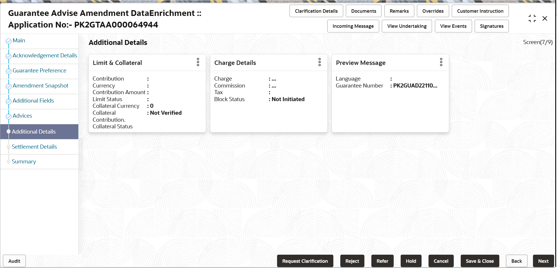

- Additional Details
2.3.7 Additional Details
This topic provides the systematic instructions to capture the additional details in Data Enrichment stage of Guarantee Advise Amendment process.
If any of the fields in the financial section of the pop up screen is checked then the limits and collaterals screen will be enabled.
For non-financial and narrative field amendments, the Limits and Collaterals screen will be read only. User cannot make changes.
- On Additional Details screen, click the 3 dots on any
Additional Details tile to view the details.
Figure 2-14 Additional Details

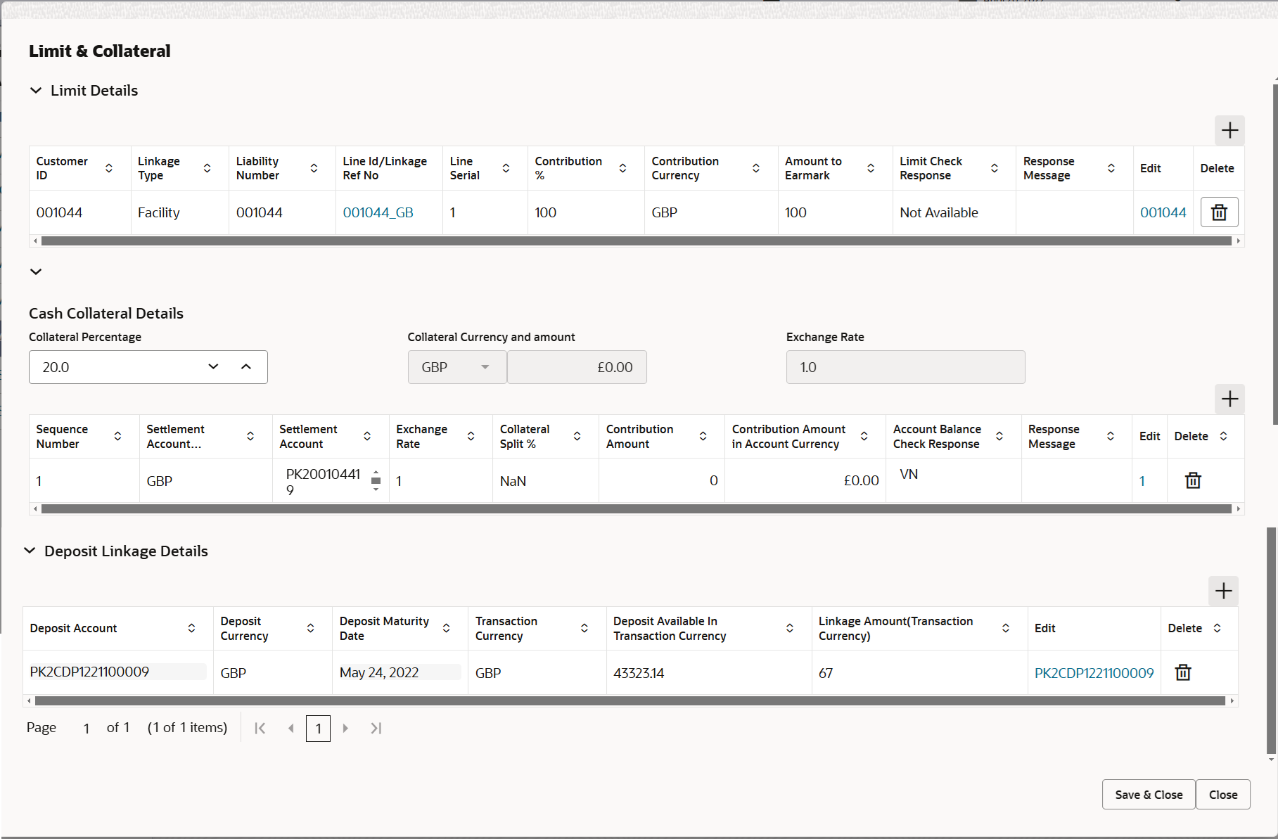

Description of the illustration deadditionaldetails.pngLimits and Collaterals
There is change in limits, if the below fields were amendment.- Increase in Amount
- Increase in Expiry Date
- Increase in Tolerance
The additional details are displayed as tile. The tiles displays a list of important fields with values. User will be able to drill down from tiles into respective data segments. User can select the tile, an update the respective details.
On Approval, system should not release the Earmarking against each limit line and system should handoff the “Limit Earmark Reference Number “to the back office. On successful handoff, back office will make use of these “Limit Earmark Reference Number” to release the Limit Earmark done in the mid office (OBTFPM) and should Earmark the limit from the Back office.
In case multiple Lines are applicable, Limit Earmark Reference for all lines to be passed to the back office.Figure 2-17 Deposit Linkage Details
Description of the illustration depositlinkagedetails1.pngFor more information on fields, refer to the field description table below.
Table 2-19 Limit Details - Field Description
Field Description
Click plus icon to add new limit details. Limit Details Click + plus icon to add new limit details.
Below fields are displayed on the Limit Details pop-up screen, if the user clicks plus icon.
Customer ID This field displays the applicant’s/applicant bank customer ID defaulted from the application. User can change the customer ID.
Linkage Type Select the linkage type. Linkage type can be:
- Facility
- Liability
By default Linkage Type should be “Facility”.
Contribution % System will default this to 100%. User can modify, if contribution is more than 100%. System will display an alert message, if modified. Once contribution % is provided, system will default the amount.
System to validate that if Limit Contribution% plus Collateral% is equal to 100. If the total percentage is not equal to 100 application will display an alert message.Note:
The collateral % maintained for the customer is defaulted into the Collateral Details screen. If collateral % is not maintained for the customer, then system should default the collateral % maintained for the product. User can modify the defaulted collateral percentage, in which case system should display a override message “Defaulted Collateral Percentage modified.Liability Number Click Search to search and select the Liability Number from the look-up. The list has all the Liabilities mapped to the customer.
Contribution Currency Read only field. The LC currency is defaulted in this field.
Line ID/Linkage Ref No Click Search to search and select from the various lines available and mapped under the customer id gets listed in the drop-down. LINE ID-DESCRIPTION will be available for selection along with Line ID. When you click on 'verify', the system will return value if the limit check was successful or Limit not Available. If limit check fails, the outstanding limit after the transaction value will be shown in the limit outstanding amount.
The user can click the Line Id link to view the limit details.Note:
User can also select expired Line ID from the lookup and on clicking the verify button, system should default “The Earmarking cannot be performed as the Line ID is Expired” in the “Response Message” field.This field is disabled and read only, if Linkage Type is Liability.
Limit/Liability Currency Limit Currency will be defaulted in this field, when the user select the Liability Number. Limits Description This field displays the limits description. Limit Check Response This field displays the limit check response. Response can be ‘Success’ or ‘Limit not Available’ based on the limit service call response.
The value in this field appears, if you click the Verify button.
Amount to Earmark Amount to earmark will default based on the contribution %. User can change the value.
Expiry Date Read only field. This field displays the date up to which the Line is valid.
Limit Available Amount Read only field. This field displays the value of available limit, i.e., limit available without any earmark. The Limit Available Amount must be greater than the Contribution Amount.
Response Message Read only field. This field displays the detailed response message.
ELCM Reference Number Read only field. This field displays the ELCM reference number.
Below fields appear in the Limit Details grid along with the above fields.
Line Serial Displays the serial of the various lines available and mapped under the customer id. This field appears on the Limits grid.
Edit Click the link to edit the Limit Details. Figure 2-18 Delete
Click delete icon to delete the existing limit details. Cash Collateral Details Collateral Percentage System populates the Collateral % maintained in the Customer / Product for the counter party of the contract. User can modify the collateral percentage.
Collateral Currency and amount System populates the contract currency as collateral currency by default. User can modify the collateral Currency and amount.
Exchange Rate System populates the exchange rate maintained. User can modify the collateral Currency and amount.
System validates for the Override Limit and the Stop limit if defaulted exchange rate is modified.
Click plus icon to add new collateral details. Figure 2-19 Delete
Click delete icon to delete the existing collateral details. Edit Click edit link to edit the collateral details. Click + plus icon to add new collateral details. Below fields are displayed on the Collateral Details pop-up screen, if the user clicks plus icon.
Total Collateral Amount Read only field. This field displays the total collateral amount provided by the user.
Collateral Amount to be Collected Read only field. This field displays the collateral amount yet to be collected as part of the collateral split.
Sequence Number Read only field. The sequence number is auto populated with the value, generated by the system.
Collateral Split % Collateral split% to be collected against the selected settlement account gets defaulted in this field. User can change the collateral split%.
Collateral Contribution Amount Collateral contribution amount will get defaulted in this field. The collateral % maintained for the customer is defaulted into the Collateral Details screen. If collateral % is not maintained for the customer, then system should default the collateral % maintained for the product.
Settlement Account Click Search to search and select the settlement account for the collateral. Settlement Account Currency Read only field. Settlement Account Currency will be auto-populated based on the Settlement Account selection.
Exchange Rate Read only field. This field displays the exchange rate, if the settlement account currency is different from the collateral currency.
Contribution Amount in Account Currency Read only field. This field displays the contribution amount in the settlement account currency as defaulted by the system.
Account Available Amount Read only field. Account available amount will be auto-populated based on the Settlement Account selection.
System populates the account available amount on clicking the Verify button.
Response Read only field. Response can be ‘Success’ or ‘Amount not Available’.
System populates the response on clicking the Verify button.
Response Message Read only field. Detailed Response message.
System populates the response message on clicking the Verify button.
Verify Click to verify the account balance of the Settlement Account. Save & Close Click to to save and close the record. Cancel Click to cancel the entry. Below fields appear in the Cash Collateral Details grid along with the above fields.
Collateral % Specify the percentage of collateral to be linked to this transaction. If the value is more than 100% system will display an alert message. System defaults the collateral % maintained for the customer into the Collateral Details screen. If collateral % is not maintained for the customer, then system should default the collateral % maintained for the product.
Contribution Amount This field displays the collateral contribution amount. The collateral % maintained for the customer is defaulted into the Collateral Details screen. If collateral % is not maintained for the customer, then system should default the collateral % maintained for the product. User can modify the defaulted collateral percentage, in which case system should display a override message “Defaulted Collateral Percentage modified.
Account Balance Check Response This field displays the account balance check response. Edit Click edit link to edit the collateral details. Figure 2-20 Delete
Click delete icon to delete the existing collateral details. Deposit Linkage Details In this section which the deposit linkage details is captured.
System should allow the user to Link one or more existing Deposits as a contribution to secure underlying transactions. On Submit of DE stage, system will create Linkage of the Deposit/modification of existing Linkage by calling Back-office system (DDA) system directly.
Click + plus icon to add new Deposit Linkage details.
Click plus icon to add new deposit linkage details. Below fields are displayed on the Deposit Linkage Details pop-up screen, if the user clicks plus icon. Customer Id Customer ID is defaulted from the system. User can change the customer ID.
Deposit Account Click Search to search and select deposit for linkage from the list of all the customer Deposits. All the Deposits of the customer should be listed in the List of Values search. User should be able to select the deposit for linkage.
Deposit Branch This field displays the deposit branch which will be auto-populated based on the deposit account selection. Deposit Available Amount This field displays the deposit available amount and currency which will be auto-populated based on the deposit account selection. Deposit Maturity Date This field displays the maturity date of deposit. Exchange Rate This field displays the latest exchange rate for deposit linkage. This will be picked up from the exchange rate maintenance from the common core.
Deposit Available In Transaction Currency This field displays the deposit amount available, after exchange rate conversion, if applicable. Linkage Percentage % Specify the value for linkage percentage. Linkage Amount (Transaction Currency) This field displays the transaction amount, user can change the value. Edit Click edit link to edit the deposit linkage details. Figure 2-21 Delete
Click delete icon to delete the existing deposit linkage details. - Click Save and Close to save the details and close the
screen.

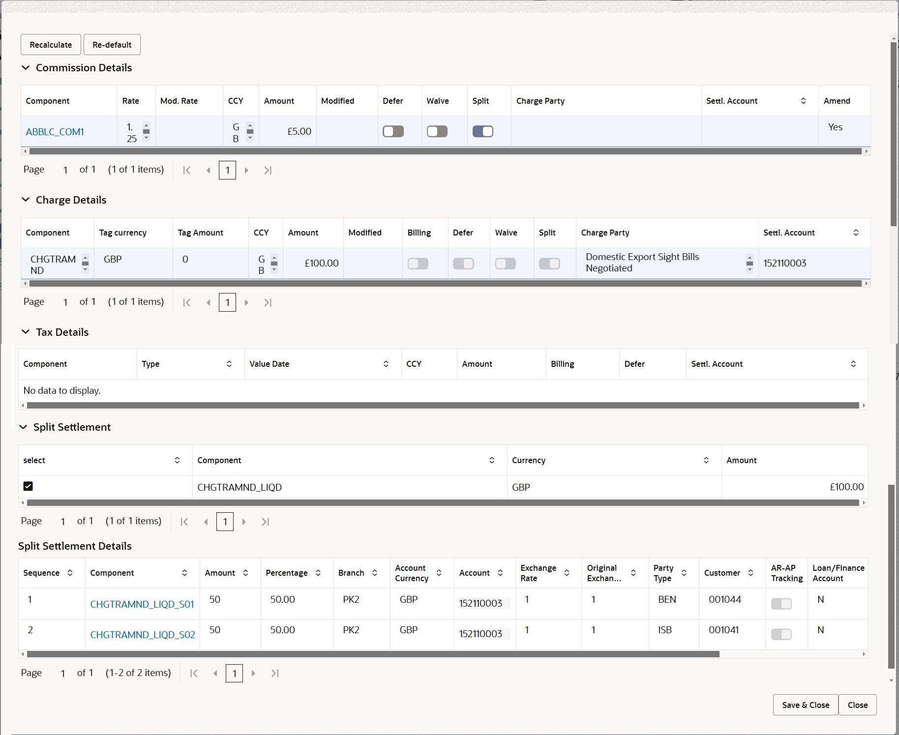

Charge Details
This section displays charge details. If default charges are available under the product, they should be defaulted here with values. If customer or customer group specific charges are maintained, then the same will be defaulted from back end system.
The system also default the Charges/Commission Party maintained for the customer as per defined Class Maintenance in OBTF. System simulates the Charges, Commission and Tax details from the Back office.
Description of the illustration dechargedetails.pngSplit Settlement Details
Description of the illustration desplitsettlementdetails1.pngFor more information on fields, refer to the field description table below.
Table 2-20 Charge Details - Field Description
Field Description Event Read only field. This field displays the event name.
Event Description Read only field. This field displays the description of the event.
Commission Details Component This field displays the commission component. Rate This field displays the rate that is defaulted from product. The commission rate, if available in Back Office defaults in OBTFPM. The user is able to change the rate.
If flat commission is applicable, then commission amount defaulted from back office is modifiable by the user. Rate field will be blank and the user cannot modify the Rate field.
Modified Rate From the default value, if the rate is changed the value gets updated in this field. Currency This field displays the currency in which the commission have to be collected. Amount This field displays the amount that is maintained under the product code. The commission rate, if available in Back Office defaults in OBTFPM. The user is able to change the rate, but not the commission amount directly. The amount gets modified based on the rate changed and the new amount is calculated in back office based on the new rate and is populated in OBTFPM.
Modified Amount From the default value, if the amount is changed, the value gets updated in the modified amount field. Defer If enabled, charges/commissions has to be deferred and collected at any future step. Waive Based on the customer maintenance, the charges/commission can be marked for Billing or Defer. If the defaulted Commission is changed to defer or billing or waive, system must capture the user details and the modification details in the ‘Remarks’ place holder.
Split The user can split the Commission by enabling/ disabling the flag as per the requirement. Charge Party Charge party is 'Applicant' by default. User can change the value to Beneficiary. Settlement Account Select the settlement account. Amend Displays whether the field is amendable or not. Charge Details Component This field displays the charge component type. Tag Currency This field displays the tag currency in which the charges have to be collected. Tag Amount This field displays the tag amount that is maintained under the product code. Currency This field displays the currency in which the charges have to be collected. Amount This field displays the amount that is maintained under the product code. Modified From the default value, if the rate is changed or the amount is changed, the value gets updated in the modified amount field. Billing If charges are handled by separate billing engine, then by selecting billing the details to be available for billing engine for further processing. On simulation of charges/commission from Back Office, if any of the Charges/Commission component for the customer is ‘Billing’ enabled, ‘Billing’ toggle for that component should be automatically enabled in OBTFPM.
The user can not enable/disable the option, if it is de-selected by default.
This field is disabled, if ‘Defer’ toggle is enabled.
Defer If charges have to be deferred and collected at any future step, this check box has to be selected. On simulation of charges/commission from Back Office, if any of the Charges/Commission component for the customer is AR-AP tracking enabled, ‘Defer’ toggle for that component should be automatically checked in OBTFPM.
The user can enable/disable the option the check box. On de-selection the user has to click on ‘Recalculate’ charges button for re-simulation.
Waive Enble the toggle, if charges has to be waived. Based on the customer maintenance, the charges should be marked for Billing or for Defer.
This field is disabled, if Defer toggle is enabled.
Split The bank User can split the Charges/Commission by enabling/disabling the flag as per the requirement. Charge Party Charge party is applicant by default. User can change the value to beneficiary. Settlement Account Select the settlement account. Tax Details The tax component is calculated based on the commission and defaults if maintained at product level. User cannot update tax details and any change in tax amount on account of modification of charges/ commission will be available on click of Re-Calculate button or on hand off to back-end system.
Component This field displays the tax component. Type This field displays the type of tax component. Value Date This field displays the value date of tax component. Currency This field displays the currency in which the tax have to be collected. The tax currency is the same as the commission.
Amount This field displays the tax amount based on the percentage of commission maintained. You can edit the tax amount, if applicable.
Billing If taxes are handled by separate billing engine, then by selecting billing the details to be available for billing engine for further processing. This field is disabled, if ‘Defer’ toggle is enabled.
Defer If taxes have to be deferred and collected at any future step, this option has to be enabled. The user can enable/disable the option the check box. On de-selection the user has to click on ‘Recalculate’ charges button for re-simulation.
Settlement Account System defaults the settlement account. The user can modify the settlement account.

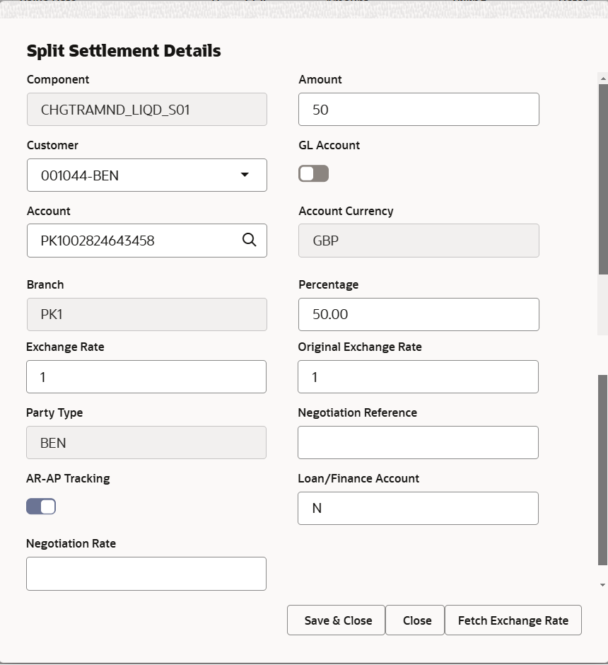

Split Settlement Once the user clicks on the Recalculate button to fetch the Split Settlement details from Backoffice, new section “Split Settlement” will appear below the ‘Tax’ section. The default parties in Split row should be fetched from OBTF.
Component The split component type eligible for Split . Currency The currency of split settlement. Amount The amount of split settlement. Split Settlement Details Split Settlement details section appears from Back office, when the user clicks on the Recalculate button.
Seqence The sequence number is auto populated with the value, generated by the system. Component The split component type eligible for Split. Amount The system splits the respective Charge/Commission amount automatically between counter party and third party with 50% value by default. The bank user can modify the amount.
More than two splits are not allowed.
Customer Indicates the ID of the Customer in Split Settlement Details section. Account The system defaults the settlement account. User can modify the settlement account. System initiates a call to common core tables within OBTFPM to select the account.
Account Currency This field defaults the currency of the account. Branch Indicates the branch of the customer where transaction is getting processed. Percentage The system splits the respective Charge/Commission percentage automatically between counter party and third party with 50% value by default. More than two splits are not allowed.
The system should validate that the total percentage of each component doesn't exceed 100 and the total amount of each component doesn't exceed total component amount.
Exchange Rate System populates the exchange rate maintained. Original Exchange Rate System displays the Original Exchange Rate as simulated in split settlement details section. Party Type System displays the party type in split settlement details section. Negotiation Reference Specify the negotiation reference number. AR-AP Tracking Indicates to defer the charge/ commission in Split Settlement Details section. The user can modify the AR-AP Tracking flag as per the requirements.
Loan/Finance Account Displays the loan account. Negotiation Rate Specify the negotiation rate. - Click Save and Close to save the details and close the

- Click Next.The task will move to next data segment.
For more information on action buttons, refer to the field description table below.
Table 2-22 Additional Details - Action Buttons - Field Description
Field Description Clarification Details Click to open a detailed screen, user can see the clarification details in the window and the status will be Clarification Requested. Documents Click to View/Upload the required document. Application displays the mandatory and optional documents.
The user can view and input/view application details simultaneously.
