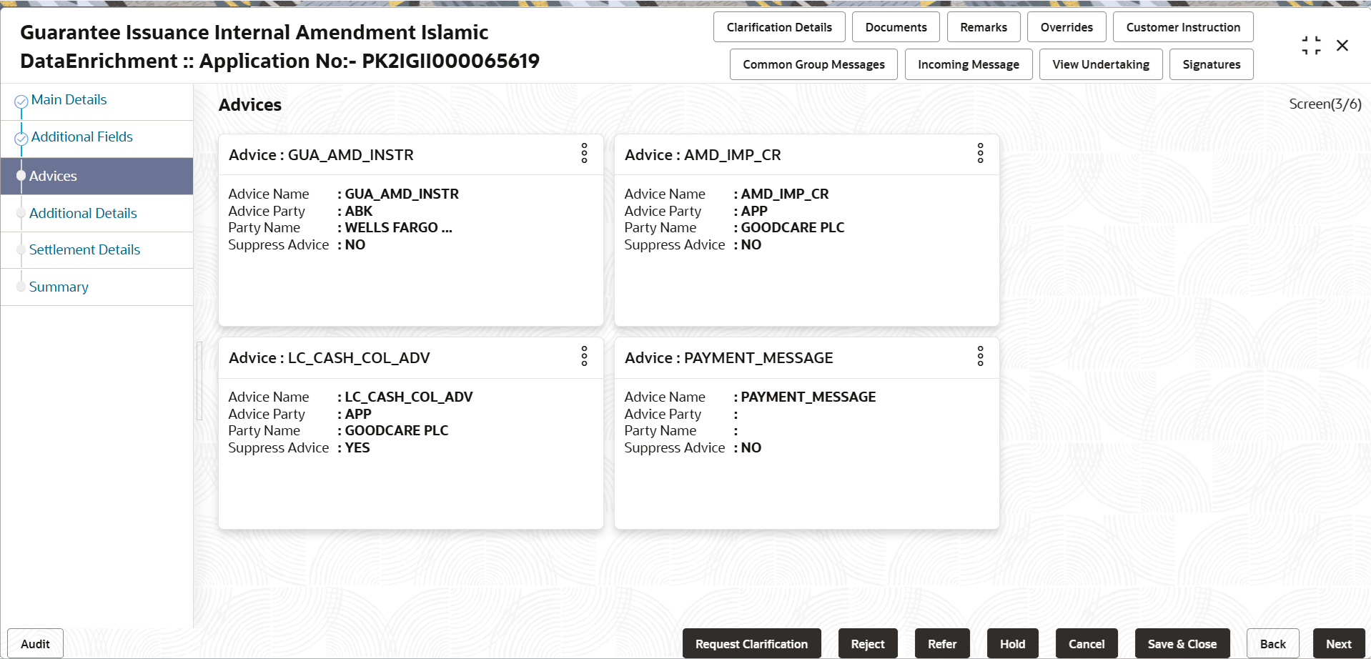

This topic provides the systematic instructions to capture the advices details of Guarantee Issuance Internal Amendment Islamic process.
- On Advices screen, click the 3 dots on any advice tile
to view the advice details.
Figure 2-10 Advices
Description of the illustration deadvices.pngAdvice Details
Description of the illustration deadvicedetails.pngFor more information on fields, refer to the field description table below.
