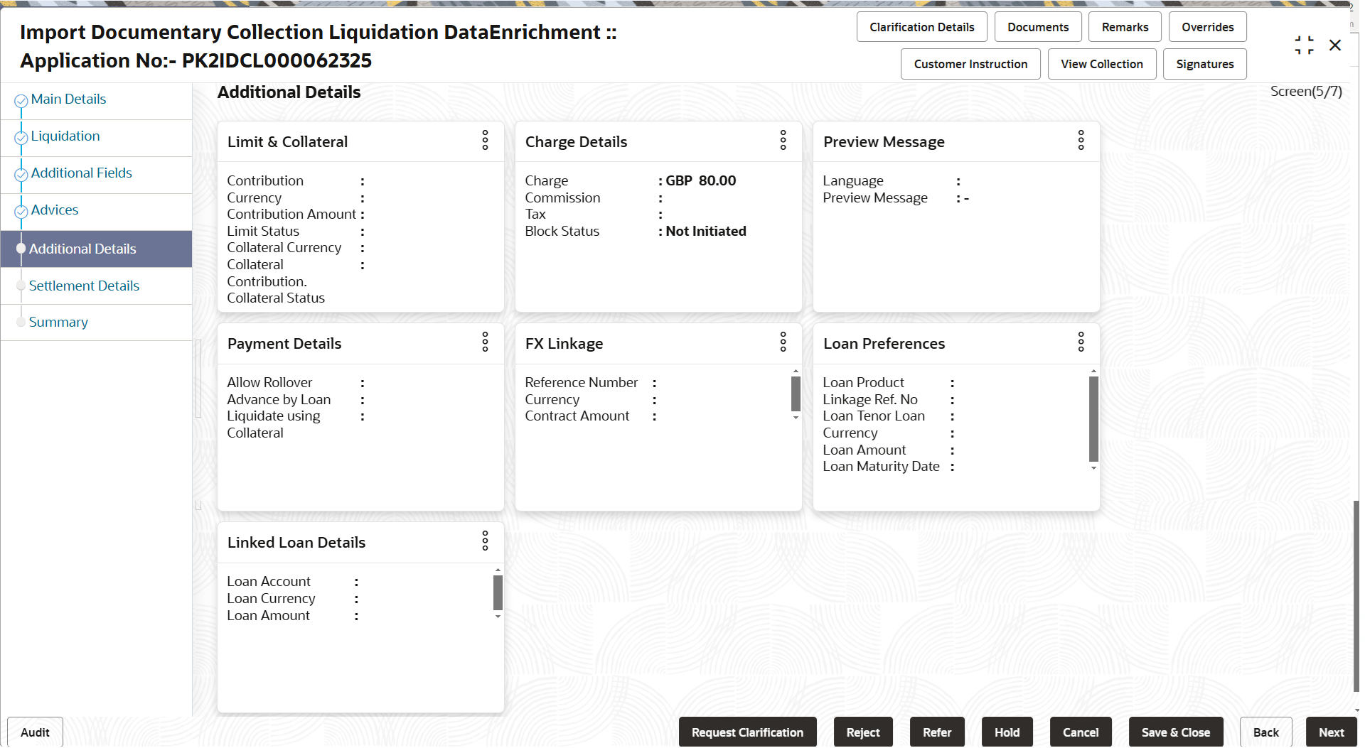

3.3.5 Additional Details
This topic provides the systematic instructions to capture the additional details
- On Additional Details screen, click the 3 dots on any
Additional Details tile to view the details.

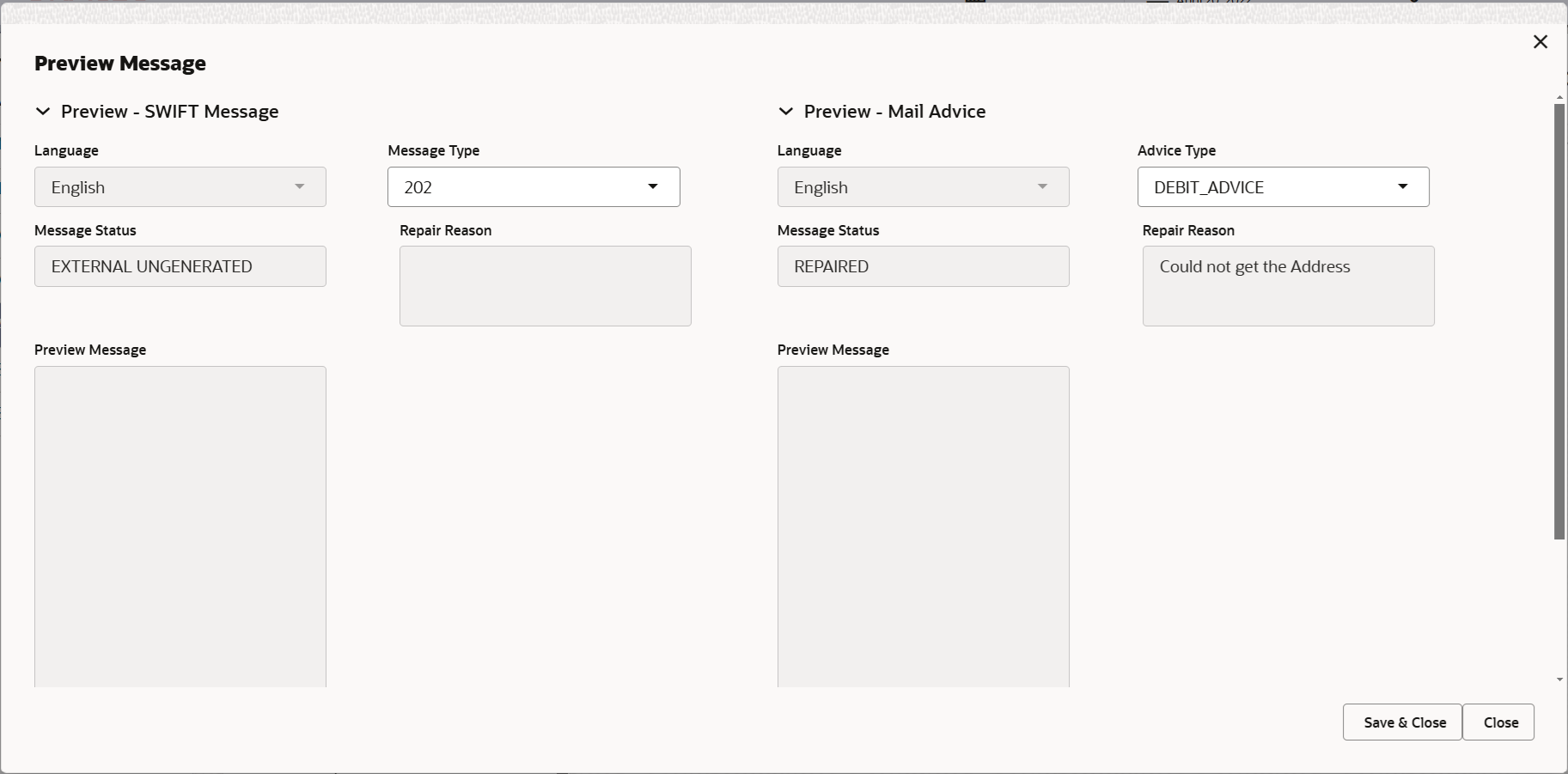

screen.Preview Message
The bank user can view a preview of the outgoing SWIFT message and advise simulated from back office.
Description of the illustration deadditionaldetailspreview.pngFor more information on fields, refer to the field description table below.
Table 3-18 Preview Message - Field Description
Field Description Preview SWIFT Message This section displays the preview of SWIFT Messages fields. Language Read only field. English is set as default language for the preview.
Message Type Select the message type from the drop down. User can choose to see preview of different message like MT 700, MT 740 and MT 701. Message Status Read only field. Display the message status of draft message of liquidation details.
Repair Reason Read only field. Display the message repair reason of draft message of liquidation details.
Preview Message This field displays a preview of the draft message. Preview Mail Advice This section displays the preview of Mail Advice fields. Language Read only field. English is set as default language for the preview.
Advice Type Select the advice type. Message Status Read only field. Display the message status of draft message of liquidation details.
Preview Message This field displays a preview of the draft message. - Click Save and Close to save the details and close the
screen.

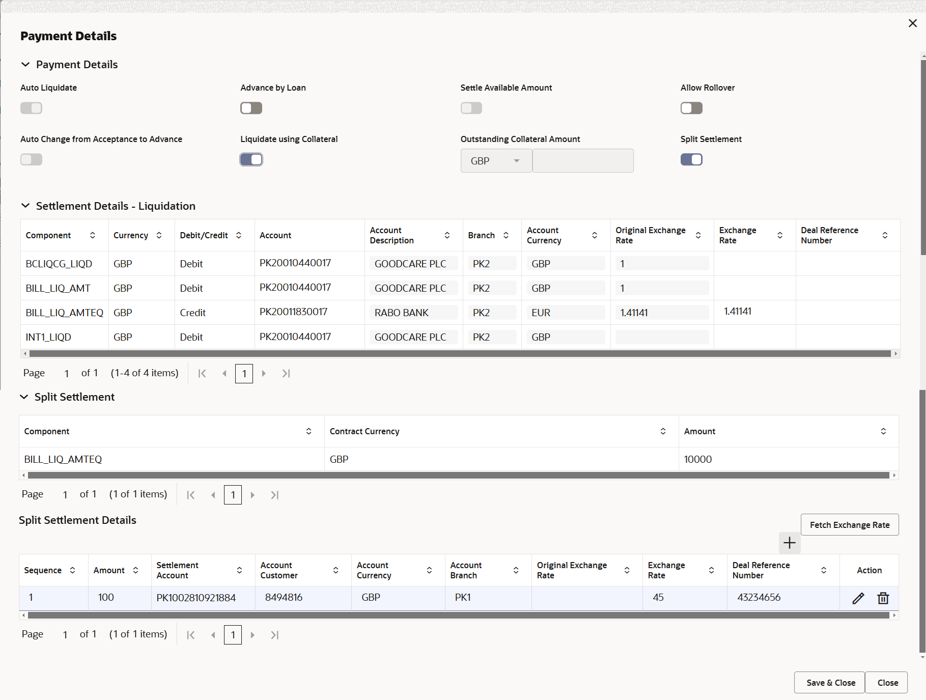

Payment Details
Description of the illustration depaymentdetails.pngFor more information on fields, refer to the field description table below.
Table 3-19 Payment Details - Field Description
Field Description Payment Details Specify the payment details based on the description in the following table: Auto Liquidate Read only field. Auto Liquidation enables liquidation of the bill on the due date automatically from the back office system.
Advance by Loan Switch to
to enable the creation of loan at the time of final
liquidation.
System defaults the value as per the value available in contract in back office. User can change value.Note:
Bill product should support Advance by loan, for enabling Advance by loan at contract level.Settle Available Amount Switch to
, if during settlement, the amount as available in
the CASA account of the customer has to be utilized and for
the balance if a loan has to be availed.
Allow Rollover Switch to
, if rollover is allowed.
Auto Change from Acceptance to Advance Read only field. This
option indicates whether an Acceptance type of
bill should be automatically converted into an Advance
type of bill on its liquidation date.
This option is applicable only for the bills that are co-accepted by the bank.Liquidate using Collateral Switch to
, if liquidation is done using collateral.
Outstanding Collateral Amount Read only field. The outstanding collateral amount along with the currency.
Split Settlement Switch to
, to select more than one account for settlement
(Split Settlement) for the liquidation of an import or
export drawing or collection bill.
Switch to
to disable the user to select more than one
account for settlement (Split Settlement) for the
liquidation of an import or export drawing or collection
bill.
Settlement Details - Liquidation This section displays the Settlement Details - Liquidation details. When Advance by loan option is selected, system simulate and display the settlement details along with split settlement detail for loan component and settlement account as Loan GL as defined at product level. If contract currency and Debit account currency is different system defaults card rate. User can change Exchange rate if there any specific Exchange Rate If FX contract linked, system considers the linked FX for the conversion.
Component This field displays the component based on the product selected. Currency This field displays the currency for the component. Debit/Credit This field displays the debit/credit indicators for the components. Account This field displays the account details for the components. The user can change the account number.
Account Description This field displays the description of the selected account. Branch This field displays the branch of the selected account. Account Currency This field displays the currency for all the items based on the account number. Original Exchange Rate System displays the Original Exchange Rate as simulated in settlement details section from OBTF. Exchange Rate System defaults card rate. User can provide specific rate for the contract for liquidation if contract currency and debit account currency is different. Deal Reference Number The exchange deal reference number. Split Settlement This section displays the Split Settlement details. Component Components gets defaulted based on the product selected. Contract Currency This field displays the default currency for the component. Amount This field displays the amount for each component. This is populated from the transaction details of the drawing. Split Settlement Details Specify the Split Settlement details based on the description in the following table: The user can click + to add multiple Split Settlement Details.
Sequence Indicates the sequence of the settlement details. Amount Specify the amount for the split settlement. Settlement Account Click Search to search and select the settlement account. Account Customer This field displays customer account based on the selected settlement account. Account Currency This field displays currency of the account based on the selected settlement account. Account Branch This field displays branch of the customer’s account. Original Exchange Rate System displays the Original Exchange Rate as simulated in settlement details section from OBTF. Click the Fetch Exchange Rate button, the field displays the exchange rate for the split settlement.
Exchange Rate Specify the exchange rate for the split settlement. Deal Reference Number Specify the exchange deal reference number. Action Click Edit icon to edit the Split Settlement. Click Delete icon to delete the Split Settlement.

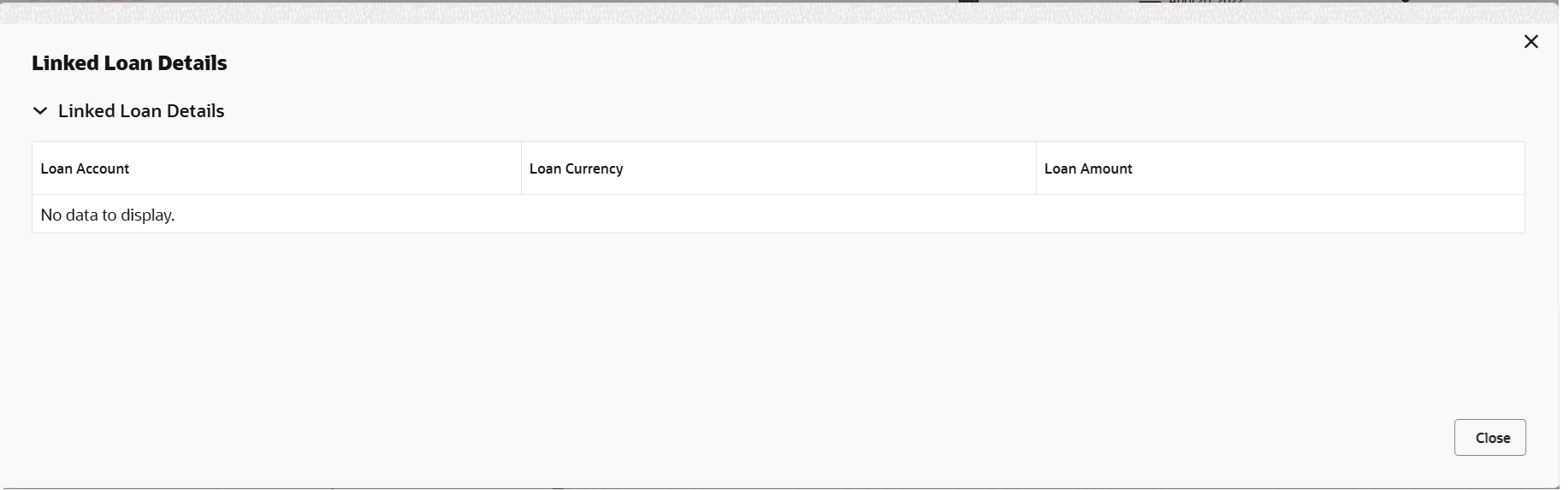

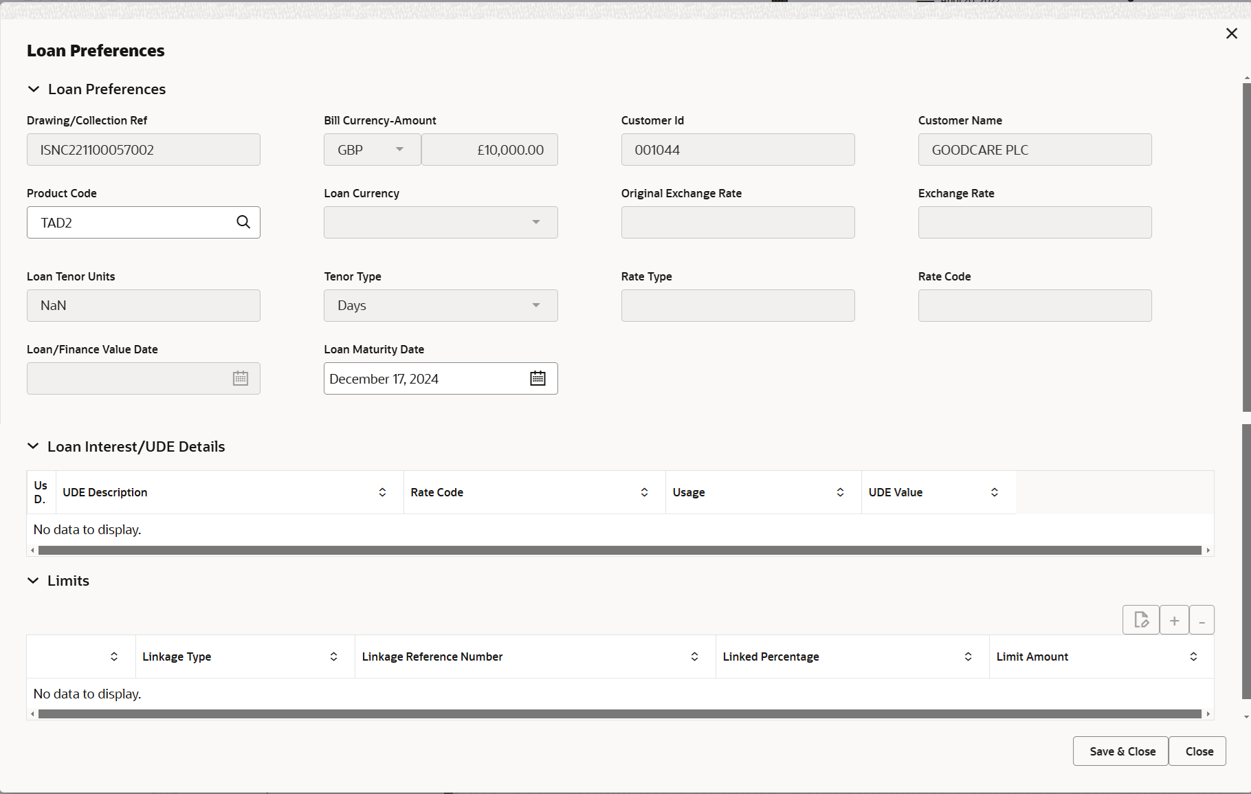

screen.Loan Preferences
This section enables the user to link a loan to liquidate the document under collection. This section will be enabled based on the product selected for documents under collection.
Description of the illustration deloanpreference.pngFor more information on fields, refer to the field description table below.
Table 3-21 Loan Preferences
Field Description Drawing/Collection Ref Defaults from the underlying task. User cannot change the value.
Bill Currency-Amount Outstanding Drawing/ Collection Currency and Amount, defaults from the underlying task. User cannot change the value.
Customer Id Customer Id defaults from the underlying task. User cannot change the value.
Customer Name Applicant/ Drawee Name defaults from the underlying task. User cannot change the value.
Product Code Product Code defaults from the underlying Collection/ Drawing Product maintenance. User can change the value.
Loan Currency-Amount Loan currency is defaulted from the bill currency. System should displays an error message on tab out if the currency is not a Bill currency or Local Currency. If collateral amount is linked to the underlying drawing/ collection bill, the Loan Currency- amount to be utilized for liquidation to be input by the user here.
Original Exchange Rate This field displays the original exchange rate applicable for Local Currency. System displays the Exchange rate from maintenance. User cannot change the value. System validates the exchange rate is within the allowed range.
Exchange Rate The exchange rate. Loan Tenor Units Indicates the period of loan defaults from the underlying task. The numerical value for Days or months or Years is applicable.
Tenor Type System defaults the tenor type. User cannot change the value. Values are Days, Months and Years. The numerical value for Days or months or Years is applicable.
Rate Type Defaults from the underlying task. User cannot change the value.
Rate Code Defaults from the underlying task. User cannot change the value.
Loan/Finance Value Date This field displays the branch date as Value date. User cannot change the value.
Loan Maturity Date Loan maturity date defaults based on Tenor type and Tenor units. Loan Interest/UDE Details User Defined Element ID This field displays the UDE Element ID as part of simulation. UDE Description This field displays the UDE description as part of simulation. Rate Code This field displays the Rate code as part of simulation. Usage This field displays the details as part of simulation. UDE Value This field displays the UDE value as part of simulation. Limits Specify the limit details. Click + to add limits. Clicking the plus icon displays a pop windows and allows the user to select the line code.
Serial Number This field displays the serial number. Linkage Type This field displays the linkage type as “Facility” from back office. Linkage Reference Number This field displays the Linkage reference as part of simulation. User can change the value. Linkages available for the customer should be displayed for selection.
Linked Percentage Specify the value for linked percentage. Maximum value is 100. User cannot enter negative values.
Limit Amount This field displays the value for limit amount. System populates the value based on the contribution percentage.
screen.Linked Loan Details
The bank user can view the details of linked loan accounts.
Description of the illustration delinkedloandetails.pngFor more information on fields, refer to the field description table below.
Table 3-22 Linked Loan Details - Field Description
Field Description Linked Loan Details Loan Account This field displays the loan account number. Loan Currency This field displays the currency of the loan account. Loan Amount This field displays the loan amout. - Click Save and Close to save the details and close the screen.
- Next.The task will move to next data segment.
For more information on action buttons, refer to the field description table below.
Table 3-23 Additional Details - Action Buttons - Field Description
Field Description Clarification Details Clicking the button opens a detailed screen, user can see the clarification details in the window and the status will be 'Clarification Requested'. Documents View/Upload the required document. Application displays the mandatory and optional documents.
The user can view and input/view application details simultaneously.
When a user clicks on the uploaded document, Document window get opened and on clicking the view icon of the uploaded document, Application screen should get split into two. The one side of the document allows to view and on the other side allows to input/view the details in the applicationRemarks Specify any additional information regarding the collection. This information can be viewed by other users processing the request. Content from Remarks field should be handed off to Remarks field in Backend application.
Overrides Click to view the overrides accepted by the user. Customer Instructions Click to view/ input the following - Standard Instructions – In this section, the system will populate the details of Standard Instructions maintained for the customer. User will not be able to edit this.
- Transaction Level Instructions – In this section, OBTFPM user can input any Customer Instructions received as part of transaction processing. This section will be enabled only for customer initiated transactions.
View Collection Enables the user to view the latest collection values displayed in the respective fields. Signatures Click the Signature button to verify the signature of the customer/ bank if required. The user can view the Customer Number and Name of the signatory, Signature image and the applicable operation instructions if any available in the back-office system.
If more than one signature is required, system should display all the signatures.
Request Clarification User can specify the clarification details for requests received online. Save & Close Save the details provided and holds the task in ‘My Task’ queue for further update. This option will not submit the request. Cancel Cancel the Data Enrichment stage inputs. The details updated in this stage are not saved. The task will be available in 'My Task' queue. Hold The details provided will be saved and status will be on hold.User must update the remarks on the reason for holding the task. This option is used, if there are any pending information yet to be received from applicant.
Reject On click of Reject, user must select a Reject Reason from a list displayed by the system. Reject Codes are:
- R1- Documents missing
- R2- Signature Missing
- R3- Input Error
- R4- Insufficient Balance/Limits
- R5 - Others
Select a Reject code and give a Reject Description.
This reject reason will be available in the remarks window throughout the process.Refer Select a Refer Reason from the values displayed by the system. Refer Codes are:
- R3- Input Error
- R5 - Others
Back On click of Back, system moves the task back to previous data segment. Next On click of Next, system validates if all the mandatory fields have been captured. Necessary error and override messages to be displayed. On successful validation, system moves the task to the next data segment.
