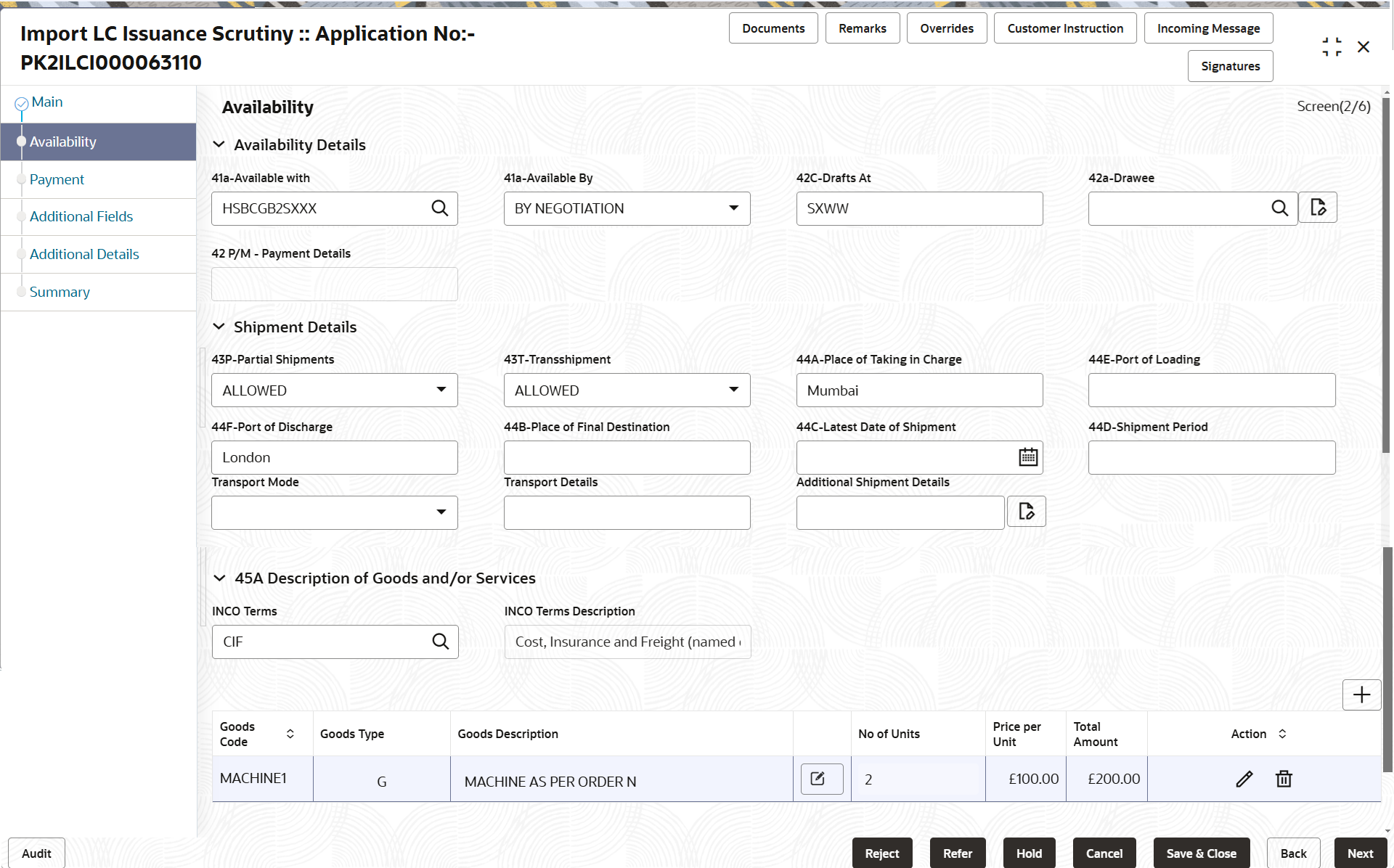

This topic provides the systematic instructions to capture the availability details.
- On Availability screen, specify the fields.
For more information on fields, refer to the field description table below.
Table 2-11 Availability - Field Description
Field Description Availability Details Specify the availibility details based on the description of following table. Available with Click Search to search and select the bank with which the credit is available, in case of Non - Online channel. - If the LC is restricted to any particular bank, search the bank with SWIFT code (BIC) or Bank Name.
On selection of the record if SWIFT code is available, then SWIFT code will be defaulted. If SWIFT code is not available then the bank's name and address gets defaulted.- If the LC is not restricted to any bank, provide free text - (YOURSELVES, WITH ANY BANK etc.).
In case of Online channel, this field is read only.
Available By Select the available by from the drop-down list, in case of Non - Online channel. The options are:
- BY NEGOTIATION
- BY PAYMENT
If BY PAYMENT option is selected, payment at sight is applicable.It is applicable for Sight Type of product only.In case of Online channel, this field is read only.
Drafts At Specify the draft details. This field specifies the tenor of drafts to be drawn under the documentary credit.
Drawee Click Search to search and select the Drawee bank (Advising bank or Confirming bank). This field will have value only if Drafts At field has values.
- Search the bank with SWIFT code (BIC) or Bank Name.
On selection of the record if SWIFT code is available, then SWIFT code will be defaulted. If SWIFT code is not available then the bank's name and address to be defaulted.Note:
This field is mandatory if value is provided at Drafts At fieldPayment Details Specify the payment details if, Available By field has value as BY NEGOTIATION. Shipment Details. Specify the shipment details based on the description of following table. Partial Shipments Select the partial shipment details from the drop-down list, in case of Non - Online channel. This field specifies whether or not partial shipments are allowed under the documentary credit.
The options are:
- Allowed
- Conditional
- Not Allowed
Transshipment Select the transshipment details from the drop-down list, in case of Non - Online channel. This field specifies whether or not transshipment are allowed under the documentary credit.
The options are:
- Allowed
- Conditional
- Not Allowed
Place Of Taking In Charge Specify the details of place of taking in charge (in case of a multi-modal transport document), the place of receipt (in case of a road, rail or inland waterway transport document or a courier or expedited delivery service document), the place of dispatch or the place of shipment to be indicated on the transport document for non-online channel. In case of Online channel, this field is read only.
This field is alternate to Port Of Loading. Any of these fields must have value and if both the fields has values, application will display an error messagePort Of Loading Specify the details of Port/Airport of Loading to be indicated on the transport document, in case of non-online channel. In case of Online channel, this field is read only.
This field is alternate to Place Of Taking In Charge. Any of these fields must have value and if both the fields has values, application will display an error message.Port Of Discharge Specify the details of the port of discharge or airport of destination to be indicated on the transport document, in case of non-online channel. In case of Online channel, this field is read only.
This field is alternate to Place Of Final Destination. Any of these fields must have value and if both the fields has values, application will display an error message.Place Of Final Destination Specify the details of Place of final destination or place of delivery to be indicated on the transport document, in case of non-online channel. In case of Online channel, this field is read only.
This field is alternate to Port Of Discharge. Any of these fields must have value and if both the fields has values, application will display an error message.Latest Date Of Shipment Select the latest date for loading on board/dispatch/taking in charge. Note:
This field is alternate to Shipment Period. Latest date of shipment or shipment period must have value and if both the fields has values, application will display an error message.Shipment Period Specify the details of shipment period. Note:
This field is alternate to Latest Date Of Shipment.. Latest date of shipment or shipment period must have value and if both the fields has values, application will display an error message.Transport Mode Select the transportation mode. The options are:- Air
- Sea
- Road
- Rail
- Multimodal
- Other
Transport Details Specify the transportation details of shipment. Additional Shipment Details Specify the transportation additional shipment details, if any. Description of Goods and/or Services Specify the description of goods and/or services based on the description of following table. INCO Terms Click Search to search and select the INCO terms from the document received, in case of non-online channel. In case of Online channel, this field is read only.
INCO Terms Description System displays the description of the INCO term based on selected INCO Terms.
Click + to add multiple descrption of goods and services. Goods Code Click Search to search and select the goods code. Once you select goods code, value will default in Goods Type and Goods Description. Goods Type This field displays the goods type depending on selected goods code. Goods Description The goods description is auto populated depending on selected goods code. The user can edit the goods description.
No of Units Specify the number of units being imported or exported. Price per Unit Specify the value for price per unit. Total Amount System calculates the total price. In case of online request, the system should populate the total amount from incoming request. System validates that the total amount is equal to the value of the transaction (LC/Collection). Action Click Edit icon to edit the goods code. Click Delete icon to delete the goods code.
