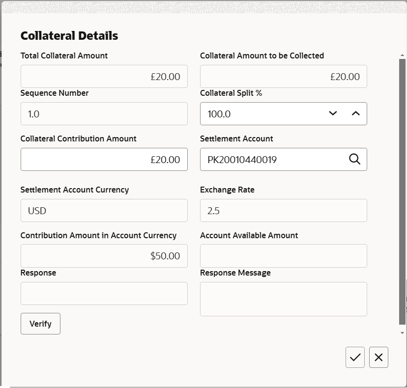

Click delete icon to delete the existing limit details. Cash Collateral Details Specify the Collateral details based on the description of following table: Collateral Percentage System populates the Collateral % maintained in the Customer / Product for the counter party of the contract. User can modify the collateral percentage.
Specify the percentage of collateral to be linked to this transaction. If the value is more than 100% system will display an alert message. The collateral % maintained for the customer is defaulted into the Collateral Details screen. If collateral % is not maintained for the customer, then system should default the collateral % maintained for the product. User can modify the defaulted collateral percentage, in which case system should display a override message “Defaulted Collateral Percentage modified.
Collateral Currency and amount System populates the contract currency as collateral currency by default. User can modify the collateral Currency and amount.
Exchange Rate System populates the exchange rate maintained. System validates for the Override Limit and the Stop limit if defaulted exchange rate is modified.
Click plus icon to add new collateral details. Collateral Details Below fields are displayed on the Collateral Details pop-up screen, if the user clicks plus icon. Total Collateral Amount Read only field. This field displays the total collateral amount provided by the user.
Collateral Amount to be Collected Read only field. This field displays the collateral amount yet to be collected as part of the collateral split.
Sequence Number Read only field. The sequence number is auto populated with the value, generated by the system.
Collateral Split % Specify the collateral split% to be collected against the selected settlement account. Collateral Contribution Amount Specify the collateral amount to be collected against the selected settlement account. User can either provide the collateral % where the collateral amount will be auto populated or modifying the collateral amount will auto correct the collateral %.
Settlement Account Click Search to search and select the settlement account for the collateral. Settlement Account Currency Read only field. This field displays the settlement account currency defaulted by the system.
Exchange Rate Read only field. This field displays the exchange rate, if the settlement account currency is different from the collateral currency.
Contribution Amount in Account Currency Read only field. This field displays the contribution amount in the settlement account currency as defaulted by the system.
Account Available Amount Read only field. System populates the account available amount on clicking the Verify button.
Response Read only field. System populates the response on clicking the Verify button.
Response Message Read only field. System populates the response message on clicking the Verify button.
Verify Click to verify the account balance of the Settlement Account. Save Click to to save and close the record. Close Click to cancel the entry. Cash Collateral Details grid Below fields appear in the along with the above fields. Contribution Amount This field displays the collateral contribution amount. The collateral % maintained for the customer is defaulted into the Collateral Details screen. If collateral % is not maintained for the customer, then system should default the collateral % maintained for the product. User can modify the defaulted collateral percentage, in which case system should display a override message “Defaulted Collateral Percentage modified.
Account Balance Check Response This field displays the account balance check response. Edit Click edit link to edit the collateral details.
Click delete icon to delete the existing collateral details. Account Available Amount This field displays the account available amount which will be auto-populated based on the settlement account selection. Deposit Linkage Details Specify the deposit linkage details based on the description of following table: System should allow the user to Link one or more existing Deposits as a contribution to secure underlying transactions. On Submit of DE stage, system will create Linkage of the Deposit/modification of existing Linkage by calling Back-office system (DDA) system directly.

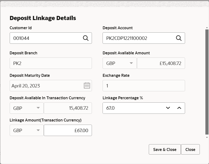

Click plus icon to add new deposit linkage details. Below fields are displayed on the Deposit Linkage Details pop-up screen, if the user clicks plus icon.
Customer Id This field displays the defaulted from the application. The user can change the Customer ID.
Deposit Account Click Search to search and select deposit for linkage from the list of all the customer Deposits. All the Deposits of the customer should be listed in the LOV search. User should be able to select the deposit for linkage.
Deposit Branch Read only field. This field displays the deposit branch which will be auto-populated based on the deposit account selection.
Deposit Available Amount Read only field. This field displays the deposit available amount and currency which will be auto-populated based on the deposit account selection.
Deposit Maturity Date Read only field. This field displays the maturity date of deposit based on the deposit account selection.
Exchange Rate Read only field. This field displays the latest exchange rate for deposit linkage.
This will be picked up from the exchange rate maintenance from the common core.
Deposit Available In Transaction Currency Read only field. This field displays the deposit amount available, after exchange rate conversion, if applicable.
Linkage Percentage % Specify the value for linkage percentage. Linkage Amount (Transaction Currency) This field displays the transaction amount, user can change the value. System validates the linking amount with available Deposit balance and should not allow to link more than the available amount.
Deposit Details grid Below fields appear in the Deposit Details grid along with the above fields. Deposit Currency This field displays the deposit currency. Transaction Currency This field displays the transaction currency. Edit Click edit link to edit the deposit linkage details.
Click delete icon to delete the existing deposit linkage details. - Click Save and Close to save the details and close the

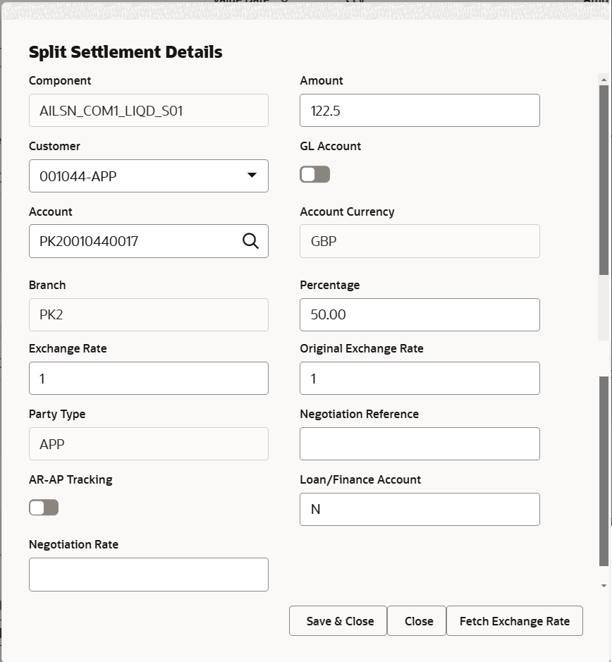

Split Settlement This section displays the Split Settlement. This section is displayed if the user clicks on the Recalculate button to fetch the Split Settlement details from Backoffice.
The default parties in Split row should be fetched from OBTF.
Select The option to select the split settlement record. Component Displays the split component type eligible for Split . Currency Displays the currency of split settlement. Amount Displays the amount of split settlement. Split Settlement Details This section displays the Split Settlement details. Split Settlement details section appears from Back office, when the user clicks on the Recalculate button. Seqence Displays the sequence number is auto populated with the value, generated by the system. Component Displays the split component type eligible for Split. Amount The system splits the respective Charge/Commission amount automatically between counter party and third party with 50% value by default. The bank user can modify the amount.
More than two splits are not allowed.
Customer Indicates the ID of the Customer in Split Settlement Details section. GL Account The system defaults the GL account. Account The system defaults the Settlement account. User can modify the settlement account. System initiates a call to common core tables within OBTFPM to select the account.
Account Currency This field defaults the currency of the account. Branch Indicates the branch of the customer where transaction is getting processed. Percentage The system splits the respective Charge/Commission percentage automatically between counter party and third party with 50% value by default. More than two splits are not allowed.
The system should validate that the total percentage of each component doesn't exceed 100 and the total amount of each component doesn't exceed total component amount.
Exchange Rate System populates the exchange rate maintained. Original Exchange Rate Displays the Original Exchange Rate as simulated in split settlement details section. Party Type Displays the party type in split settlement details section. Negotiation Reference Specify the negotiation reference number. AR-AP Tracking Indicates to defer the charge/ commission in Split Settlement Details section. The user can modify the AR-AP Tracking flag as per the requirements.
