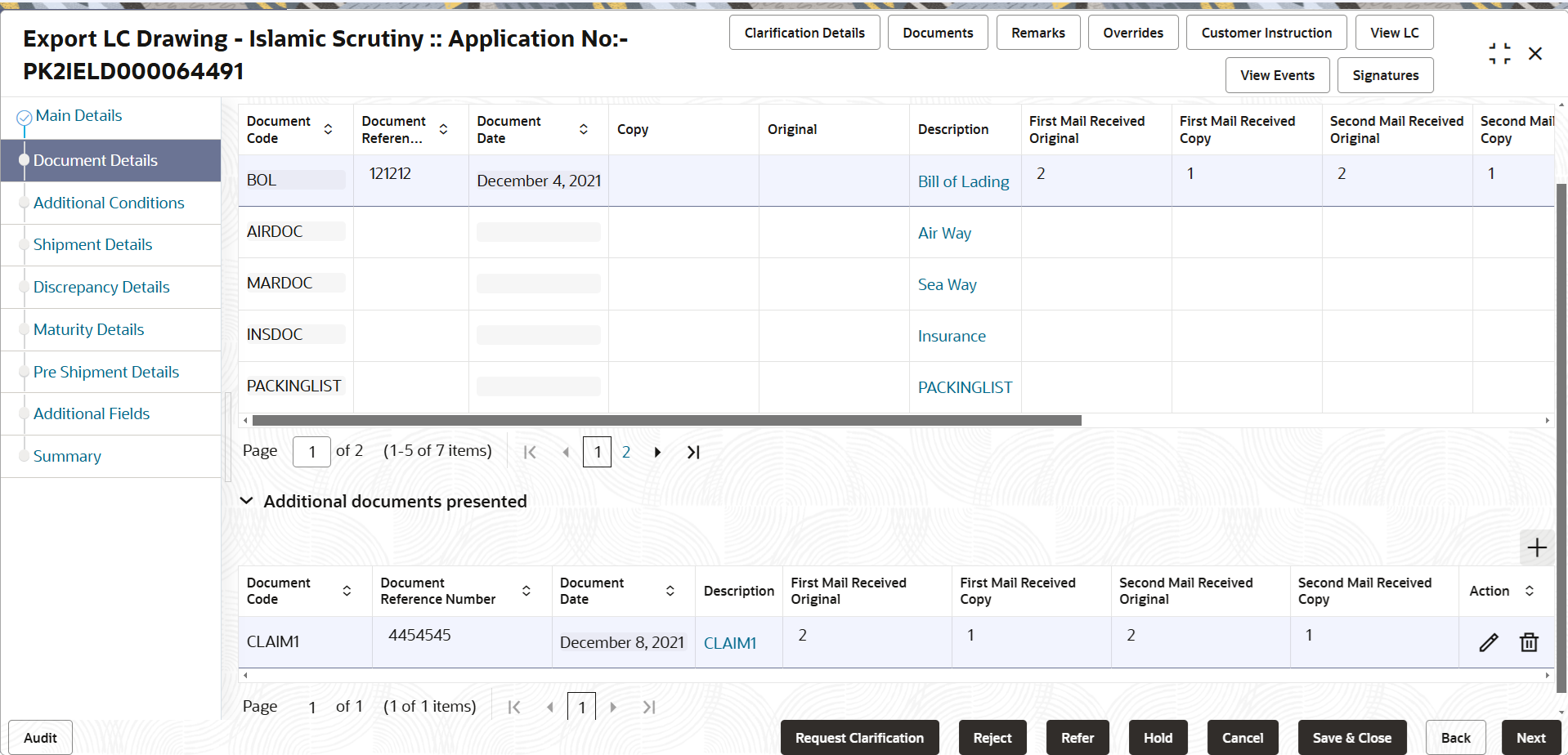

2.3.2 Document Details
This topic provides the systematic instructions to capture the details of the documents received.
- On Document Details screen, specify the fields.
Figure 2-9 Scrutiny - Document Details
Description of the illustration scrutinydocumentdetails.pngFor more information on fields, refer to the field description table below.
Table 2-10 Document Details - Field Description
Field Description Document Details - As per LC This table will fetches the document details as maintained in the underlying LC(LCDTRONL). User can modify the details only which are fetched from underlying LC. User can not add or delete any document details. Once bill drawing is authorized and if update drawing is processed, details of this table will be fetched from underlying bill drawing. Document Code Document code is auto-populated from the latest LC. User can add or delete the code by deleting the line on the grid.
Document Reference Number Specify the reference number available in the documents. Document Date Displays the document date. The user can change the date.Note:
If “Document date” is more than “Shipment Date” system displays an override alert.Copy Number of duplicate copies of documents as required in LC. Original Number of documents in original as required in LC. Description Displays the description of the document required as per LC. Click the link to view the description of the document.
First Mail Received Original The number of originals of documents received from first mail. First Mail Received Copy The number of duplicate copies of documents received from first mail. Second Mail Received Original The number of originals of documents received from second mail. Second Mail Received Copy The number of duplicate copies of documents received from second mail. Document Clause Displays the document clause. Click the link to view the document clause.
Received Description Defaults the description of the documents received from presenting bank. The user can edit the description.
Discrepant System marks the discrepant toggle as ‘Yes’ if there is difference between number of documents required and number of documents received. The user to change, if any discrepancy identified in the document.
Discrepancy Code Click Search to search and select the discrepancy code based on the discrepancy identified. This field is enabled if Discrepant option is enabled.
Discrepancy Description This field displays the description based on the discrepancy code. Action Click Edit icon to edit the document code. Additional documents presented This table fetches document details as maintained for the specific bill drawing product (BCDPRMNT). Here user can add/modify/delete additional document received, if any, during bill drawing. Once bill drawing is authorized, details from this table will be fetched in update drawing operation also.
The user can click + to add multiple document details.
Document Code Document code is auto-populated from the latest LC. User can click plus + icon and click Search to search and select the document code for the additional documents presented.
The User is not allowed to add any document code which is already existing in any of the two tables.Document Reference Number Specify the document reference number of the documents linked. Document Date Provide the document date of the underlying document. Note:
If “Document date” is more than “Shipment Date” system displays an override alert.Description Displays the description of the additional documents based on the document code selected. Click the link to view the description of the document.
Copy Number of duplicate copies of documents as required in LC. User can edit the actual copies received. Original Number of documents in original as required in LC. User can edit the actual originals received. Description Displays the description of the document required as per LC. First Mail Received Original Specify the number of originals of documents received from first mail. First Mail Received Copy Specify the number of duplicate copies of documents received from first mail. Second Mail Received Original Specify the number of originals of documents received from second mail. Second Mail Received Copy Specify the number of duplicate copies of documents received from second mail. Action Click Edit icon to edit the document code. Click Delete icon to delete the document code.
The User can not be able to delete any document detail fetched from previous operation.For LC Not Advised by Us: The LC terms documents will be inactive. The user must read the description available in the documents and compare them with the description as per LC terms and will mark them if discrepant and provide discrepancy description.If there are additional documents received from the beneficiary that has not be requested through LC, user must add them.
