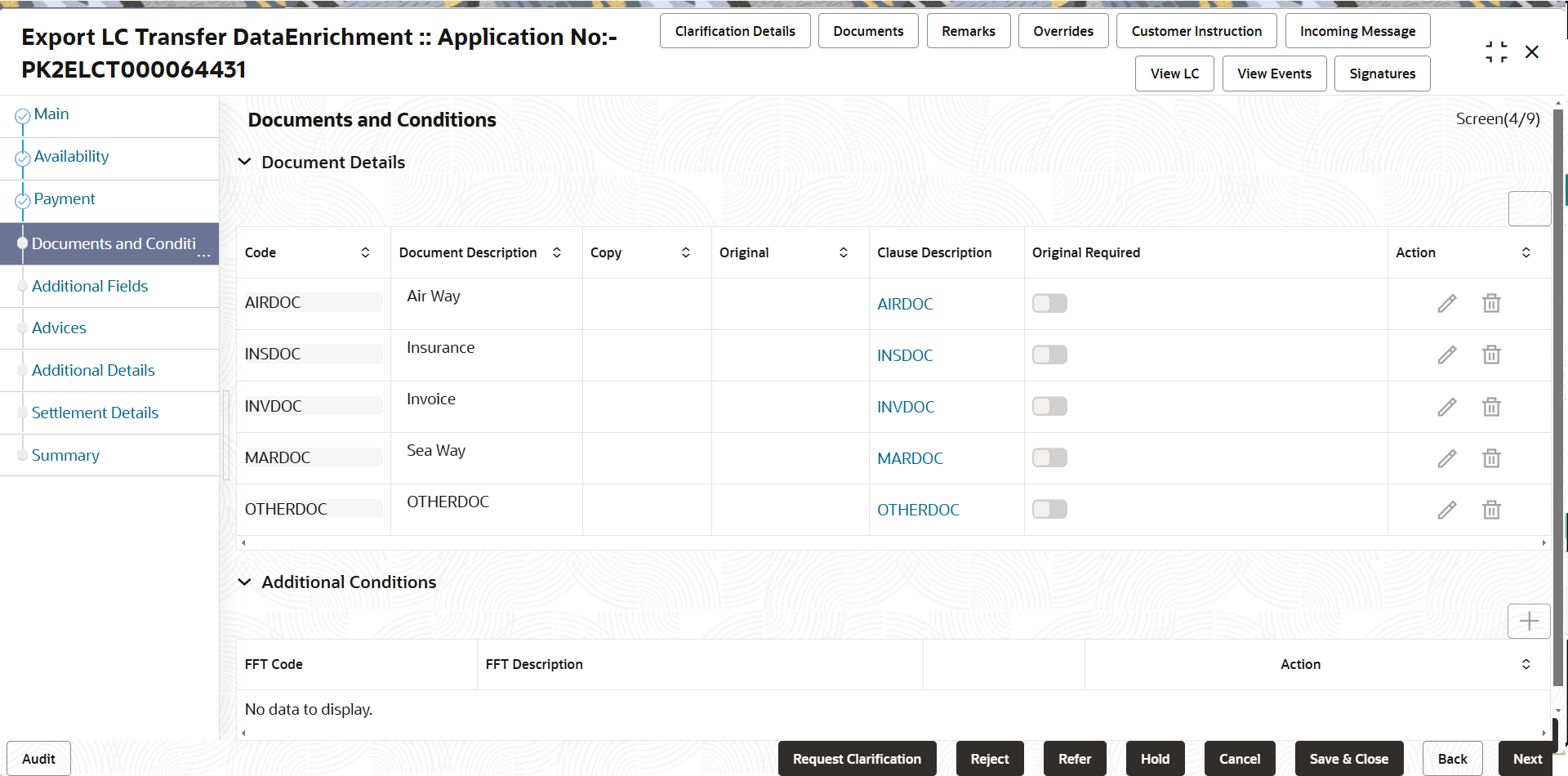

- On Document Details screen, specify the fields.
Figure 2-20 Data Enrichment - Document Details
Description of the illustration dedocumentandconditions.pngFor more information on fields, refer to the field description table below.
Table 2-20 Document Details - Field Description
Field Description Document Code System defaults the document code. User can add the document code by clicking the plus icon.Click Search to search and select the document code based on the document received.
User can add or delete the code by deleting the line on the grid.
Document Description System dispalys the document description based on the document code from the latest LC. Copy System defaults the number of duplicate copies of documents as required in LC. User can edit the actual copies received. Specify the number copies received.
Original System defaults the number of documents in original as required in LC. User can edit the actual originals received. Specify the number of original documents received.
Clause Description System populates the description of the clause required as per LC. User can view the description of the clause by clicking the link in the ‘Document Clause’ column.
Original Required System defaults the value to display whether original document is required or not. Enable the option, if original document is required.
Action Click Edit icon to edit the document details. Click Delete icon to delete the document details.
Additional ConditionsOnline Channel - System will default the details received in the description column. System will parse the additional conditions required field into multiple line items based on line de-limiter (+) and shall populate each line item as a separate description. User can read the description and make any changes required to the description, also must be able to add more conditions.
Non Online Channel - User can use FFT to capture additional conditions and can edit the description populated from FFT. User should also be able to add additional FFT.
For more information on fields, refer to the field description table below.Table 2-21 Additional Conditions - Field Description
Field Description FFT Code Click Search to search and select the FFT code from the look up. The user can click + to add multiple Additional Conditions.
FFT Description This field displays the description of the FFT code based on the selected FFT code. Action Click Edit icon to edit the additional condition details. Click Delete icon to delete the additional condition details.
