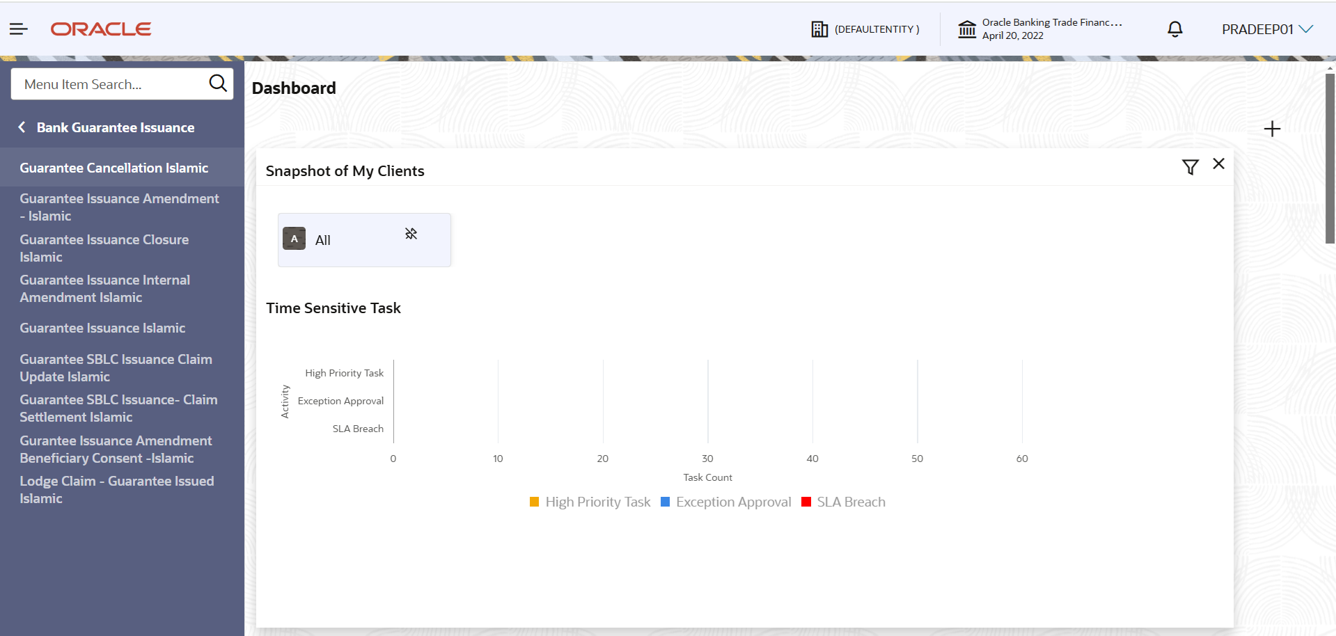

- On Home screen, click Trade Finance - Islamic. Under Trade Finance - Islamic, click Bank Guarantee Issuance.
- Under Bank Guarantee Issuance, click
Guarantee Cancellation - Islamic.

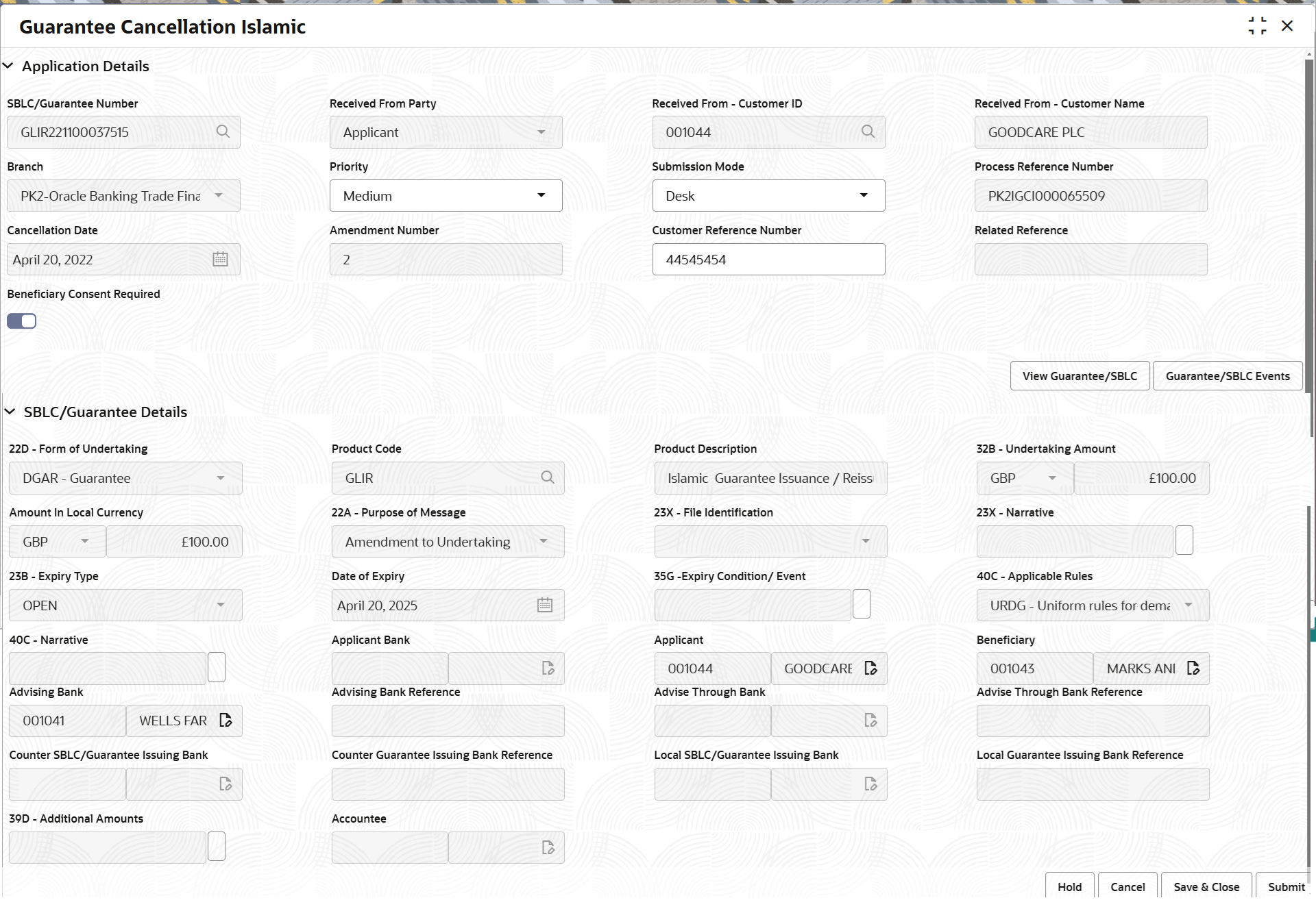

The Guarantee Cancellation - Islamic - Registration screen appears.The Guarantee Cancellation - Islamic - Registration stage has two sections Application Details and SBLC/Guarantee Details. Let’s look at the details of Registration screens below:
Figure 2-4 Guarantee Cancellation - Islamic - Registration - Application Details
Description of the illustration registrationapplicationdetails.png - On Guarantee Cancellation - Islamic - Registration - Application
Details screen, specify the fields.
The fields which are marked as Required are mandatory.For more information on fields, refer to the field description table below.
Table 2-3 Guarantee Cancellation - Islamic - Registration - Application Details - Field Description
Field Description SBLC/Guarantee Number Click Search to search and select the SBLC/Guarantee number of the Guarantee to be cancelled from the look-up. Alternatively, specify the advising SBLC/Guarantee number.
In the look-up search, user can specify the Undertaking Number, Applicant, Currency, Amount and User Reference to fetch the Guarantee details. Based on the search result, select the applicable Guarantee to be cancelled.
Received from Applicant Bank Read only field. System defaults the name of the apllicant as available in Guarantee.
Received From - Customer ID Read only field. Customer ID is auto-populated from Guarantee /SBLC Issuance.
Received From - Customer Name Read only field. Customer name is auto-populated from Guarantee /SBLC Issuance.
Branch Read only field. Branch details is auto-populated from Guarantee /SBLC Issuance.
Priority System populates the priority of the customer based on priority maintenance, also enables the user to change the priority as per the requirement. Set the priority of the Guarantee Cancellation - Islamic request as Low/Medium/High/Essentical/Critical. If priority is not maintained for a customer, Medium priority will be defaulted.
Submission Mode System populates the submission mode of the Guarantee Cancellation request. By default the submission mode will have the value as ‘Desk’.
- Desk - Request received through Desk
- Email - Request received through Email
- Fax - Request received through Fax
The user can change the submission mode.
Process Reference Number Unique sequence number for the transaction. This is auto generated by the system based on process name and branch code.
Cancellation Date By default, the application will display branch’s current date. Amendment Number Read only field. Amendment number is auto-populated based on the system maintenance.
Amendment number increases by 1 for each amendment.
Customer Reference Number Specify a unique Customer Reference Number which is provided by the applicant/applicant bank. Enables the user to provide a unique Customer Reference Number for the cancellation.
Related Reference Read only field. Related reference number is auto-populated based on the system maintenance.
Beneficiary Consent Required Enable the option, if beneficiary consent is required for cancellation. Disable the option, if beneficiary consent is not required for cancellation.

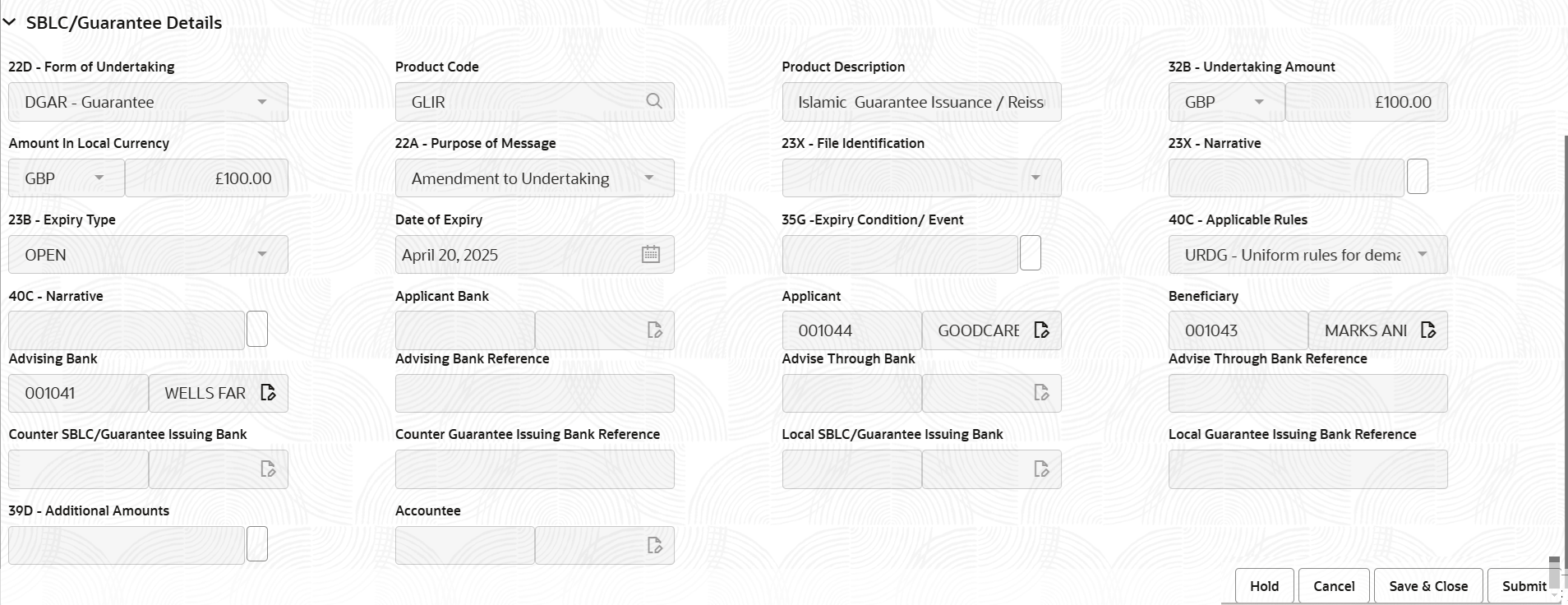

SBLC/Guarantee DetailsRegistration user can provide SBLC/Guarantee details in this section. Alternately, details can be provided by Data Enrichment user.
Description of the illustration registrationguaranteedetails.png - On Guarantee Cancellation - Islamic - SBLC/Guarantee
Table 2-4 Guarantee Cancellation - Islamic - Registration - SBLC/Guarantee Details - Field Description
Field Description Form of Undertaking Read only field. Form of undertaking is auto-populated from Guarantee /SBLC Issuance.
Product Code Read only field. Product code is auto-populated from guarantee /SBLC issuance.
Product Description Read only field. This field displays the description of the product as per the product code.
Undertaking Amount Read only field. System defaults the outstanding value available in guarantee.
Amount In Local Currency Read only field. System fetches the local currency equivalent value for the LC amount from back office (with decimal places).
Purpose of Message Read only field. System defaults the purpose of message value from guarantee.
The values are:- ISSU - Issue of Undertaking:
- ICCO - Issuance of counter-counter-undertaking
- ISCO - Issuance of counter undertaking
File Identification Read only field. System defaults the file identification value available in guarantee.
Narrative Read only field. System defaults the value available in guarantee.
Expiry Type Read only field. System defaults the expiry type as maintained in guarantee issuance.
Date of Expiry Read only field. System defaults the expiry date of the guarantee.
Expiry Condition/Event Read only field. System defaults the expiry condition/event value available in guarantee.
Applicable Rules Read only field. This field displays the rules of the guarantee.
Narrative Read only field. System defaults the narrative available in guarantee.
Applicant Bank Read only field. This field displays the applicant bank details available in guarantee.
Applicant Read only field. This field displays the details of the applicant available in guarantee.
Beneficiary This field displays the beneficiary details of the selected guarantee and user can edit the details if required.
Advising Bank Read only field. This field displays the details of the advising bank.
Advise Bank Reference Read only field. This field displays the advising bank reference if available.
Advising Through Bank Read only field. System defaults the advising through bank value available in guarantee.
Advise Through Bank Reference Read only field. This field displays the advising bank reference if available.
Counter SBLC/Guarantee Issuing Bank Read only field. System defaults the counter SBLC/guarantee issuing bank details available in guarantee.
Counter Guarantee Issuing Bank Reference Read only field. System defaults the counter SBLC/guarantee issuing bank reference value available in guarantee.
Local SBLC/Guarantee Issuing Bank Read only field. System defaults the local SBLC/guarantee issuing bank details available in Guarantee.
Local Guarantee Issuing Bank Reference Read only field. System defaults the local SBLC/guarantee issuing bank reference value available in Guarantee.
Additional Amounts Read only field. This field displays the details of the additional amount covered as per the latest guarantee details.
