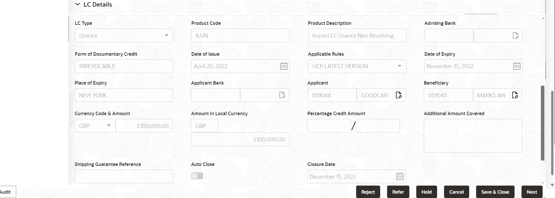

LC DetailsThe fields listed under this section are same as the fields listed under the LC Details section in Registration. All fields displayed in LC details section are read only fields.
Figure 2-8 LC Details
Description of the illustration demainlcdetails.pngTable 2-6 Main Details - Liquidation Details - Field Description
Field Description LC Type Read only field. LC type will be populated based selected LC using documentary credit number.
Product Code Read only field. This field displays the product code of the selected LC.
Product Description Read only field. This field displays the description of the product as per the product code.
Advising Bank Read only field. This field displays the advising bank details (if provided) of the selected LC.
Form of Documentary Credit Read only field. This field displays the form of documentary credit details of the selected LC.
Date of Issue Read only field. This field displays the LC issuance date.
Applicable Rules Read only field. This field displays the applicable rule of the selected LC.
Date of Expiry Read only field. This field displays the expiry date of the selected LC.
Place of Expiry Read only field. This field displays the place of expiry of the selected LC.
Applicant Bank Read only field. This field displays the applicant bank details of the selected LC.
Applicant Read only field. This field displays the details of the applicant of the selected LC.
Beneficiary Read only field. This field displays the beneficiary details of the selected LC.
Currency Code, Amount Read only field. This field displays the value of LC along with the currency details of the selected LC.
Amount In Local Currency Read only field. This field displays the amount of LC along in local currency.
Percentage Credit Amount Tolerance Read only field. This field displays the percentage credit amount tolerance details of the selected LC.
Additional Amount Covered Read only field. This field displays the details of additional amount covered of the selected LC.
Shipping Guarantee Reference Read only field. This field displays the details of shipping guarantee reference.
Auto Close Read only field. System default the value from the previous versions of the contracts.
Closure Date Read only field. System default the value from the previous versions of the contracts.
- Click Next.The task will move to next data segment.
