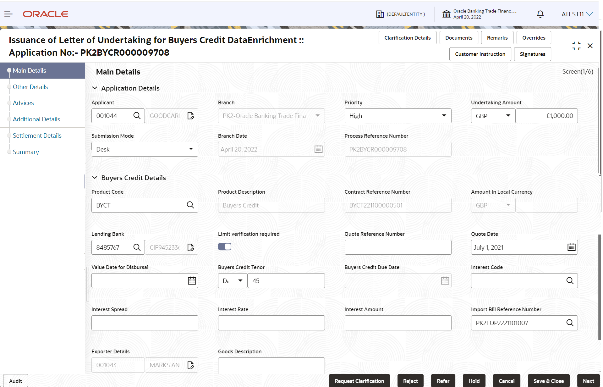

- Application Details
- Buyers Credit Details.
All fields displayed under Application details section are same as the fields listed under the 'Main Details' section in Registration stage. For more information on the fields, refer Application Details of Registration stage .
- On Main Details screen, specify the fields that were not
entered at Registration stage.
The fields which are marked as Required are mandatory.For more information on fields, refer to the field description table below.
Table 2-6 Main Details - Application Details - Field Description
Field Description Applicant Defaults the applicant details from 'Registration' stage. User can change the applicant.
Branch By default, customer’s home branch will be displayed based on the customer ID. Note:
Once the request is submitted, Branch field is non-editable.Priority Set the priority of the Issuance of Letter of Undertaking for Buyers Credit request as Low/Medium/High/Essential/Critical. If priority is not maintained for the customer, system will populate Medium as the default priority. User can change the priority populated any time before submit of Registration stage. Undertaking Amount Select the currency code from the drop-down list. Specify the value of LC (with decimal places) as per currency type and tab out.
Submission Mode Select the submission mode of Import LC Issuance request from the drop-down list. By default the submission mode will have the value as ‘Desk’.
- Courier - Request received through Courier
- Desk - Request received through Desk
- Email- Request received through Email
- Fax- Request received through Fax
Branch Date Read only field. By default, the application will display branch’s current date
Process Reference Number Read only field. Unique OBTFPM task reference number for the transaction.
This is auto generated by the system based on process name and branch code.

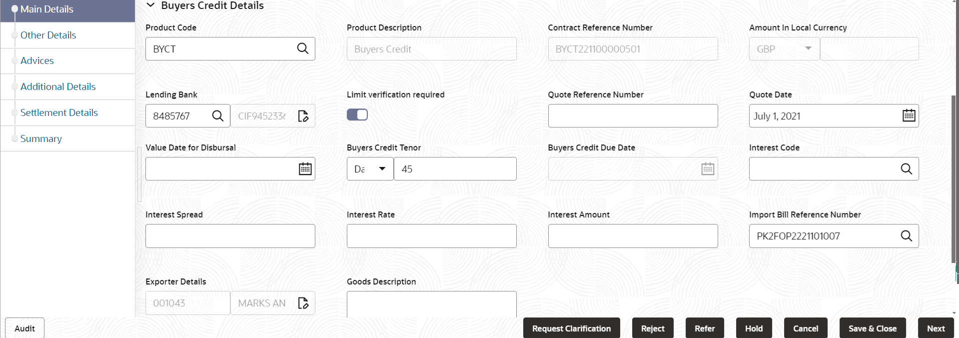

Buyers Credit DetailsThe fields listed under this section are same as the fields listed under the 'Buyers Credit Details' section in Registration stage. During Registration, if user has not captured input, then user can capture the details in this section.
Figure 2-8 Buyers Credit Details
Description of the illustration demainbuyerscreditdetails.pngFor more information on fields, refer to the field description table below.
Table 2-7 Main Details - Buyers Credit Details - Field Description
Field Description Product Code Specify the product code and on tab out, system will validate and populate the product code. Alternatively, click Search icon to search and select the product code with code or product description.
System fetches all the Buyers Credit Product maintained in the back office in the lookup. Only those products which are classified under “Buyers Credit” Product group in back office, should be available for selection.
Product Description Read only field. This field displays the description of the product as per the selected product code.
Contract Reference Number Read only field. Contract Reference Number will be auto populated by the system based on selection of Product Code
Amount In Local Currency Read only field. After the tab out of ‘Currency Code, Amount’ field, system populates the Local currency and amount value in this field. System fetches the local currency equivalent value for the LC amount from back office (with decimal places).
Lending Bank Specify the lending bank name or click Search to search and select the lending bank. System fetches only Bank customers in this lookup. Note:
System should display an override if the selected Bank is Non- RMA Complaint. System needs to generate MT999 if the Lending Bank is non RMA complaint instead of MT799 for the Letter of UndertakingLimit verification required Enable the option for limit check during the process flow of this request. By default this option is enabled.
Disable this option if limit check is not required during the process flow.
Quote Reference Number Specify the Quote Reference Number, mentioned in the Buyers Credit Quotation received from the Lending Bank. Request for Quote and Quote selection are to be operationally handled. Quote Date Select the Quote Date. The quote date cannot be earlier than the Branch date. Value Date for Disbursal Select the buyers credit disbursal date. The date cannot be lesser than the current branch date. Buyers Credit Tenor Select the buyers credit tenor. The options are:- Days
- Months
- Year
Specify the value for tenor of the bill (days, month and year) as mentioned in the Quote
Buyers Credit Due Date The buyers credit due date. It should be greater than the Quote Date and the Value date for Disbursal, system needs to validate the same. If the same falls on Branch / Currency holiday then system needs to show an override for the same.
Interest Code Click Search icon to search and select the interest rate code, mentioned in the Buyers Credit Quotation received from the Lending Bank. The lookup fetches all the rate codes maintained in the back office.
Interest Spread Specify the interest rate spread, mentioned in the Buyers Credit Quotation received from the Lending Bank. It should be a positive numeric value. Interest Rate Specify the interest rate, mentioned in the Buyers Credit Quotation received from the Lending Bank. It should be a positive numeric value. Interest Amount Specify the interest amount, mentioned in the Buyers Credit Quotation received from the Lending Bank. It should be a positive numeric value. Import Bill Reference Number Click Search icon to search and select the Import Bill Reference Number for which the Buyers Credit Bill is being booked. The lookup fetches all the active Import Bill for the Applicant of the Buyers Credit. Exporter Details Read only field. This filed displays the exporter from the Import Bill Reference selected by the user in the Import Bill Reference Number field.

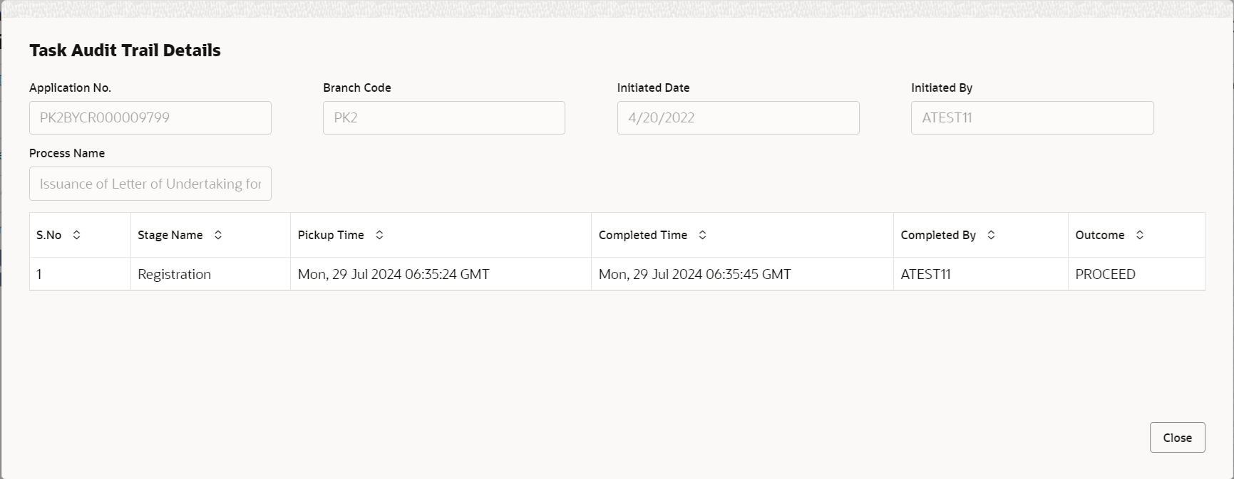

Goods Description Specify the details of the Goods as mentioned in the underlying Import Bill. AuditThis button provides information about user initiated the transaction, initiated date, stage wise detail etc.
For more information on audit, refer to the field description table below.Table 2-8 Audit - Field Description
Field Description Application No. This field displays the appliation number of the process. Branch Code This field displays the branch code. Initiated Date This field displays the date on which process is initiated. Initiated By This field displays the user ID of the user who had initiated the process. Process Name This field displays the name of the process which is initiated. S. No This field displays the serial number of the audit record. Stage Name This field displays the current stage of the process. Completed Time This field displays the time on which the audit of the current stage is completed. Completed By This field displays the user ID of the user who had completed the audit. Outcome This field displays the outcome of the audit. - Click Next.The task will move to next data segment.
