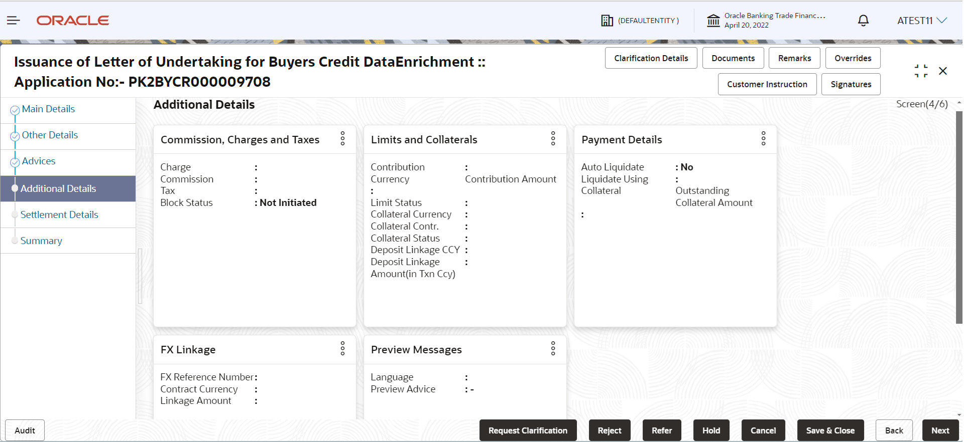

2.3.4 Additional Details
This topic provides the systematic instructions to capture the additional details
- On Additional Details screen, click the 3 dots on any
Additional Details tile to view the details.
Figure 2-11 Additional Details
Description of the illustration deadditionaldetails.pngLimits and Collaterals

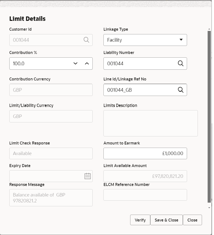

Provide the Limit Details based on the description in the following table.
Figure 2-12 Limit Details
Description of the illustration delimitdetails1.pngFor more information on fields, refer to the field description table below.
Table 2-14 Limit Details - Field Description
Field Description Limit Details Specify the limit details. Click plus icon to add new limit details.
Below fields are displayed on the Limit Details pop-up screen, if the user clicks plus icon.
Customer ID This field displays the applicant’s/applicant bank customer ID defaulted from the application. The user can change the customer ID.
Linkage Type Select the linkage type. Linkage type can be:- Facility
- Liability
By default Linkage Type is Facility.
Contribution % System will default this to 100%. User can modify, if contribution is more than 100%. System will display an alert message, if modified. Once contribution % is provided, system will default the amount.
System to validate that if Limit Contribution% plus Collateral% is equal to 100. If the total percentage is not equal to 100 application will display an alert message.
Liability Number Click Search icon to search and select the Liability Number from the look-up. The list has all the Liabilities mapped to the customer.
Contribution Currency Read only field. The LC currency will be defaulted in this field.
Line ID/ Linkage Ref No Click Search to search and select from the various lines available and mapped under the customer id gets listed in the drop down. LINE ID-DESCRIPTION will be available for selection along with Line ID. When you click on 'verify', the system will return value if the limit check was successful or Limit not Available. If limit check fails, the outstanding limit after the transaction value will be shown in the limit outstanding amount. Note:
User can also select expired Line ID from the lookup and on clicking the verify button, system should default “The Earmarking cannot be performed as the Line ID is Expired” in the “Response Message” field.This field is disabled and read only, if Linkage Type is Liability.
Limit/ Liability Currency This field displays the limit currency. Limit Currency will be defaulted in this field, when you select the Liability Number.
Limits Description Read only field. This field displays the limits description.
Limit Check Response Read only field. This field displays the limit check response. Response can be ‘Success’ or ‘Limit not Available’ based on the limit service call response.
The value in this field appears, if you click the Verify button.
Amount to Earmark Amount to earmark will default based on the contribution %. User can change the value.
Expiry Date Read only field. This field displays the date up to which the Line is valid.
Limit Available Amount Read only field. This field displays the value of available limit, i.e., limit available without any earmark. The Limit Available Amount must be greater than the Contribution Amount. The value in this field appears, if you click the Verify button.
Response Message Read only field. This field displays the detailed response message.
ELCM Reference Number Read only field. This field displays the ELCM reference number.
Limit Details - Grid Below fields appear in the Limit Details grid along with the above fields. Line Serial Read only field. Displays the serial of the various lines available and mapped under the customer id.
This field appears on the Limits grid.
Edit Click edit link to edit the limit details. Collateral DetailsCollateral availability needs to be checked if amendment involves increase in amount or tolerance. Provide the collateral details based on the description provided in the following table.

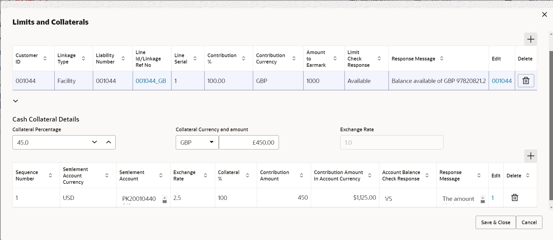

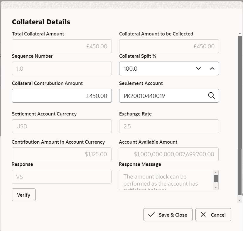

Table 2-15 Cash Collateral Details - Field Description
Field Description Collateral Percentage System populates the Collateral % maintained in the Customer / Product for the counter party of the contract. User can modify the collateral percentage.
Collateral Currency and amount System populates the contract currency as collateral currency by default. User can modify the collateral Currency and amount.
Exchange Rate System populates the exchange rate maintained. System validates for the Override Limit and the Stop limit if defaulted exchange rate is modified.
Cash Collateral Details pop-up screen Click plus icon to add new collateral details. Below fields are displayed on the Cash Collateral Details pop-up screen, if the user clicks plus icon.
Total Collateral Amount Read only field. This field displays the total collateral amount provided by the user.
Collateral Amount to be Collected Read only field. This field displays the collateral amount yet to be collected as part of the collateral split.
Sequence Number Read only field. The sequence number is auto populated with the value, generated by the system.
Collateral Split % Specify the collateral split% to be collected against the selected settlement account. Collateral Contribution Amount Collateral contribution amount will get defaulted in this field. The collateral % maintained for the customer is defaulted into the Collateral Details screen. If collateral % is not maintained for the customer, then system should default the collateral % maintained for the product. User can modify the defaulted collateral percentage, in which case system should display a override message “Defaulted Collateral Percentage modified.
Settlement Account Click Search to search and select the settlement account for the collateral. Settlement Account Currency Read only field. This field displays the settlement account currency and will be auto-populated based on the Settlement Account selection.
Exchange Rate Read only field. This field displays the exchange rate, if the settlement account currency is different from the collateral currency.
Contribution Amount in Account Currency Read only field. This field displays the contribution amount in the settlement account currency as defaulted by the system.
Account Available Amount Read only field. System populates the account available amount on clicking the Verify button.
Response Read only field. System populates the response on clicking the Verify button.
Response Message Read only field. System populates the response message on clicking the Verify button.
Verify Click to verify the account balance of the Settlement Account. Save & Close Click to to save and close the record. Cancel Click to cancel the entry. Cash Collateral Details - Grid Below fields appear in the Cash Collateral Details grid along with the above fields. Collateral % Specify the percentage of collateral to be linked to this transaction. If the value is more than 100% system will display an alert message. The collateral % maintained for the customer is defaulted into the Collateral Details screen. If collateral % is not maintained for the customer, then system should default the collateral % maintained for the product.
Contribution Amount This field displays the collateral contribution amount. The collateral % maintained for the customer is defaulted into the Collateral Details screen. If collateral % is not maintained for the customer, then system should default the collateral % maintained for the product. User can modify the defaulted collateral percentage, in which case system should display a override message “Defaulted Collateral Percentage modified.
Account Balance Check Response This field displays the account balance check response. Edit Click edit link to edit the collateral details. - Click Save and Close to save the details and close the
screen.

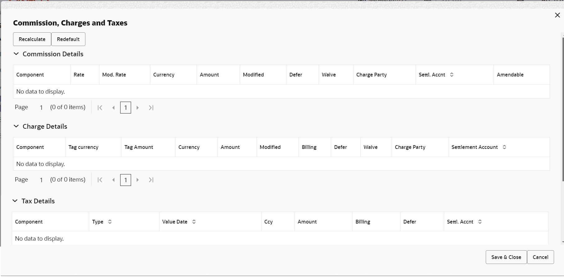

Commission, Charges and Taxes Details
This section displays charge details. System will auto populate the charges, commission and tax components mapped to the product from the back office system.
If default charges are available under the product, they should be defaulted here with values. If customer or customer group specific charges are maintained, then the same will be defaulted from back end system.
Description of the illustration dechargedetails.pngFor more information on fields, refer to the field description table below.
Table 2-16 Charge Details - Field Description
Field Description Commission Details Specify the commission details. All charges, commission and margin are collected from the counter-party by default.
Component This field displays the commission component. Click the link to view the component details.
Rate This field displays the rate that is defaulted from product. The commission rate, if available in Back Office defaults in OBTFPM. The user is able to change the rate.
If flat commission is applicable, then commission amount defaulted from back office is modifiable by the user. Rate field will be blank and the user cannot modify the Rate field.
Mod. Rate From the default value, if the rate is changed the value gets updated in this field. Ccy This field displays the currency in which the commission have to be collected. Amount This field displays the amount that is maintained under the product code. The commission rate, if available in Back Office defaults in OBTFPM. The user is able to change the rate, but not the commission amount directly. The amount gets modified based on the rate changed and the new amount is calculated in back office based on the new rate and is populated in OBTFPM.
Modified From the default value, if the amount is changed, the value gets updated in the modified amount field. Defer If enabled, charges/commissions has to be deferred and collected at any future step. Waive Based on the customer maintenance, the charges/commission can be marked for Billing or Defer. If the defaulted Commission is changed to defer or billing or waive, system must capture the user details and the modification details in the ‘Remarks’ place holder.
Split The user can split the Commission by enabling/ disabling the flag as per the requirement. Charge Party Charge party is 'Applicant' by default. User can change the value to Beneficiary. Settl. Accnt Details of the Settlement Account is defaulted. User can change the settlement account.
Amend The value is auto-populated as the commission can be amended or not. Charge Details Specify the charge details. Component This field displays the charge component type. Tag Currency Defaults the tag currency in which the charges have to be collected. Tag Amount Defaults the tag amount that is maintained under the product code gets defaulted in this field. User can edit the value, if required. Ccy Defaults the currency in which the charges have to be collected. Amount An amount that is maintained under the product code gets defaulted in this field. Modified From the default value, if the rate is changed or the amount is changed, the value gets updated in the modified amount field. Billing If charges are handled by separate billing engine, then by selecting billing the details to be available for billing engine for further processing. On simulation of charges/commission from Back Office, if any of the Charges/Commission component for the customer is ‘Billing’ enabled, ‘Billing’ toggle for that component should be automatically enabled in OBTFPM.
The user can not enable/disable the option, if it is de-selected by default.
Defer If charges have to be deferred and collected at any future step, this check box has to be selected. On simulation of charges/commission from Back Office, if any of the Charges/Commission component for the customer is AR-AP tracking enabled, ‘Defer’ toggle for that component should be automatically checked in OBTFPM.
The user can enable/disable the option the check box. On de-selection the user has to click on ‘Recalculate’ charges button for re-simulation.
Waive Enble the toggle, if charges has to be waived. Based on the customer maintenance, the charges should be marked for Billing or for Defer.
Split The bank user can split the charges by enabling/disabling the flag as per the requirement. Charge Party Charge party is applicant by default. User can change the value to beneficiary. Settlement Account Details of the Settlement Account is defaulted. User can change the settlement account.
Tax Details Specify the tax details. The tax component is calculated based on the commission and defaults if maintained at product level. User cannot update tax details and any change in tax amount on account of modification of charges/ commission will be available on click of Re-Calculate button or on hand off to back-end system.
Component This field displays the tax component. Type This field displays the type of tax component. Value Date This field displays the value date of tax component. Ccy This field displays the currency in which the tax have to be collected. The tax currency is the same as the commission.
Amount This field displays the tax amount based on the percentage of commission maintained. You can edit the tax amount, if applicable.
Billing If taxes are handled by separate billing engine, then by selecting billing the details to be available for billing engine for further processing. Defer If taxes have to be deferred and collected at any future step, this option has to be enabled. The user can enable/disable the option the check box. On de-selection the user has to click on ‘Recalculate’ charges button for re-simulation.
Settl. Accnt System defaults the settlement account. The user can modify the settlement account.
Split Settlement Once the user clicks on the Recalculate button to fetch the Split Settlement details from Backoffice, new section “Split Settlement” will appear below the ‘Tax’ section. The default parties in Split row should be fetched from OBTF. Select The check box to select the Split Settlement record. Component The split component type eligible for Split. Currency The currency of split settlement. Amount The amount of split settlement. Split Settlement Details Split Settlement details section appears from Back office, when the user clicks on the Recalculate button. Sequence The sequence number is auto populated with the value, generated by the system. Component The split component type eligible for Split. Amount The system splits the respective Charge/Commission amount automatically between counter party and third party with 50% value by default. The bank user can modify the amount.
More than two splits are not allowed.
Customer Indicates the ID of the Customer in Split Settlement Details section. Account The system defaults the settlement account. User can modify the settlement account.
System initiates a call to common core tables within OBTFPM to select the account.
Account Currency Defaults the currency of the account. Branch Indicates the branch of the customer where transaction is getting processed. Percentage The system splits the respective Charge/Commission percentage automatically between counter party and third party with 50% value by default.
More than two splits are not allowed. The bank user can modify the amount.
The system should validate that the total percentage of each component doesn't exceed 100 and the total amount of each component doesn't exceed total component amount.Exchange Rate System populates the exchange rate maintained. Original Exchange Rate System displays the Original Exchange Rate as simulated in split settlement details section. Party Type System displays the party type in split settlement details section. Negotiation Reference Specify the negotiation reference number. AR-AP Tracking Indicates to defer the charge/ commission in Split Settlement Details section.
The user can modify the AR-AP Tracking flag as per the requirements.Loan/Finance Account Displays the loan account. Negotiation Rate Specify the negotiation rate. - Click Save and Close to save the details and close the

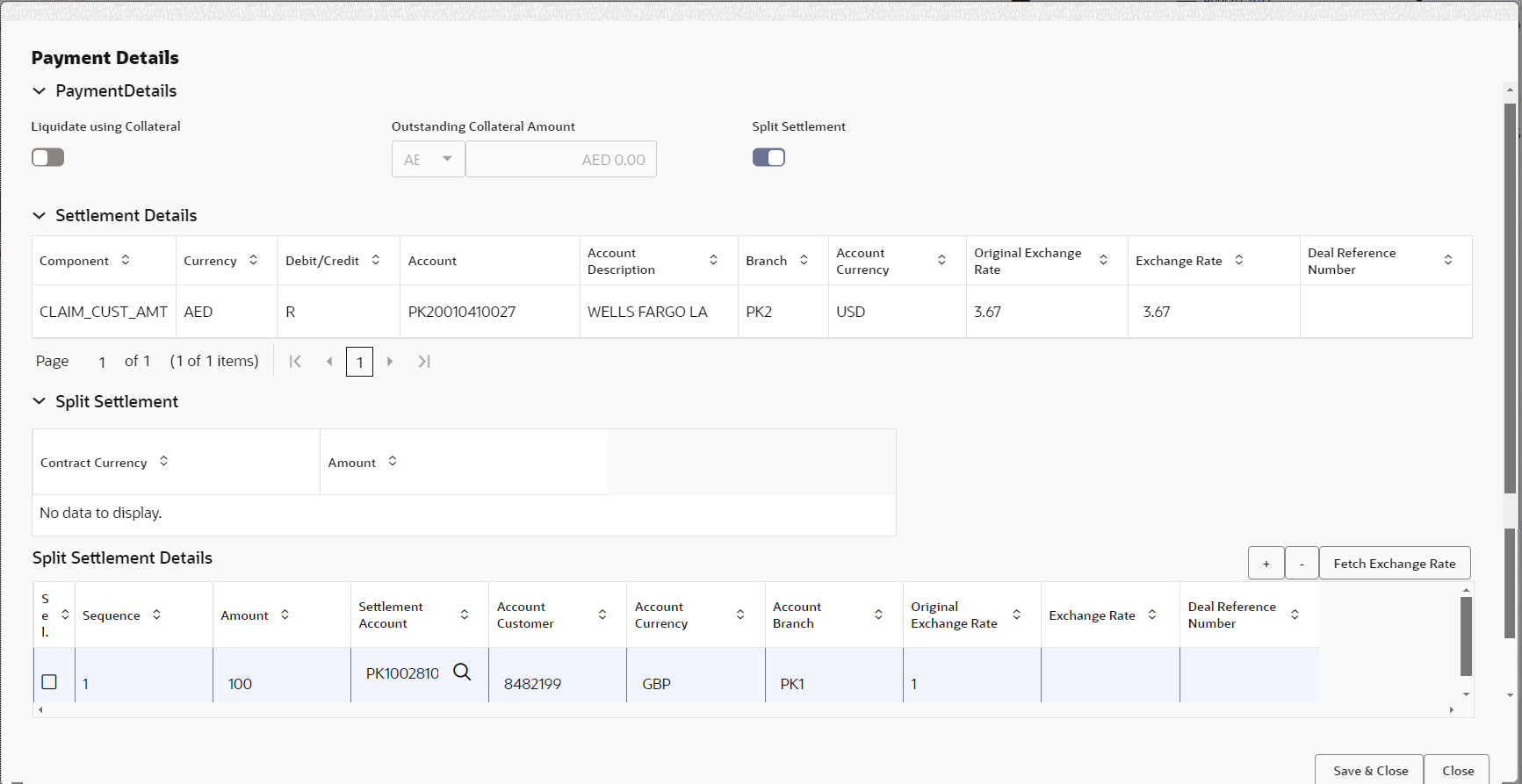

screen.Payment Details
Description of the illustration liquidationpaymentdetails.pngTable 2-17 Payment Details - Field Description
Field Description Payment Details Specify the Payment Details. Auto Liquidate Enable this option, if the auto liquidation is required. Disable this option, if the auto liquidation is not required.
Auto Liquidation enables liquidation of the bill on the due date automatically from the back office system.
Liquidate using Collateral If the claim settlement has to be paid, via collateral the user has to select the Liquidate using collateral. User can liquidate using collateral only if collateral has been mapped at the time of Issuance of Letter of Undertaking for Buyers Credit. In case collateral not mapped during issuance, user cannot add collaterals and use the same during liquidation.
Outstanding Collateral Amount Read Only field. System defaults the outstanding collateral amount (if mapped).
Split Settlement Enable the option to select more than one account for settlement (Split Settlement) for the liquidation of an import or export drawing or collection bill. Disables the user to select more than one account for settlement (Split Settlement) for the liquidation of an import or export drawing or collection bill
Settlement Details - Liquidation Specify the Settlement Details. Component System defaults the component based on the product selected. Currency System defaults the currency for the component. Debit/Credit System defaults the debit/ credit value for the component. Account System defaults the account details for the components. User can modify the account.
Account Description System defaults the description of the customer’s account. Branch System defaults the branch of the customer’s account. Account Currency This field defaults the currency of the account. Split Settlement Below section appears, if user enables the Split Settlement option. Contract Currency System defaults the contract currency for the component. Amount The Amount for each component. This is populated from the transaction details of the buyers credit. Split Settlement Details Below section appears, if user enables the Split Settlement option. Click '+' plus icon to add new Split Settlement details.
Click - minus icon to delete the Split Settlement record.
Seqence The sequence number is auto populated with the value, generated by the system. Amount Specify the amount for the split settlement. Settlement Account Click Search to search and select the settlement account where the repayment of the Buyers Credit has to be routed. Account Customer Displays the customer's account based on the settlement account selection. Account Currency Displays the customer's account currency based on the settlement account selection. Account Branch Displays the branch of the customer's account based on the settlement account selection. Original Exchange Rate System defaults the original exchange rate as simulated in settlement details section from OBTF on clicking the Fetch Exchange Rate button. Exchange Rate The exchange rate for the split settlement. Deal Reference Number The exchange deal reference number. Action Click edit icon to edit the Split Settlement Details record. Click delete icon to delete the Split Settlement Details record.

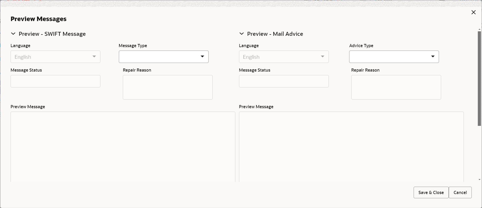

screen.Preview Message
The bank user can view a preview the draft SWIFT message based on message type and the draft mail advice based on the advice type.
Description of the illustration depreviewmessages.pngFor more information on fields, refer to the field description table below.
Table 2-19 Preview Message - Field Description
Field Description Preview SWIFT Message Displays the preview of SWIFT Messages. Language Read only field. The language to preview the draft issuance of letter of undertaking details.
English is set as default language for the preview.
Message Type Select the message type from the drop down. User can choose to see preview of different message.
Message Status Read only field. Display the message status of draft message of issuance of letter of undertaking details.
Repair Reason Read only field. Display the message repair reason of draft message of issuance of letter of undertaking details.
Preview Message This field displays a preview of the draft message. Preview Mail Advice The preview message-mail advice is simulated from the back office and the user can view the message. Language Read only field. The language for the advice message.
Advice Type Select the advice type. Message Status Read only field. Display the message status of draft message of issuance of letter of undertaking details.
Preview Message This field displays a preview of advice. - Click Save and Close to save the details and close the screen.
- Next.The task will move to next data segment.
For more information on action buttons, refer to the field description table below.
