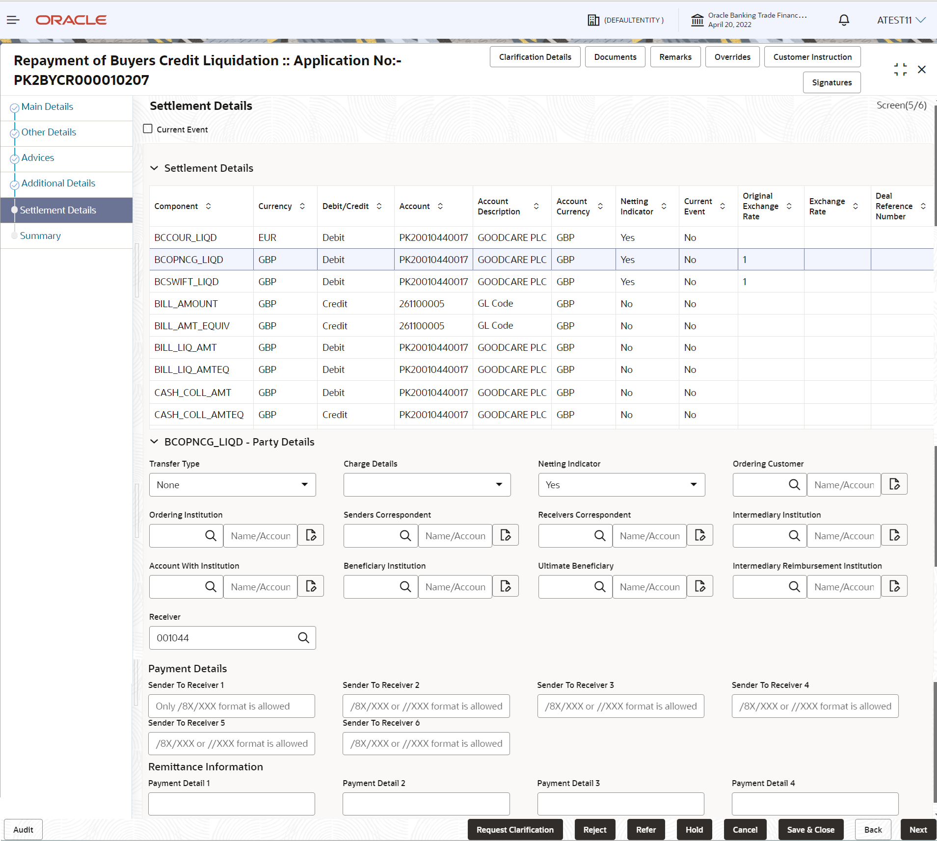

2.3.5 Settlement Details
This topic provides the systematic instructions to capture the settlement details of Repayment of Buyers Credit request.
- On Settlement Details screen, specify the fields.
For more information on fields, refer to the field description table below.
Table 2-22 Settlement Details – Field Description
Field Description Current Event Select the check box to populate the settlement details of the current event associated with the task. On De-selecting the check box, the system list all the accounts under the settlement details irrespective of the current event Component This field displays the components based on the product selected. Currency This field displays the default currency for the component. Debit/Credit This field displays the debit/credit indicators for the components. Account This field displays the account details for the components. Account Description This field displays the the description of the selected account. Account Currency System defaults the currency for all the items based on the account number. Netting Indicator This field displays the applicable netting indicator. Current Event System defaults the current event as Y or N. - Click any component in the grid.Party Details
Table 2-23 Party Details – Field Description
Field Description Transfer Type Select the transfer type from the drop-down list. The options are:- Customer Transfer
- Bank Transfer for own account
- Direct Debit Advice
- Managers Check
- Customer Transfer with Cover
- Bank Transfer
Charge Details Select the charge details for the transaction. The options are:- Beneficiary All Charges
- Remitter Our Charges
- Remitter All Charges
Netting Indicator Select the netting indicator for the component. The options are:- Yes
- No
Ordering Customer Click search icon to search and select the ordering customer from the look up. Ordering Institution Click search icon to search and select the ordering institution from the look up. Senders Correspondent Click search icon to search and select the senders correspondent from the look up. Receivers Correspondent Click search icon to search and select the receivers correspondent from the look up. Intermediary Institution Click search icon to search and select the intermediary institution from the look up. Account with Institution Click search icon to search and select the account with institution from the look up. Beneficiary Institution Click search icon to search and select the beneficiary institution from the look up. Ultimate Beneficiary Click search icon to search and select the ultimate beneficiary from the look up. Intermediary Reimbursement Institution Click search icon to search and select the intermediary reimbursement institution from the look up. Receiver Click search icon to search and select the Receiver from the look up. Payment Details
Table 2-24 Payment Details - Field Description
Field Description Sender to Receiver 1 Specify the sender to receiver message. Sender to Receiver 2 Specify the sender to receiver message. Sender to Receiver 3 Specify the sender to receiver message. Sender to Receiver 4 Specify the sender to receiver message. Sender to Receiver 5 Specify the sender to receiver message. Sender to Receiver 6 Specify the sender to receiver message. Remittance Information
Table 2-25 Remittance Information – Field Description
Field Description Payment Detail 1 Specify the payment details. Payment Detail 2 Specify the payment details. Payment Detail 3 Specify the payment details. Payment Detail 4 Specify the payment details. - Click Next.The task will move to next data segment.
