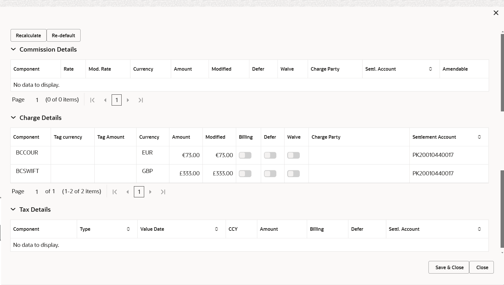

    Charge Details
    This section displays charge details.
    For more information on fields, refer to the field description table below.
    Table 3-19 Charge Details - Field Description
    Field Description
    Commission Details This section displays the commission details.
    Component This field displays the commission component.
    Rate This field displays the rate that is defaulted from product.
    The commission rate, if available in Back Office defaults in OBTFPM. The user is able to change the rate.
    If flat commission is applicable, then commission amount defaulted from back office is modifiable by the user. Rate field will be blank and the user cannot modify the Rate field.
    Modified Rate From the default value, if the rate is changed the value gets updated in this field.
    Currency This field displays the currency in which the commission have to be collected.
    Amount This field displays the amount that is maintained under the product code.
    The commission rate, if available in Back Office defaults in OBTFPM. The user is able to change the rate, but not the commission amount directly. The amount gets modified based on the rate changed and the new amount is calculated in back office based on the new rate and is populated in OBTFPM.
    Modified Amount From the default value, if the amount is changed, the value gets updated in the modified amount field.
    Defer If enabled, charges/commissions has to be deferred and collected at any future step.
    Waive Based on the customer maintenance, the charges/commission can be marked for Billing or Defer.
    If the defaulted Commission is changed to defer or billing or waive, system must capture the user details and the modification details in the ‘Remarks’ place holder.
    Charge Party Charge party is 'Applicant' by default. User can change the value to Beneficiary.
    Settlement Account Select the settlement account.
    Amendable Displays if the field is amendable or not.
    Charge Details This section displays the charge details.
    Component This field displays the charge component type.
    Tag Currency This field displays the tag currency in which the charges have to be collected.
    Tag Amount This field displays the tag amount that is maintained under the product code.
    Currency This field displays the currency in which the charges have to be collected.
    Modified From the default value, if the rate is changed or the amount is changed, the value gets updated in the modified amount field.
    Billing If charges are handled by separate billing engine, then by selecting billing the details to be available for billing engine for further processing.
    On simulation of charges/commission from Back Office, if any of the Charges/Commission component for the customer is ‘Billing’ enabled, ‘Billing’ toggle for that component should be automatically enabled in OBTFPM.
    The user can not enable/disable the option, if it is de-selected by default.
    This field is disabled, if ‘Defer’ toggle is enabled.
    Defer If charges have to be deferred and collected at any future step, this check box has to be selected.
    On simulation of charges/commission from Back Office, if any of the Charges/Commission component for the customer is AR-AP tracking enabled, ‘Defer’ toggle for that component should be automatically checked in OBTFPM.
    The user can enable/disable the option the check box. On de-selection the user has to click on ‘Recalculate’ charges button for re-simulation.
    Waive Enble the toggle, if charges has to be waived.
    Based on the customer maintenance, the charges should be marked for Billing or for Defer.
    This field is disabled, if Defer toggle is enabled.
    Charge Party Charge party is applicant by default. User can change the value to beneficiary.
    Settlement Account Indicates the settlement account.
    Tax Details This section displays the charge details.
    The tax component is calculated based on the commission and defaults if maintained at product level. User cannot update tax details and any change in tax amount on account of modification of charges/ commission will be available on click of Re-Calculate button or on hand off to back-end system.
    Component This field displays the tax component.
    Type This field displays the type of tax component.
    Value Date This field displays the value date of tax component.
    Currency This field displays the currency in which the tax have to be collected.
    The tax currency is the same as the commission.
    Amount This field displays the tax amount based on the percentage of commission maintained.
    You can edit the tax amount, if applicable.
    Billing If taxes are handled by separate billing engine, then by selecting billing the details to be available for billing engine for further processing.
    Defer If taxes have to be deferred and collected at any future step, this option has to be enabled.
    Settlement Account System defaults the settlement account.
    The user can modify the settlement account.

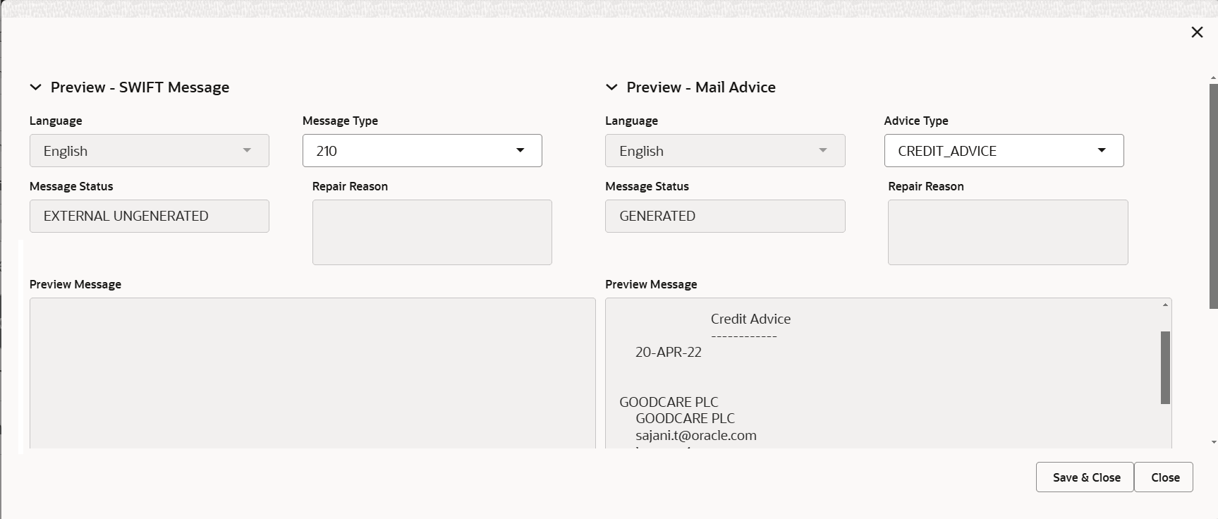

    Preview
    The bank user can view a preview of the outgoing SWIFT message and advise simulated from back office.Description of deadditionaldetailspreview.png follows
    Table 3-23 Preview - Field Description
    Field Description
    Preview SWIFT Message This section displays the Preview SWIFT Message details.
    Language Select the language for the SWIFT message.
    Message Type Select the message type.
    Message Status Read only field.
    Display the message status of draft message of liquidation details.
    Repair Reason Read only field.
    Display the message repair reason of draft message of liquidation details.
    Preview Message This field displays a preview of the draft message.
    Preview Mail Device This section displays the Preview Mail Device details.
    Language Select the language for the advice message.
    Advice Type Select the advice type.
  5. Click Save and Close to save the details and close the screen.

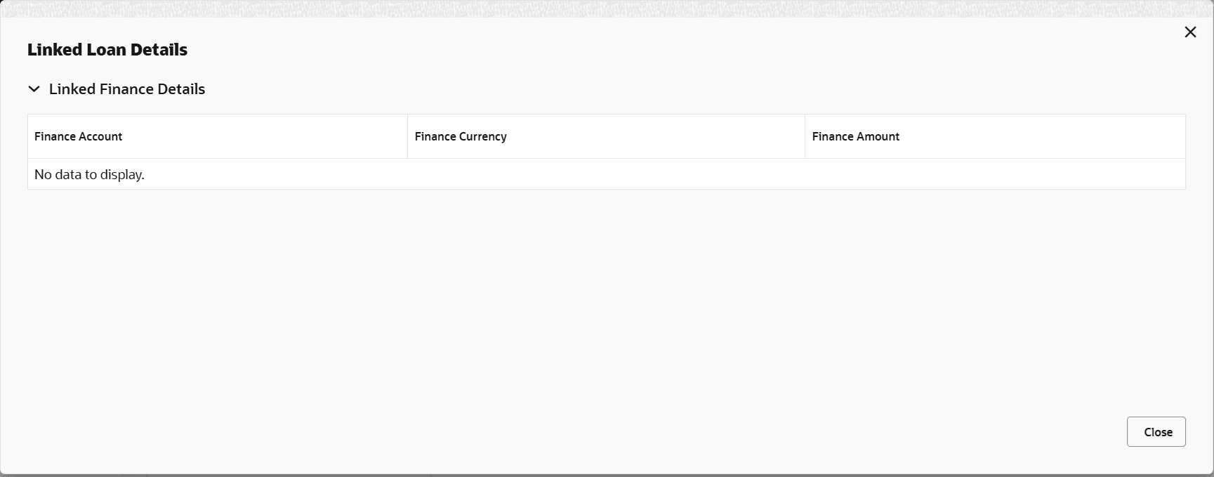

    Linked Finance Details
    The bank user can view the details of linked finance accounts.
    Description of delinkedloandetails.png follows
    Table 3-24 Linked Finance Details - Field Description
    Field Description
    Finance Account The details of the linked finance account.
    Finance Currency Finance currency of the linked finance account.
    Finance Amount Finance amount of the linked finance account.
  6. Click Save and Close to save the details and close the screen.
