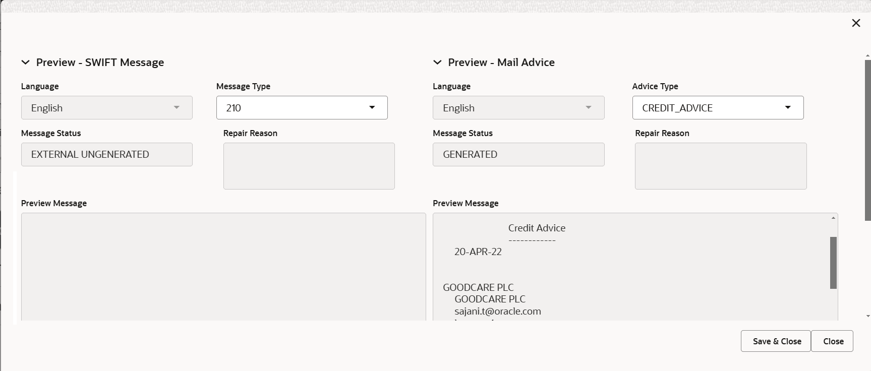

    Preview Messages
    User can view the draft message being displayed on the preview message text box.
    Description of deadditionaldetailspreview.png follows
    For more information on fields, refer to the field description table below.
    Table 2-15 Preview - Field Description
    Field Description
    Preview SWIFT Message This section displays the Preview SWIFT Message details.
    Language Read only field.
    English is set as default language for the preview.
    Message Type Select the message type.
    Message Status Read only field.
    Display the message status of draft message of liquidation details.
    Repair Reason Read only field.
    Display the message repair reason of draft message of liquidation details.
    Preview Message This field displays a preview of the draft message.
    Preview Mail Device This section displays the Preview Mail Device details.
    Language Select the language for the advice message.
    Advice Type Select the advice type.
