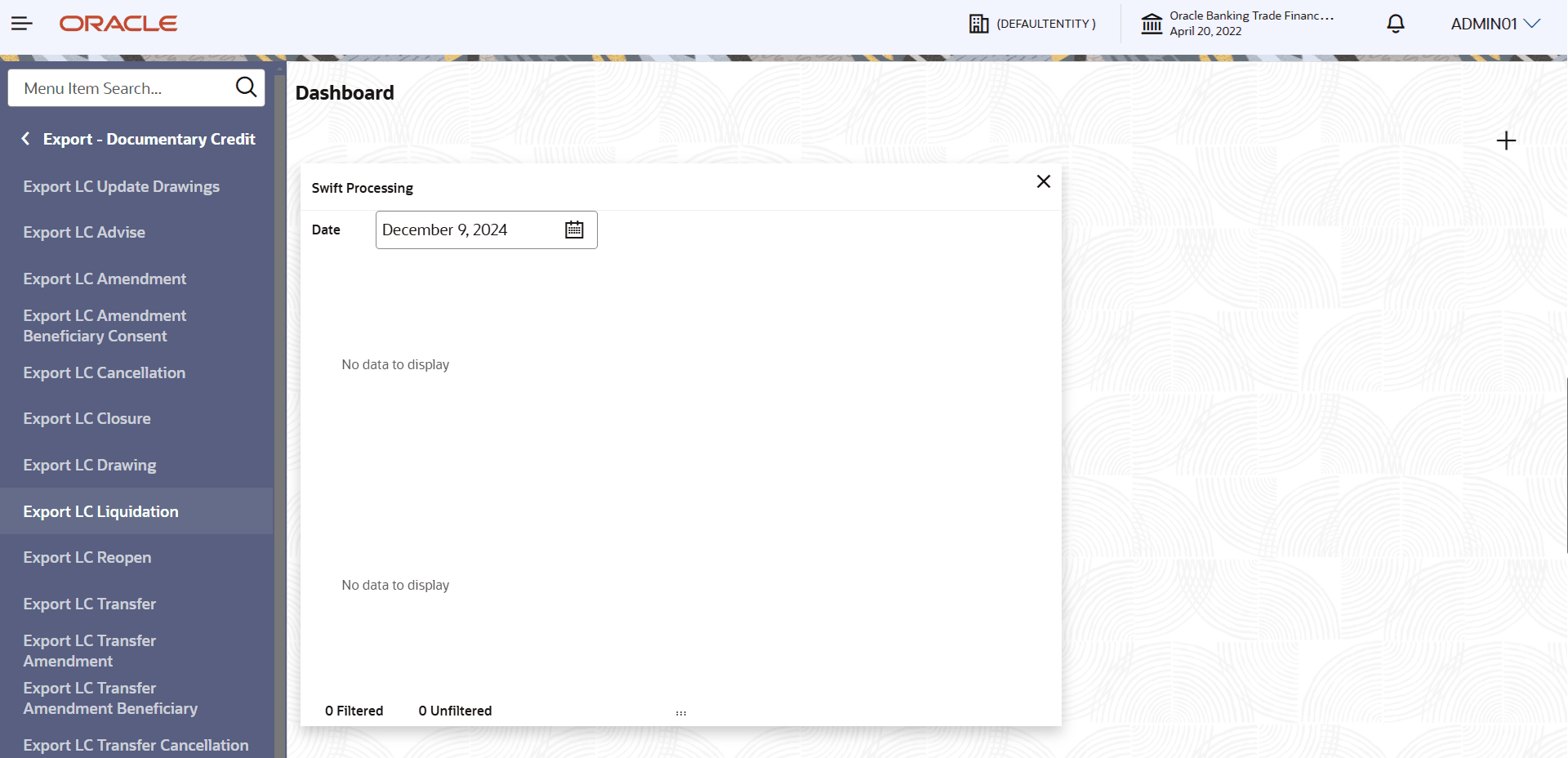

Specify User ID and Password, and login to Home screen.
  1. On Home screen, click Trade Finance. Under Trade Finance, click Export Documentary Credit.
  2. Under Export Documentary Credit, click Export LC Liquidation.
    The Export LC Liquidation - Registration screen appears.

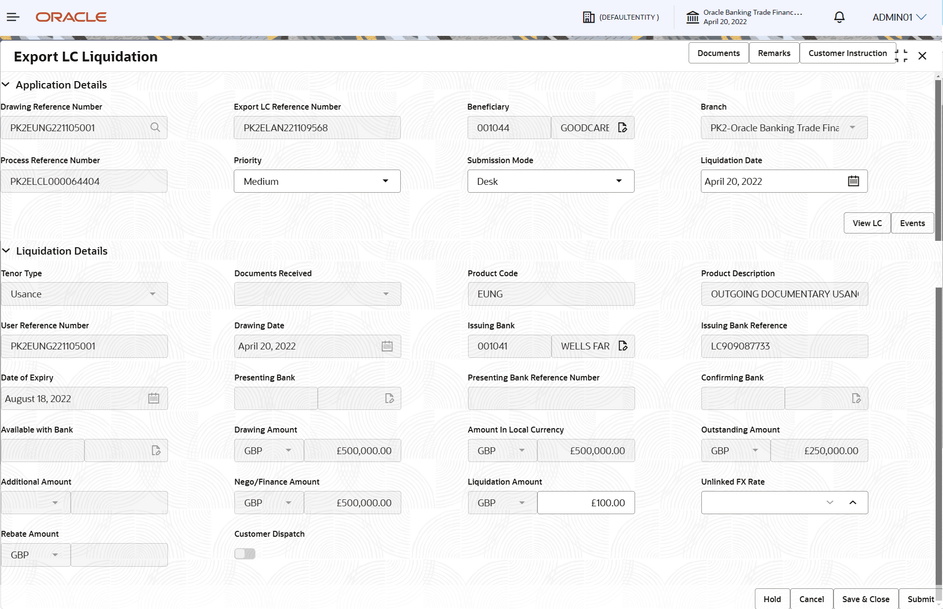

    The Export LC Liquidation - Registration stage has two sections Application Details and Liquidation Details. Let’s look at the details of Registration screens below:
    Figure 2-4 Export LC Liquidation - Registration - Application Details
    Description of registrationapplicationdetails.png follows
  3. On Export LC Liquidation - Registration - Application Details screen, specify the fields.
    The fields which are marked as Required are mandatory.
    For more information on fields, refer to the field description table below.
    Table 2-3 Export LC Liquidation - Registration - Application Details - Field Description
    Field Description
    Drawing Reference Number Specify the drawing reference number.
    Alternatively, click Search to search and select the drawing reference number reference number from the look-up. In the lookup, you can search giving Drawing Reference Number, Customer ID, Currency, Value Date, and User Reference Number to fetch the LC details. Based on the search result, select the applicable LC to add the applicant response.
    Export LC Reference Number Read only field.
    Export LC reference number is auto-populated based on the selected LC from the lookup.
    Beneficiary Read only field.
    Beneficiary ID and name is auto-populated based on the selected LC from the lookup.
    Branch Read only field.
    Branch details is auto-populated based on the selected LC from the lookup.
    Process Reference Number Read only field.
    Unique sequence number for the transaction.
    This is auto generated by the system based on process name and branch code.
    Priority System populates the priority of the customer based on priority maintenance. If priority is not maintained for the customer, system will populate 'Medium' as the default priority.
    User can change the priority populated any time before submit.
    Submission Mode System populates the submission mode of Export LC Liquidation request.
    By default the submission mode will have the value as ‘Desk’.
    • Desk - Request received through Desk
    • Courier - Request received through Courier
    User can change and select the  submission mode of Export LC Liquidation request.
    Liquidation Date
    System displays the liquidation date.
    By default, the application will display branch’s current date and does not enables the user to change the date to any back date.

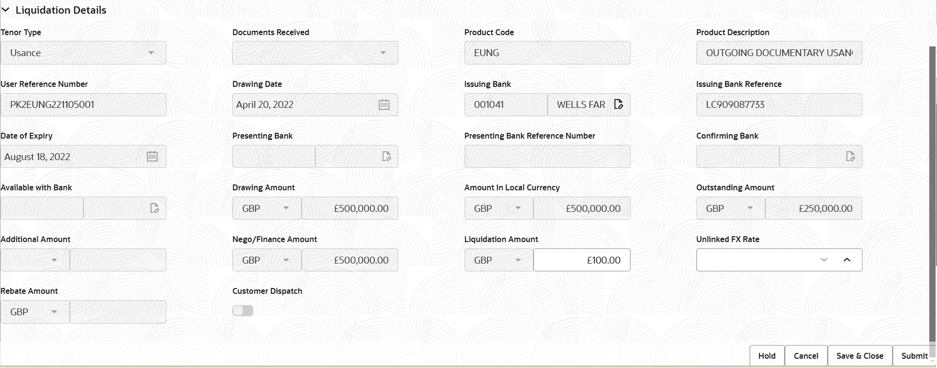

    Liquidation Details
    Registration user can provide Liquidation details in this section. Alternately, details can be provided by Data Enrichment user.
    Description of registrationliquidationdetails.png follows
  4. On Export LC Liquidation - Liquidation Details screen, specify the fields.
    Table 2-4 Export LC Liquidation - Registration - Liquidation Details - Field Description
    Field Description
    Tenor Type Read only field. System defaults the value for tenor type.
    This field displays the tenor of the drawing
    The tenor type can be:
    • Sight
    • Usance
    • Multi Tenor
    Documents Received Read only field.
    This field displays the documents received details of the drawing.
    Product Code Read only field.
    This field displays the product code of the drawing.
    Product Description Read only field.
    This field displays the description of the product as per the product code.
    User Reference Number Read only field.
    This field displays the user reference number based on the product code.
    Drawing Date Read only field.
    This field displays the drawing date details of the drawing.
    Issuing Bank Read only field.
    This field displays the issuing bank ID and issuing bank name of the drawing.
    Issuing Bank Reference Read only field.
    This field displays the issuing bank ID of the drawing.
    Date of Expiry Read only field.
    This field displays the expiry date of the drawing.
    Presenting Bank Read only field.
    Presenting Bank is auto-populated based on the selected LC from the look-up.
    Presenting Bank Reference Number Read only field.
    Presenting bank reference number is auto-populated based on the selected LC from the look-up.
    Confirming Bank Read only field.
    Confirming bank details if any, will populate from drawing/update drawing.
    Available with Bank Specify the value for available with bank.
    The Available Bank details should be handed off against ‘Collecting Bank’ Party in OBTF.
    If the Bank selected in Confirming Bank and Available with Bank are same, system should hand off only the Confirming Bank details in Back office.
    If Confirming Bank/Available with Bank are the same as Issuing Bank/Presenting Bank, system should display an error.
    Drawing Amount Read only field.
    This field displays the LC Drawing Amount as per the selected drawing.
    Amount In Local Currency Read only field.
    System fetches the local currency equivalent value for the LC amount from back office (with decimal places).
    Outstanding Amount Read only field.
    Outstanding amount value is auto-populated.
    This field displays the value as per the latest LC.
    Additional Amount Read only field.
    Additional amount is auto-populated. This field displays the value as per the latest LC.
    Nego/Finance Amount Read only field.
    Nego/Finance amount is auto-populated. This field displays the value as per the latest LC.
    Liquidation Amount
    Liquidation Amount defaults to the Outstanding Bill Amount. The user can modify the defaulted Liquidation Amount, if required.
    Unlinked FX Rate Specify the unlinked FX Rate.
    Rebate Amount Read only field.
    This field displays the rebate to the bill outstanding amount.
    Customer Dispatch The value will be populated from back office based on the maintenance.
    If the option is enabled, the customer has the option to dispatch the documents directly to the importer’s bank.
    If the option is enabled, the bank has to dispatch the documents to the importer’s bank.
    Bank user is not allowed to edit the field, if the value defaulted from the back office is “No”,
