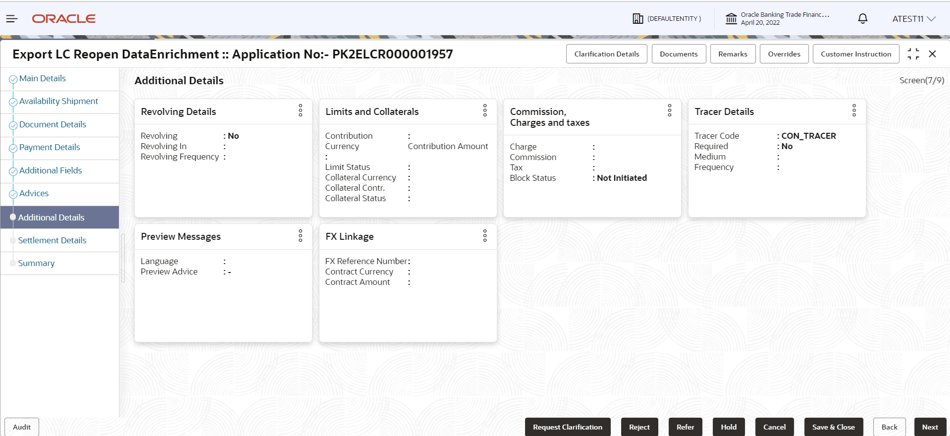

2.3.7 Additional Details
This topic provides the systematic instructions to capture the additional details.
A Data Enrichment user can view the additional details available for the Export LC Reopen request. Some of the possible details could be related to:
  • Revolving Details
  • Limits and Collateral (Verification Applicable)
  • Commission, Charges and Taxes
  • Tracer Details
  • Preview Messages
  • FX Linkage.
  1. On Additional Details screen, click View on any Additional Details tile to view the details.

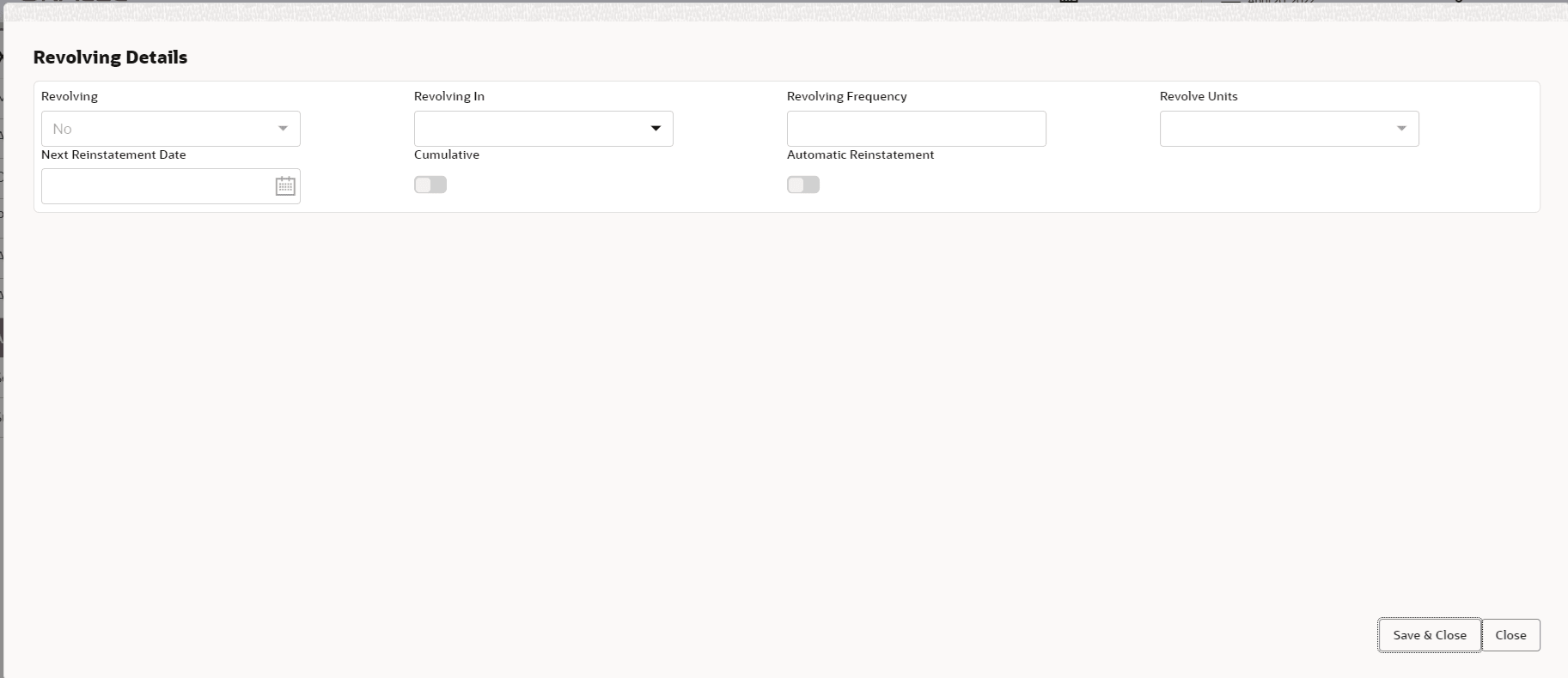

  2. Click the 3 dots on Revolving Details tiles to view the Revolving Details screen.
    Revolving Details
    For more information on fields, refer to the field description table below.
    Table 2-19 Revolving Details - Field Description
    Field Description
    Revolving This field displays the revolving details of the LC.
    Revolving In Indicates the mode of revolving in this field. The LC can revolve with Time or Units.
    Revolving Frequency In case the LC revolves with time, then this field should be updated. This field captures the frequency in days and months by which the LC revolves.
    Revolving Units This field indicates the units by which the LC revolves.
    Next Reinstatement Date This field displays the date of next reinstatement for the LC based on the revolving frequency selected.
    Cumulative This field indicates, if the LC value has to be cumulative or not on reinstatement.
    Automatic Reinstatement This field enables the user to have automatic reinstatement on the reinstatement day without manual intervention.
  3. Click Save and Close to save the details and close the screen.

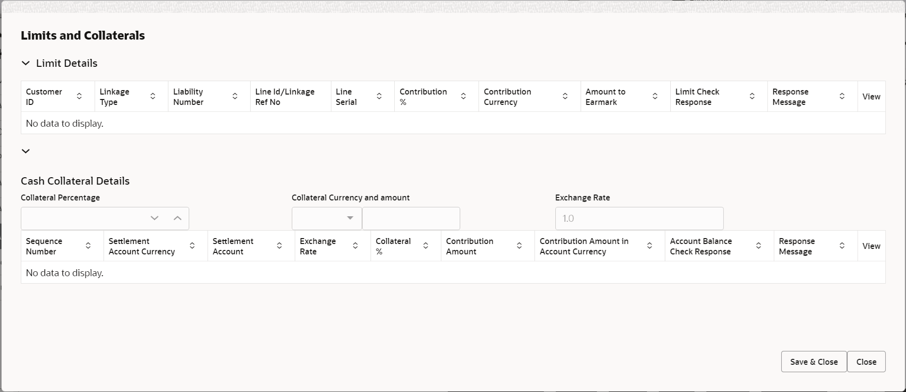

    Limits and Collaterals
    On Approval, system should not release the Earmarking against each limit line and system should handoff the “Limit Earmark Reference Number “to the back office. On successful handoff, back office will make use of these “Limit Earmark Reference Number” to release the Limit Earmark done in the mid office (OBTFPM) and should Earmark the limit from the Back office.
    In case multiple Lines are applicable, Limit Earmark Reference for all lines to be passed to the back office.
    Table 2-20 Field Description - Limit Details
    Field Description

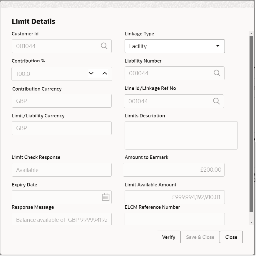

    Limit Details
    Below fields are displayed on the Limit Details pop-up screen.
    Customer ID Displays the applicant’s/applicant bank customer ID defaulted from the application.
    Linkage Type The linkage type.
    Linkage type can be:
    • Facility
    • Liability
    By default Linkage Type should be Facility.
    Contribution % System will default this to 100%. User can modify, if contribution is more than 100%. System will display an alert message, if modified.
    Once contribution % is provided, system will default the amount.
    System to validate that if Limit Contribution% plus Collateral% is equal to 100. If the total percentage is not equal to 100 application will display an alert message.
    The collateral % maintained for the customer is defaulted into the Collateral Details screen. If collateral % is not maintained for the customer, then system should default the collateral % maintained for the product. User can modify the defaulted collateral percentage, in which case system should display a override message “Defaulted Collateral Percentage modified.
    Liability Number Displays the liability number mapped to the customer.
    Contribution Currency Displays the contribution currency.
    Line ID/Linkage Ref No Displays the various lines available and mapped under the customer id gets listed in the drop-down.
    LINE ID-DESCRIPTION will be available for selection along with Line ID. When you click on 'verify', the system will return value if the limit check was successful or Limit not Available. If limit check fails, the outstanding limit after the transaction value will be shown in the limit outstanding amount.
    The user can click the Line Id link to view the limit details.
    User can also select expired Line ID from the lookup and on clicking the verify button, system should default “The Earmarking cannot be performed as the Line ID is Expired” in the “Response Message” field.
    This field is disabled and read only, if Linkage Type is Liability.
    Limit/Liability Currency Displays the limit currency, when the user select the Liability Number.
    Limits Description Displays the limits description.
    Limit Check Response Displays the limit check response.
    Response can be ‘Success’ or ‘Limit not Available’ based on the limit service call response.
    The value in this field appears, if you click the Verify button.
    Amount to Earmark This field defaults the amount to earmark value.. Amount to earmark value will default based on the contribution %. User can change the value.
    Expiry Date Displays the date up to which the Line is valid.
    Limit Available Amount Displays the value of available limit, i.e., limit available without any earmark. The Limit Available Amount must be greater than the Contribution Amount.
    Response Message Displays the detailed response message.
    ELCM Reference Number Displays the ELCM reference number.
    Limit Details grid
    Below fields appear in the Limit Details grid along with the above fields.
    Line Serial Displays the serial of the various lines available and mapped under the customer id.
    This field appears on the Limits grid.
    Edit/View Click the link to edit/view the Limit Details.
    Cash Collateral Details This section displays the Cash Collateral Details.
    Collateral Percentage System populates the Collateral % maintained in the Customer / Product for the counter party of the contract.
    User can modify the collateral percentage.
    Collateral Currency and amount System populates the contract currency as collateral currency by default.
    User can modify the collateral Currency and amount.
    Exchange Rate System populates the exchange rate maintained.
    System validates for the Override Limit and the Stop limit if defaulted exchange rate is modified.
    User can modify the exchange rate.

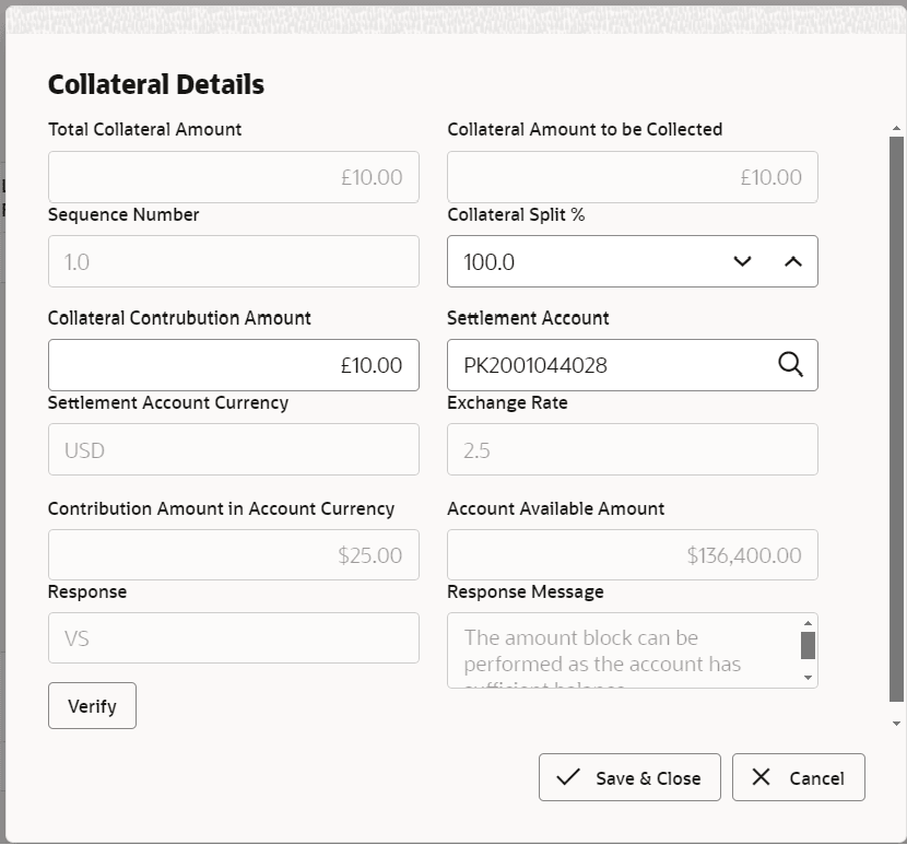

    Collateral Details pop-up screen Below fields are displayed on the Collateral Details pop-up screen.
    Total Collateral Amount Read only field.
    This field displays the total collateral amount provided by the user.
    Collateral Amount to be Collected Read only field.
    This field displays the collateral amount yet to be collected as part of the collateral split.
    Sequence Number Read only field.
    The sequence number is auto populated with the value, generated by the system.
    Collateral Split % Indicates the collateral split% to be collected against the selected settlement account.
    Collateral Contribution Amount Indicates the collateral amount to be collected against the selected settlement account.
    User can either provide the collateral % where the collateral amount will be auto populated or modifying the collateral amount will auto correct the collateral %.
    Settlement Account Indicates the settlement account for the collateral.
    Settlement Account Currency Read only field.
    This field displays the settlement account currency defaulted by the system.
    Exchange Rate Read only field.
    This field displays the exchange rate, if the settlement account currency is different from the collateral currency.
    Contribution Amount in Account Currency Read only field.
    This field displays the contribution amount in the settlement account currency as defaulted by the system.
    Account Balance Check Response Read only field.
    System populates the account balance check response value.
    System populates the response. Response can be ‘Success’ or ‘Amount not Available’.
    Response Message Read only field.
    System populates the detailed response message.
    Cancel Click to cancel the entry.
    Cash Collateral Details grid Below fields appear in the Cash Collateral Details grid along with the above fields.
    Collateral % Indicates the percentage of collateral to be linked to this transaction. If the value is more than 100% system will display an alert message.
    Contribution Amount This field displays the collateral contribution amount.
    Account Available Amount This field displays the account available amount which will be auto-populated based on the settlement account.
    View Link Click the View link to view the collateral details.
  4. Click Save and Close to save the details and close the screen.

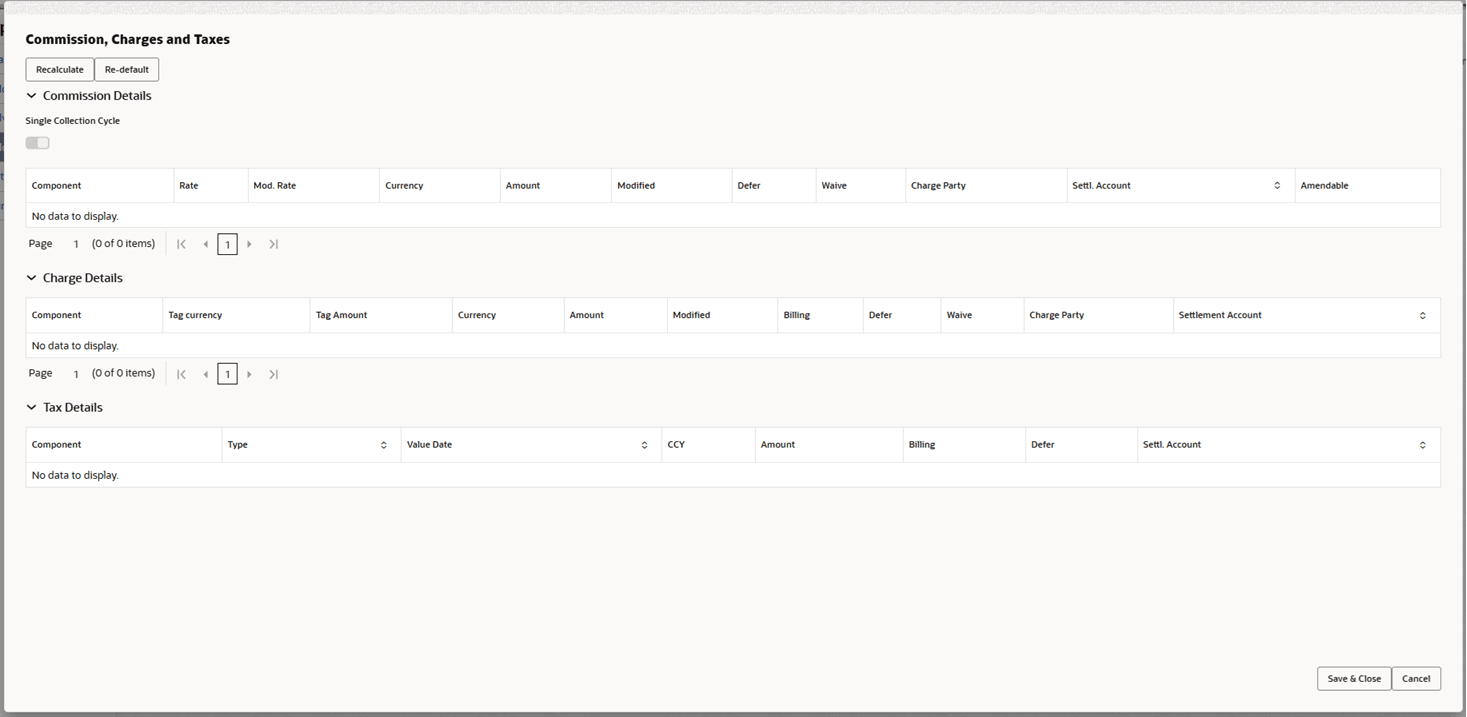

    Commission,Charges and Taxes
    In Additional Details section, default commission, charges and tax if any, will get populated.
    If default charges are available under the product, they should be defaulted here with values. If customer or customer group specific charges are maintained, then the same will be defaulted from back end system.
    Table 2-21 Commission,Charges and Taxes - Field Description
    Field Description
    Commission Details This section displays the commission details.
    By default, all the charges, commission and margin are collected from the counter-party.
    Single Collection Cycle for Commission
    This field is display only.
    The value displays as available in Bank Parameter at Back office
    When Single Cycle toggle is on, back office system follows single cycle for collecting commission as per the issuance commission cycle period for periodic commission.
    Commission Collection Method Select the Commission Collection Method from the following values:
    • Advance
    • Arrears
    The values are defaulted for commission Collection method as per product, which user can change. Based on collection method provided at contract level, for all commission component commission are collected and same is applicable for life cycle of the transaction.
    Component Displays the commission component.
    Rate Displays the rate that is defaulted from product.
    The commission rate, if available in Back Office defaults in OBTFPM. The user is able to change the rate.
    If flat commission is applicable, then commission amount defaulted from back office is modifiable by the user. Rate field will be blank and the user cannot modify the Rate field.
    Mod. Rate From the default value, if the rate is changed the value gets updated in this field.
    Currency Displays the currency in which the commission have to be collected.
    Amount Displays the amount that is maintained under the product code.
    The commission rate, if available in Back Office defaults in OBTFPM. The user is able to change the rate, but not the commission amount directly. The amount gets modified based on the rate changed and the new amount is calculated in back office based on the new rate and is populated in OBTFPM.
    Modified From the default value, if the amount is changed, the value gets updated in the modified amount field.
    Defer Switch to Enable for charges/commissions has to be deferred and collected at any future step.
    Waive Switch to Enable to waive the charges/commissions.
    Based on the customer maintenance, the charges/commission can be marked for Billing or Defer.
    If the defaulted Commission is changed to defer or billing or waive, system must capture the user details and the modification details in the ‘Remarks’ place holder.
    Split Switch to Enablefor splitting the Commission.
    Switch to Disableif splitting of commission is not required.
    Charge Party Charge party is 'Applicant' by default. User can change the value to Beneficiary.
    Settl. Account The settlement account.
    Amend Displays if the field is amendable or not.
    Charge Details This section displays the charge details.
    Component Displays the charge component type.
    Tag Currency Displays the tag currency in which the charges have to be collected.
    Tag Amount Displays the tag amount that is maintained under the product code.
    Currency Displays the currency in which the charges have to be collected.
    Amount This field displays the amount that is maintained under the product code.
    Modified From the default value, if the rate is changed or the amount is changed, the value gets updated in the modified amount field.
    Billing Switch to Enableto make the details available for billing engine for further processing, if charges are handled by separate billing engine.
    On simulation of charges/commission from Back Office, if any of the Charges/Commission component for the customer is ‘Billing’ enabled, ‘Billing’ toggle for that component should be automatically enabled in OBTFPM.
    The user can not enable/disable the option, if it is de-selected by default.
    This field is disabled, if ‘Defer’ toggle is enabled.
    Defer Switch to Enableto defer the charges and collect at any future step.
    On simulation of charges/commission from Back Office, if any of the Charges/Commission component for the customer is AR-AP tracking enabled, ‘Defer’ toggle for that component should be automatically checked in OBTFPM.
    The user can enable/disable the option the check box. On de-selection the user has to click on ‘Recalculate’ charges button for re-simulation.
    Waive Switch to Enableto waive the charges.
    Based on the customer maintenance, the charges should be marked for Billing or for Defer.
    This field is disabled, if Defer toggle is enabled.
    Switch to Disable, if splitting of commission is not required.
    Charge Party Displays the charge party. By default the charge party is ‘Applicant’.
    Settlement Account Click Search icon to search and select the settlement account.
    Tax Details This section displays the tax details.
    The tax component is calculated based on the commission and defaults if maintained at product level. User cannot update tax details and any change in tax amount on account of modification of charges/ commission will be available on click of Re-Calculate button or on hand off to back-end system.
    Component Displays the tax component.
    Type Displays the type of tax component.
    Value Date Displays the value date of tax component.
    Ccy Displays the currency in which the tax have to be collected.
    The tax currency is the same as the commission.
    Amount Displays the tax amount based on the percentage of commission maintained.
    The user can edit the tax amount, if applicable.
    Billing Switch to Enableto make the details available for billing engine for further processing, if taxes are handled by separate billing engine.
    Defer Switch to Enableto defer the taxes and collect at any future step.
    Switch to Disableif you do not want to defer the taxes.
    On disabling the user has to click on ‘Recalculate’ charges button for re-simulation.

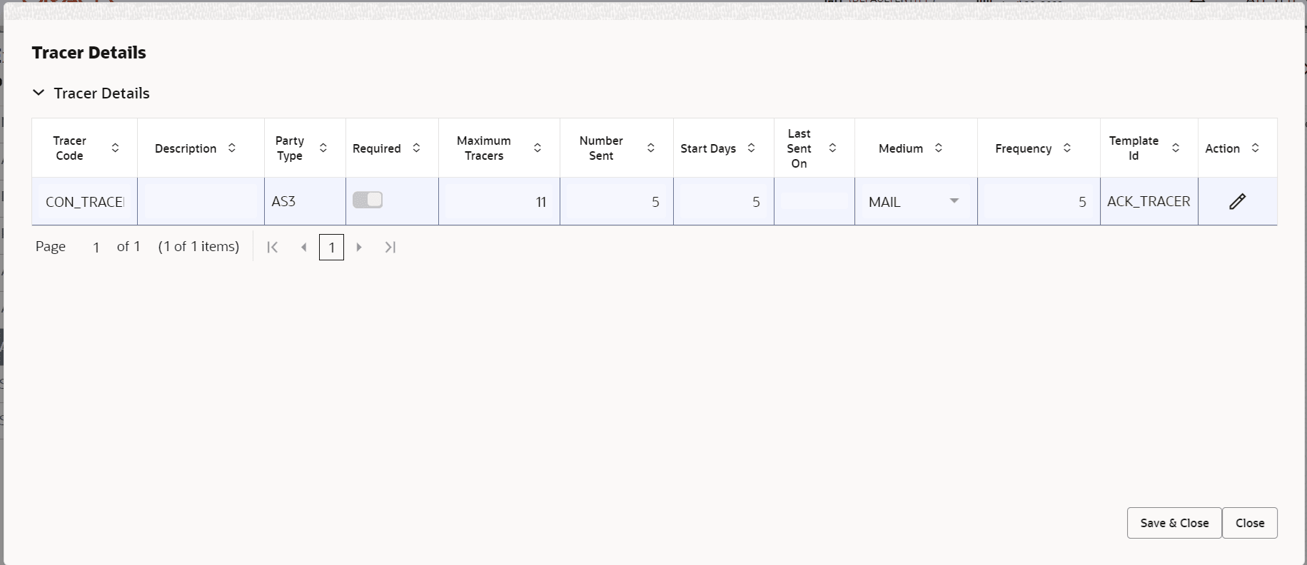

    Tracer Details
    This section enables the user to view the default Tracer details from back end application. It also allows the user to edit the Tracer details.
    Table 2-22 Tracer Details - Field Description
    Field Description
    Tracer Code Read only field.
    Tracer code is auto-populated from the latest LC.
    Description Read only field.
    Tracer description is auto-populated from the latest LC.
    Party Type Party type is auto-populated from the latest LC.
    The user can change the party type.
    Required
    Switch onEnableto capture the tracer details.
    Switch off Disable, if user does not require to capture tracer details.
    Maximum Tracers Specify the value for maximum number of tracers.
    Number Sent Specify the number of tracers sent
    Start Days Specify the tracer start days.
    Last Sent On Read only field.
    The date on which the tracer is last sent.
    Medium Select the tracer medium from the drop-down.
    • Mail
    • Swift
    Frequency System defaults the days set up at the product level. Value can be 1, 2 etc. which represents daily, once in 2 days etc.
    The user can change the frequency.
    Template ID Click Search icon to search and select the party type of the template ID from the lookup.
    Action Click the edit icon to edit the tracer details.
  6. Click Save and Close to save the details and close the screen.

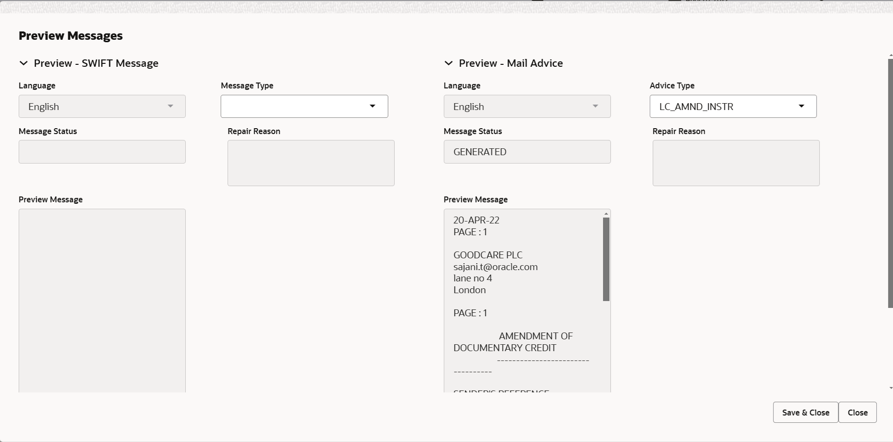

    Preview Messages
    The bank user can view a preview of the message and advice simulated from back office which is based on the details captured in the previous screen.
    Field Description
    Preview SWIFT Message This section displays the preview of SWIFT Messages fields.
    Language Select the language for the SWIFT message.
    Message Type Select the message type.
    Message Status Read only field.
    Display the message status of draft message of liquidation details.
    Repair Reason Read only field.
    Display the message repair reason of draft message of LC reopening details.
    Preview Message This field displays a preview of the draft message.
    Preview Mail Advice This section displays the preview of Mail Advice fields.
    Language Select the language for the advice message.
    Advice Type Select the advice type.
    Display the message status of draft message of LC reopening details.
    Display the message repair reason of draft message of liquidation details.
  7. Click Save and Close to save the details and close the screen.

  8. Click Next.
    The task will move to next data segment.
    For more information on action buttons, refer to the field description table below.
    Table 2-24 Additional Details - Action Buttons - Field Description
    Field Description
    Clarification Details Clicking the button opens a detailed screen, user can see the clarification details in the window and the status will be ‘Clarification Requested’.
    Documents Click to View/Upload the required document.
    Application displays the mandatory and optional documents.
    The user can view and input/view application details simultaneously.
    When a user clicks on the uploaded document, Document window get opened and on clicking the view icon of the uploaded document, Application screen should get split into two. The one side of the document allows to view and on the other side allows to input/view the details in the application.
    Remarks Specify any additional information regarding the LC Reopen. This information can be viewed by other users processing the request.
    Content from Remarks field should be handed off to Remarks field in Backend application.
    Overrides Click to view the overrides accepted by the user.
    Customer Instruction Click to view/ input the following
    • Standard Instructions – In this section, the system will populate the details of Standard Instructions maintained for the customer. User will not be able to edit this.
    • Transaction Level Instructions – In this section, OBTFPM user can input any Customer Instructions received as part of transaction processing. This section will be enabled only for customer initiated transactions.
    Request Clarification User should be able to submit the request for clarification to the “Trade Finance Portal” User for the transactions initiated offline.
    Reject On click of Reject, user must select a Reject Reason from a list displayed by the system.
    Reject Codes are:
    • R1- Documents missing
    • R2- Signature Missing
    • R3- Input Error
    • R4- Insufficient Balance/Limits
    • R5 - Others
    Select a Reject code and give a Reject Description.
    This reject reason will be available in the remarks window throughout the process.
    Refer Select a Refer Reason from the values displayed by the system.
    Refer Codes are:
    • R3- Input Error
    • R5 - Others
    Hold The details provided will be saved and status will be on hold.User must update the remarks on the reason for holding the task.
    This option is used, if there are any pending information yet to be received from applicant.
    Cancel Cancel the Data Enrichment stage inputs. The details updated in this stage are not saved. The task will be available in 'My Task' queue.
    Save & Close Save the details provided and holds the task in ‘My Task’ queue for further update. This option will not submit the request.
    Back Click Back to move to the previous screen of Data Enrichment stage.
    Next On click of Next, system validates if all the mandatory fields have been captured. Necessary error and override messages to be displayed. On successful validation, system moves the task to the next data segment.
