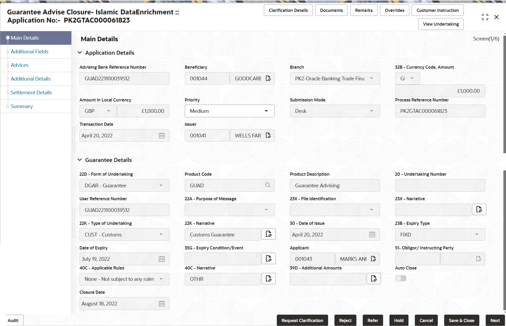

2.3.1 Main Details
This topic provides the systematic instructions to initiate the main details of Data Enrichment stage of Guarantee Advise Closure - Islamic request.
- Application Details
- Guarantee Details.
All fields displayed under Application details section, would be read only except for the Priority field.
- On Main Details screen, specify the fields that were not
entered at Registration stage.
Figure 2-8 Main Details
Description of the illustration demainapplicationdetails.pngNote:
The fields which are marked as Required are mandatory.For more information on fields, refer to the field description table below.
Table 2-6 Guarantee Advise Closure - Main - Application Details - Field Description
Field Description Advising Bank Reference Number Read-only field. The Advising Bank Reference Number as per the latest Guarantee/SBLC advise details is displayed.
Beneficiary Read-only field. The Beneficiary of Guarantee/SBLC as per the latest Guarantee/SBLC advise details is displayed.
Branch Read-only field. System will default the branch from Guarantee Advise.
Currency Code, Amount Read-only field. The amount of Undertaking and currency code as per the latest Guarantee/SBLC advise details is displayed.
Amount In Local Currency Read only field. System fetches the local currency equivalent value for the transaction amount from back office (with decimal places).
Priority This field will be defaulted based on the priority maintenance. Set the priority of the Guarantee Advice Closure request as Low/Medium/High/Critical/Essential. If priority is not maintained for a customer, Medium priority will be defaulted. The user can change the priority.
Submission Mode Read-only field. Displays the submission mode of Guarantee Advise Closure request. By default the submission mode will have the value as ‘Desk’.
- Desk - Request received through Desk
- Courier - Request received through Courier
- Fax - Request received through Fax
- Email - Request received through Email
Process Reference Number Read-only field. Unique sequence number for the transaction.This is auto generated by the system based on process name and branch code.
Transaction Date Read-only field. System defaults branch date.
Issuer Read-only field. The Issuing Bank as per the latest Guarantee/SBLC details is displayed.

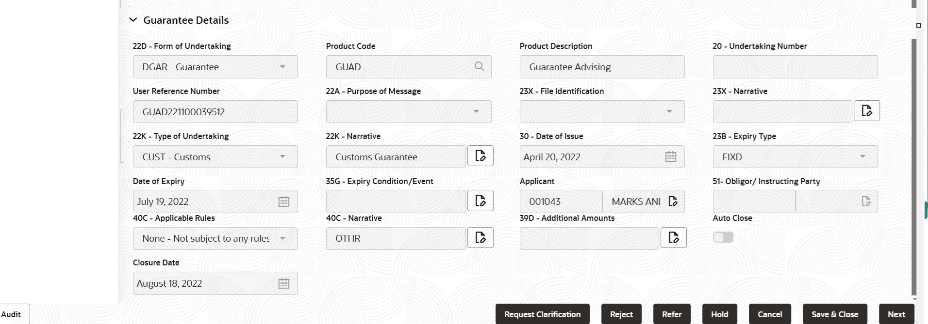

Guarantee DetailsThe fields listed under this section are same as the fields listed under the Guarantee Details section in Registration stage.
Figure 2-9 Guarantee Details
Description of the illustration demainguaranteedetails.pngFor more information on action buttons, refer to the field description table below.
Table 2-7 Guarantee Advise Closure - Islamic - Main - Guarantee Details - Field Description
Field Description Form of Undertaking Read-only field. Form of Undertaking (Guarantee/Standby LC) as per the latest Guarantee/SBLC details is displayed.
Product Code Read-only field. The product code used for SBLC/Guarantee advise is displayed.
Product Description Read only field. This field displays the description of the product as per the latest Guarantee/SBLC advise.
Undertaking Number Read-only field. The undertaking number as per the latest Guarantee/SBLC advise is displayed.
User Reference Number Read-only field. System defaults the user reference number, depending on the selection of Advising Bank Reference Number in the Registration stage.
Purpose of Message Read-only field. The Purpose of message (ACNF/ADVI) used during SBLC/Guarantee advise is displayed.
File Identification Read-only field. The File Identification as per the latest Guarantee/SBLC advise details is displayed and populated from Incoming MT 760.
Narrative Read-only field. Any kind of Narrative/Additional text as per the latest Guarantee/SBLC advise details is displayed.
Type of Undertaking Read-only field. The type of Undertaking as per the latest Guarantee/SBLC advise details is displayed.
Date of Issue Read-only field. The date of issue as per the latest Guarantee/SBLC advise details is displayed.
Expiry Type Read-only field. The type of Expiry as per the latest Guarantee/SBLC advise details is displayed..
Date of Expiry Read-only field. The date of Expiry as per the latest Guarantee/SBLC advise details is displayed.
Expiry Condition/Event Read-only field. The expiry condition/event as per the latest Guarantee/SBLC advise details is displayed.
Applicant Read-only field. Applicant details will be auto populated based on the details provided in Application Details section.
Obligor/ Instructor Party Read-only field. The Obligor/I nstructing Party as per the latest Guarantee/SBLC advise details is displayed.
Applicable Rules Read-only field. Applicable Rules as per the latest Guarantee/SBLC advise details is displayed.
Additional Amounts Read-only field. Any additional amounts related to undertaking as per the latest Guarantee/SBLC advise details is displayed.
Auto Close Read-only field. System default the value from the previous versions of the contracts.
Closure Date Read-only field. System default the value from the previous versions of the contracts.
