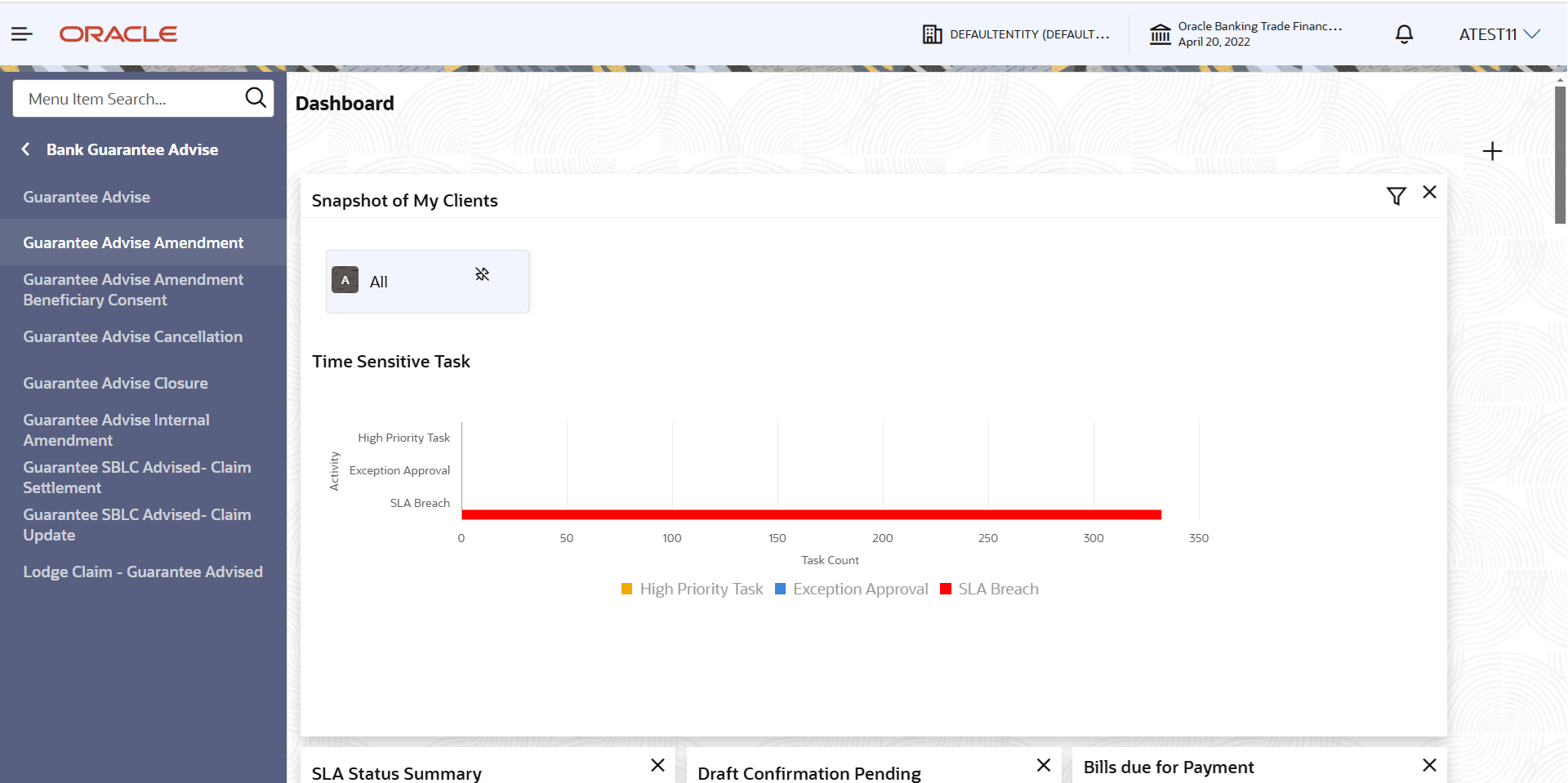

  1. On Home screen, click Trade Finance. Under Trade Finance, click Bank Guarantee Advise.
  2. Under Bank Guarantee Advise, click Guarantee Advise Amendment.

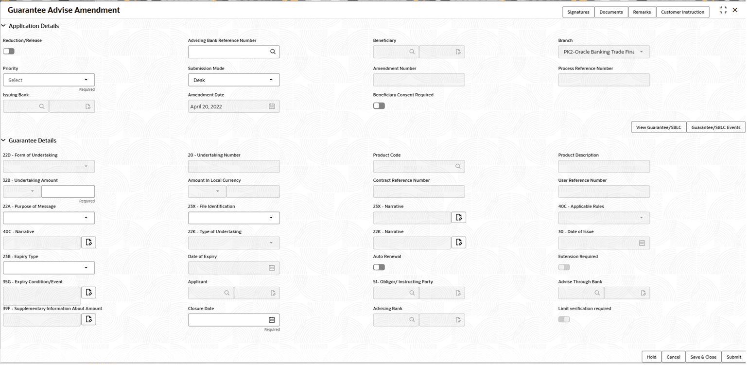

    The Guarantee Advise Amendment - Registration screen displays.
    The Guarantee Advise Amendment - Registration stage has two sections Application Details and Guarantee Details. Let’s look at the details of Registration screens below:
    Figure 2-4 Guarantee Advise Amendment - Registration - Application Details
    Description of Figure 2-4 follows
    Description of "Figure 2-4 Guarantee Advise Amendment - Registration - Application Details"
  3. On Guarantee Advise Amendment - Registration - Application Details screen, specify the fields.
    The fields which are marked as Required are mandatory.
    Table 2-3 Guarantee Advise Amendment - Registration - Application Details - Field Description
    Field Description
    Advising Bank Reference Number Specify the advising bank reference number or click Search to search and select the advising bank reference number from look-up, by entering the search criteria.
    Beneficiary Read only field.
    System defaults the beneficiary as per the Guarantee/SBLC advised.
    Branch Read only field.
    Branch Name will be auto-populated from Guarantee /SBLC Advise.
    Once the request is submitted, Branch field is non-editable.
    Priority This field will be defaulted based on the priority maintenance.
    If priority is not maintained for a customer, ‘Medium' priority will be defaulted.
    User can change the priority populated any time before submit of Registration stage as per the requirement.
    Submission Mode Select the submission mode of Guarantee Advise request from the drop-down list.
    By default the submission mode will have the value as ‘Desk’.
    • Desk - Request received through Desk
    • Courier - Request received through Courier
    • Email - Request received through Email
    • SWIFT - Non STP- Request received through SWIFT
    • Fax - Request received through Fax
    Amendment Number Read only field.
    Amendment number will be auto-populated based on the back-end simulation.
    Process Reference Number Read only field.
    Unique OBTFPM task reference number for the transaction.
    This is auto generated by the system based on process name and branch code.
    Issuing Bank System defaults the issuing bank as per the Guarantee/SBLC advised.
    Party type with banks will only be displayed in look-up.
    Amendment Date Read only field.
    The application displays the current system date by default.
    Back dating not allowed, if the amendment is authorized on a later date, system should update the branch date of authorization as the Amendment date.
    Beneficiary Consent Required Enable the option, if beneficiary consent required for the amendment made to the fields.
    Disable the option, if beneficiary consent is not required for the amendments.

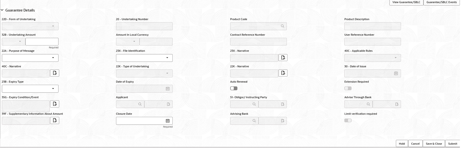

    Guarantee Details
    Registration user can provide Guarantee details in this section.
    Description of registrationguaranteedetails.png follows
  4. On Guarantee Advise Amendment - Registration - Guarantee Details screen, specify the fields.
    For more information on fields, refer to the field description table below.
    Table 2-4 Guarantee Details - Field Description
    Field Description
    Form of Undertaking Read only field.
    Form of Undertaking defaults from Guarantee/ SBLC Advise.
    Form of Undertaking values can be:
    • DGAR - Guarantee
    • STBY - Standby LC
    Undertaking Number Read only field.
    Undertaking Number defaults from Guarantee/ SBLC Advise.
    Product Code Read only field.
    System defaults the value from Guarantee/ SBLC Advise.
    Product Description Read only field.
    System defaults the description of the product from Guarantee/ SBLC Advise.
    Undertaking Amount System defaults the value from Guarantee/ SBLC Advise.
    The user can change the undertaking amount but not the currency.
    Amount In Local Currency Read only field.
    System fetches the local currency equivalent value for the transaction amount from back office (with decimal places).
    Contract Reference Number Read only field.
    Auto-generated by back end application.
    Number will be populated based on the Product Code.
    User Reference Number Read only field.
    System defaults the user reference number from Guarantee/ SBLC Advise.
    Purpose of Message System defaults the value from Guarantee/ SBLC Advise.
    The user can change the value.
    Select the purpose of message from the drop-down.
    The values are:
    • Advice and confirmation of amendment to issued undertaking
    • Advice of amendment to issued undertaking
    In case of STP of Incoming MT 767, system displays the value available in incoming MT 767.
    File Identification Select the type of delivery channel and its associated file name or reference from the available values.
    The options are:
    • COUR - Courier delivery
    • EMAL - Email transfer
    • FACT - SWIFTNet FileAct
    • FAXT - Fax transfer
    • HOST - Host-to-Host
    • MAIL - Postal Delivery
    • OTHR - Other delivery channel
    Narrative Specify the description available in the amendment instrument. If applicable.
    This field is enabled, if File Identification field values are COUR or OTHR.
    Applicable Rules Read only field.
    System defaults the rules for guarantee, from Guarantee/ SBLC Advise.
    Narrative Specify the description in this field, if Applicable Rules field values is OTHR.
    Type of Undertaking Read only field.
    Narrative Specify the details of any other type of local undertaking.
    This field is enabled if the Type of Undertaking has value as OTHR .
    Date of Issue Read only field.
    Expiry Type Indicates the validity of the guarantee.
    The options are
    • COND - With Expiry
    • CONU - Without Expiry
    • FIXD - Specified expiry date (with/without automatic expansion)
    • OPEN - No specific date of expiry
    User can amend the field, if required.
    Date of Expiry Indicates the validity of the guarantee. System defaults the expiry date of Guarantee from Guarantee/ SBLC Advise.
    This field is enabled if the Expiry Type is COND or FIXD.
    Expiry Condition/Event This field indicates the documentary condition/event that indicates when the local undertaking will cease to be available.
    This field is enabled if the Expiry Type is COND or CONU.
    Applicant Read only field.
    Obligor/ Instructor Party System defaults the name of the obligor from Guarantee/ SBLC Advise.
    Advise Through Bank System defaults the value from Guarantee/ SBLC Advise.
    Supplementary Information About Amount Read only field.
    System defaults any additional information about amount from Guarantee/ SBLC Advise.
    Closure Date System defaults the “Closure Date”value from the previous version of the contract.
    User can modify the system defaulted “Closure Date” and system should validate the same for the below conditions:
    • Closure Date must be after the Issue Date
    • Closure Date must be after the Expiry Date
    • Closure Date cannot be blank
    Advising Bank Specify the Advising Bank or click Search to search and select the advising bank reference number from look-up, by entering the search criteria.
    Limit verification required Read only field.
    The field value defaults to yes, if Limit is already available in contract. The field value defaults No, if contract does not have limit.
