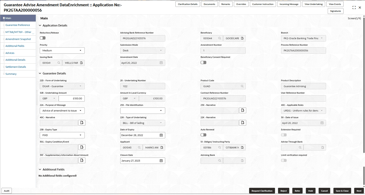

2.3.1 Main Details
This topic provides the systematic instructions to initiate the Main details of Data Enrichment stage of Guarantee Advise Amendment request.
Main details section has two sub section as follows:
  • Application Details
  • Guarantee Details.
Application Details
All fields displayed under Application details section, would be read only except the Priority and Beneficiary Consent Required fields.
  1. On Data Enrichment - Main Details screen, specify the fields that were not entered at Registration stage.
    Figure 2-7 Data Enrichment - Main Details
    Description of Figure 2-7 follows
    Description of "Figure 2-7 Data Enrichment - Main Details"
    For more information on fields, refer to the field description table below.

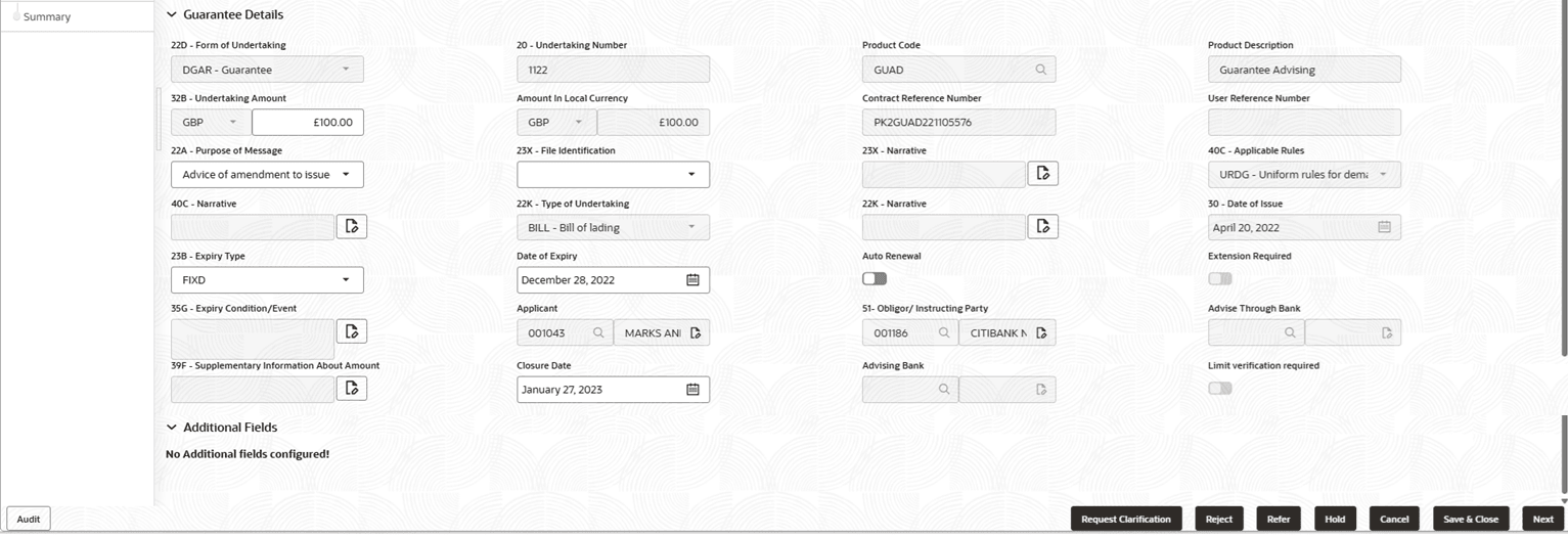

    Guarantee Details
    The fields listed under this section are same as the fields listed under the Guarantee Details section in Registration stage. For more information on the fields, refer Registration stage. During Registration, if user has not captured input, then user can capture the details in this section.
    For more information on action buttons, refer to the field description table below.
    Table 2-7 Guarantee Advise Amendment Islamic - Main - Guarantee Details - Field Description
    Field Description
    Form of Undertaking Read only field.
    Displays the type of LC (Documentary Credit).
    Undertaking Number Read only field.
    Displays the undertaking number available in the guarantee/SBLC.
    Product Code Read only field.
    Displays the product code available in the guarantee/SBLC.
    Product Description Read only field.
    Displays the description of the product as per the product code.
    Undertaking Amount System defaults the value from Guarantee/ SBLC Advise.
    The user can change the undertaking amount but not the currency.
    Amount In Local Currency Read only field.
    Displays the Local currency and amount value in this field. System fetches the local currency equivalent value for the transaction amount from back office (with decimal places).
    Contract Reference Number Read only field.
    Displays the Contract Reference Number, auto-generated by back end application.
    User Reference Number Read only field.
    System defaults the user reference number from Guarantee/ SBLC Advise.
    Purpose of Message System defaults the value from Guarantee/ SBLC Advise.
    The user can change the value.
    The values are:
    • Advice and confirmation of amendment to issued undertaking
    • Advice of amendment to issued undertaking
    File Identification Select the type of delivery channel and its associated file name or reference from the available values.
    The options are:
    • COUR - Courier delivery
    • EMAL - Email transfer
    • FACT - SWIFTNet FileAct
    • FAXT - Fax transfer
    • HOST - Host-to-Host
    • MAIL - Postal Delivery
    • OTHR - Other delivery channel
    Narrative Specify the description in this field, if File Identification field values are COUR or OTHR .
    Applicable Rules Read only field.
    System defaults the rules for guarantee, from Guarantee/ SBLC Advise.
    Narrative Specify the description in this field, if Applicable Rules field values is OTHR .
    Type of Undertaking Read only field.
    System defaults the guarantee type. The type of undertaking can be:
    • Advance Payment Guarantee
    • BILL - Bill of Lading
    • CUST - Customs
    • DPAY - Direct Pay
    • INSU - Insurance
    • JUDI - Judicial
    • LEAS - Lease
    • PAYM - Payment
    • PERF - Performance
    • RETN - Retention
    • SHIP - Shipping - For shipping guarantee
    • TEND - Tender or Bid
    • WARR - Warranty/ maintenance
    • OTHR - Any other local undertaking type.
    Narrative Specify the details of any other type of local undertaking.
    This field is enabled if the Type of Undertaking has value as OTHR .
    Date of Issue Read only field.
    System defaults the branch’s current date as date of issue defaulted from the application.
    Expiry Type System defaults the value from Guarantee/ SBLC Advise.
    This field indicates whether undertaking has specified expiry date or is open-ended.
    The options are:
    • COND - With Expiry
    • CONU - Without Expiry
    • FIXD - Specified expiry date (with/without automatic expansion)
    • OPEN - No specific date of expiry
    User can amend the field, if required.
    Date of Expiry Read only field.
    Displays the expiry date of the LC. The expiry date can be equal or greater than the issue date.
    The field is enabled, if Expiry Type is COND and FIXD.
    Expiry Condition/Event Specifies the documentary condition/event that indicates when the local undertaking will cease to be available.
    The field is enabled, if Expiry Type is COND or CONU.
    Applicant Read only field.
    Obligor/ Instructor Party Read only field.
    System defaults the name of the obligor from Guarantee/ SBLC Advise to reimburse the issuer.
    Advise Through Bank Read only field.
    Supplementary Information About Amount Read only field.
    System defaults any additional information about amount from Guarantee/ SBLC Advise.
    Closure Date System defaults the “Closure Date”value from the previous version of the contract.
    User can modify the system defaulted “Closure Date” and system should validate the same for the below conditions:
    • Closure Date must be after the Issue Date.
    • Closure Date must be after the Expiry Date.
    • Closure Date cannot be blank
    Advising Bank Specify the Advising Bank or click Search to search and select the advising bank reference number from look-up, by entering the search criteria.
    Limit verification required Read only field.
    The field value defaults to yes, if Limit is already available in contract. Value defaults to No, if contract does not have limit.
