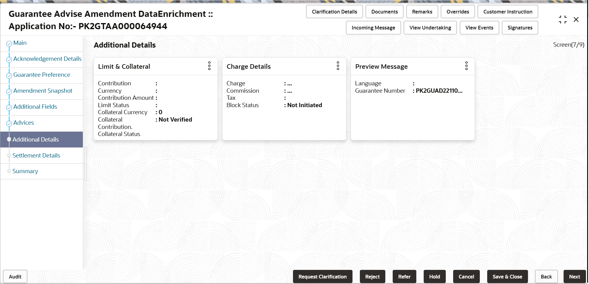

2.3.7 Additional Details
This topic provides the systematic instructions to capture the additional details in Data Enrichment stage of Guarantee Advise Amendment process.
In the Additional details section, Guarantee /Standby amendment can have impact on the Limits and Collaterals section.
If any of the fields in the financial section of the pop up screen is checked then the limits and collaterals screen will be enabled.
For non-financial and narrative field amendments, the Limits and Collaterals screen will be read only. User cannot make changes.
  1. On Additional Details screen, click the 3 dots on any Additional Details tile to view the details.

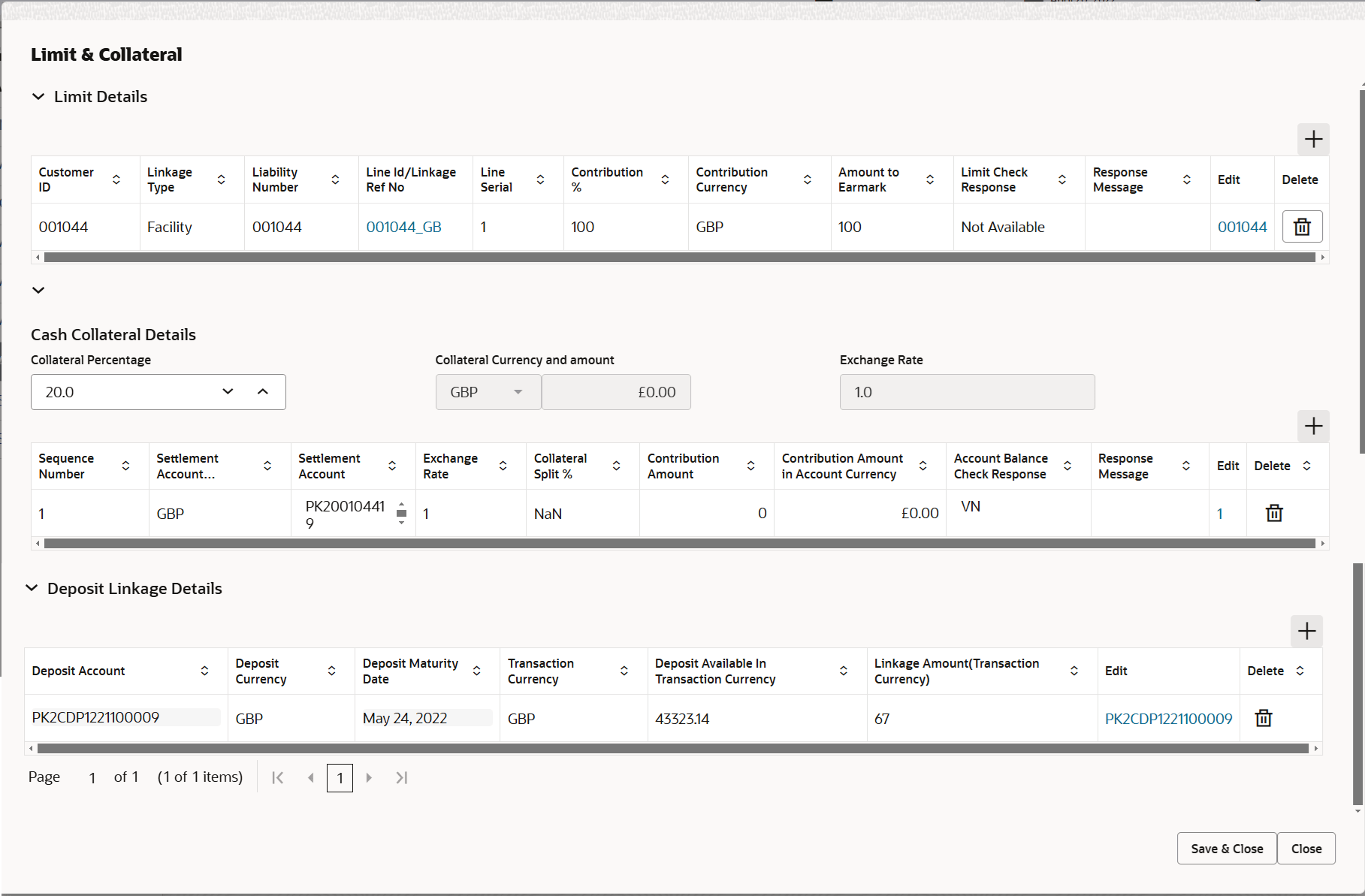

    There is change in limits, if the below fields were amendment.
    • Increase in Amount
    • Increase in Expiry Date
    • Increase in Tolerance
    The additional details are displayed as tile. The tiles displays a list of important fields with values. User will be able to drill down from tiles into respective data segments. User can select the tile, an update the respective details.
    Description of delimitdetails.png follows
    On Approval, system should not release the Earmarking against each limit line and system should handoff the “Limit Earmark Reference Number “to the back office. On successful handoff, back office will make use of these “Limit Earmark Reference Number” to release the Limit Earmark done in the mid office (OBTFPM) and should Earmark the limit from the Back office.
    In case multiple Lines are applicable, Limit Earmark Reference for all lines to be passed to the back office.
    For more information on fields, refer to the field description table below.
    Table 2-19 Limit Details - Field Description
    Field Description
    Plus Icon Click plus icon to add new limit details.
    Limit Details
    Click + plus icon to add new limit details.
    Below fields are displayed on the Limit Details pop-up screen, if the user clicks plus icon.
    Customer ID Read only field.
    The field value displays as available for contract.
    Linkage Type Read only field.
    By default Linkage Type is “Facility”.
    Contribution % Read only field.
    The collateral % maintained for the customer is defaulted into the Collateral Details screen. If collateral % is not maintained for the customer, then system should default the collateral % maintained for the product. User can modify the defaulted collateral percentage, in which case system should display a override message “Defaulted Collateral Percentage modified.
    Liability Number CRead only field.
    Contribution Currency Read only field.
    The LC currency is defaulted in this field.
    Line ID/Linkage Ref No Read only field.
    Limit/Liability Currency Read only field.
    Limits Description Read only field.
    Limit Check Response Read only field.
    Amount to Earmark Read only field.
    If Contract amount increase and Contract has confirmation, system by default increases the limit earmark amount to proportionate of confirmation amount.
    Expiry Date Read only field.
    This field displays the date up to which the Line is valid.
    Limit Available Amount Read only field.
    This field displays the value of available limit, i.e., limit available without any earmark.
    Response Message Read only field.
    This field displays the detailed response message.
    ELCM Reference Number Read only field.
    This field displays the ELCM reference number.
    Below fields appear in the Limit Details grid along with the above fields.
    Line Serial Read only field.
    Edit Read only field.
    Figure 2-18 Delete
    Delete Icon
    Read only field.
    Cash Collateral Details
    Collateral Percentage System populates the Collateral % maintained in the Customer / Product for the counter party of the contract.
    User can modify the collateral percentage.
    Collateral Currency and amount System populates the contract currency as collateral currency by default.
    User can modify the collateral Currency and amount.
    Exchange Rate System populates the exchange rate maintained.
    System validates for the Override Limit and the Stop limit if defaulted exchange rate is modified.
    Plus Icon Click plus icon to add new collateral details.
    Figure 2-19 Delete
    Delete Icon
    Click delete icon to delete the existing collateral details.
    Edit Click edit link to edit the collateral details.
    Click + plus icon to add new collateral details.
    Below fields are displayed on the Collateral Details pop-up screen, if the user clicks plus icon.
    Total Collateral Amount Read only field.
    This field displays the total collateral amount provided by the user.
    Collateral Amount to be Collected Read only field.
    This field displays the collateral amount yet to be collected as part of the collateral split.
    Sequence Number Read only field.
    The sequence number is auto populated with the value, generated by the system.
    Collateral Split % Collateral split% to be collected against the selected settlement account gets defaulted in this field.
    User can change the collateral split%.
    Collateral Contribution Amount Collateral contribution amount will get defaulted in this field.
    Settlement Account Click Search to search and select the settlement account for the collateral.
    Settlement Account Currency Read only field.
    Settlement Account Currency will be auto-populated based on the Settlement Account selection.
    Exchange Rate Read only field.
    This field displays the exchange rate, if the settlement account currency is different from the collateral currency.
    Contribution Amount in Account Currency Read only field.
    This field displays the contribution amount in the settlement account currency as defaulted by the system.
    Account Available Amount Read only field.
    Account available amount will be auto-populated based on the Settlement Account selection.
    System populates the account available amount on clicking the Verify button.
    Response can be ‘Success’ or ‘Amount not Available’.
    System populates the response on clicking the Verify button.
    Detailed Response message.
    System populates the response message on clicking the Verify button.
    Verify Click to verify the account balance of the Settlement Account.
    Save & Close Click to to save and close the record.
    Cancel Click to cancel the entry.
    Below fields appear in the Cash Collateral Details grid along with the above fields.
    Collateral % Specify the percentage of collateral to be linked to this transaction. If the value is more than 100% system will display an alert message.
    System defaults the collateral % maintained for the customer into the Collateral Details screen. If collateral % is not maintained for the customer, then system should default the collateral % maintained for the product.
    Contribution Amount This field displays the collateral contribution amount.
    Account Balance Check Response This field displays the account balance check response.
    Figure 2-20 Delete
    Delete Icon
    Deposit Linkage Details
    In this section which the deposit linkage details is captured.
    System should allow the user to Link one or more existing Deposits as a contribution to secure underlying transactions. On Submit of DE stage, system will create Linkage of the Deposit/modification of existing Linkage by calling Back-office system (DDA) system directly.
    Click + plus icon to add new Deposit Linkage details.
    Plus Icon Click plus icon to add new deposit linkage details.
    Below fields are displayed on the Deposit Linkage Details pop-up screen, if the user clicks plus icon.
    Customer Id Customer ID is defaulted from the system.
    User can change the customer ID.
    Deposit Account Click Search to search and select deposit for linkage from the list of all the customer Deposits.
    All the Deposits of the customer should be listed in the List of Values search. User should be able to select the deposit for linkage.
    Deposit Branch This field displays the deposit branch which will be auto-populated based on the deposit account selection.
    Deposit Available Amount This field displays the deposit available amount and currency which will be auto-populated based on the deposit account selection.
    Deposit Maturity Date This field displays the maturity date of deposit.
    Exchange Rate This field displays the latest exchange rate for deposit linkage.
    This will be picked up from the exchange rate maintenance from the common core.
    Deposit Available In Transaction Currency This field displays the deposit amount available, after exchange rate conversion, if applicable.
    Linkage Percentage % Specify the value for linkage percentage.
    Linkage Amount (Transaction Currency) This field displays the transaction amount, user can change the value.
    Edit Click edit link to edit the deposit linkage details.
    Figure 2-21 Delete
    Delete Icon
    Click delete icon to delete the existing deposit linkage details.
  2. Click Save and Close to save the details and close the screen.

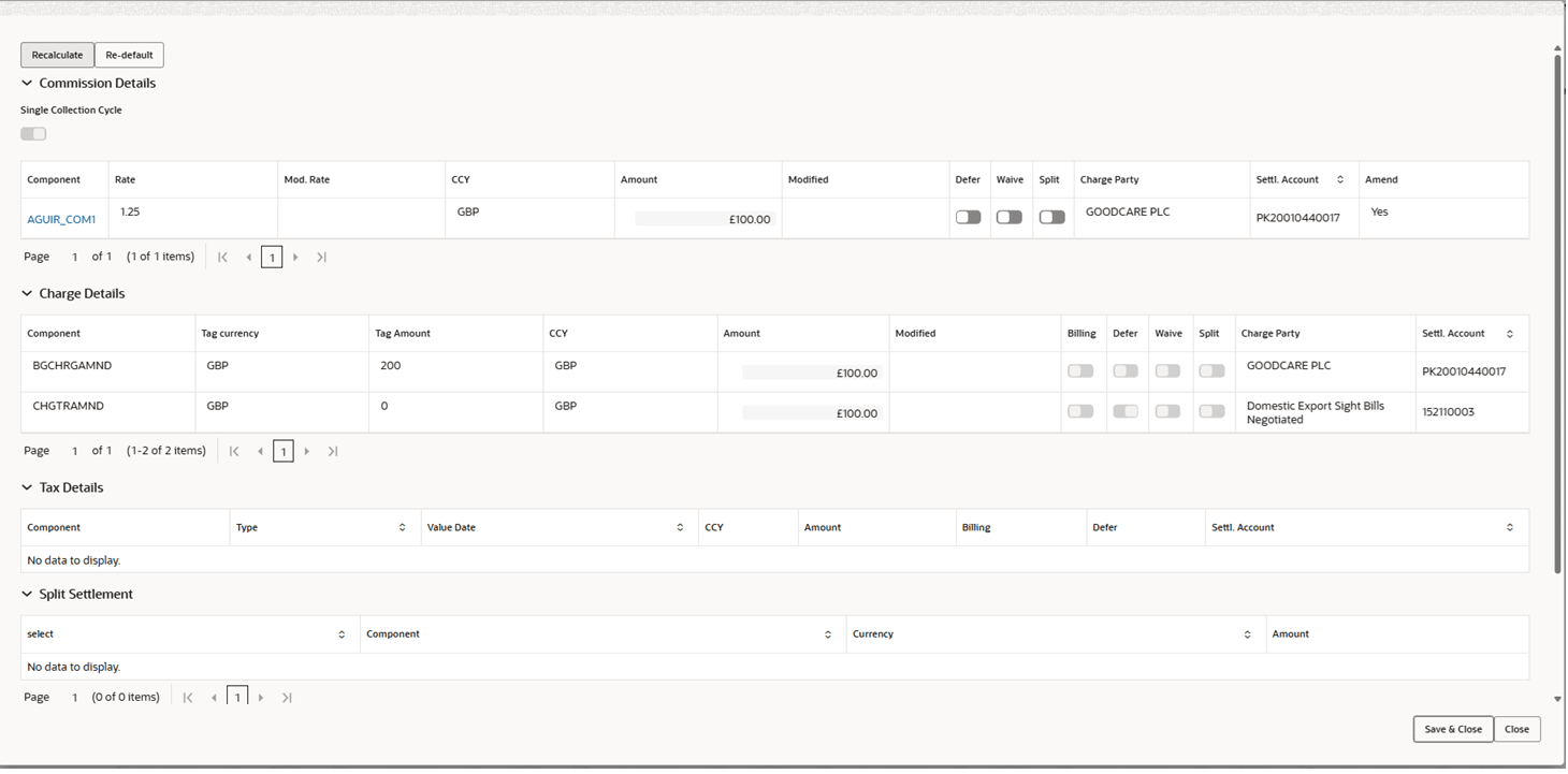

    Charge Details
    This section displays charge details. If default charges are available under the product, they should be defaulted here with values. If customer or customer group specific charges are maintained, then the same will be defaulted from back end system.
    The system also default the Charges/Commission Party maintained for the customer as per defined Class Maintenance in OBTF. System simulates the Charges, Commission and Tax details from the Back office.
    Description of dechargedetails.png follows

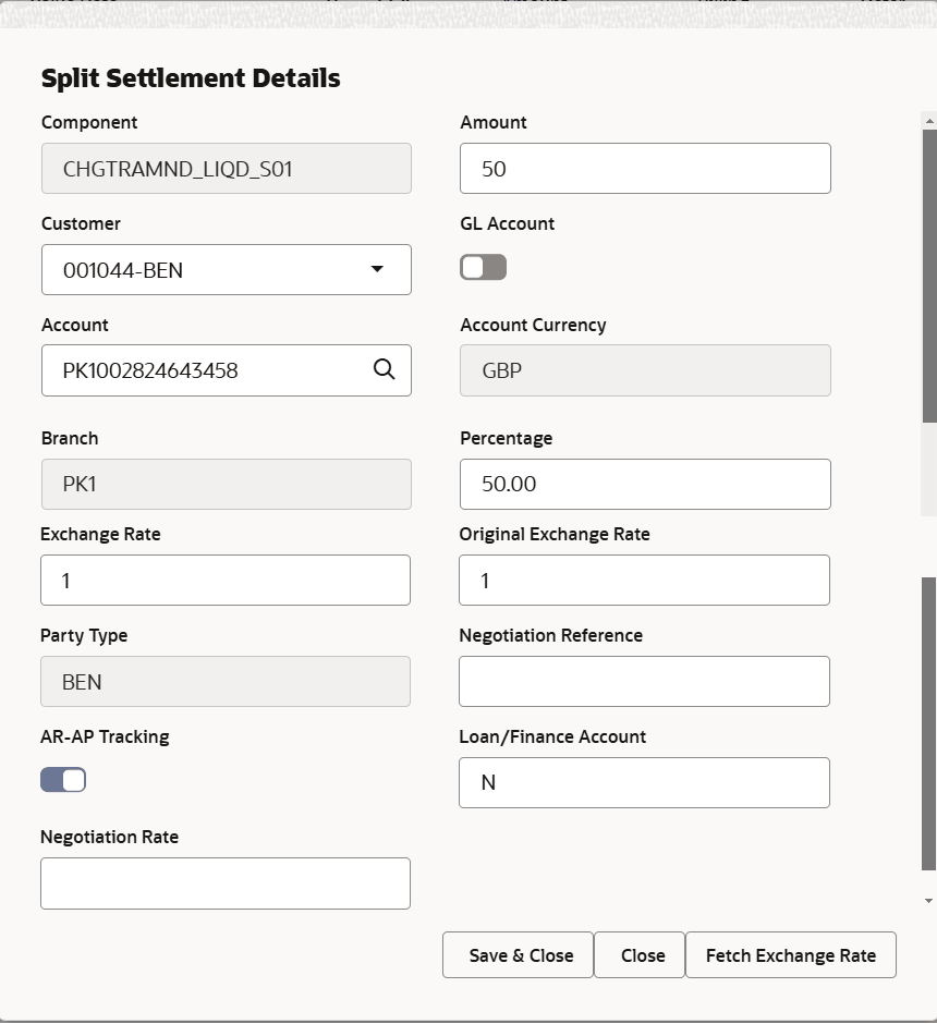

    Split Settlement Details
    Description of desplitsettlementdetails1.png follows
    Table 2-20 Charge Details - Field Description
    Field Description
    Event Read only field.
    This field displays the event name.
    Event Description Read only field.
    This field displays the description of the event.
    Commission Details
    Single Collection Cycle for Commission
    This field is display only.
    The value displays as available in Bank Parameter at Back office
    When Single Cycle toggle is on, back office system follows single cycle for collecting commission as per the issuance commission cycle period for periodic commission.
    Component This field displays the commission component.
    Rate This field displays the rate that is defaulted from product.
    The commission rate, if available in Back Office defaults in OBTFPM. The user is able to change the rate.
    If flat commission is applicable, then commission amount defaulted from back office is modifiable by the user. Rate field will be blank and the user cannot modify the Rate field.
    Modified Rate From the default value, if the rate is changed the value gets updated in this field.
    Currency This field displays the currency in which the commission have to be collected.
    Amount This field displays the amount that is maintained under the product code.
    The commission rate, if available in Back Office defaults in OBTFPM. The user is able to change the rate, but not the commission amount directly. The amount gets modified based on the rate changed and the new amount is calculated in back office based on the new rate and is populated in OBTFPM.
    Modified Amount From the default value, if the amount is changed, the value gets updated in the modified amount field.
    Defer If enabled, charges/commissions has to be deferred and collected at any future step.
    Waive Based on the customer maintenance, the charges/commission can be marked for Billing or Defer.
    If the defaulted Commission is changed to defer or billing or waive, system must capture the user details and the modification details in the ‘Remarks’ place holder.
    Split The user can split the Commission by enabling/ disabling the flag as per the requirement.
    Charge Party Charge party is 'Applicant' by default. User can change the value to Beneficiary.
    Settlement Account Select the settlement account.
    Amend Displays whether the field is amendable or not.
    Charge Details
    Component This field displays the charge component type.
    Tag Currency This field displays the tag currency in which the charges have to be collected.
    Tag Amount This field displays the tag amount that is maintained under the product code.
    Currency This field displays the currency in which the charges have to be collected.
    Modified From the default value, if the rate is changed or the amount is changed, the value gets updated in the modified amount field.
    Billing If charges are handled by separate billing engine, then by selecting billing the details to be available for billing engine for further processing.
    On simulation of charges/commission from Back Office, if any of the Charges/Commission component for the customer is ‘Billing’ enabled, ‘Billing’ toggle for that component should be automatically enabled in OBTFPM.
    The user can not enable/disable the option, if it is de-selected by default.
    This field is disabled, if ‘Defer’ toggle is enabled.
    Defer If charges have to be deferred and collected at any future step, this check box has to be selected.
    On simulation of charges/commission from Back Office, if any of the Charges/Commission component for the customer is AR-AP tracking enabled, ‘Defer’ toggle for that component should be automatically checked in OBTFPM.
    The user can enable/disable the option the check box. On de-selection the user has to click on ‘Recalculate’ charges button for re-simulation.
    Waive Enble the toggle, if charges has to be waived.
    Based on the customer maintenance, the charges should be marked for Billing or for Defer.
    This field is disabled, if Defer toggle is enabled.
    Split The bank User can split the Charges/Commission by enabling/disabling the flag as per the requirement.
    Charge Party Charge party is applicant by default. User can change the value to beneficiary.
    Tax Details
    The tax component is calculated based on the commission and defaults if maintained at product level. User cannot update tax details and any change in tax amount on account of modification of charges/ commission will be available on click of Re-Calculate button or on hand off to back-end system.
    Component This field displays the tax component.
    Type This field displays the type of tax component.
    Value Date This field displays the value date of tax component.
    Currency This field displays the currency in which the tax have to be collected.
    The tax currency is the same as the commission.
    Amount This field displays the tax amount based on the percentage of commission maintained.
    You can edit the tax amount, if applicable.
    Billing If taxes are handled by separate billing engine, then by selecting billing the details to be available for billing engine for further processing.
    Defer If taxes have to be deferred and collected at any future step, this option has to be enabled.
    Settlement Account System defaults the settlement account.
    The user can modify the settlement account.
    Split Settlement
    Once the user clicks on the Recalculate button to fetch the Split Settlement details from Backoffice, new section “Split Settlement” will appear below the ‘Tax’ section. The default parties in Split row should be fetched from OBTF.
    Component The split component type eligible for Split .
    Currency The currency of split settlement.
    Amount The amount of split settlement.
    Split Settlement details section appears from Back office, when the user clicks on the Recalculate button.
    Seqence The sequence number is auto populated with the value, generated by the system.
    Component The split component type eligible for Split.
    Amount The system splits the respective Charge/Commission amount automatically between counter party and third party with 50% value by default.
    The bank user can modify the amount.
    More than two splits are not allowed.
    Customer Indicates the ID of the Customer in Split Settlement Details section.
    Account The system defaults the settlement account.
    User can modify the settlement account. System initiates a call to common core tables within OBTFPM to select the account.
    Account Currency This field defaults the currency of the account.
    Branch Indicates the branch of the customer where transaction is getting processed.
    Percentage The system splits the respective Charge/Commission percentage automatically between counter party and third party with 50% value by default.
    The system should validate that the total percentage of each component doesn't exceed 100 and the total amount of each component doesn't exceed total component amount.
    Original Exchange Rate System displays the Original Exchange Rate as simulated in split settlement details section.
    Party Type System displays the party type in split settlement details section.
    Negotiation Reference Specify the negotiation reference number.
    AR-AP Tracking Indicates to defer the charge/ commission in Split Settlement Details section.
    The user can modify the AR-AP Tracking flag as per the requirements.
    Loan/Finance Account Displays the loan account.
    Negotiation Rate Specify the negotiation rate.

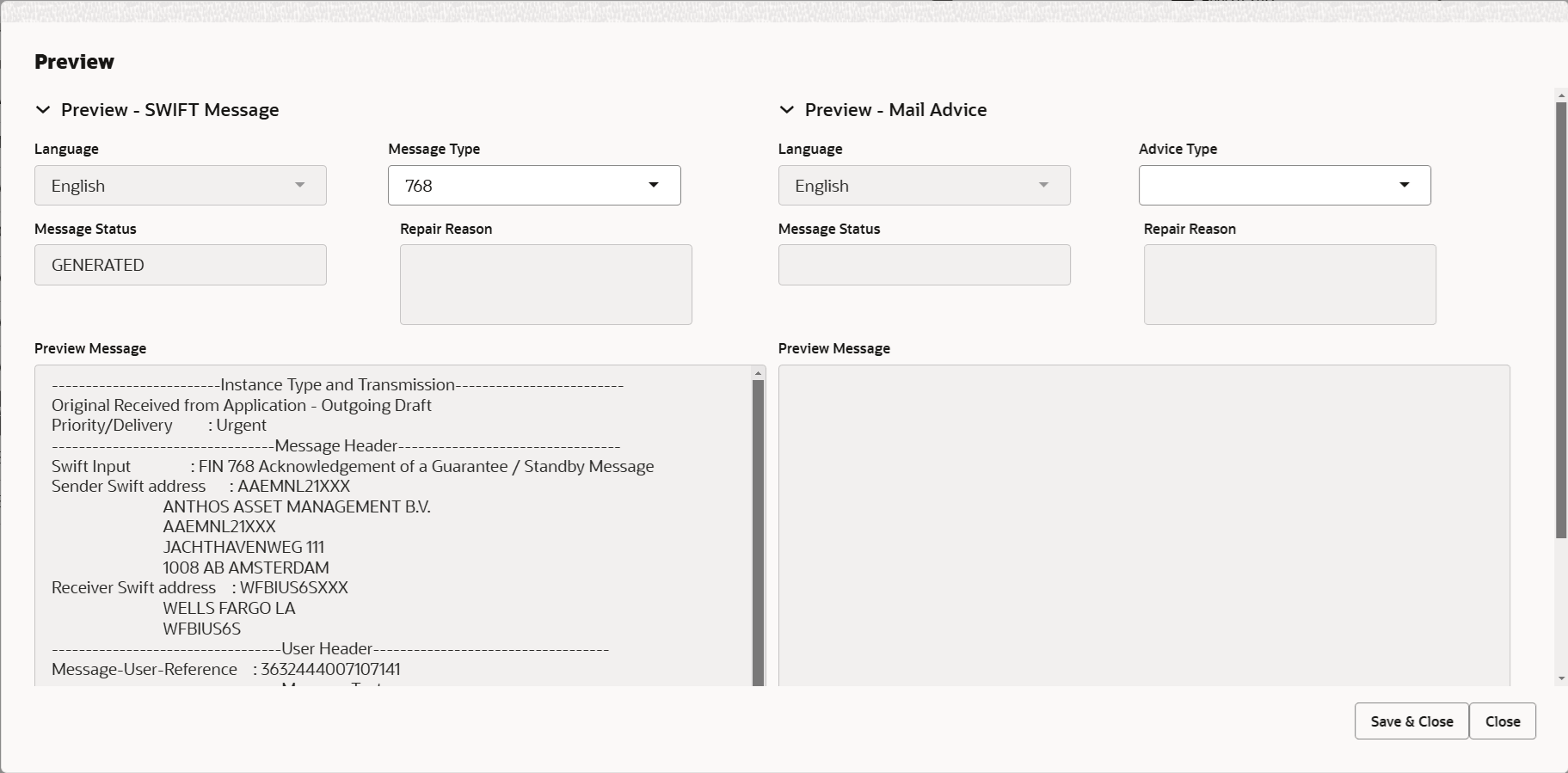

    Preview Mesage
    This screen provides preview of draft guarantee details. If required, the draft can be sent for legal verification to legal team and draft confirmation to customer.
    For Guarantee Advising MT 760, preview message has Debit advice, Instrument Copy, MT 768.Description of previewmessage.png follows
    Table 2-21 Preview Message - Field Description
    Field Description
    Preview SWIFT Message
    Language Read only field.
    The language to preview the draft guarantee details.
    English is set as default language for the preview.
    Message Type Select the message type from the drop down.
    Message Status Read only field.
    Display the message status of draft message of guarantee details
    Repair Reason Read only field.
    Display the message repair reason of draft message of guarantee details.
    Preview Message This field displays a preview of the draft message.
    Based on the guarantee text captured in the previous screen, guarantee draft is generated in the back office and is displayed in this screen.

    For more information on action buttons, refer to the field description table below.
    Table 2-22 Additional Details - Action Buttons - Field Description
    Field Description
    Clarification Details Click to open a detailed screen, user can see the clarification details in the window and the status will be Clarification Requested.
    Documents Click to View/Upload the required document.
    Application displays the mandatory and optional documents.
    The user can view and input/view application details simultaneously.
    When a user clicks on the uploaded document, Document window get opened and on clicking the view icon of the uploaded document, Application screen should get split into two. The one side of the document allows to view and on the other side allows to input/view the details in the application
    Remarks Specify any additional information regarding the Guarantee Advise Amendment. This information can be viewed by other users processing the request.
    Content from Remarks field should be handed off to Remarks field in Backend application.
    Overrides Click to view the overrides accepted by the user.
    Customer Instruction Click to view/ input the following
    • Standard Instructions – In this section, the system will populate the details of Standard Instructions maintained for the customer. User will not be able to edit this.
    • Transaction Level Instructions – In this section, OBTFPM user can input any Customer Instructions received as part of transaction processing. This section will be enabled only for customer initiated transactions.
    Incoming Message This button displays the multiple messages (MT767+ up to 7 MT775.
    Click to allow parsing of MT 767 along with MT775 (up to 7) messages together to create a Guarantee Issuance.
    In case of MT798-MT726-MT759 request, user can view MT798 message(726-759) in this placeholder in Header of the task.
    In case of MT798_MT788-MT799 request, user can view MT798 message (788-799) in this placeholder in Header of the process-task.
    View Undertaking Clicking this button allows the user should to view the undertaking details.
    View Events Click View Events button to view the snapshot of various events under the Guarantee Advised Amendment.
    Signatures Click the Signature button to verify the signature of the customer/ bank if required.
    The user can view the Customer Number and Name of the signatory, Signature image and the applicable operation instructions if any available in the back-office system.
    If more than one signature is available, system should display all the signatures.
    Request Clarification Click the Request Clarification button to request for an Online clarification from customer. Clicking the button opens a detailed screen to capture the clarification details.
    Save & Close Save the details provided and holds the task in ‘My Task’ queue for further update. This option will not submit the request.
    Cancel Cancel the Data Enrichment stage inputs. The details updated in this stage are not saved. The task will be available in 'My Task' queue.
    Hold The details provided will be saved and status will be on hold. User must update the remarks on the reason for holding the task.
    This option is used, if there are any pending information yet to be received from applicant.
    Reject On click of Reject, user must select a Reject Reason from a list displayed by the system.
    Reject Codes are:
    • R1- Documents missing
    • R2- Signature Missing
    • R3- Input Error
    • R4- Insufficient Balance/Limits
    • R5 - Others
    Select a Reject code and give a Reject Description.
    This reject reason will be available in the remarks window throughout the process.
    Refer Select a Refer Reason from the values displayed by the system.
    Refer Codes are:
    • R3- Input Error
    • R5 - Others
    Back On click of Back, system moves the task back to previous data segment.
    Next On click of Next, system validates if all the mandatory fields have been captured. Necessary error and override messages to be displayed. On successful validation, system moves the task to the next data segment.
