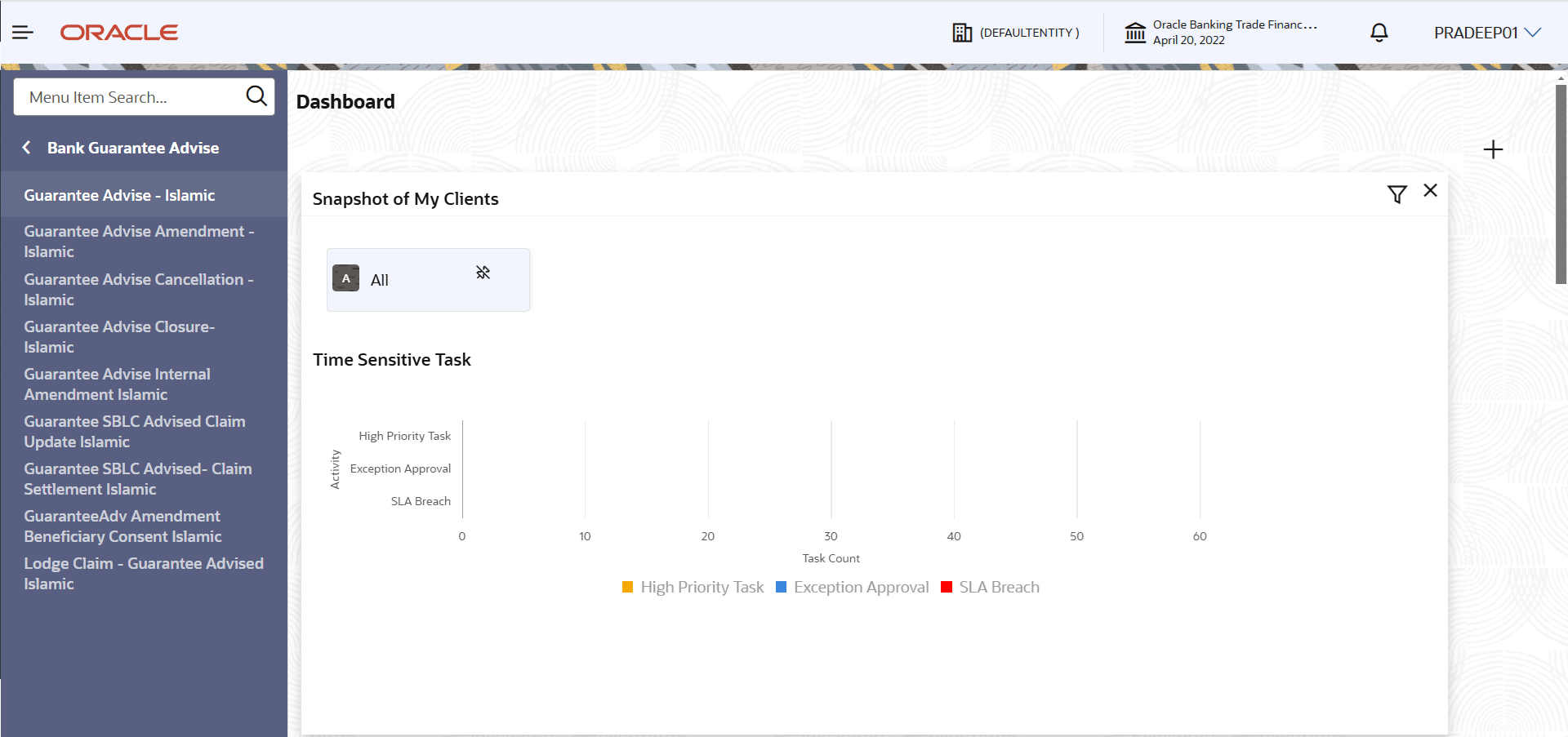

Specify User ID and Password, and login to Home screen.
  1. On Home screen, click Trade Finance Islamic. Under Trade Finance Islamic, click Bank Guarantee Advise.
  2. Under Bank Guarantee Advise, click Guarantee Advise Islamic.
    Figure 2-3 Guarantee Advice Islamic
    Description of Figure 2-3 follows
    Description of "Figure 2-3 Guarantee Advice Islamic"

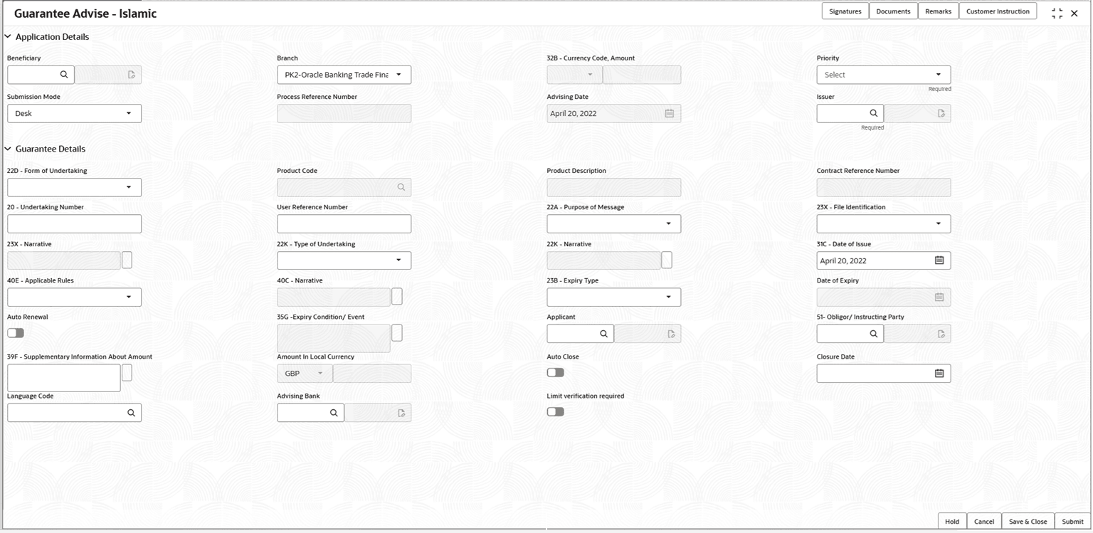

    The Guarantee Advise Islamic - Registration screen appears.
    The Guarantee Advise Islamic - Registration stage has two sections Application Details and Guarantee Details. Let’s look at the details of Registration screens below:
    Figure 2-4 Guarantee Advise Islamic - Registration - Application Details
    Description of Figure 2-4 follows
    Description of "Figure 2-4 Guarantee Advise Islamic - Registration - Application Details"
  3. On Guarantee Advise Islamic - Registration - Application Details screen, specify the fields.
    The fields which are marked as Required are mandatory.
    For more information on fields, refer to the field description table below.
    Table 2-3 Guarantee Advise Islamic - Registration - Application Details - Field Description
    Field Description
    Beneficiary Specify the beneficiary or click Search to search and select the beneficiary customer from look-up.
    If beneficiary is a customer of the bank, system will check for valid KYC status. If KYC status is not valid, system will display alert.
    For Guarantee Advising MT760, the Customer ID to be resolved from incoming message. If required use Walk-in ID. Bene ID/ name should be made amendable by the user.
    Branch Displays the customer’s home branch based on the customer ID.
    Once the request is submitted, Branch field is non-editable.
    For Guarantee Advising MT760, the branch to be resolved from CIF.
    Currency Code, Amount Select the currency code from the drop-down list.
    Specify the value of guarantee (with decimal places) as per currency type.
    For Guarantee Advising MT760, the currency code is Read only and populated from Incoming MT 760.
    Priority Set the priority of the Guarantee Advise request as Low/Medium/High/Essential/Critical. If priority is not maintained for the customer, system will populate 'Medium' as the default priority.
    For Guarantee Advising MT760, the field is defaulted and user can change its value.
    Submission Mode Select the submission mode of Guarantee Advise request from the drop-down list.
    By default the submission mode will have the value as ‘Desk’.

    Process Reference Number Read only field.
    Unique OBTFPM task reference number for the transaction.
    This is auto generated by the system based on process name and branch code.
    For Guarantee Advising MT760, the Process Reference Number is read only and generated by the system.
    Advising Date Read only field.
    System will default branch date. Back dating not allowed, if approved on a subsequent date, that date will be populated here.
    For Guarantee Advising MT760, the branch date to be defaulted. User cannot change the date. If approved on a later date, system should populate the branch date as on date of approval.
    Issuer Specify the issuing bank name or click Search to search and select the issuing bank.
    Party type with banks will only be displayed in look-up. The system will display the
    1. SWIFT code (if available)
    2. Name and address of the bank
    On selection of the record if SWIFT code is available then SWIFT code will be populated, if SWIFT code is not available then the bank's name and address will be populated.
    For Guarantee Advising MT760, the issuing bank is read only and populated from Incoming MT 760.

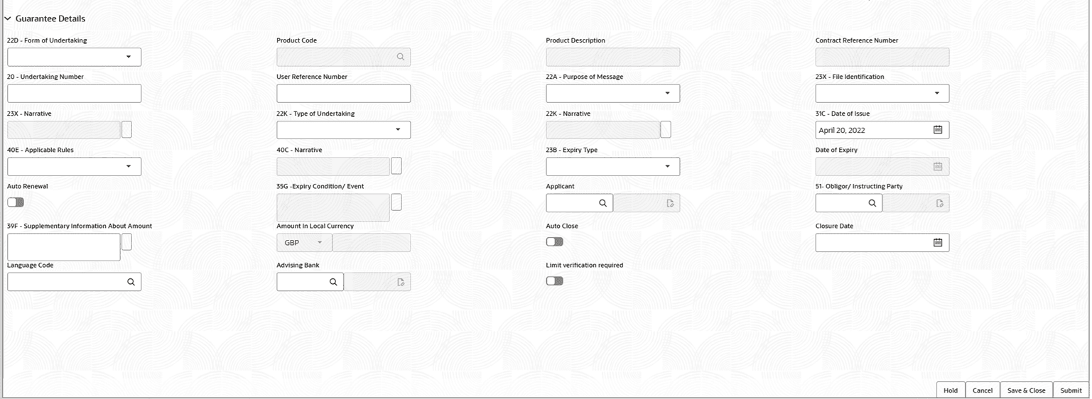

    Guarantee Details
    Registration user can provide Guarantee details in this section. Alternately, details can be provided by Scrutiny user.
  4. On Guarantee Advise Islamic - Registration - Guarantee Details screen, specify the fields.
    The fields which are marked in asterisk are mandatory.
    Figure 2-5 Guarantee Advise Islamic - Registration - Guarantee DetailsDescription of registrationguaranteedetails.png follows
    Table 2-4 Guarantee Advise Islamic - Registration - Guarantee Details - Field Description
    Field Description
    Form of Undertaking Select the type of LC (Documentary Credit) as per the requirement. By default LC type is Irrevocable.

    Product Code Specify the product code and on tab out system will validate and populate the selected product description. The product codes will be listed based on the selected value in Form of Undertaking.
    Alternatively, click Search to search and select the product code with code or product description.
    For Guarantee Advising MT760, user can enter the product code.
    Product Description Read only field.
    This field displays the description of the product as per the product code.
    For Guarantee Advising MT760, Product Description is populated based on product code selected.
    Contract Reference Number Read only field.
    Auto-generated by back end application. Number will be populated on the selection of Product Code.
    For Guarantee Advising MT760, Contract Reference Number is generated from Back office System.
    Undertaking Number Specify the undertaking number available in the guarantee/SBLC.
    For Guarantee Advising MT760, the Undertaking Number is read only and populated from Incoming MT 760.
    User Reference Number System defaults the user reference number, depending on the selection of product code.
    The user can change the value.
    Purpose of Message Select the purpose of message from the drop-down.

    Limit verification required Switch to Enable to enables for limit verification.
    Switch to Disable ,
    and provide the Finance Amount, the system prompts an override message on Submit.
  5. Click Submit.
    The task will move to next logical stage of Guarantee Advise Islamic.
