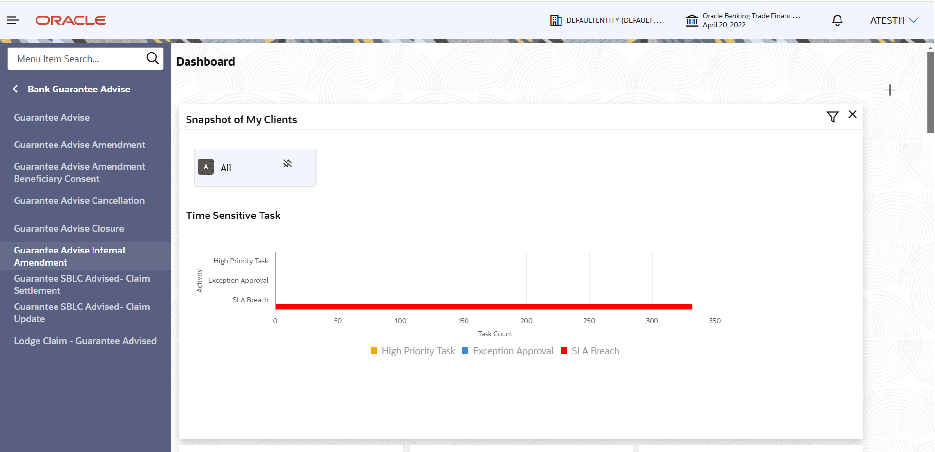

Specify User ID and Password, and login to Home screen.
  1. On Home screen, click Trade Finance - Islamic. Under Trade Finance, click Bank Guarantee Advise.
  2. Under Bank Guarantee Advise, click Guarantee Advise Internal Amendment Islamic.

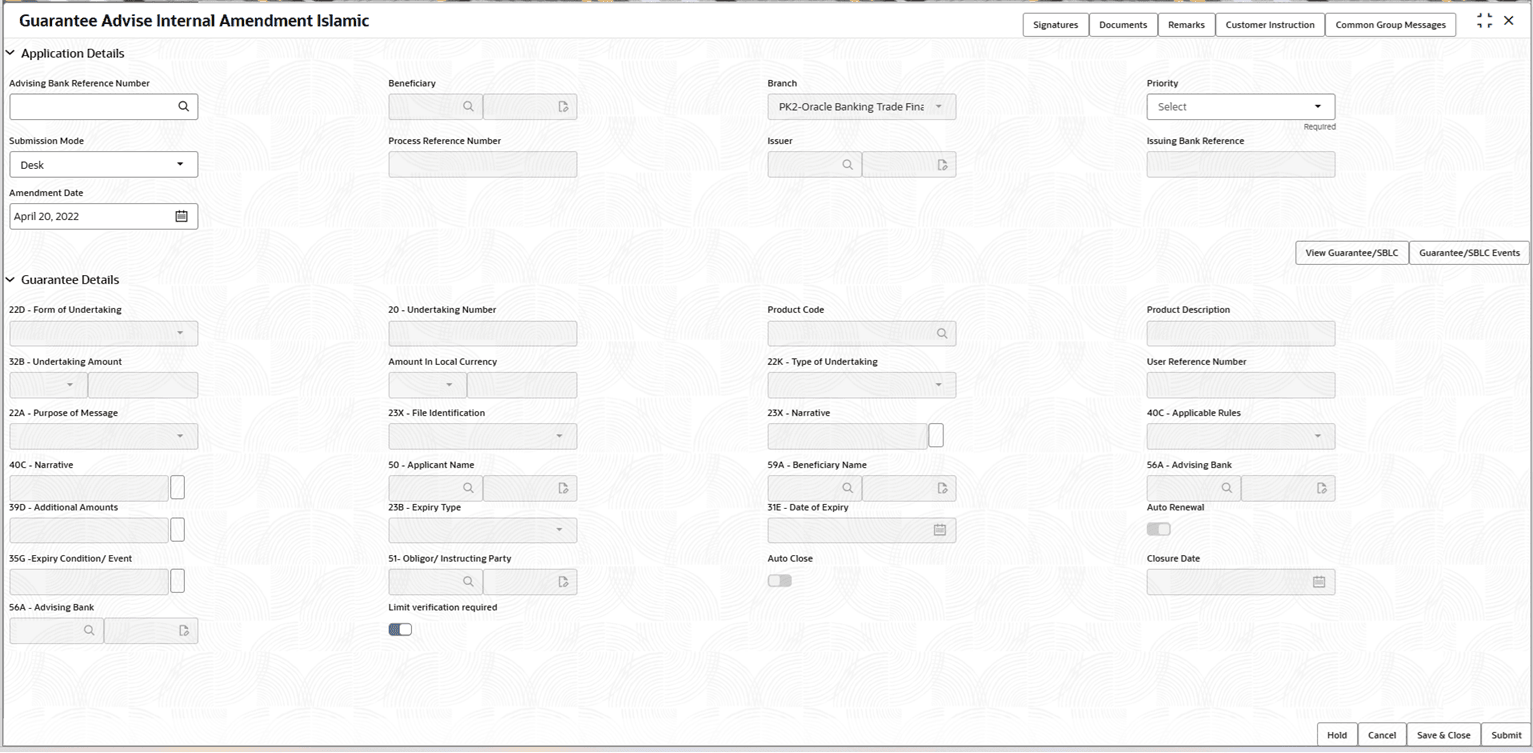

    Figure 2-2 Guarantee Advise Internal Amendment Islamic
    The Guarantee Advise Internal Amendment Islamic screen appears.
    The Guarantee Advise Internal Amendment Islamic - Registration stage has two sections Application Details and Guarantee Details. Let’s look at the details of Registration screens below:
    In case of STP of incoming SWIFT MT 768, a task should be directly created in Data Enrichment Stage after the required business validations and Registration stage is not applicable.
    Figure 2-3 Guarantee Advise Internal Amendment Islamic - Registration - Application Details
  3. On Guarantee Advise Internal Amendment Islamic - Registration - Application Details screen, specify the fields.
    The fields which are marked as Required are mandatory.
    For more information on fields, refer to the field description table below.

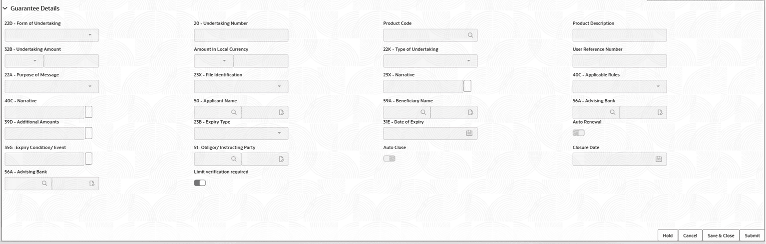

    Guarantee Details
    Registration user can view the latest LC values defaulted in the respective fields in the Guarantee Details in this section.
    Description of registrationguaranteedetails.png follows
  4. On Guarantee Advise Internal Amendment Islamic - Registration - Guarantee Details screen, specify the fields.
    Table 2-2 Guarantee Advise Internal Amendment Islamic - Registration - SBLC/Guarantee Details - Field Description
