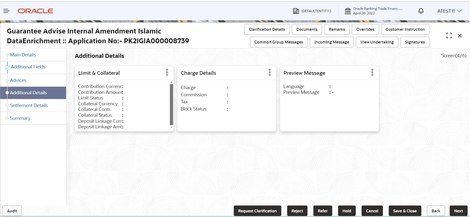

2.2.4 Additional Details
This topic provides the systematic instructions to capture the additional details in Data Enrichment stage of Guarantee Advise Internal Amendment Islamic process.
In the Additional details section, user can enter, update and verify the additional details Data Segment of Internal Amendment of Guarantee/ SBLC Advised request.
User can change the values in ‘Limits and Collateral’ section and ‘Charges Details’ section. Change to existing Line or cash collateral is applicable when the advising bank has also confirmed the SBLC and changes the details Issuing bank Line/ Cash Collateral.

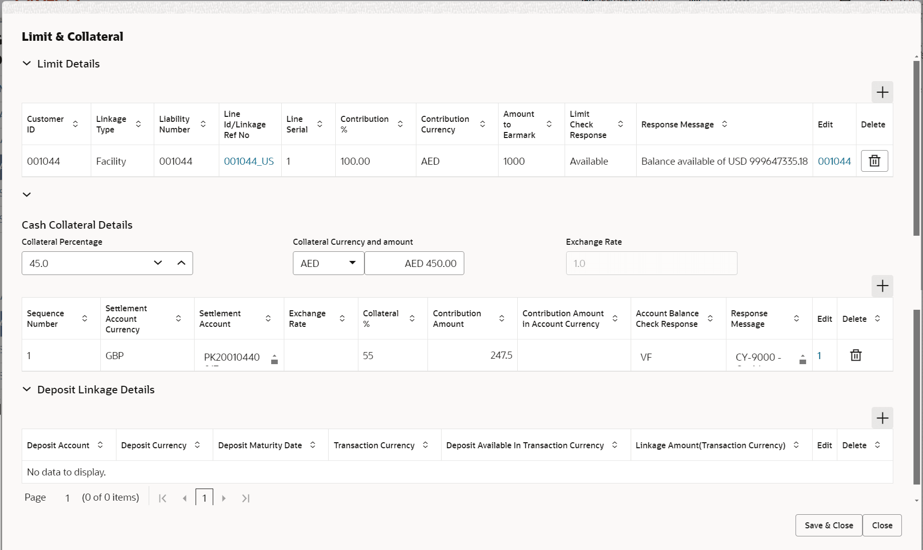

  1. On Additional Details screen, click the 3 dots on any Additional Details tile to view the details.
    Limits and Collaterals
    In this section user can to attach more than one line.
    On Approval, system should not release the Earmarking against each limit line and system should handoff the “Limit Earmark Reference Number “to the back office. On successful handoff, back office will make use of these “Limit Earmark Reference Number” to release the Limit Earmark done in the mid office (OBTFPM) and should Earmark the limit from the Back office.
    In case multiple Lines are applicable, Limit Earmark Reference for all lines to be passed to the back office.
    Description of delimitdetails.png follows
    For more information on fields, refer to the field description table below.

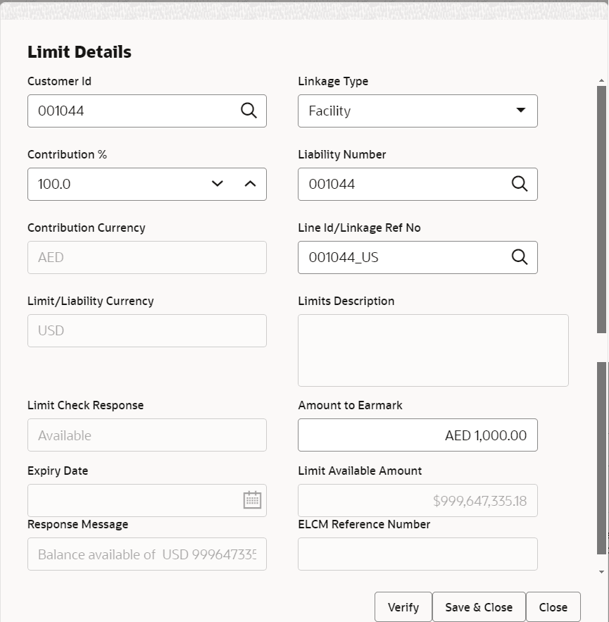

    Table 2-11 Limit Details - Field Description
    Field Description
    Limit Details Specify the limit details.
    Click plus icon to add new limit details.
    Below fields are displayed on the Limit Details pop-up screen, if the user clicks plus icon.
    Customer ID This field displays the applicant’s/applicant bank customer ID defaulted from the application.
    The user can change the customer ID.
    Linkage Type Select the linkage type.
    Linkage type can be:
    • Facility
    • Liability
    By default Linkage Type is Facility.
    Contribution % System will default this to 100%. User can modify, if contribution is more than 100%. System will display an alert message, if modified.
    Once contribution % is provided, system will default the amount.
    System to validate that if Limit Contribution% plus Collateral% is equal to 100. If the total percentage is not equal to 100 application will display an alert message.
    Liability Number Click Search icon to search and select the Liability Number from the look-up.
    The list has all the Liabilities mapped to the customer.
    Contribution Currency Read only field.
    The LC currency will be defaulted in this field.
    Line ID/ Linkage Ref No Click Search icon to search and select from the various lines available and mapped under the customer id gets listed in the drop down. LINE ID-DESCRIPTION will be available for selection along with Line ID. When you click on 'verify', the system will return value if the limit check was successful or Limit not Available. If limit check fails, the outstanding limit after the transaction value will be shown in the limit outstanding amount.
    User can also select expired Line ID from the lookup and on clicking the verify button, system should default “The Earmarking cannot be performed as the Line ID is Expired” in the “Response Message” field.
    This field is disabled and read only, if Linkage Type is Liability.
    Limit/ Liability Currency This field displays the limit currency.
    Limit Currency will be defaulted in this field, when you select the Liability Number.
    Limits Description Read only field.
    This field displays the limits description.
    Limit Check Response Read only field. This field displays the limit check response.
    Response can be ‘Success’ or ‘Limit not Available’ based on the limit service call response.
    The value in this field appears, if you click the Verify button.
    Amount to Earmark Amount to earmark will default based on the contribution %.
    User can change the value.
    Expiry Date Read only field.
    This field displays the date up to which the Line is valid.
    Limit Available Amount Read only field.
    This field displays the value of available limit, i.e., limit available without any earmark. The Limit Available Amount must be greater than the Contribution Amount.
    Response Message Read only field.
    This field displays the detailed response message.
    ELCM Reference Number Read only field.
    This field displays the ELCM reference number.
    Limit Details - Grid Below fields appear in the Limit Details grid along with the above fields.
    Line Serial Read only field.
    Displays the serial of the various lines available and mapped under the customer id.
    This field appears on the Limits grid.
    Edit Click the edit link to edit the limit details.

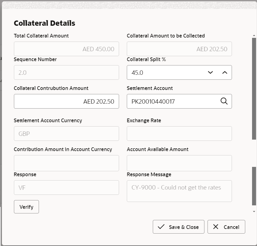

    Table 2-12 Cash Collateral Details - Field Description
    Field Description
    Collateral Percentage System populates the Collateral % maintained in the Customer / Product for the counter party of the contract.
    User can modify the collateral percentage.
    Collateral Currency and amount System populates the contract currency as collateral currency by default.
    User can modify the collateral Currency and amount.
    Exchange Rate System populates the exchange rate maintained.
    System validates for the Override Limit and the Stop limit if defaulted exchange rate is modified.
    Cash Collateral Details pop-up screen Click plus icon to add new collateral details.
    Below fields are displayed on the Cash Collateral Details pop-up screen, if the user clicks plus icon.
    Total Collateral Amount Read only field.
    This field displays the total collateral amount provided by the user.
    Collateral Amount to be Collected Read only field.
    This field displays the collateral amount yet to be collected as part of the collateral split.
    Sequence Number Read only field.
    The sequence number is auto populated with the value, generated by the system.
    Collateral Split % Specify the collateral split% to be collected against the selected settlement account.
    Collateral Contribution Amount Collateral contribution amount will get defaulted in this field.
    The collateral % maintained for the customer is defaulted into the Collateral Details screen. If collateral % is not maintained for the customer, then system should default the collateral % maintained for the product. User can modify the defaulted collateral percentage, in which case system should display a override message “Defaulted Collateral Percentage modified.
    Settlement Account Click Search to search and select the settlement account for the collateral.
    Settlement Account Currency Read only field.
    This field displays the settlement account currency and will be auto-populated based on the Settlement Account selection.
    Exchange Rate Read only field.
    This field displays the exchange rate, if the settlement account currency is different from the collateral currency.
    Contribution Amount in Account Currency Read only field.
    This field displays the contribution amount in the settlement account currency as defaulted by the system.
    Account Available Amount Read only field.
    System populates the account available amount on clicking the Verify button.
    System populates the response on clicking the Verify button.
    System populates the response message on clicking the Verify button.
    Verify Click to verify the account balance of the Settlement Account.
    Save & Close Click to to save and close the record.
    Cancel Click to cancel the entry.
    Cash Collateral Details - Grid Below fields appear in the Cash Collateral Details grid along with the above fields.
    Collateral % Specify the percentage of collateral to be linked to this transaction. If the value is more than 100% system will display an alert message.
    Contribution Amount This field displays the collateral contribution amount.
    Account Balance Check Response This field displays the account balance check response.
    Edit Click edit link to edit the collateral details.

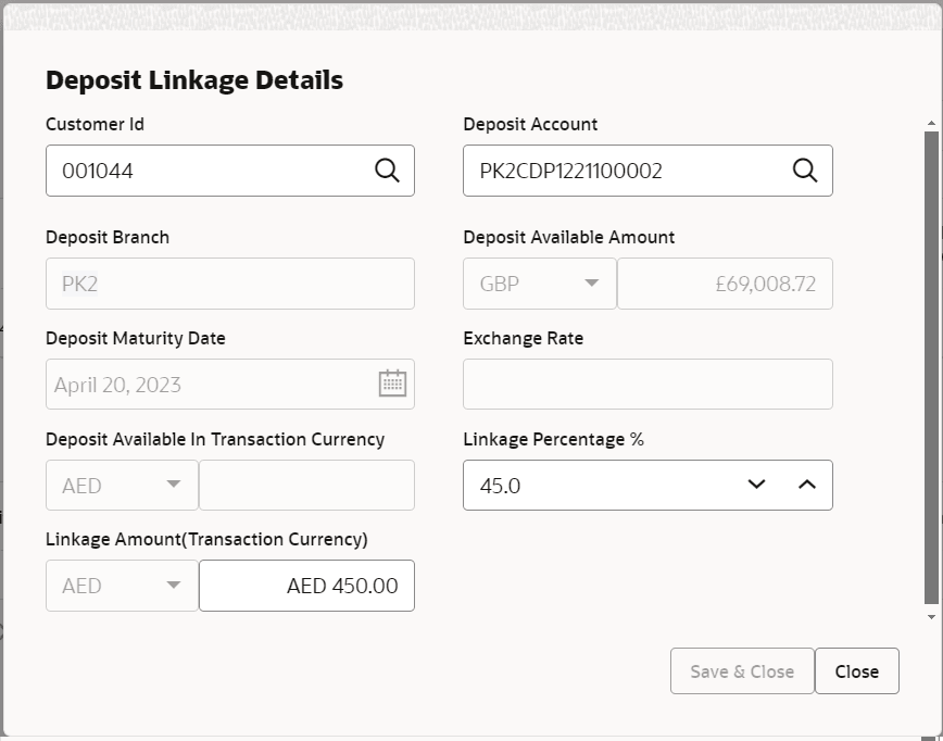

    Deposit Linkage Details
    In this section which the deposit linkage details is captured.
    System should allow the user to Link one or more existing Deposits as a contribution to secure underlying transactions. On Submit of DE stage, system will create Linkage of the Deposit/modification of existing Linkage by calling Back-office system (DDA) system directly.
    Figure 2-13 Deposit Linkage Details
    Table 2-13 Deposit Linkage Details
    Field Description
    Deposit Linkage Details Click plus icon to add new deposit linkage details.
    Deposit Account Click Search to search and select deposit for linkage from the look-up.
    All the Deposits of the customer should be listed in the look-up search.
    User should be able to select the deposit for linkage.
    Deposit Branch This field displays the deposit branch which will be auto-populated based on the deposit account selection.
    Deposit Available Amount Amount will be auto-populated based on the Deposit Account selection.
    Deposit Maturity Date Maturity Date of deposit is displayed based on the Deposit Account selection.
    Exchange Rate This field displays the latest exchange rate for deposit linkage.
    This will be picked up from the exchange rate maintenance from the common core.
    Deposit Available In Transaction Currency This field displays the deposit amount available, after exchange rate conversion, if applicable.
    Linkage Percentage % Specify the value for linkage percentage.
    Linkage Amount (Transaction Currency) System to default the transaction amount user can change the value.
    System validates the linking amount with available Deposit balance and should not allow to link more than the available amount.
    Deposit Details - grid Below fields appear in the Deposit Details grid along with the above fields.
    Deposit Currency The currency will get defaulted in this field.
    Transaction Currency The currency will get defaulted in this field from the underlying task.
    Edit Click edit link to edit the deposit linkage details.

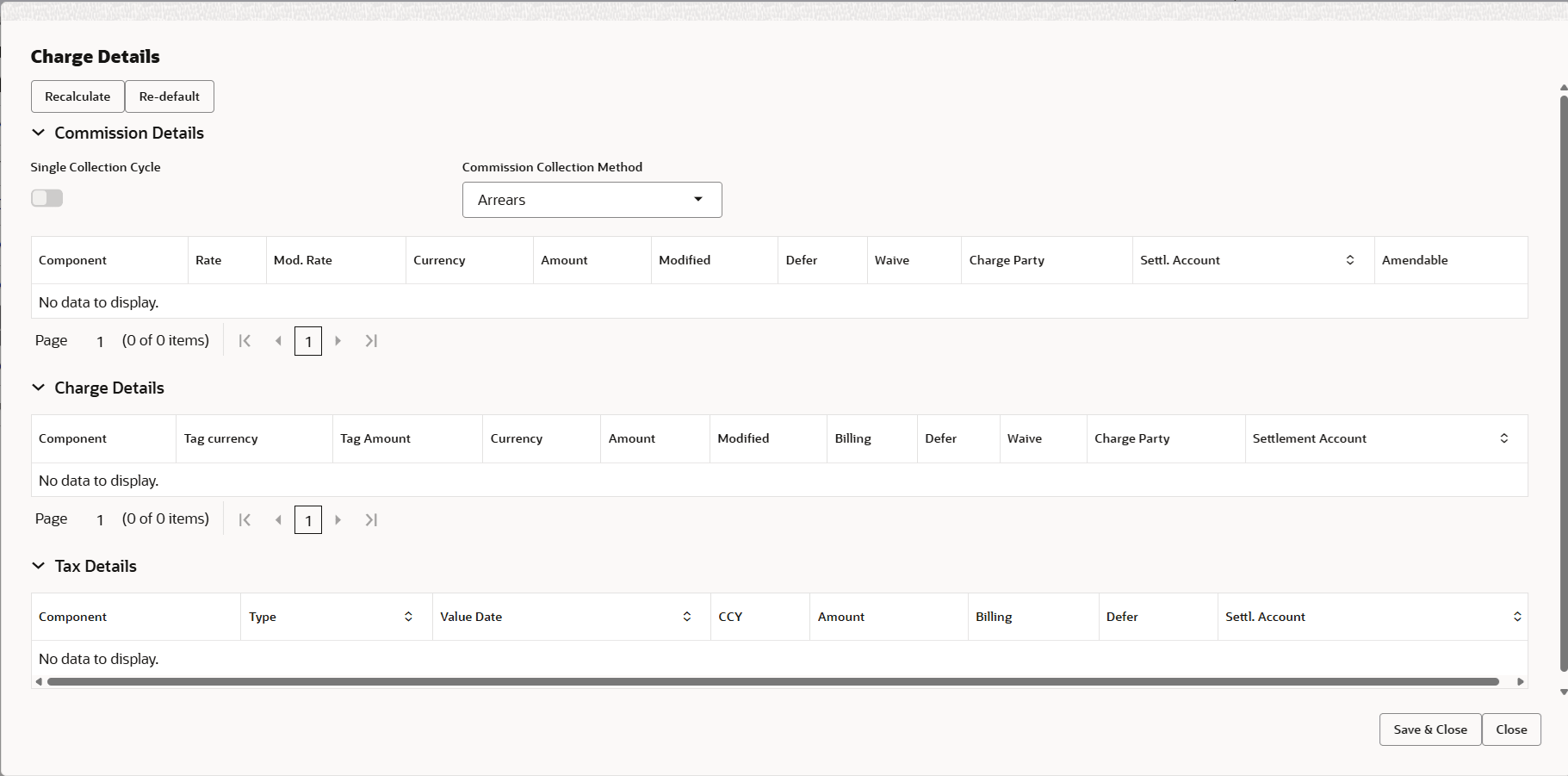

    Charge Details
    This section displays charge details. On landing the additional tab, charges and tax if any will get defaulted from Back end simulation. If default charges are available under the product, they should be defaulted here with values. If customer or customer group specific charges are maintained, then the same will be defaulted from back end system.
    Description of dechargedetails.png follows
    Table 2-14 Charge Details - Field Description
    Field Description
    Commission Details Specify the commission details.
    All charges, commission and margin are collected from the counter-party by default.
    Single Collection Cycle for Commission
    This field is display only.
    The value displays as available in Bank Parameter at Back office
    When Single Cycle toggle is on, back office system follows single cycle for collecting commission as per the issuance commission cycle period for periodic commission.
    Commission Collection Method
    This field displays the commission Collection method available for contract.
    If for a contract confirmation not added and confirmation commission not available, user can change collection method for collecting commission for adding confirmation.
    Component This field displays the commission component.
    Rate This field displays the rate that is defaulted from product.
    The commission rate, if available in Back Office defaults in OBTFPM. The user is able to change the rate.
    If flat commission is applicable, then commission amount defaulted from back office is modifiable by the user. Rate field will be blank and the user cannot modify the Rate field.
    Mod. Rate From the default value, if the rate is changed the value gets updated in this field.
    Currency This field displays the currency in which the commission have to be collected.
    Amount This field displays the amount that is maintained under the product code.
    The commission rate, if available in Back Office defaults in OBTFPM. The user is able to change the rate, but not the commission amount directly. The amount gets modified based on the rate changed and the new amount is calculated in back office based on the new rate and is populated in OBTFPM.
    Modified From the default value, if the amount is changed, the value gets updated in the modified amount field.
    Defer If enabled, charges/commissions has to be deferred and collected at any future step.
    Waive Based on the customer maintenance, the charges/commission can be marked for Billing or Defer.
    If the defaulted Commission is changed to defer or billing or waive, system must capture the user details and the modification details in the ‘Remarks’ place holder.
    Charge Party Charge party is 'Applicant' by default. User can change the value to Beneficiary.
    Settl. Account Select the settlement account.
    Amendable Displays if the field is amendable or not.
    Charge Details This section displays the charge details.
    Component This field displays the charge component type.
    Tag Currency This field displays the tag currency in which the charges have to be collected.
    Tag Amount This field displays the tag amount that is maintained under the product code.
    Currency This field displays the currency in which the charges have to be collected.
    Modified From the default value, if the rate is changed or the amount is changed, the value gets updated in the modified amount field.
    Billing If charges are handled by separate billing engine, then by selecting billing the details to be available for billing engine for further processing.
    On simulation of charges/commission from Back Office, if any of the Charges/Commission component for the customer is ‘Billing’ enabled, ‘Billing’ toggle for that component should be automatically enabled in OBTFPM.
    The user can not enable/disable the option, if it is de-selected by default.
    This field is disabled, if ‘Defer’ toggle is enabled.
    Defer If charges have to be deferred and collected at any future step, this check box has to be selected.
    On simulation of charges/commission from Back Office, if any of the Charges/Commission component for the customer is AR-AP tracking enabled, ‘Defer’ toggle for that component should be automatically checked in OBTFPM.
    The user can enable/disable the option the check box. On de-selection the user has to click on ‘Recalculate’ charges button for re-simulation.
    Waive Enble the toggle, if charges has to be waived.
    Based on the customer maintenance, the charges should be marked for Billing or for Defer.
    This field is disabled, if Defer toggle is enabled.
    Charge Party Charge party is applicant by default. User can change the value to beneficiary.
    Settlement Account Select the settlement account.
    Tax Details This section displays the tax details.

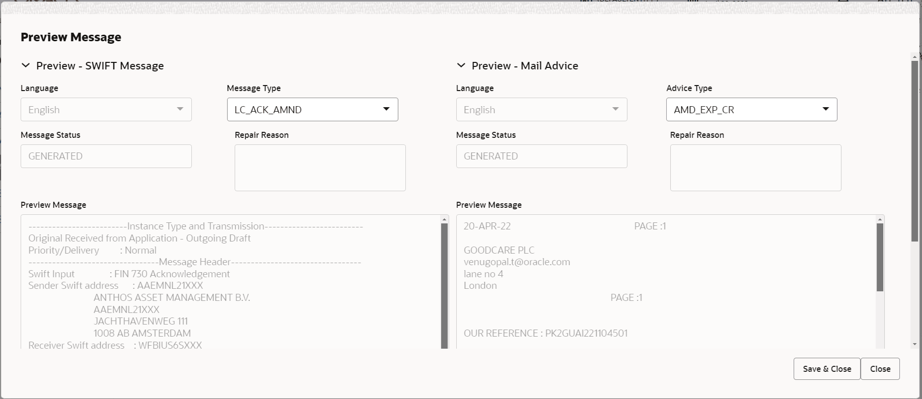

    Preview Mesage
    The bank user can view a preview of the outgoing SWIFT message and advise simulated from back office. The preview message simulated from the back office and the user can view the message.
    Table 2-15 Preview Message - Field Description
    Field Description
    Preview SWIFT Message Displays the preview of SWIFT Messages.
    Language Read only field.
    The language to preview the draft guarantee details.
    English is set as default language for the preview.
    Message Type Select the message type from the drop-down.
    Message Status Read only field.
    Displays the message status of the draft message.
    Repair Reason Read only field.
    Displays the reason of repair.
    Preview Message This field displays a preview of the draft message.
    Based on the guarantee text captured in the previous screen, guarantee draft is generated in the back office and is displayed in this screen.
    Preview Mail Advice Based on the guarantee amendment captured in the previous screen, the preview message-mail advice is simulated from the back office and the user can view the message.
    The language for the advice message.
    Advice Type Select the advice type.
    Displays the message status of the mail advice.
    Preview Message This field displays a preview of advice.
  4. Click Save and Close to save the details and close the screen.

    For more information on action buttons, refer to the field description table below.
    Table 2-16 Additional Details - Action Buttons - Field Description
    Field Description
    Clarification Details Clicking the button opens a detailed screen, user can see the clarification details in the window and the status will be ‘Clarification Requested’.
    Documents Click to View/Upload the required document.
    Application displays the mandatory and optional documents.
    The user can view and input/view application details simultaneously.
    When a user clicks on the uploaded document, Document window get opened and on clicking the view icon of the uploaded document, Application screen should get split into two. The one side of the document allows to view and on the other side allows to input/view the details in the application
    Remarks Specify any additional information regarding the guarantee advise internal amendment Islamic. This information can be viewed by other users processing the request.
    Content from Remarks field should be handed off to Remarks field in Backend application.
    Overrides Click to view the overrides accepted by the user.
    Customer Instructions Click to view/ input the following
    • Standard Instructions – In this section, the system will populate the details of Standard Instructions maintained for the customer. User will not be able to edit this.
    • Transaction Level Instructions – In this section, OBTFPM user can input any Customer Instructions received as part of transaction processing. This section will be enabled only for customer initiated transactions.
    Common Group Messages Click Common Group Message button, to send MT799 and MT999 messages from within the task.
    A walk-in customer of the receiving bank can be sent a common group message by the BIC.
    Incoming Message This button displays the multiple messages (MT760 + up to 7 MT761.
    Click to allow parsing of MT 760 along with MT761(up to 7) messages together to create a Guarantee Advise.
    In case of MT798, the User can click and view the MT798 message(784,760/761).
    In case of MT798-MT726-MT759 request, user can view MT798 message(726-759) in this placeholder in Header of the task.
    In case of MT798_MT788-MT799 request, user can view MT798 message (788-799) in this placeholder in Header of the process-task..
    View Undertaking Clicking this button allows the user to view the undertaking details.
    Signatures Click the Signature button to verify the signature of the customer/ bank if required.
    The user can view the Customer Number and Name of the signatory, Signature image and the applicable operation instructions if any available in the back-office system.
    If more than one signature is available, system should display all the signatures.
    Request Clarification Clicking this button allows the user to submit the request for clarification to the “Trade Finance Portal” for the transactions that are initiated offline.
    Reject On click of Reject, user must select a Reject Reason from a list displayed by the system.
    Reject Codes are:
    • R1- Documents missing
    • R2- Signature Missing
    • R3- Input Error
    • R4- Insufficient Balance/Limits
    • R5 - Others
    Select a Reject code and give a Reject Description.
    This reject reason will be available in the remarks window throughout the process.
    Refer Select a Refer Reason from the values displayed by the system.
    Refer Codes are:
    • R3- Input Error
    • R5 - Others
    Hold The details provided will be saved and status will be on hold.User must update the remarks on the reason for holding the task.
    This option is used, if there are any pending information yet to be received from applicant.
    Cancel Cancel the Data Enrichment stage inputs. The details updated in this stage are not saved. The task will be available in 'My Task' queue.
    Save & Close Save the details provided and holds the task in ‘My Task’ queue for further update. This option will not submit the request.
    Back Clicking on Back button, takes the user to the previous screen.
    Next On click of Next, system validates if all the mandatory fields have been captured. Necessary error and override messages to be displayed. On successful validation, system moves the task to the next data segment.
