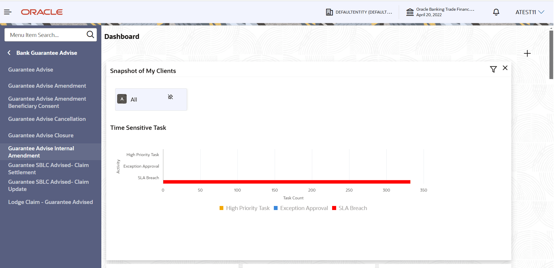

  1. On Home screen, click Trade Finance. Under Trade Finance, click Bank Guarantee Advise.
  2. Under Bank Guarantee Advise, click Guarantee Advise Internal Amendment.

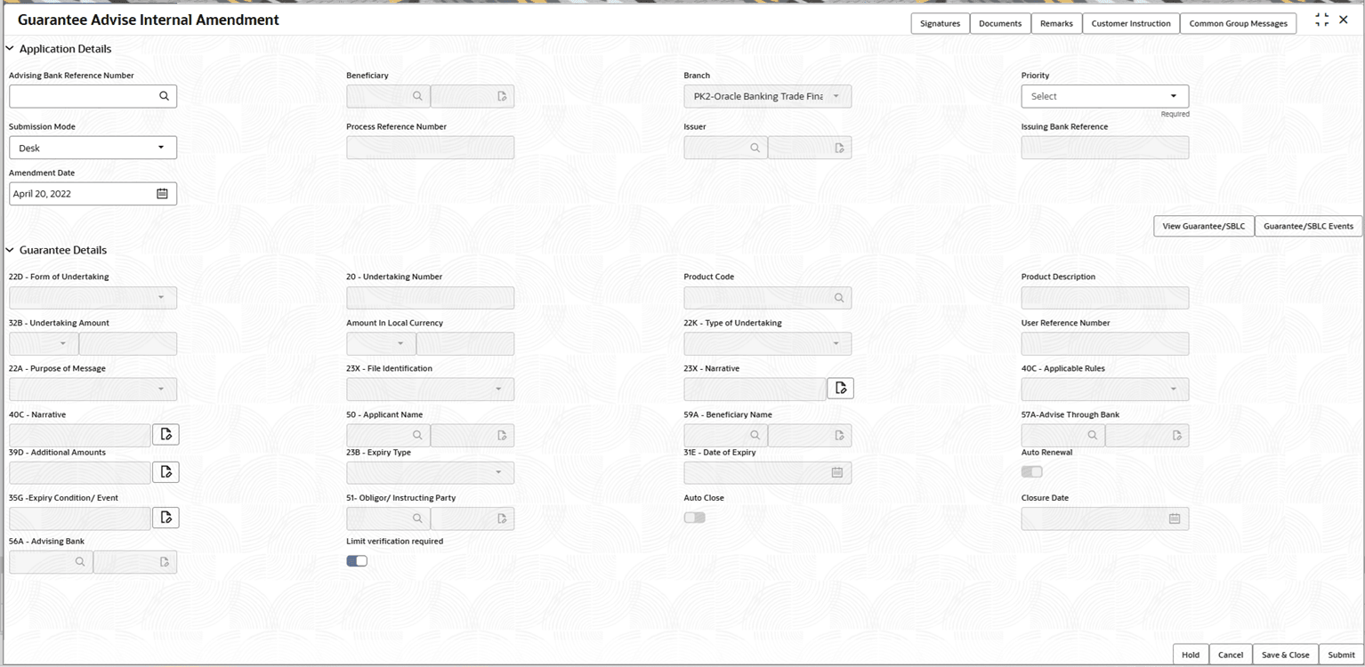

    Figure 2-2 Guarantee Advise Internal Amendment
    The Guarantee Advise Internal Amendment screen appears.
    The Guarantee Advise Internal Amendment - Registration stage has two sections Application Details and Guarantee Details. Let’s look at the details of Registration screens below:

    Figure 2-3 Guarantee Advise Internal Amendment - Registration - Application Details
  3. On Guarantee Advise Internal Amendment - Registration - Application Details screen, specify the fields.
    The fields which are marked as Required are mandatory.
    For more information on fields, refer to the field description table below.
    Table 2-1 Guarantee Advise Internal Amendment - Registration - Application Details

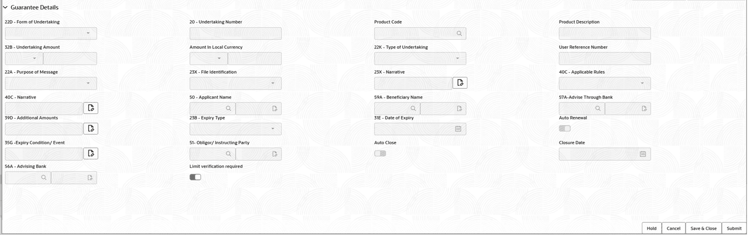

    Guarantee Details
    Registration user can view the latest LC values defaulted in the respective fields in the Guarantee Details in this section.
    Description of registrationguaranteedetails.png follows
  4. On Guarantee Advise Internal Amendment - Registration - Guarantee Details screen, specify the fields.
    The fields which are marked in asterisk are mandatory.
    Table 2-2 Guarantee Advise Internal Amendment - Registration - SBLC/Guarantee Details - Field Description
