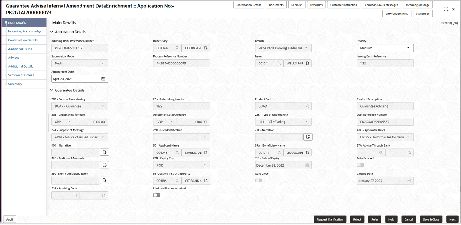

  1. On Data Enrichment - Main Details screen, specify the fields that were not entered at Registration stage.
    Figure 2-6 Data Enrichment - Main Details
    For more information on fields, refer to the field description table below.
    Table 2-4 Guarantee Advise Internal Amendment - Registration - Application Details - Field Description
    Field Description
    Advising Bank Reference Number Read only field.
    This field displays the advising bank reference number, as selected in Registration stage.
    Beneficiary Read only field.
    Name of the customer or applicant will be auto populated from Guarantee /SBLC Advise.
    Branch Read only field.
    Customer’s home branch will be defaulted from Guarantee /SBLC Advise.
    Priority This field will be defaulted based on the priority maintained for the customer. Priority maintained will be populated as either 'Essential/ Critical /Low /Medium /High'. If priority is not maintained for a customer, ‘Medium' priority will be defaulted.
    User can change the priority populated any time before submit of Registration stage.
    Submission Mode Read only field.
    This field displays the submission mode of Guarantee Advise Internal Amendment request.
    By default the submission mode will have the value as ‘Desk’.
    • Desk - Request received through Desk
    • Courier - Request received through Courier
    Process Reference Number Read only field.
    Unique OBTFPM task reference number for the transaction.
    This is auto generated by the system based on process name and branch code.
    Issuer Read only field.
    System defaults the Issuing Bank as per the Guarantee Advice details.
    Issuing Bank Reference Read only field.
    System defaults the Issuing Bank reference from Guarantee Advice details.
    Amendment Date The application displays the branch’s current date by default.

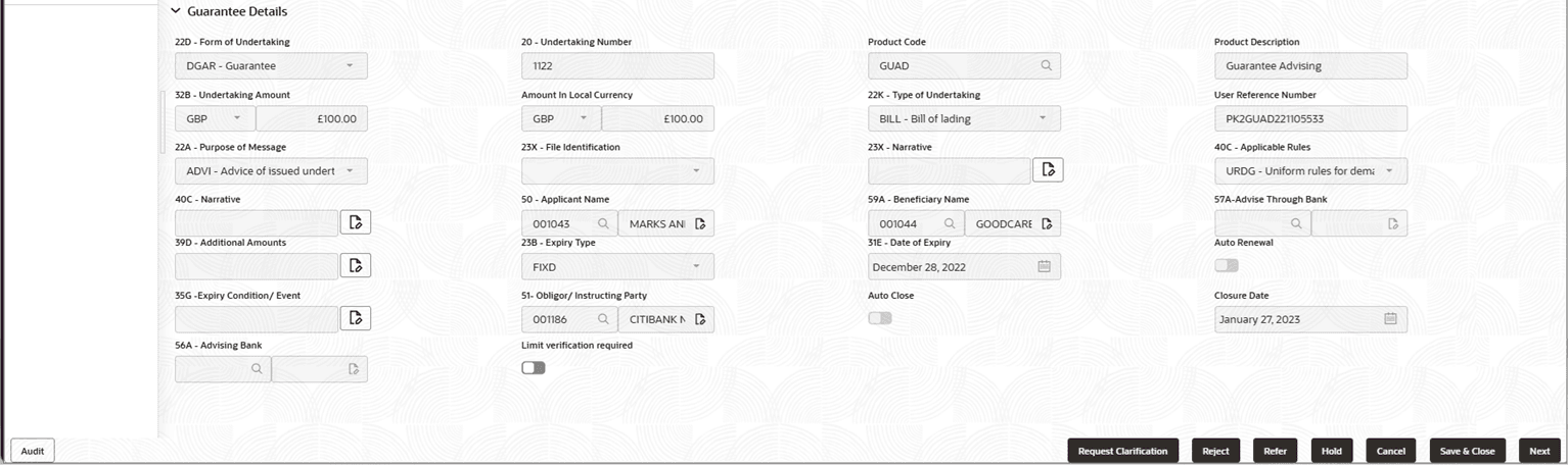

    Undertaking Details
    The fields listed under this section are same as the fields listed under the Guarantee Details section in Registration stage.
    Table 2-5 Guarantee Advise Internal Amendment - Registration - Guarantee Details - Field Description
    Field Description
    Form of Undertaking Read only field.
    This field displays the value for form of undertaking from Guarantee/ Standby Advise.
    Undertaking Number Read only field.
    Undertaking number defaults from Guarantee/ Standby Advise details.
    Product Code Read only field.
    This field displays the product code defaulted from Guarantee/ Standby Advise.
    Product Description Read only field.
    This field displays the description of the product as per the product code defaulted from Guarantee/ Standby Advise.
    Undertaking Amount Read only field.
    System defaults undertaking amount from Guarantee/ Standby Advise.
    Amount In Local Currency Read only field.
    This field displays the Local currency and amount value. System fetches the local currency equivalent value for the LC amount from back office (with decimal places).
    Type of Undertaking Read only field.
    System defaults the type of undertaking value available from Guarantee Advise details.
    User Reference Number Read only field.
    System defaults the user reference number available from Guarantee Advise details.
    Purpose of Message Read only field.
    System dafaults the purpose of message from Guarantee/ Standby Advise.
    The values are:
    • ISSU - Issue of Undertaking:
    • ICCO - Issuance of counter-counter-undertaking:
    • ISCO - Issuance of counter undertaking:
    File Identification Read only field.
    The type of delivery channel and its associated file name or reference.
    System defaults the value from Guarantee Advise details.
    Narrative Read only field.
    Applicable Rules Read only field.
    System defaults the value from Guarantee Advise details. The value can be:
    • URDG - Uniform rules for demand guarantees
    • UCPR - Uniform customs and Practices
    • ISPR - International standby Practices
    • NONE - Not subject to any rules
    • OTHR
    Applicant Name Read only field.
    This field displays the details of the applicant of the selected SBLC/Guarantee Number in Registration stage.
    Beneficiary Name Read only field.
    This field displays the beneficiary details of the selected Guarantee/ Standby Advise.
    Advising Bank Read only field.
    This field displays the details of the advising bank.
    Additional Amount Read only field.
    This field indicates the additional amounts covered as per the latest LC details is displayed in Guarantee Advise details.
    Expiry Type Read only field.
    System dafaults the expiry type from guarantee Advise.
    This field indicates whether undertaking has specified expiry date or is open-ended.
    Date of Expiry Read only field.
    Expiry date of the Guarantee Advise.
    System defaults the expiry date from Guarantee/ SBLC Advise.
    Auto Renewal Enable the option for auto renewal.
    This field is enabled if Applicable Rules is URDG - Uniform rules for demand guarantees and Expiry Type is OPEN.
    Expiry Condition/Event Read only field.
    The documentary condition/event that indicates when the local undertaking will cease to be available.
    Obligor/ Instructor Party Read only field.
    The party obligated to reimburse the issuer.
    Auto Close Toggle On: Displays that auto close is required for that transactions.
    Toggle Off: Displays that auto close is not required for that transactions.
    Closure Date Read only field.
    This field displays the “Closure Date”defaulted by the system from the previous version of the contract.
    If the system defaulted value for Auto Close is Yes, then Closure Date field will be a display only field and user is not allowed to edit the same.
    If the system defaulted value for Auto Close is No, then user can edit the Closure Date field by enabling the “Auto Close” toggle as “Yes”.
    User can provide the value in this field, if Auto Close is enabled as a part of this internal amendment.
    Advising Bank Specify the Advising Bank reference number or click Search to search and select the advising bank reference number from look-up, by entering the search criteria.
    Limit verification required
    The field value defaults to Yes, if contract already had limit attached. User can modify the value.
