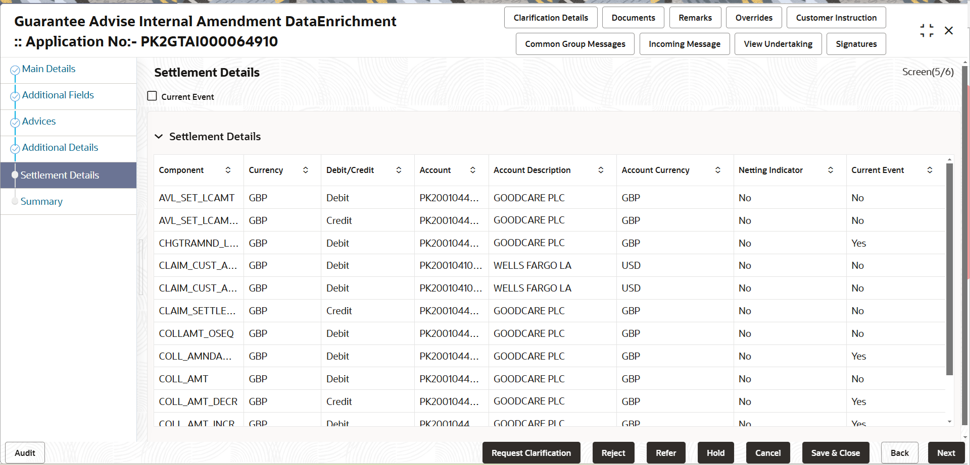

2.2.6 Settlement Details
This topic provides the systematic instructions to capture the settlement details of Guarantee Advise Internal Amendment request.
The user can view the settlement details during internal amendment of Guarantee/SBLC Advised request.
  1. On Settlement Details screen, specify the fields.
    For more information on fields, refer to the field description table below.
    Table 2-19 Settlement Details – Field Description
    Field Description
    Current Event Select the check box to populate the settlement details of the current event associated with the task. On De-selecting the check box, the system list all the accounts under the settlement details irrespective of the current event
    Component This field displays the components based on the product selected.
    Currency This field displays the default currency for the component.
    Debit/Credit This field displays the debit/credit indicators for the components.
    Account This field displays the account details for the components.
    Account Description This field displays the the description of the selected account.
    Account Currency This field displays the currency for all the items based on the account number.
    Netting Indicator This field displays the applicable netting indicator.
    Current Event This field displays the current event.
