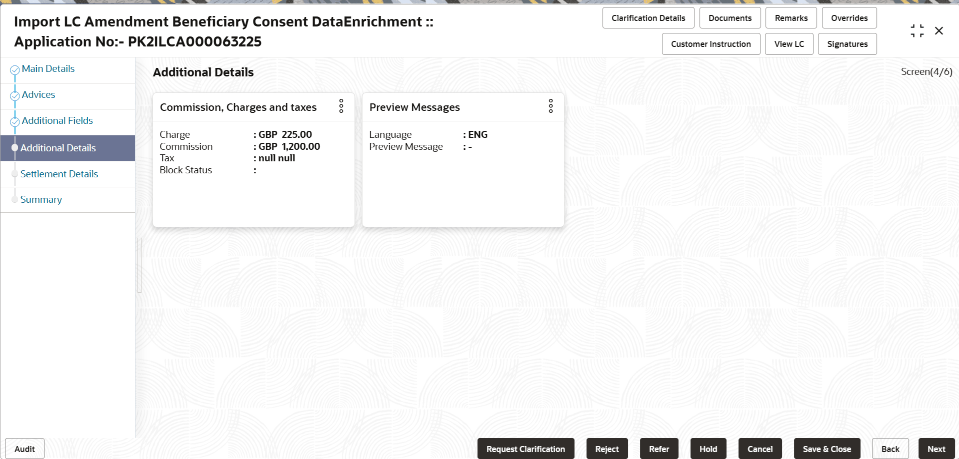

2.3.4 Additional Details
This topic provides the systematic instructions to capture the additional details
  1. On Additional Details screen, click View on any Additional Details tile to view the details.

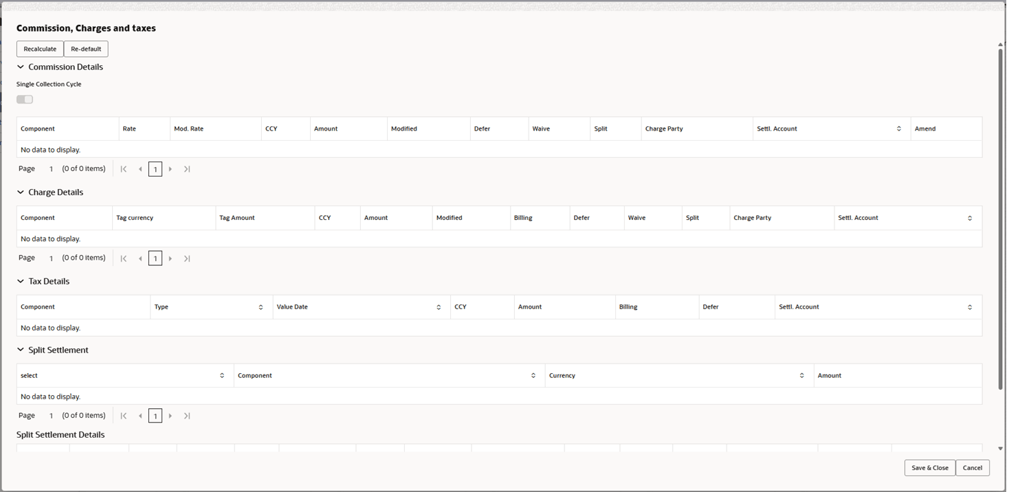

    Charge Details
    This section displays charge details.
    Figure 2-14 Split Settlement Details
    For more information on fields, refer to the field description table below.
    Table 2-14 Charge Details - Field Description
    Field Description
    Commission Details This section displays the commission details.
    By default, all the charges, commission and margin are collected from the counter-party.
    Single Collection Cycle for Commission
    This field is display only.
    The value displays as available in Bank Parameter at Back office
    When Single Cycle toggle is on, back office system follows single cycle for collecting commission as per the issuance commission cycle period for periodic commission.
    Commission Collection Method Select the Commission Collection Method from the following values:
    • Advance
    • Arrears
    The values are defaulted for commission Collection method as per product, which user can change. Based on collection method provided at contract level, for all commission component commission are collected and same is applicable for life cycle of the transaction.
    Component Displays the commission component.
    Click the link to view the commission component details.
    Rate Displays the rate that is defaulted from product.
    The commission rate, if available in Back Office defaults in OBTFPM. The user is able to change the rate.
    If flat commission is applicable, then commission amount defaulted from back office is modifiable by the user. Rate field will be blank and the user cannot modify the Rate field.
    Mod. Rate From the default value, if the rate is changed the value gets updated in this field.
    Currency Displays the currency in which the commission have to be collected.
    Amount Displays the amount that is maintained under the product code.
    The commission rate, if available in Back Office defaults in OBTFPM. The user is able to change the rate, but not the commission amount directly. The amount gets modified based on the rate changed and the new amount is calculated in back office based on the new rate and is populated in OBTFPM.
    Modified From the default value, if the amount is changed, the value gets updated in the modified amount field.
    Defer Switch to Enable for charges/commissions has to be deferred and collected at any future step.
    Waive Switch to Enable to waive the charges/commissions.
    Based on the customer maintenance, the charges/commission can be marked for Billing or Defer.
    If the defaulted Commission is changed to defer or billing or waive, system must capture the user details and the modification details in the ‘Remarks’ place holder.
    Split Switch to Enablefor splitting the Commission.
    Switch to Disableif splitting of commission is not required.
    Charge Party Charge party is 'Applicant' by default. User can change the value to Beneficiary.
    Settl. Account The settlement account.
    Amend Displays if the field is amendable or not.
    Charge Details This section displays the charge details.
    Component Displays the charge component type.
    Tag Currency Displays the tag currency in which the charges have to be collected.
    Tag Amount Displays the tag amount that is maintained under the product code.
    Currency Displays the currency in which the charges have to be collected.
    Amount This field displays the amount that is maintained under the product code.
    Modified From the default value, if the rate is changed or the amount is changed, the value gets updated in the modified amount field.
    Billing Switch to Enableto make the details available for billing engine for further processing, if charges are handled by separate billing engine.
    On simulation of charges/commission from Back Office, if any of the Charges/Commission component for the customer is ‘Billing’ enabled, ‘Billing’ toggle for that component should be automatically enabled in OBTFPM.
    The user can not enable/disable the option, if it is de-selected by default.
    This field is disabled, if ‘Defer’ toggle is enabled.
    Defer Switch to Enableto defer the charges and collect at any future step.
    On simulation of charges/commission from Back Office, if any of the Charges/Commission component for the customer is AR-AP tracking enabled, ‘Defer’ toggle for that component should be automatically checked in OBTFPM.
    The user can enable/disable the option the check box. On de-selection the user has to click on ‘Recalculate’ charges button for re-simulation.
    Waive Switch to Enableto waive the charges.
    Based on the customer maintenance, the charges should be marked for Billing or for Defer.
    This field is disabled, if Defer toggle is enabled.
    Switch to Disable, if splitting of commission is not required.
    Charge Party Displays the charge party. By default the charge party is ‘Applicant’.
    Settlement Account Click Search icon to search and select the settlement account.
    Tax Details This section displays the tax details.
    The tax component is calculated based on the commission and defaults if maintained at product level. User cannot update tax details and any change in tax amount on account of modification of charges/ commission will be available on click of Re-Calculate button or on hand off to back-end system.
    Component Displays the tax component.
    Type Displays the type of tax component.
    Value Date Displays the value date of tax component.
    Ccy Displays the currency in which the tax have to be collected.
    The tax currency is the same as the commission.
    Amount Displays the tax amount based on the percentage of commission maintained.
    The user can edit the tax amount, if applicable.
    Billing Switch to Enableto make the details available for billing engine for further processing, if taxes are handled by separate billing engine.
    Defer Switch to Enableto defer the taxes and collect at any future step.
    Switch to Disableif you do not want to defer the taxes.
    On disabling the user has to click on ‘Recalculate’ charges button for re-simulation.
    Settl. Account System defaults the settlement account.
    The user can modify the settlement account.
    Split Settlement This section displays the Split Settlement.
    This section is displayed if the user clicks on the Recalculate button to fetch the Split Settlement details from Backoffice.
    The default parties in Split row should be fetched from OBTF.
    Select The option to select the split settlement record.
    Component Displays the split component type eligible for Split .
    Currency Displays the currency of split settlement.
    Amount Displays the amount of split settlement.

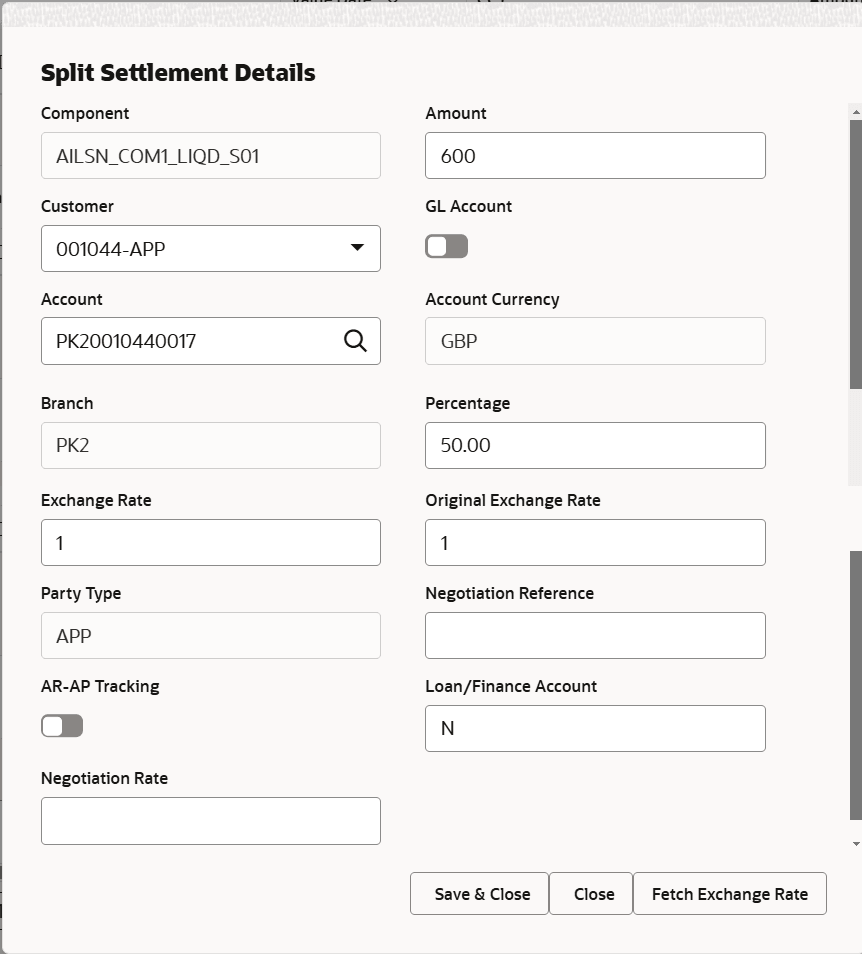

    Split Settlement Details This section displays the Split Settlement details. Split Settlement details section appears from Back office, when the user clicks on the Recalculate button.
    Seqence Displays the sequence number is auto populated with the value, generated by the system.
    Component Displays the split component type eligible for Split.
    Amount The system splits the respective Charge/Commission amount automatically between counter party and third party with 50% value by default.
    The bank user can modify the amount.
    More than two splits are not allowed.
    Customer Indicates the ID of the Customer in Split Settlement Details section.
    GL Account The system defaults the GL account.
    Account The system defaults the Settlement account.
    User can modify the settlement account. System initiates a call to common core tables within OBTFPM to select the account.
    Account Currency This field defaults the currency of the account.
    Branch Indicates the branch of the customer where transaction is getting processed.
    Percentage The system splits the respective Charge/Commission percentage automatically between counter party and third party with 50% value by default.
    The system should validate that the total percentage of each component doesn't exceed 100 and the total amount of each component doesn't exceed total component amount.
    Exchange Rate System populates the exchange rate maintained.
    Original Exchange Rate Displays the Original Exchange Rate as simulated in split settlement details section.
    Party Type Displays the party type in split settlement details section.
    Negotiation Reference Specify the negotiation reference number.
    AR-AP Tracking Indicates to defer the charge/ commission in Split Settlement Details section.
    The user can modify the AR-AP Tracking flag as per the requirements.
    Loan/Finance Account Displays the loan account.
    Negotiation Rate Displays the negotiation rate.
    Negotiation Reference Displays the negotiation reference.

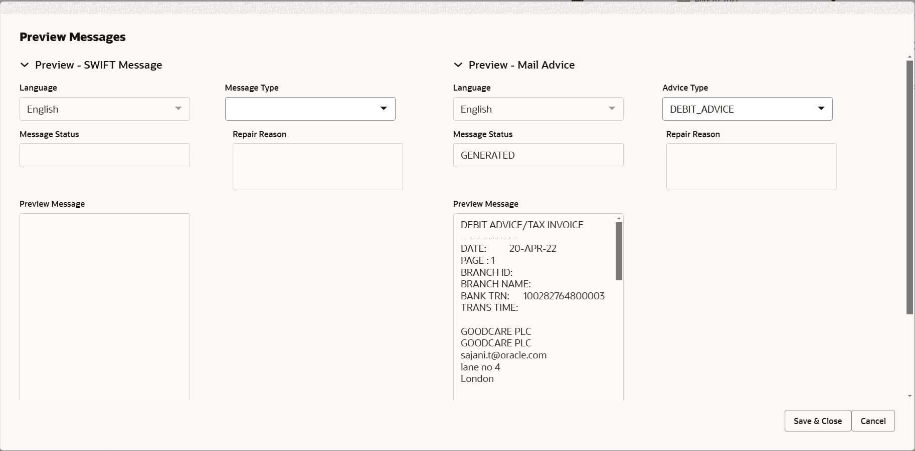

    Preview Messages
    User can view the draft LC amendment Beneficiary Consent message being displayed on the preview message text box.
    Description of deadditionaldetailspreview.png follows
    Table 2-15 Preview Messages - Field Description
    Field Description
    Preview SWIFT Message This section displays the preview of SWIFT Messages fields.
    Language Read only field.
    English is set as default language for the preview.
    Message Type Select the message type.
    Message Status Read only field.
    Display the message status of draft message of amendment beneficiary consent details.
    Repair Reason Read only field.
    Display the message repair reason of draft message of amendment beneficiary consent details.
    Preview Message This field displays a preview of the draft message.
    Preview Mail Advice This section displays the preview of Mail Advice fields.
    Advice Type Select the advice type.
  3. Click Save and Close to save the details and close the screen.

    For more information on action buttons, refer to the field description table below.
    Table 2-16 Additional Details - Action Buttons - Field Description
    Field Description
    Clarification Details Clicking the button opens a detailed screen, user can see the clarification details in the window and the status will be 'Clarification Requested'.
    Documents Click to View/Upload the required document.
    Application displays the mandatory and optional documents.
    The user can view and input/view application details simultaneously.
    When a user clicks on the uploaded document, Document window get opened and on clicking the view icon of the uploaded document, Application screen should get split into two. The one side of the document allows to view and on the other side allows to input/view the details in the application.
    Remarks Specify any additional information regarding the lc amendment. This information can be viewed by other users processing the request.
    Content from Remarks field should be handed off to Remarks field in Backend application.
    Overrides Click to view the overrides accepted by the user.
    Customer Instructions Click to view/ input the following
    • Standard Instructions – In this section, the system will populate the details of Standard Instructions maintained for the customer. User will not be able to edit this.
    • Transaction Level Instructions – In this section, OBTFPM user can input any Customer Instructions received as part of transaction processing. This section will be enabled only for customer initiated transactions.
    View LC Click to view the details of the LC.
    Signatures Click the Signature button to verify the signature of the customer/ bank if required.
    The user can view the Customer Number and Name of the signatory, Signature image and the applicable operation instructions if any available in the back-office system.
    If more than one signature is available, system should display all the signatures.
    Request Clarification Submit the request for clarification to the “Trade Finance Portal” for the transactions initiated offline.
    Save & Close Save the details provided and holds the task in ‘My Task’ queue for further update. This option will not submit the request.
    Cancel Cancel the Data Enrichment stage inputs. The details updated in this stage are not saved. The task will be available in 'My Task' queue.
    Hold The details provided will be saved and status will be on hold.User must update the remarks on the reason for holding the task.
    This option is used, if there are any pending information yet to be received from applicant.
    Reject On click of Reject, user must select a Reject Reason from a list displayed by the system.
