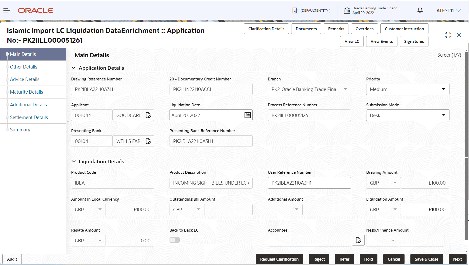

Application Details
All fields displayed under main details section, would be same as Registration stage. For more information on fields, refer 'Application Details' section of Registration stage.
  1. On Data Enrichment - Main Details screen, specify the fields that were not entered at Registration stage.
    Figure 2-6 Data Enrichment - Main Details
    Description of demainapplicationdetails.png follows
    Field Description
    Drawing Reference Number Read only field.
    The drawing reference number as selected in the Registration stage.
    Documentary Credit Number Read only field.
    Documentary credit number will be auto-populated based on the selected LC from the lookup.
    Branch Read only field.
    Branch details will be auto-populated based on the selected LC from the lookup.
    Priority System will populate the priority of the customer based on priority maintenance. If priority is not maintained for the customer, system will populate 'Medium' as the default priority.
    User can change the priority populated any time before submit of Registration stage.
    Applicant Read only field.
    Applicant details will be auto-populated based on the selected LC.
    Liquidation Date By default, the application will display branch’s current date and enables the user to change the date, back date is not alowed.
    Process Reference Number Read only field.
    Unique sequence number for the transaction.
    This is auto generated by the system based on process name and branch code.
    Submission Mode Select the submission mode of Import LC LC Liquidation request. By default the submission mode will have the value as ‘Desk’ for transactions created via registration.
    By default the submission mode will have the value as ‘Desk’.
    • Desk - Request received through Desk
    • Courier - Request received through Courier
    • Email - Request received through Mail
    • Fax - Request received through Fax
    Presenting Bank Read only field.
    This field displays the Presenting Bank name as per the drawing.
    Presenting Bank Reference Number Read only field.
    This field displays the Presenting Bank  reference number as per the drawing.

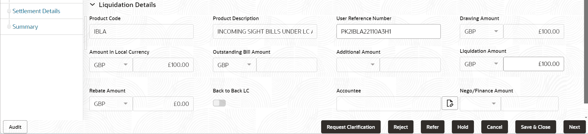

    Liquidation Details
    The fields listed under this section are same as the fields listed under the Liquidation Details section in Registration. For more information on fields, refer 'Liquidation Details' section of Registration stage.
    Table 2-4 Data Enrichment - Main Details - Liquidation Details - Field Description
    Field Description
    Product Code Read only field.
    This field displays the product code based on the selected Drawing Reference Number.
    Product Description Read only field.
    This field displays the description of the product as per the product code.
    User Reference Number
    This field displays the user reference number of the product as per the product code.
    The user can change the user reference number.
    Drawing Amount Read only field.
    This field displays the LC drawing amount as per the selected drawing.
    Amount In Local Currency Read only field.
    This field displays the Local currency and amount.
    Outstanding Bill Amount Read only field.
    Outstanding LC value will be auto-populated. This field displays the value as per the latest LC details.
    Additional Amount Read only field.
    This field displays any additional amount as per the latest LC drawing.
    Liquidation Amount
    Liquidation Amount defaults to the Outstanding Bill Amount. The user can modify the defaulted Liquidation Amount, if required.
    Liquidation currency is defaulted from the system.
    Rebate Amount Read only field.
    Rebate to the bill outstanding amount.
    Back to Back LC Read only field.
    This option is enabled, if the Import LC is back to back LC.
    This option is disabled, if back to back LC is not applicable.
    Accountee Read only field.
    The accountee name is auto-populated, if available.
    Finance Amount Read only field.
    The value for finance amount and currency is defaulted from the system.
  2. Click Next.
    The task will move to next data segment.
