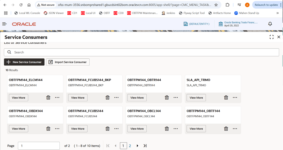

  2. On Home screen, click Core Maintenance then click Routing Hub and then Service Consumers.
    System will launch the OBRH service provider screen as shown below.

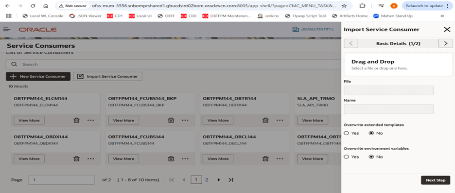

  3. Click on Import button and select the OBRH configuration artifact (JSON) as mentioned in section “OBTFPM – OBRH Configuration Deployment".
    The Import Service Consumer pop-up screen is displayed.
